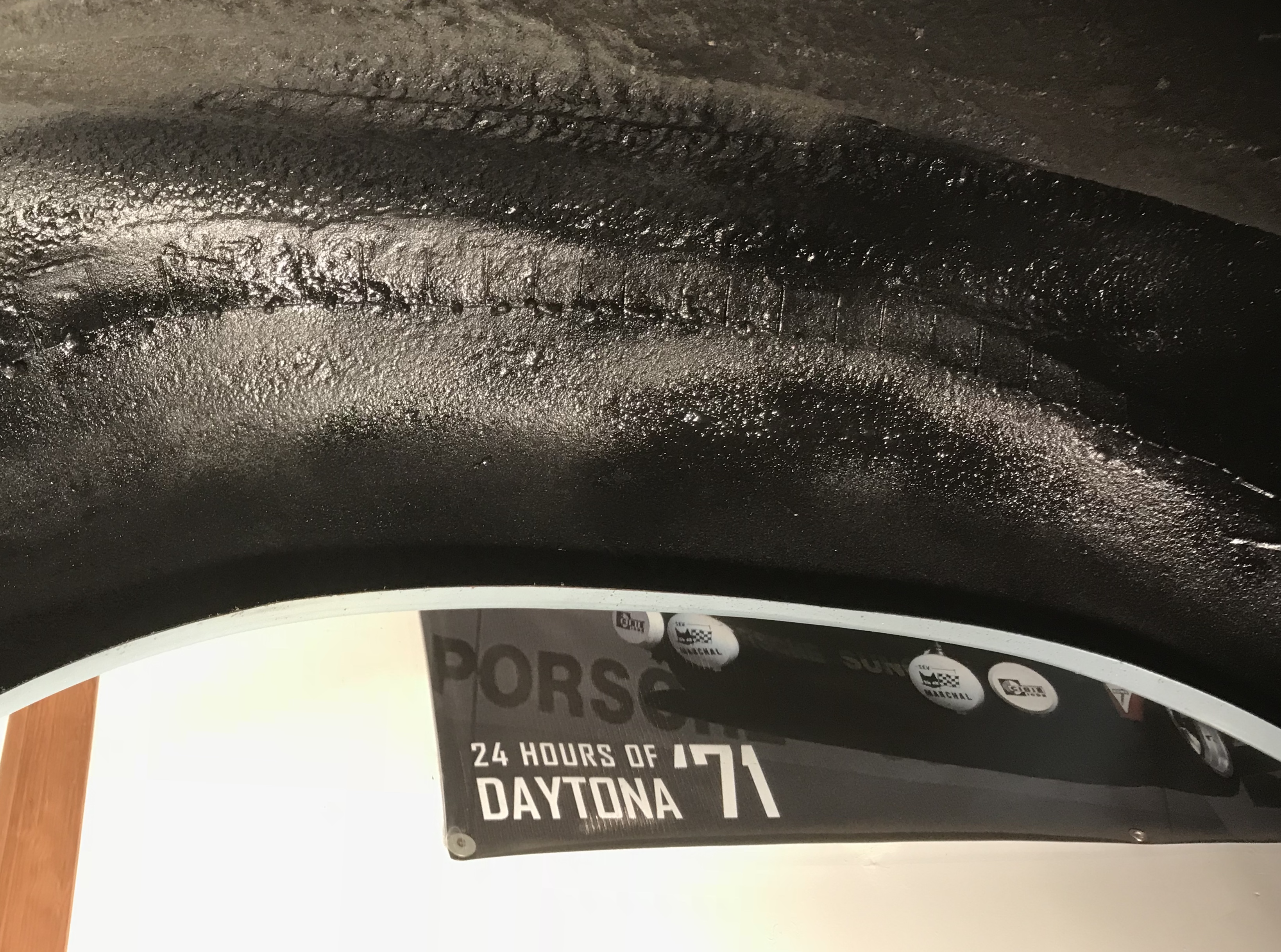

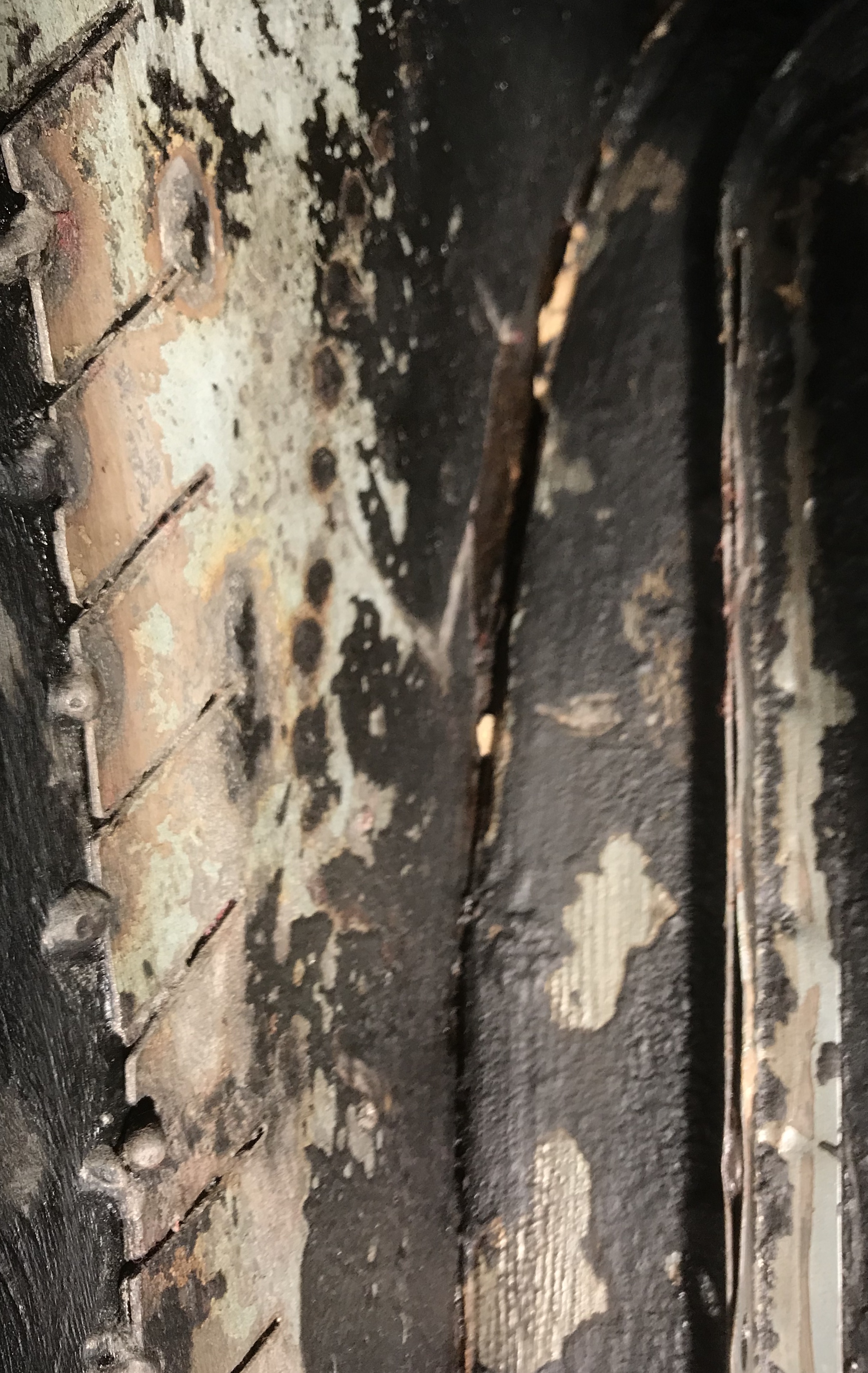

Etch turning rust to black with the phosphates.

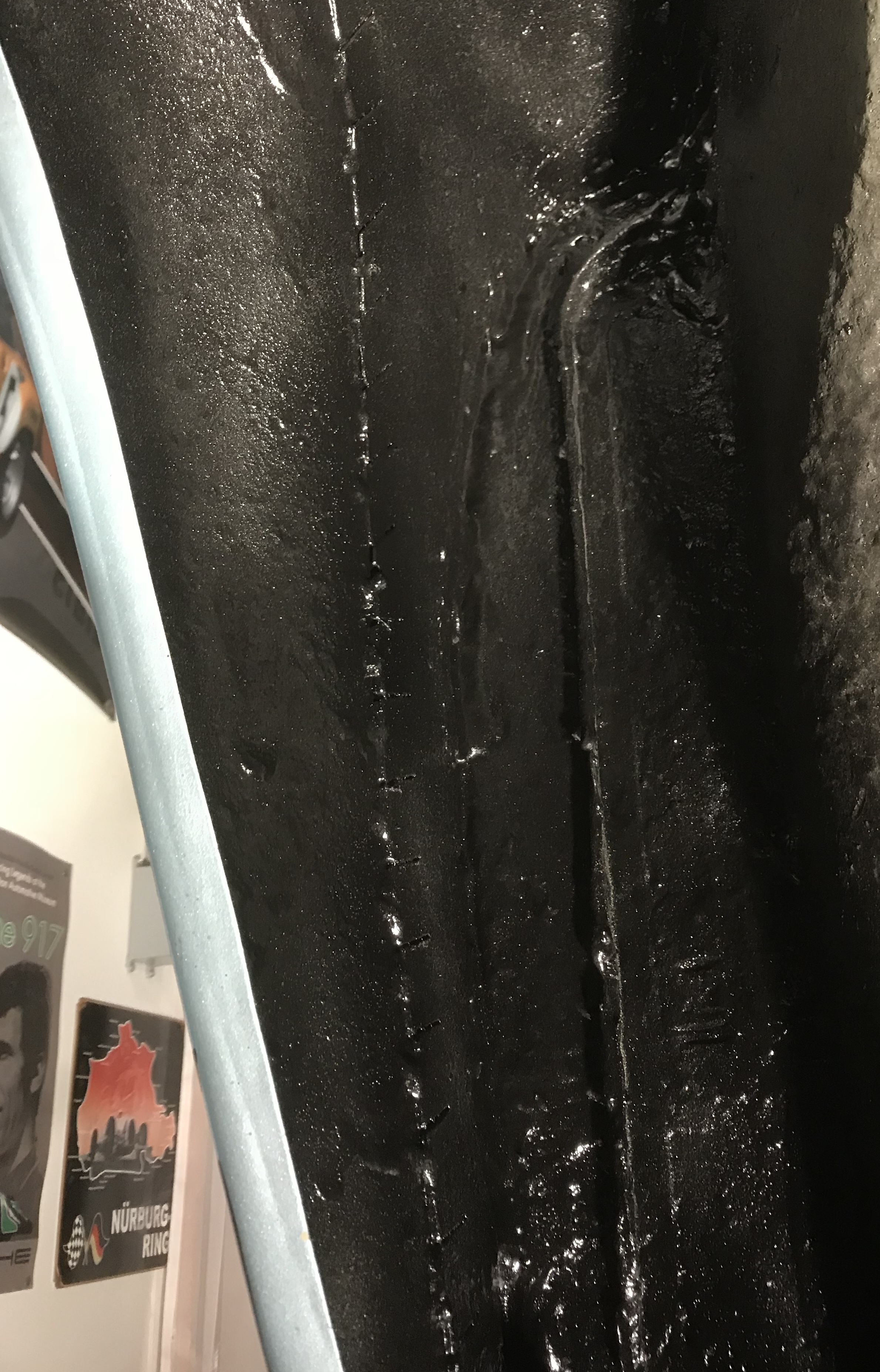

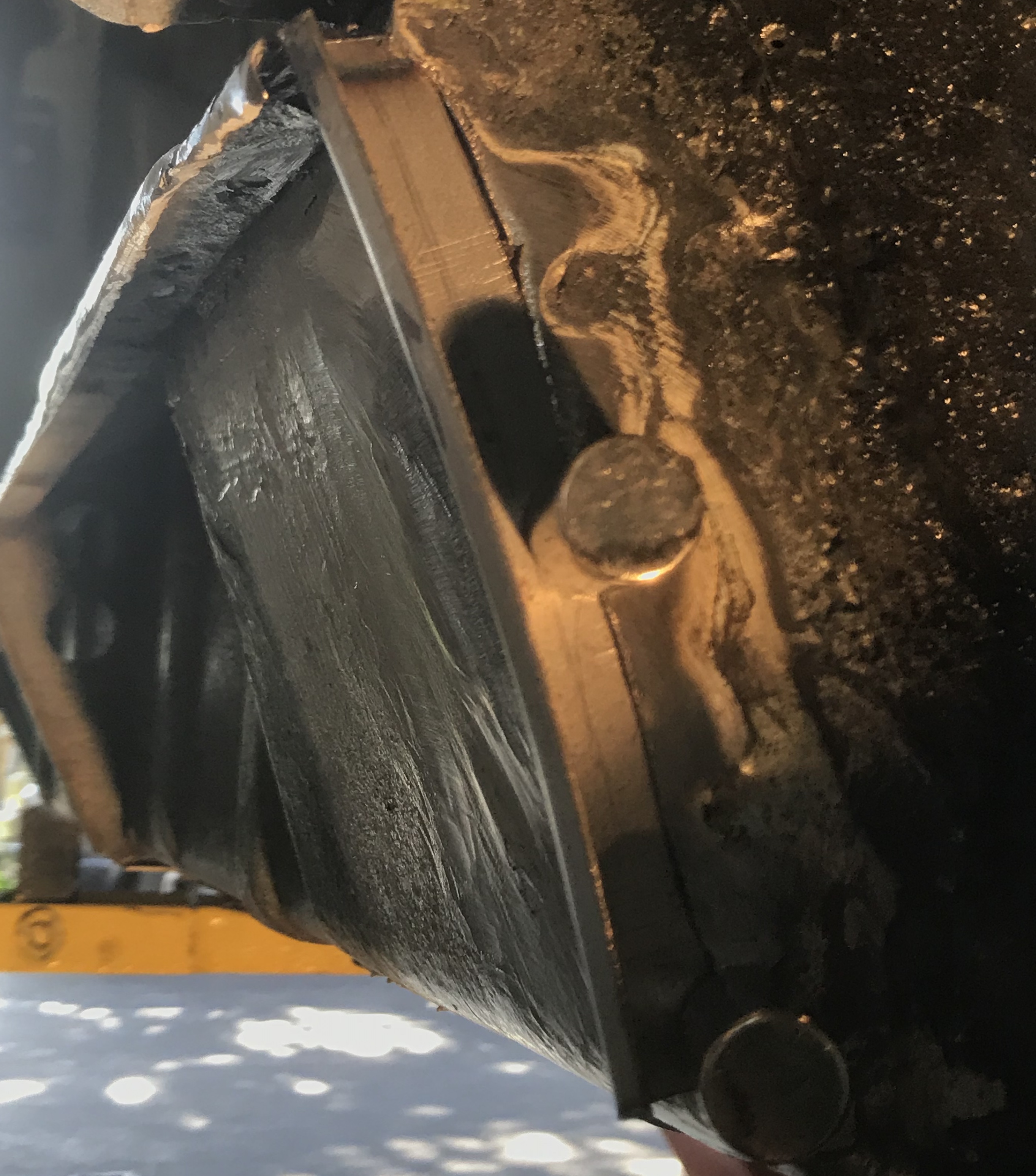

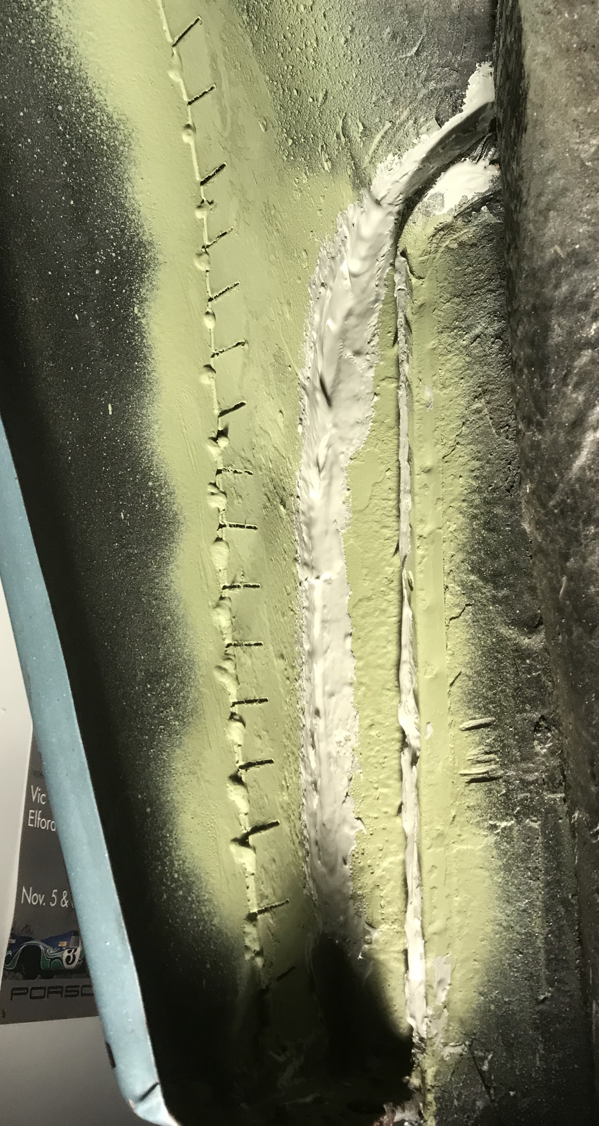

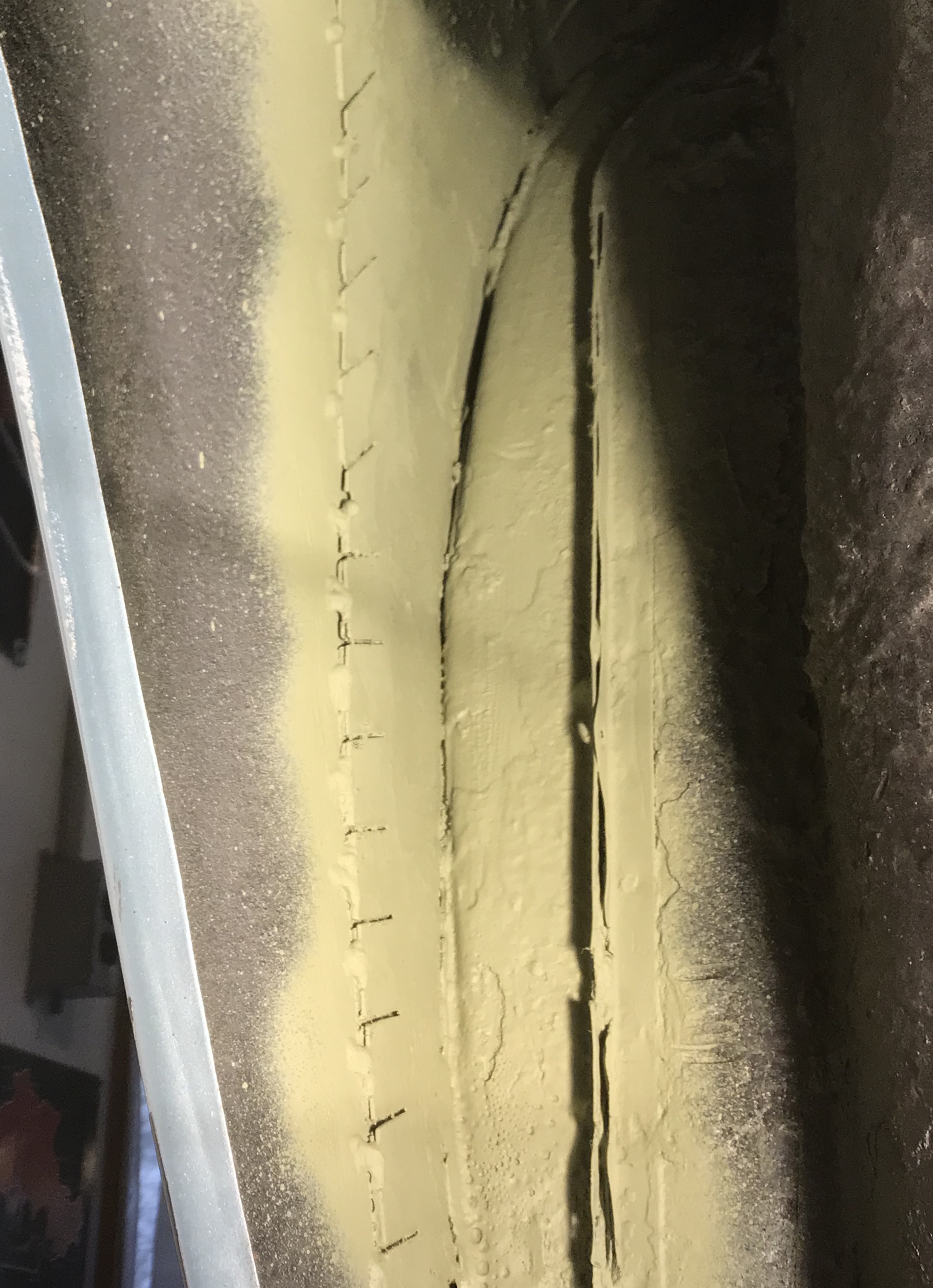

Frame coating and seam sealer
Dion
post Apr 14 2018, 07:35 PM
Post #263
RN
Posts: 2,839
Joined: 16-September 04
From: Audubon,PA
Member No.: 2,766

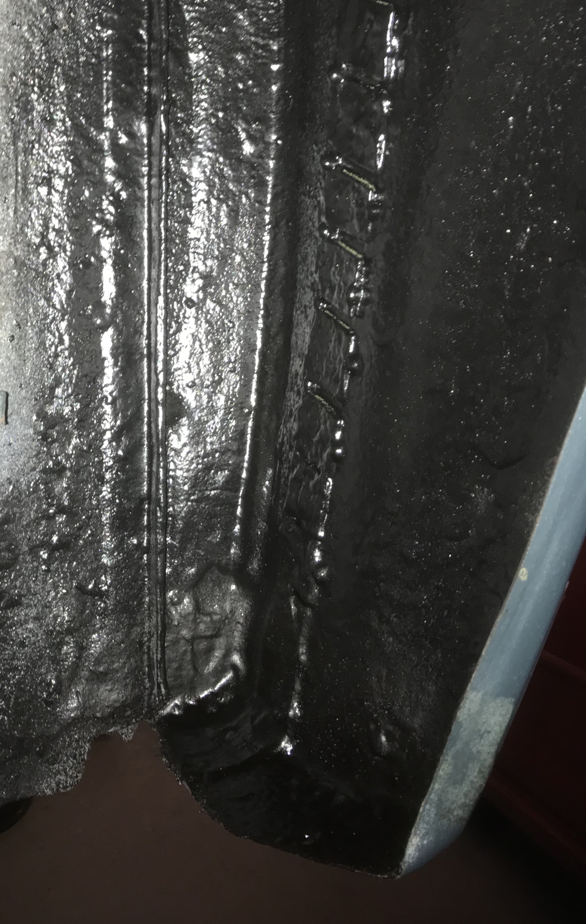

Undercoating
Dion
post Apr 14 2018, 07:36 PM
Post #264
RN
Posts: 2,839
From: Audubon,PA
Member No.: 2,766
Undercoating on overlap welded areas

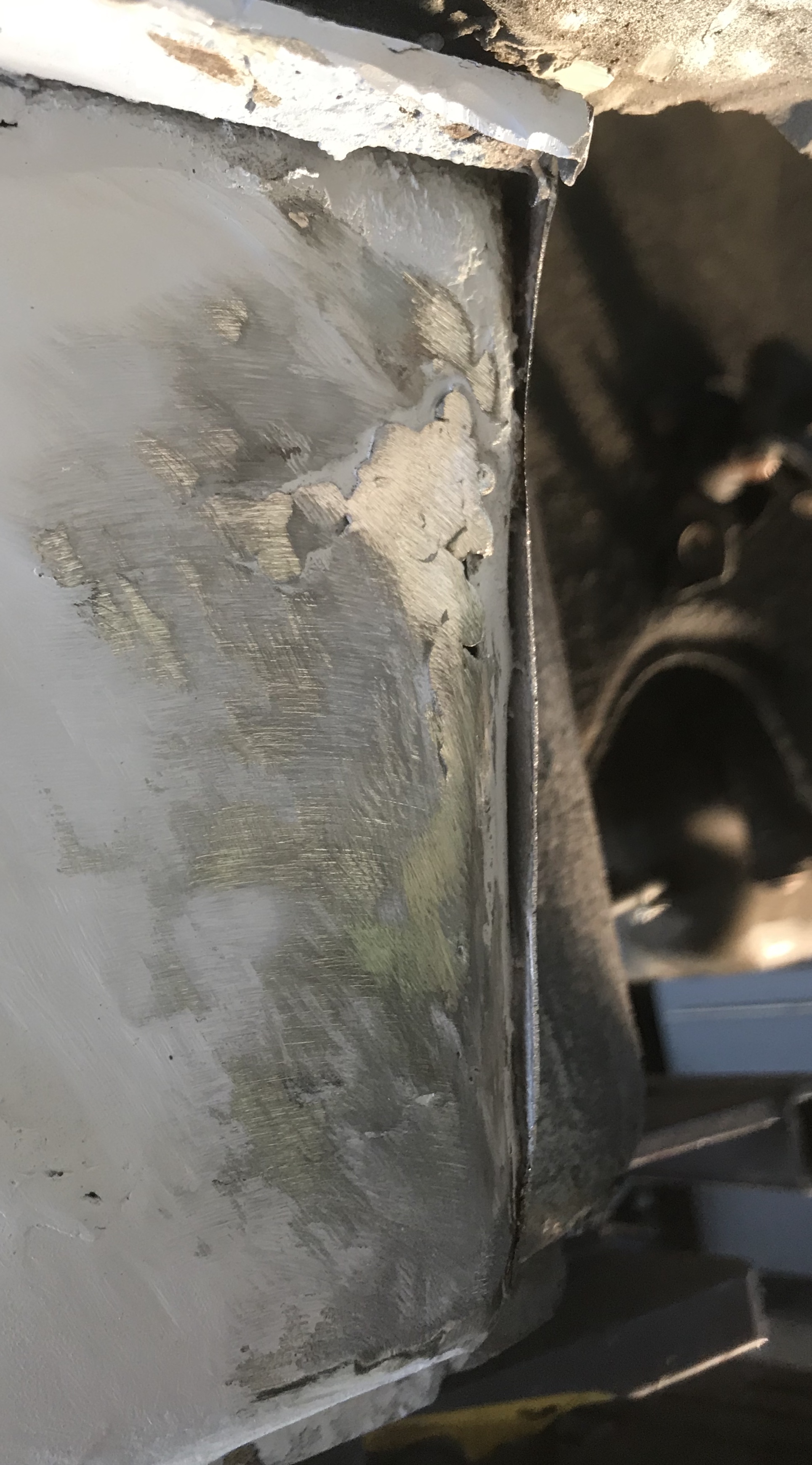

QUOTE(Dion @ Apr 2 2018, 01:43 PM) *
Happy Easter from the guy working on this project.
I worked on the front lower left fender today. What a treat this was.
Made some cardboard templates and then cut my shapes.
Bending the one piece was tricky as I don’t have the proper tools for this so
some pipe of different diameters and a vice helped me shape the curve.
Ha ha just like me older and hopefully wiser,good skills on the safety gear,I admit to being a bit slack @ times and payed the price,last we while I have 2 cut fingers with 1mm cutting wheels decided to wear mig/tig gloves from that point....makes sense.
If your flairs were overlap welded that's not too much of an issue as long as the steel was "keyed up" with a course abrasive and the filler hasn't cracked you should be fine,never been a fan of fillers but if prepped properly generally they are fine.
I understand this was done a while back if still holding up well on the exterior leave it,there's a lot you can do on the inside that's not seen afterall.
Good luck mate (IMG:style_emoticons/default/bye1.gif) .

What kind of metal etch are you using? I have some areas I would like to apply this to on my car and I have never used an etch applied by hand that converts rust. Please share.
Dion
post Apr 15 2018, 12:23 PM
Post #267
RN
Posts: 2,839
From: Audubon,PA
Member No.: 2,766
QUOTE(mb911 @ Apr 15 2018, 07:42 AM) *
Hey Ben, it was Eastwood “Fast Etch”
Shop personnel explained to me it etches and will
coat the rust with a phosphate. I used it in spray form, I let soak in for around 45 minutes. It then needs to be cleaned off. I used pre paint prep to clean it up. Then I used the frame interior coating.
Cheers, Dion

QUOTE(Dion @ Apr 1 2018, 05:55 PM) *
seam seal & primer
Left front fender buttoned up.

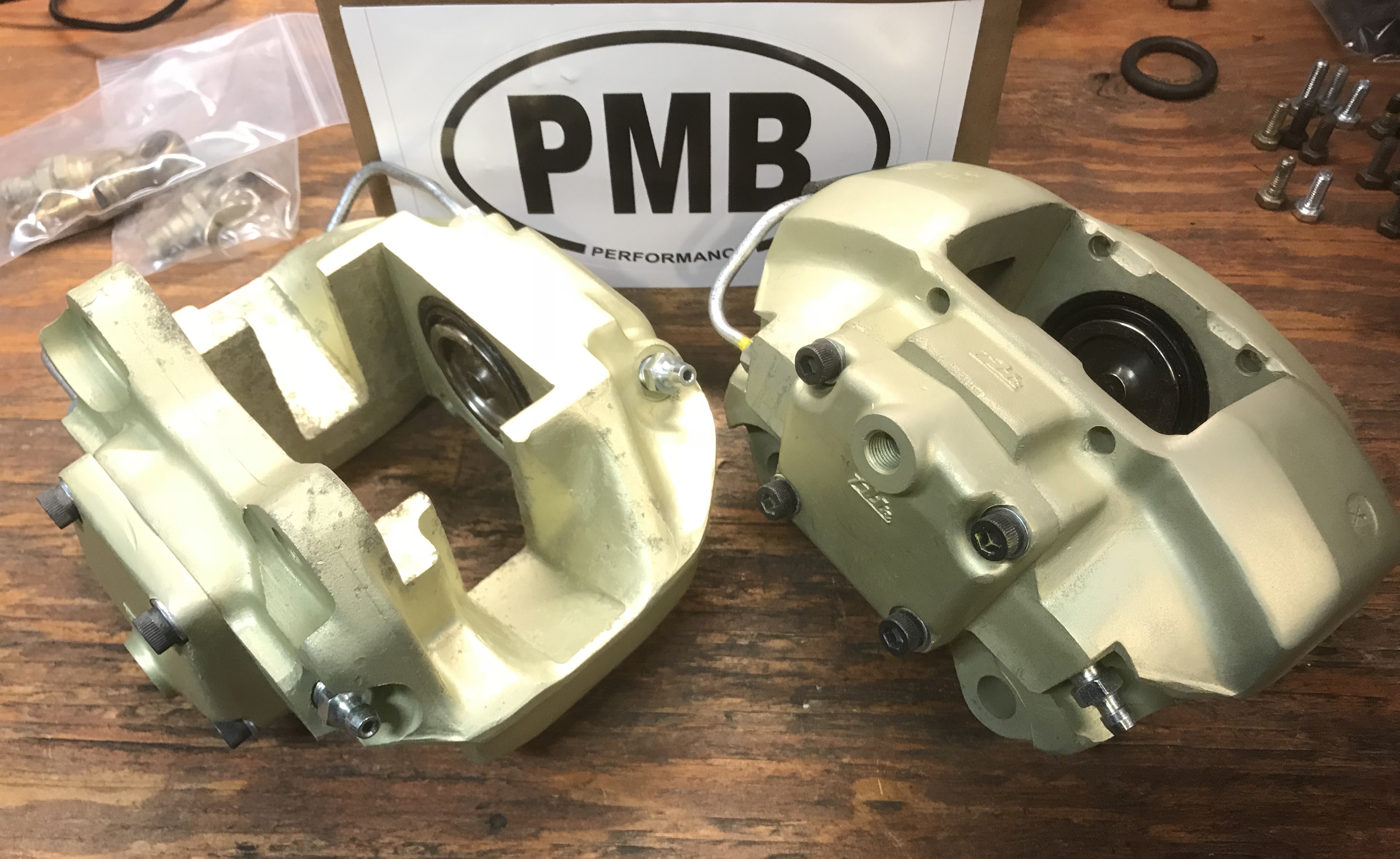

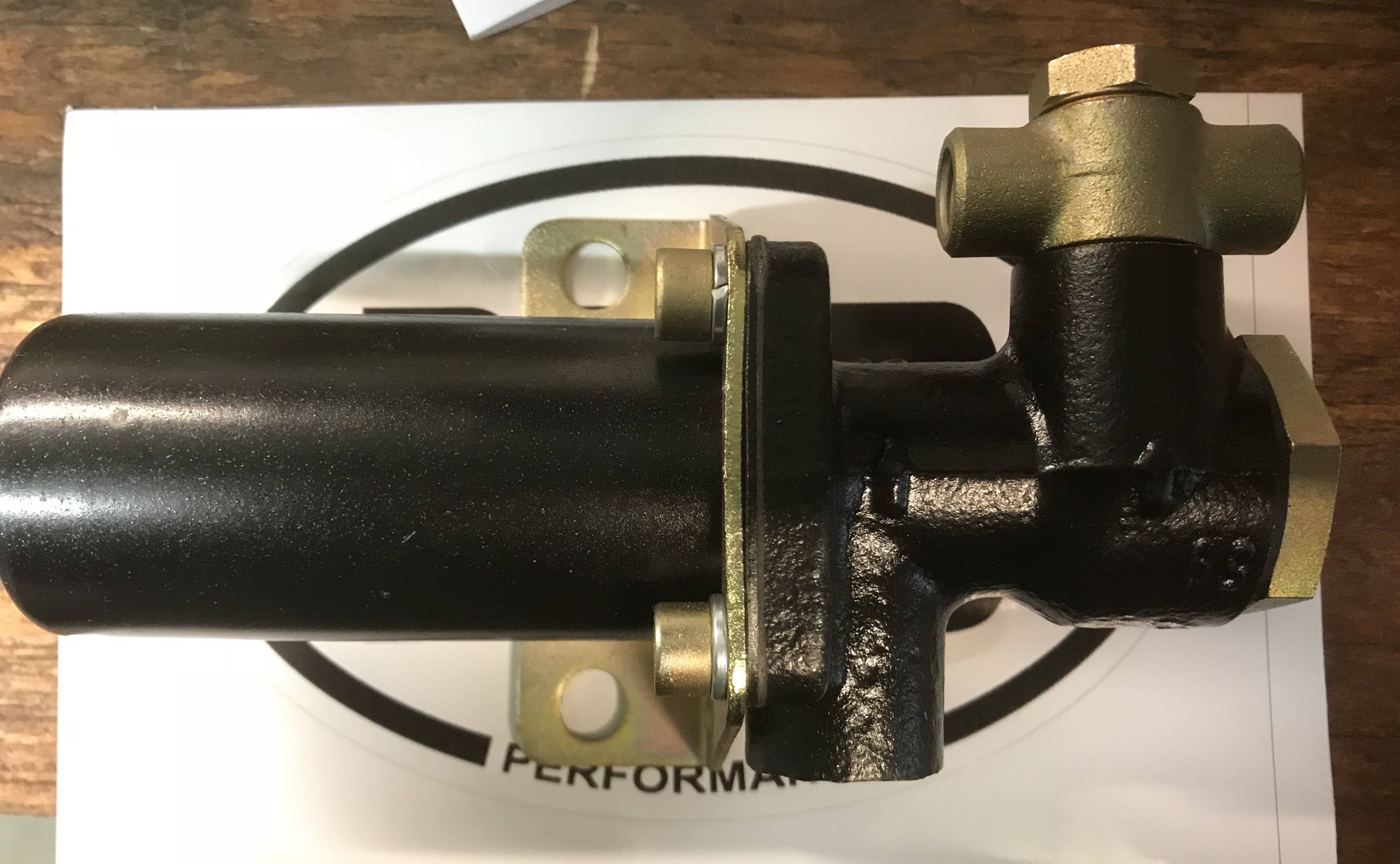

Just wanted to give a shout out to Eric and the gang at PMB.
Received my restored S calipers and regulator today as well as the brake line kit.
Thanks a bunch guys. They look awesome,& I’m sure they’ll provide plenty of STOP! (IMG:style_emoticons/default/smilie_pokal.gif) (IMG:style_emoticons/default/crest.gif)

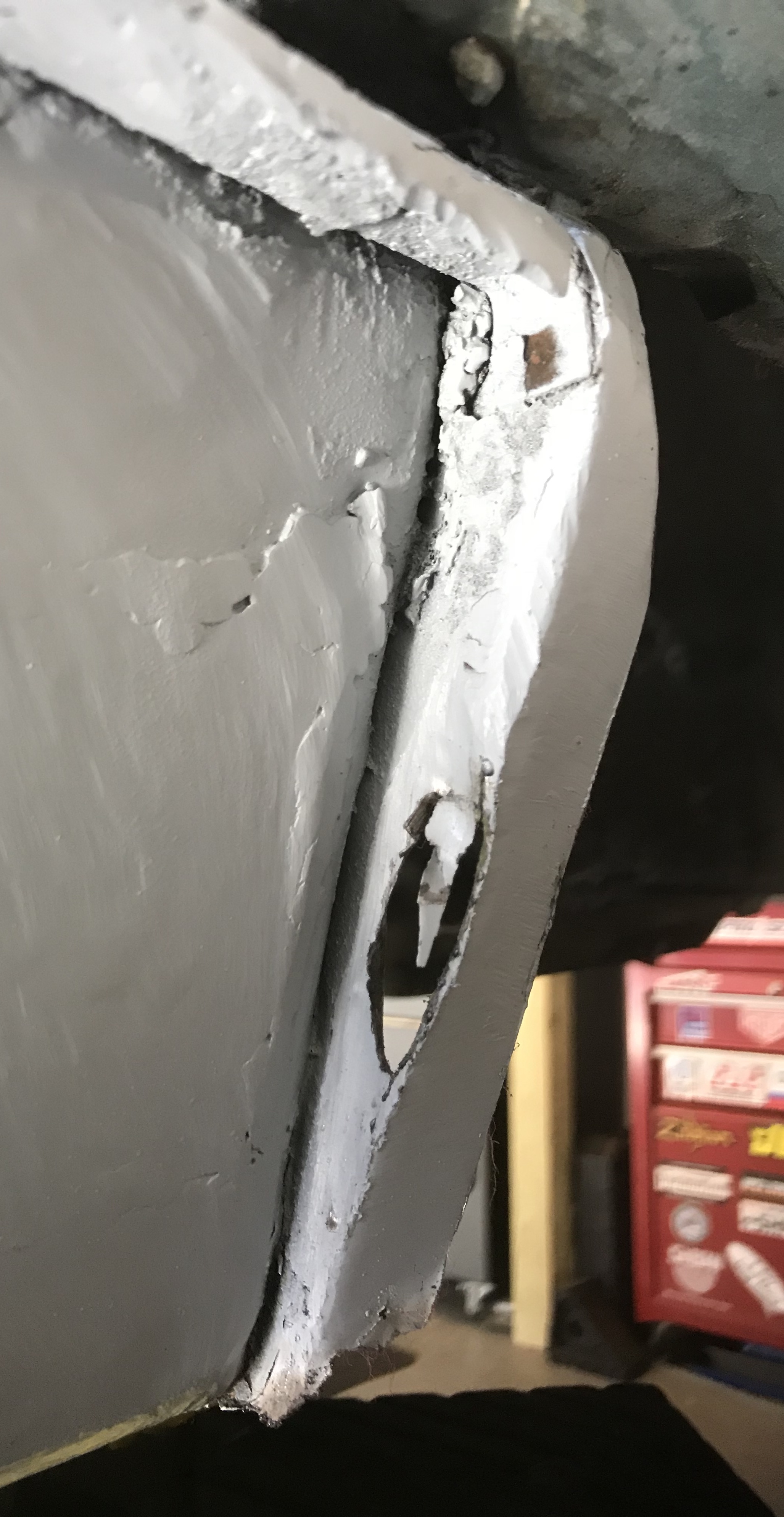

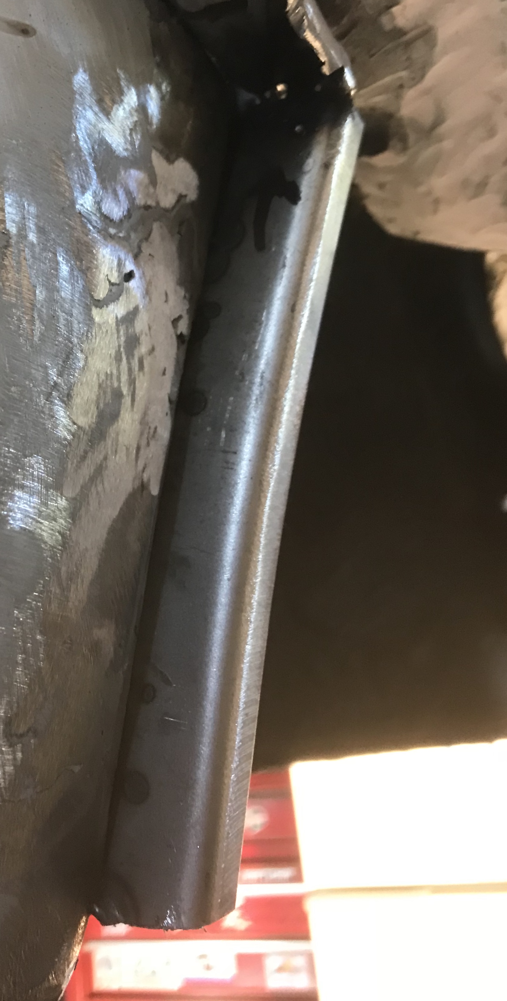

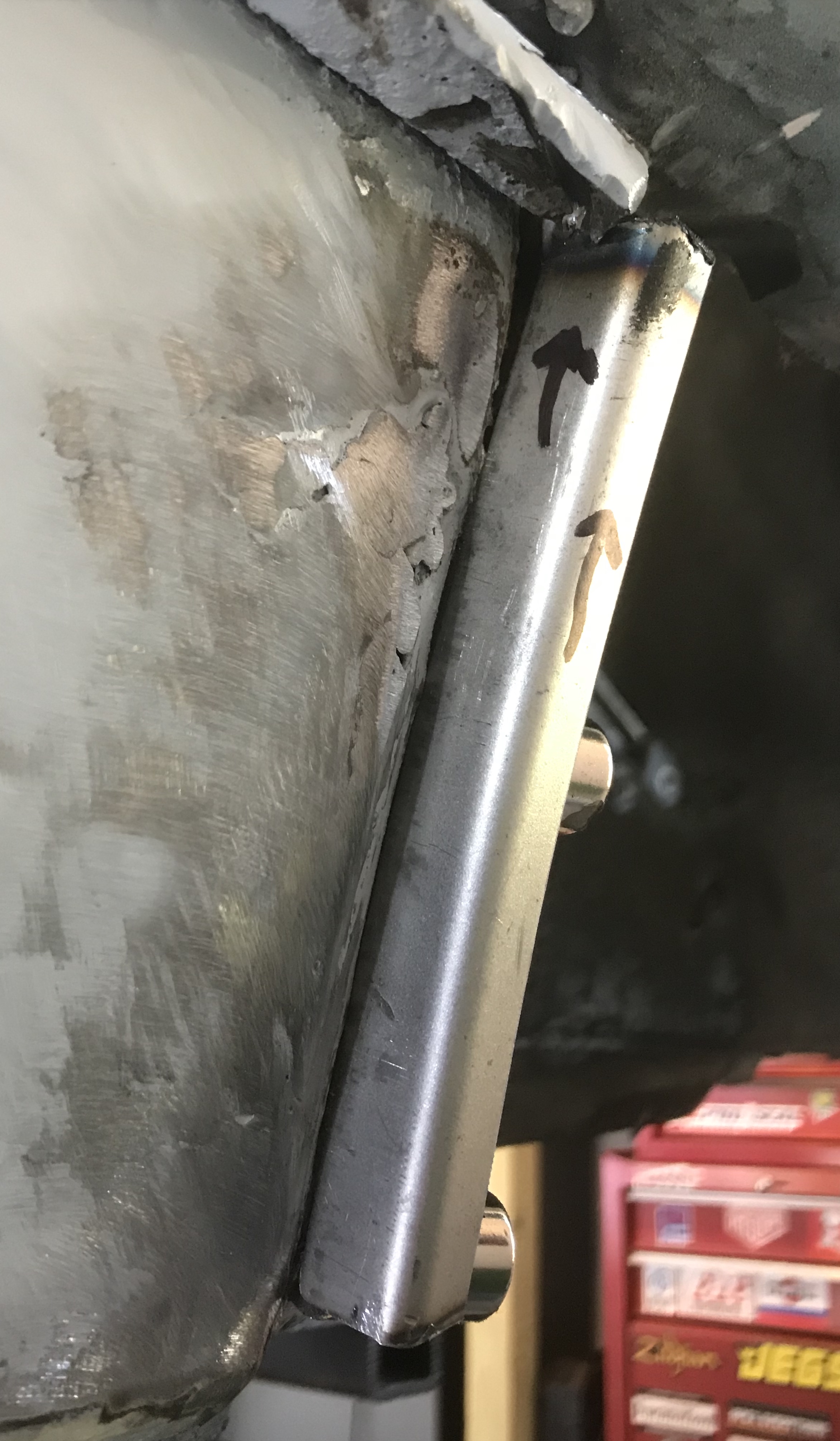

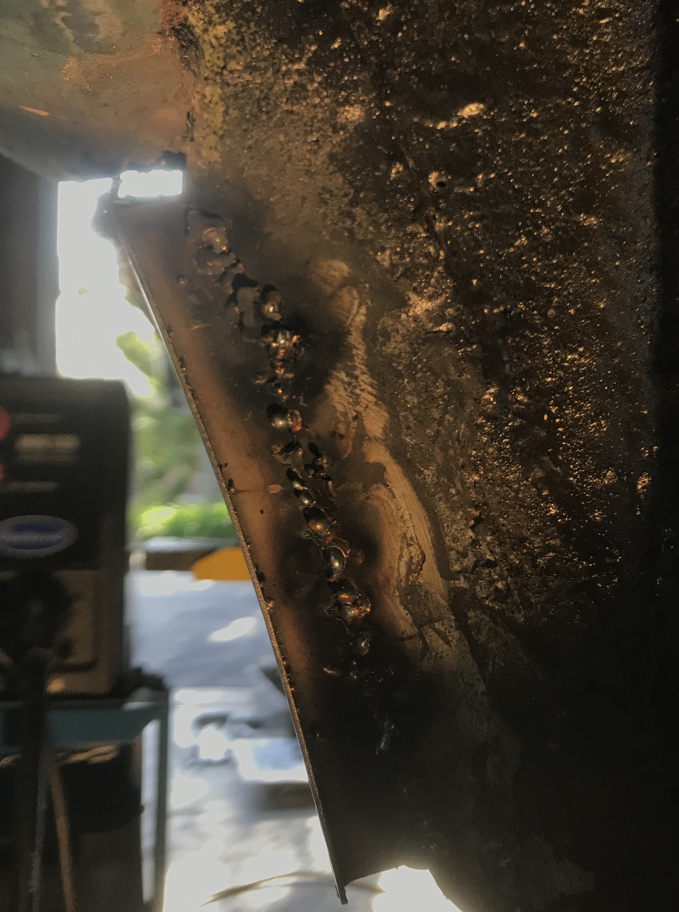

This afternoon repaired the remaining rust issue on the right front fender wheelhouse/longitudinal area. Cut off the offending piece. Made
a new one in as close a profile as I could. Using the workbench vise and a hammer to make the bend. Tacked it in. I’m pleased as to how it came out.
Listening to Ben, Chris, Brent & Dave, I think I’m finally gettIn the hang of this
welding business!
Dion
post Apr 26 2018, 07:11 PM
Post #279
RN
Posts: 2,839
From: Audubon,PA
Member No.: 2,766
New shape offered up
Dion
post Apr 26 2018, 07:12 PM
Post #280
RN
Posts: 2,839
From: Audubon,PA
Member No.: 2,766
Tacked
