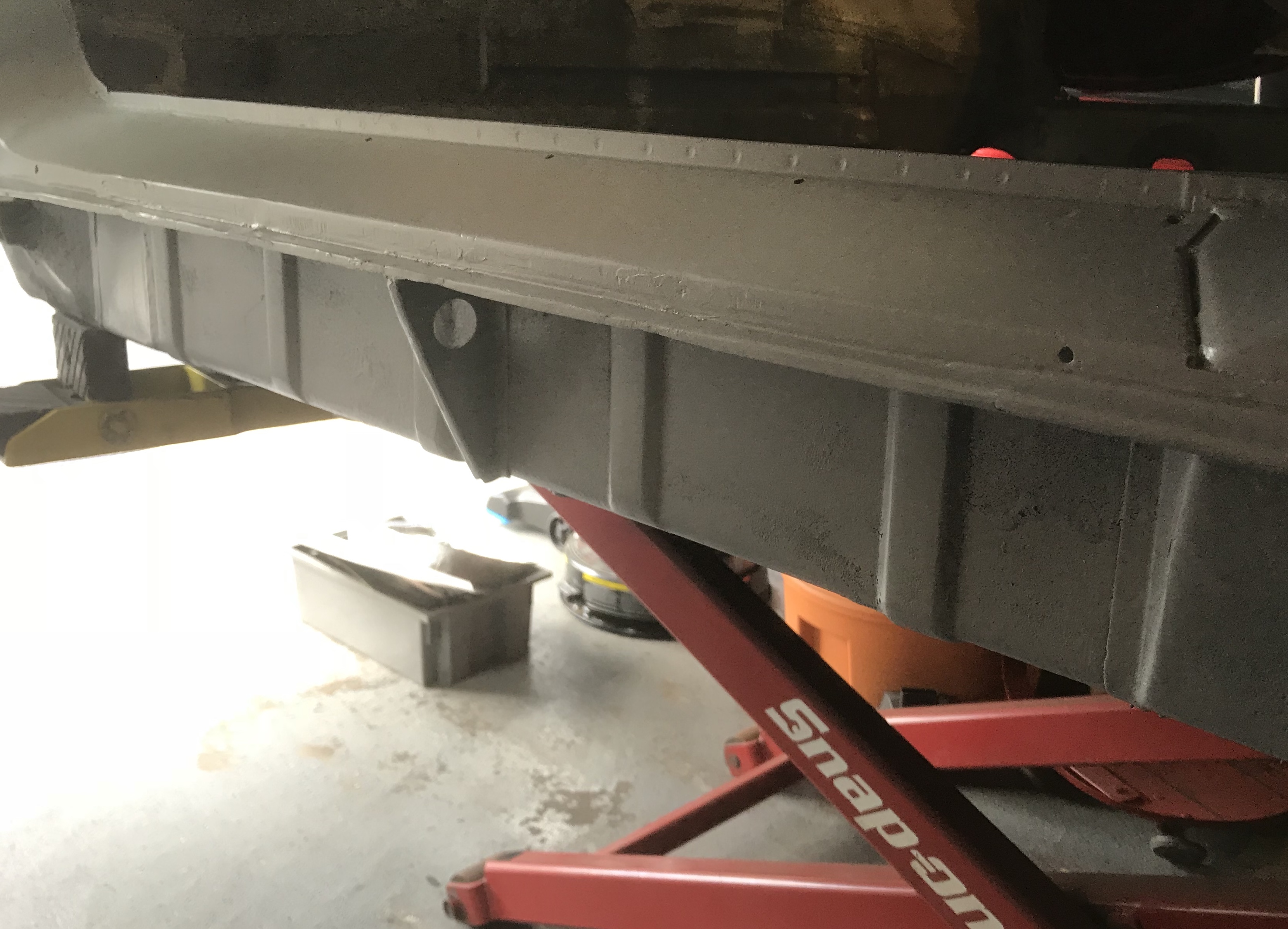

Clean up
Dion
post Apr 26 2018, 07:14 PM
Post #282
RN
Posts: 2,839
Joined: 16-September 04
From: Audubon,PA
Member No.: 2,766
Fin!

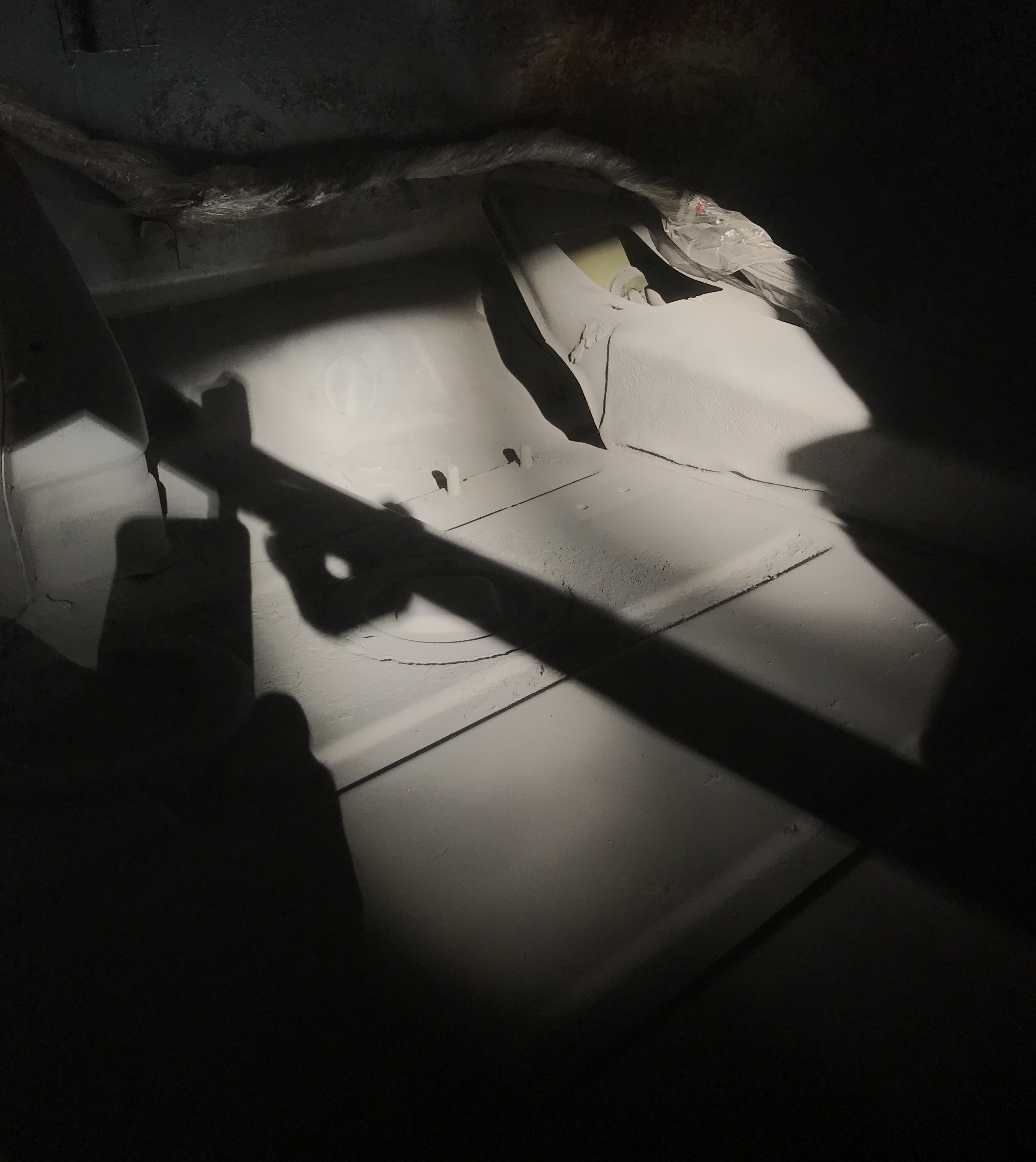

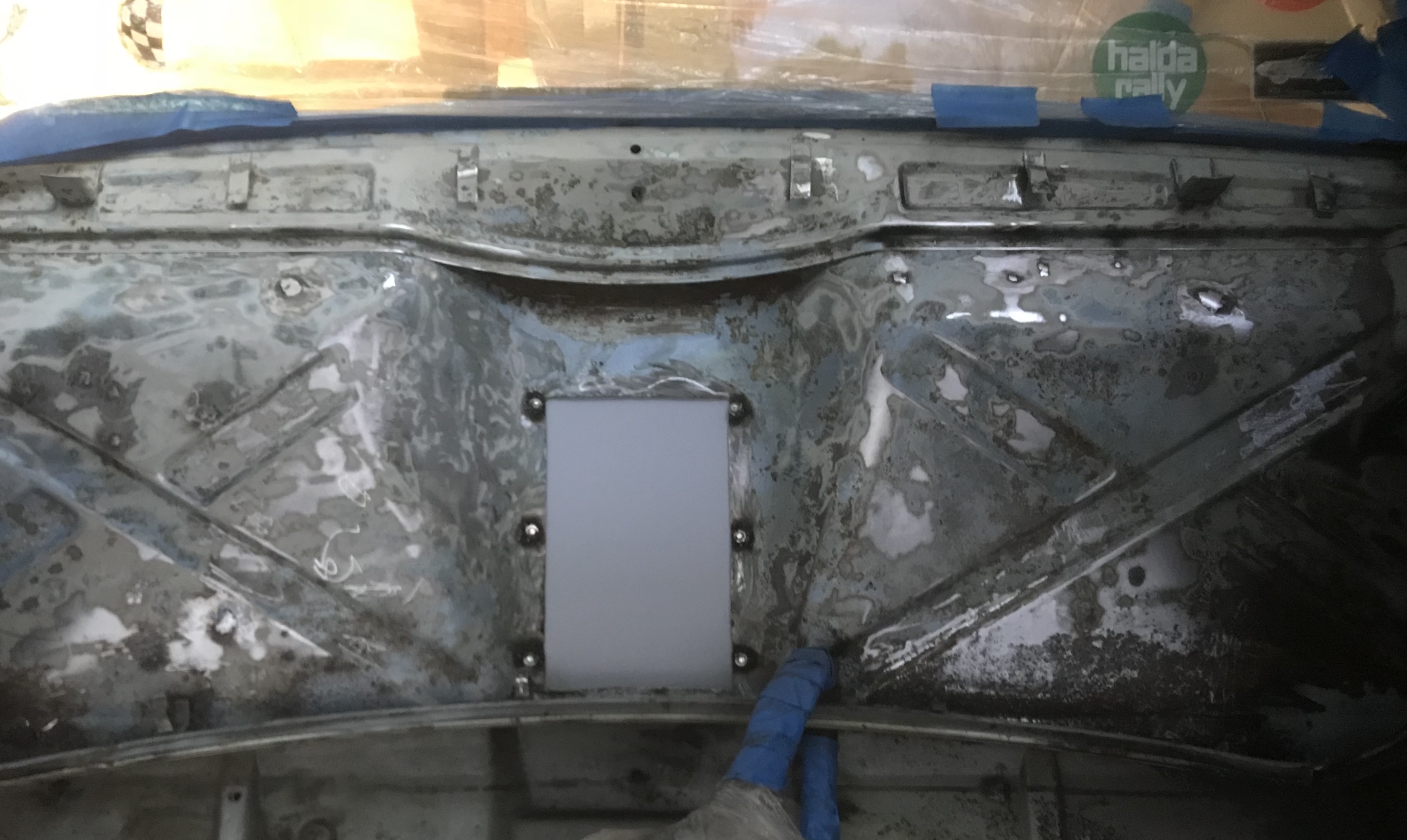

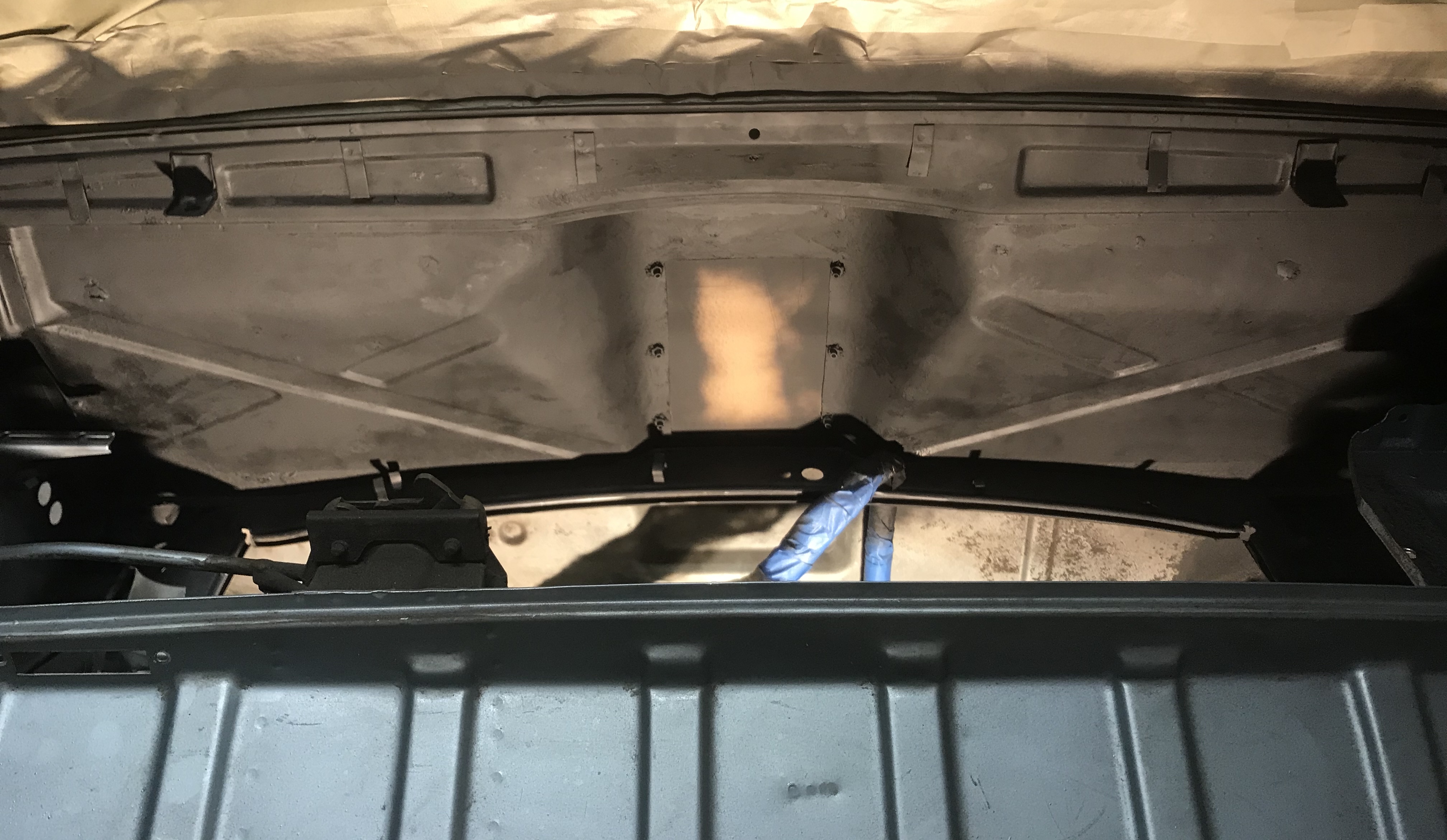

Nothing exciting today except for the cheap high. Man even while wearing the 3M
NIOSH respirator those fumes creep in!
I sanded the engine side of the firewall yesterday and today I coated it with
Epoxy primer.

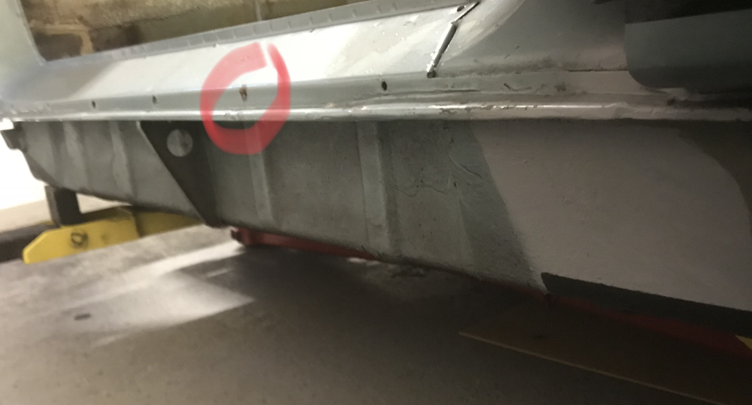

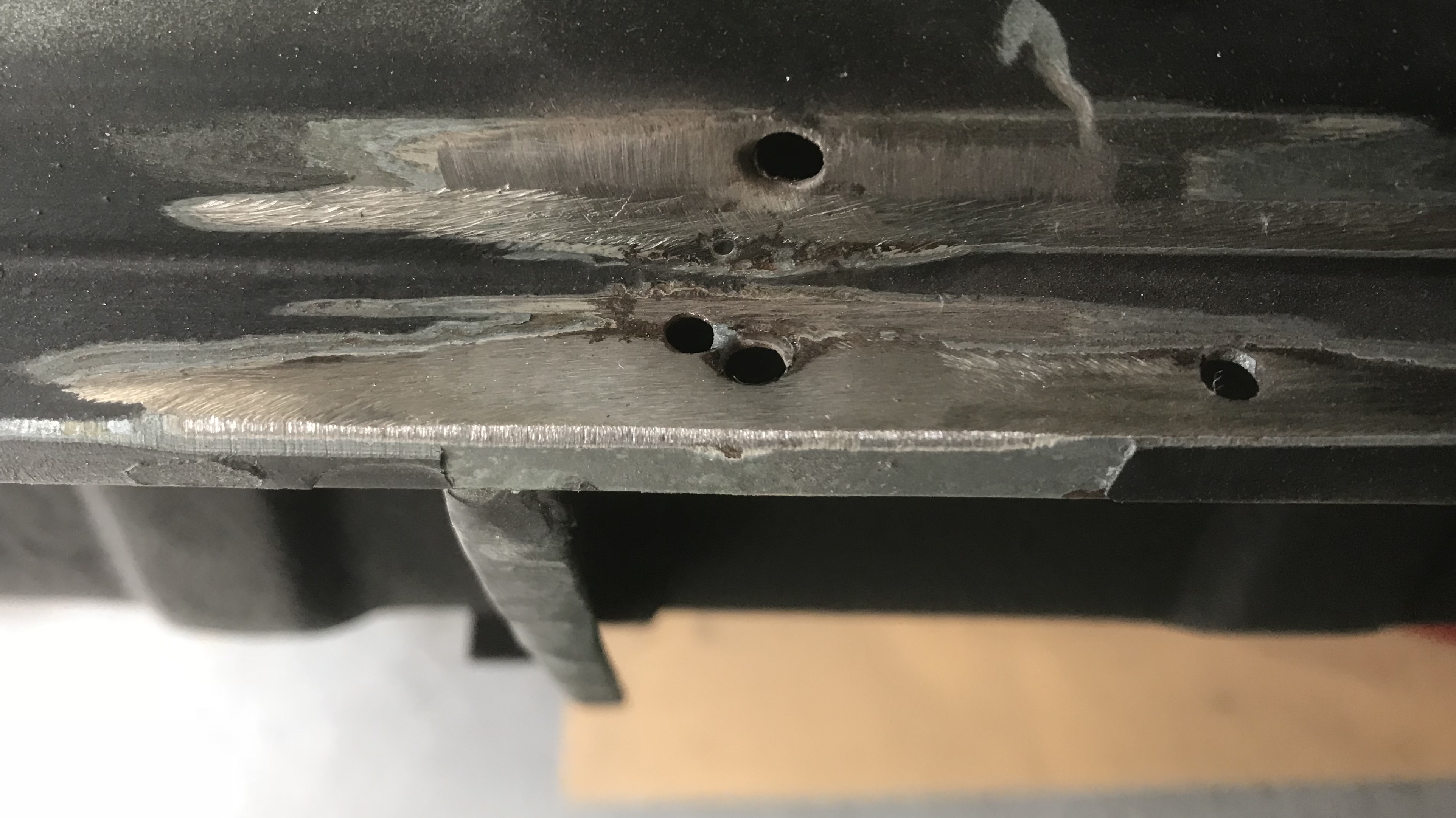

Question fellas. I’m working on the right side sill next. I have six holes. Centered 6” apart.
Can someone verify if that is correct for the factory sill plates.
Mine are packed away. Not at hand to check. I have a little welding to repair one as it
really isn’t s circular hole anymore and I want to redrill properly afterwards.
Thanks.
Dion
post Apr 30 2018, 06:31 PM
Post #286
RN
Posts: 2,839
From: Audubon,PA
Member No.: 2,766
Ok, Dave says just weld them all close and redrill when
the rust issue is fixed and I can then use the sill as a template.
It’s great when common sense prevails. Thanks bro!
I was ready to make it more complicated.

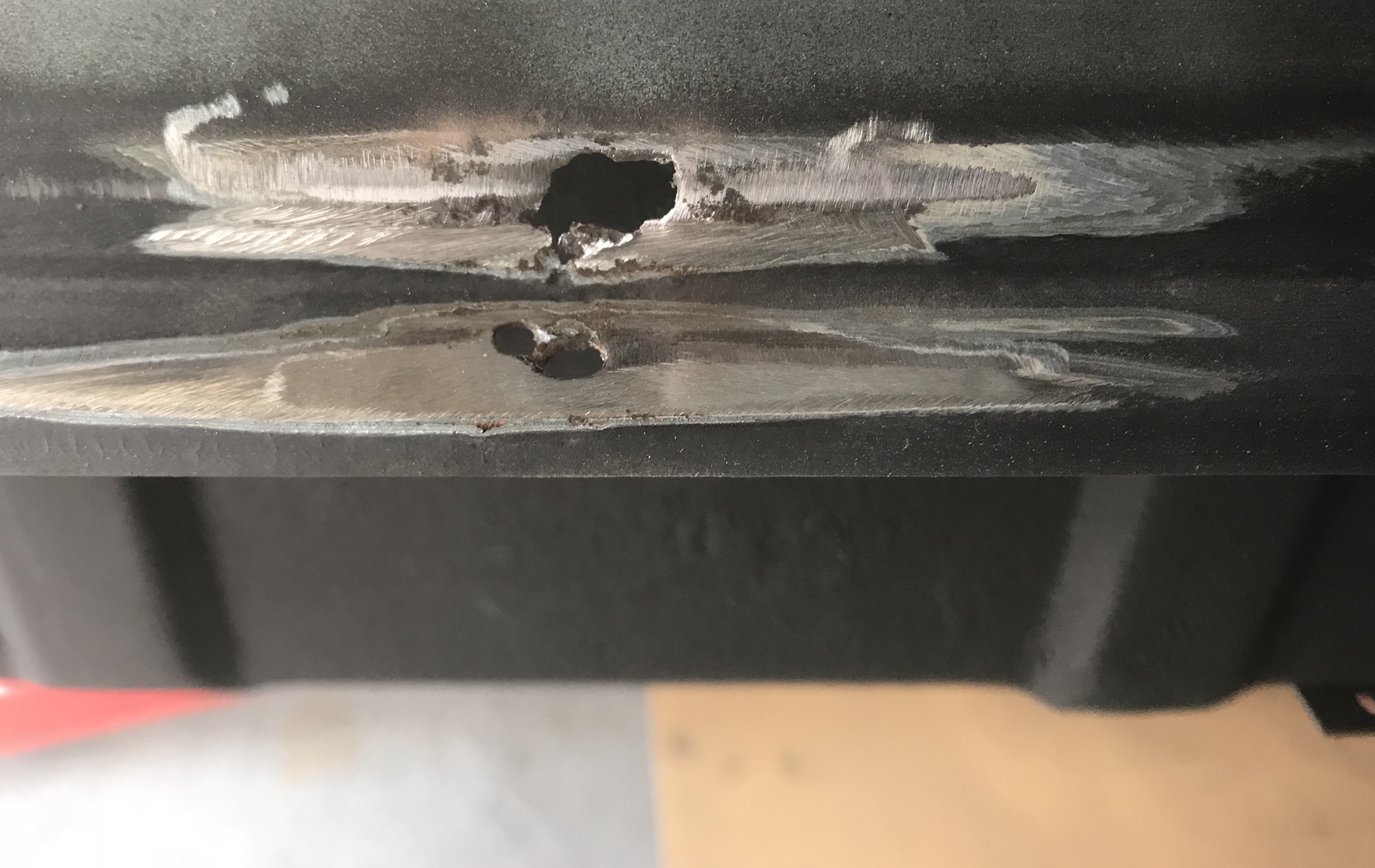

Dion
post May 8 2018, 10:17 AM
Post #287
RN
Posts: 2,839
From: Audubon,PA
Member No.: 2,766

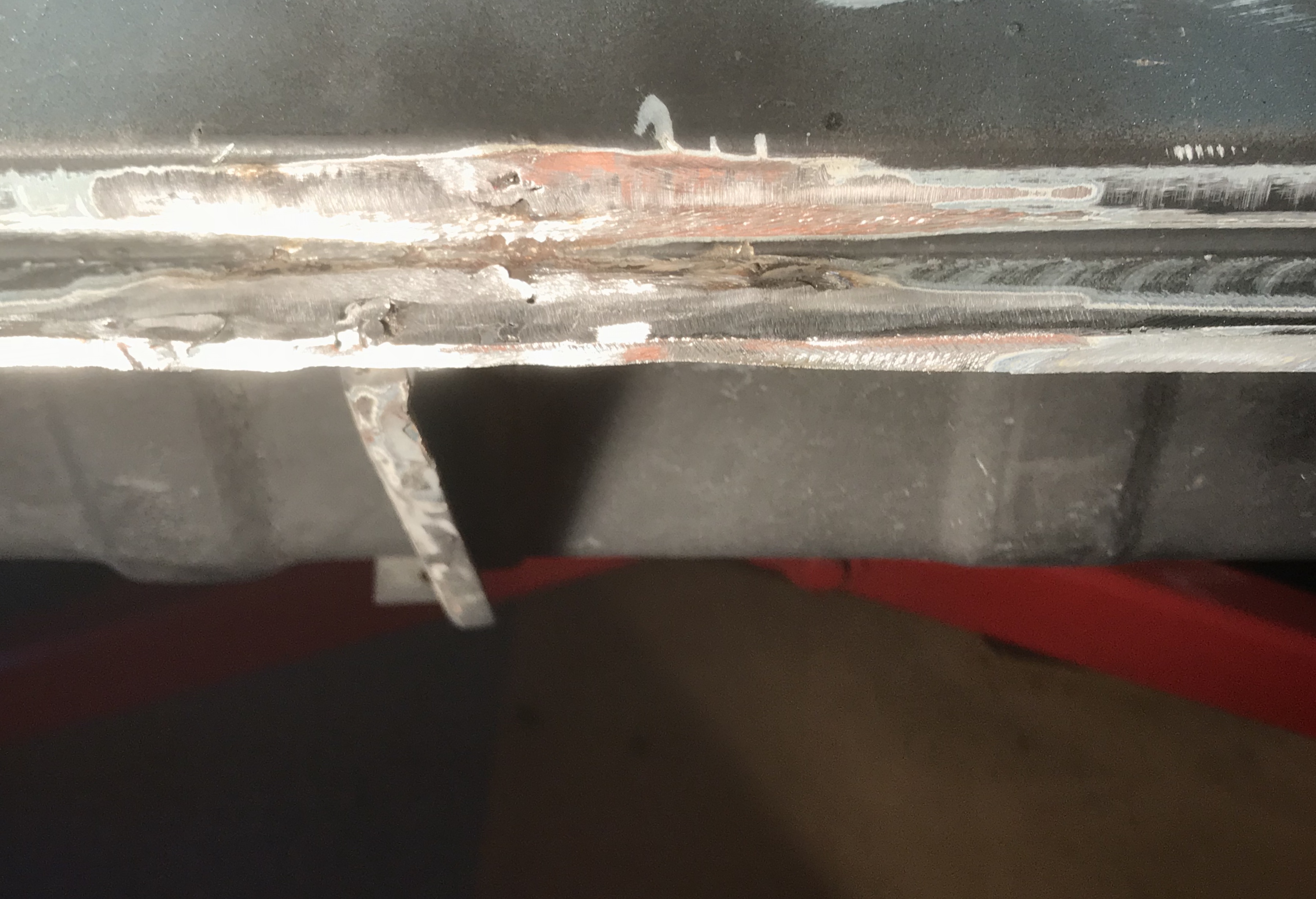

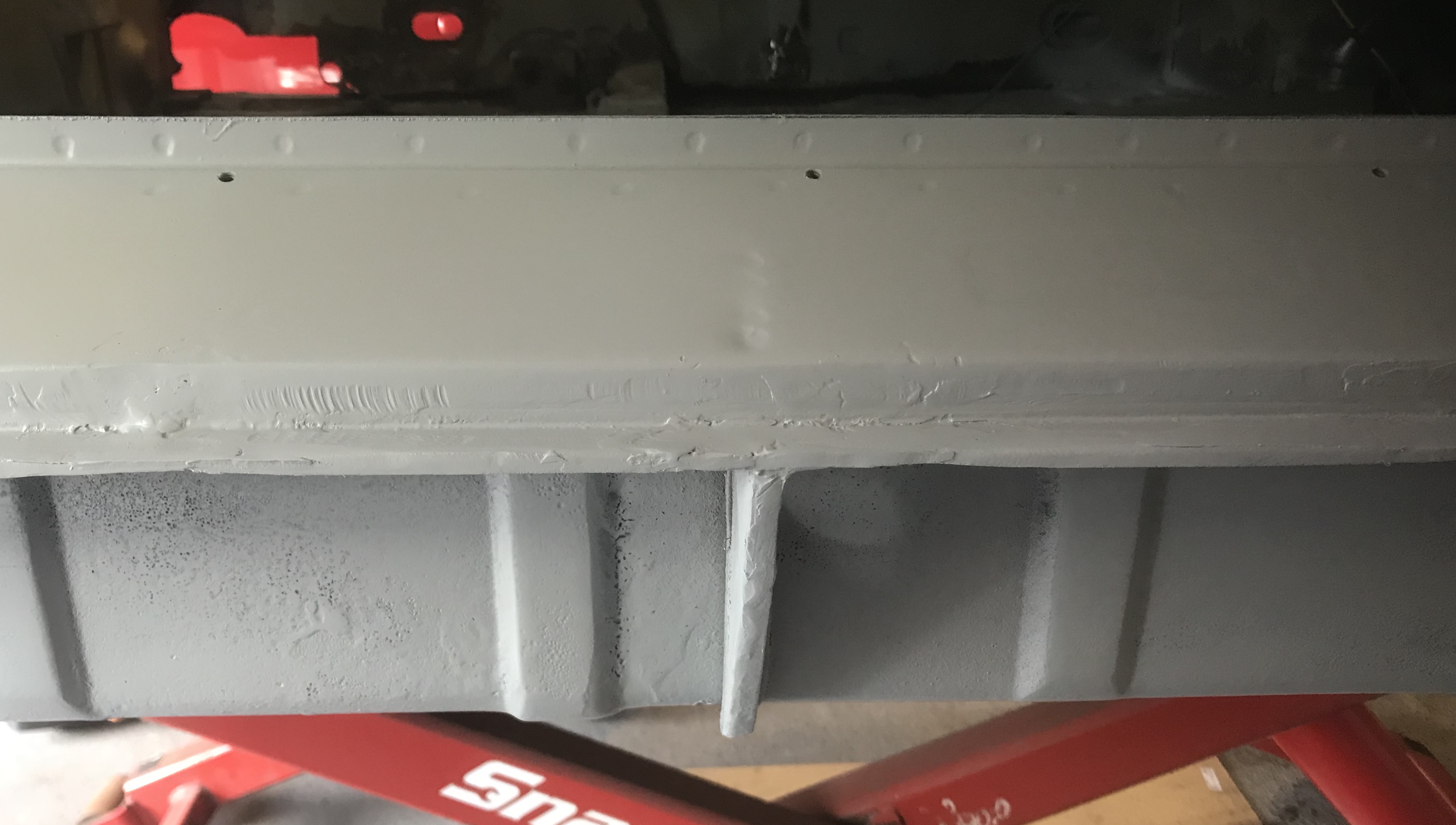

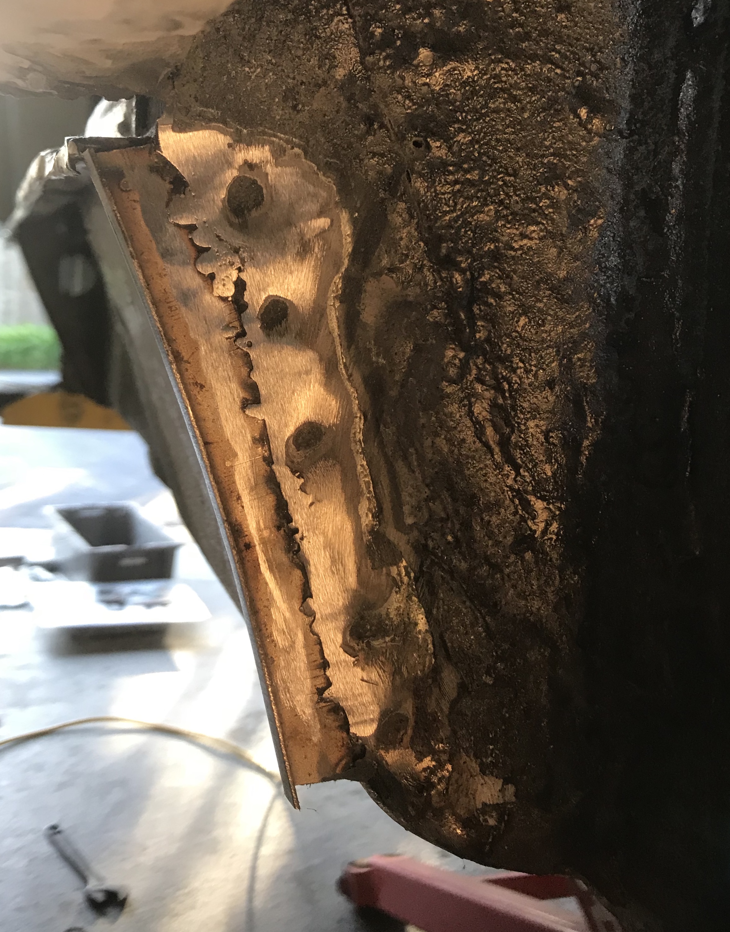

Worked on passenger side sill area.
Welded up the too numerous holes for rocker panels and sill plate.
Also removed some surface rust. A general cleanup.
Next up will be working on the left rear quarter panel/fender.
Dion
post May 8 2018, 10:18 AM
Post #288
RN
Posts: 2,839
From: Audubon,PA
Member No.: 2,766

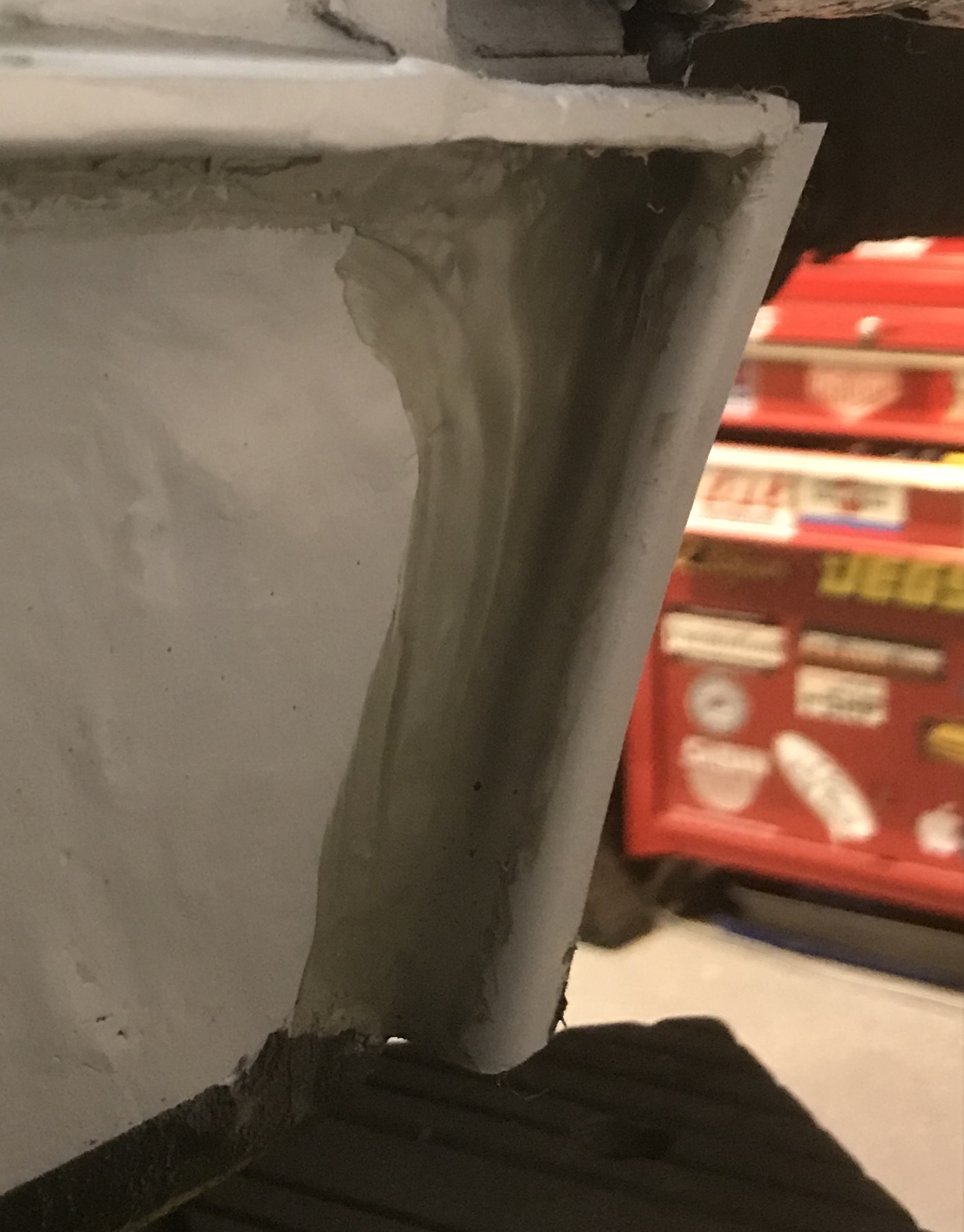

Welded & cleaned

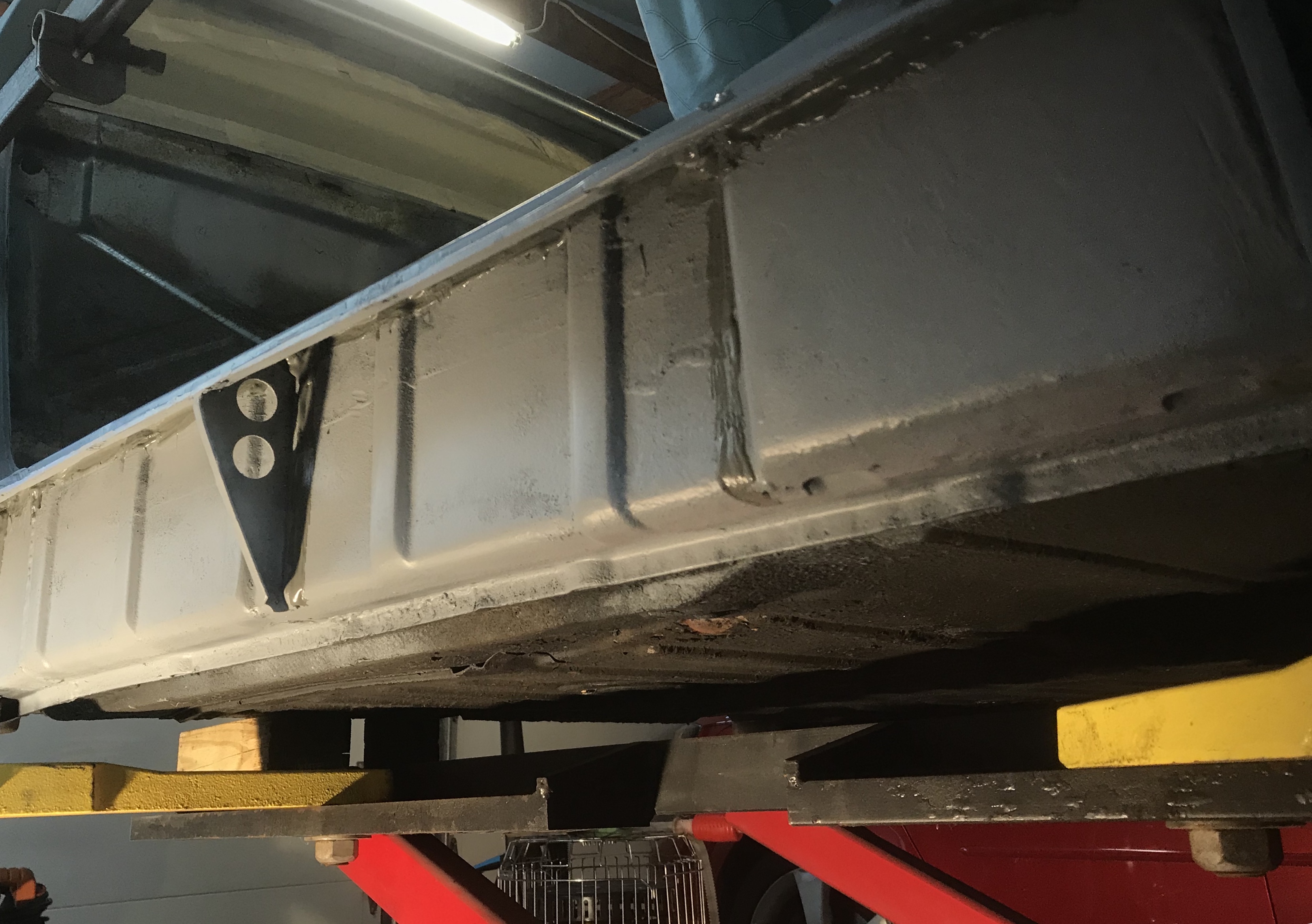

post May 8 2018, 10:20 AM
Post #289
RN
Posts: 2,839
From: Audubon,PA
Member No.: 2,766

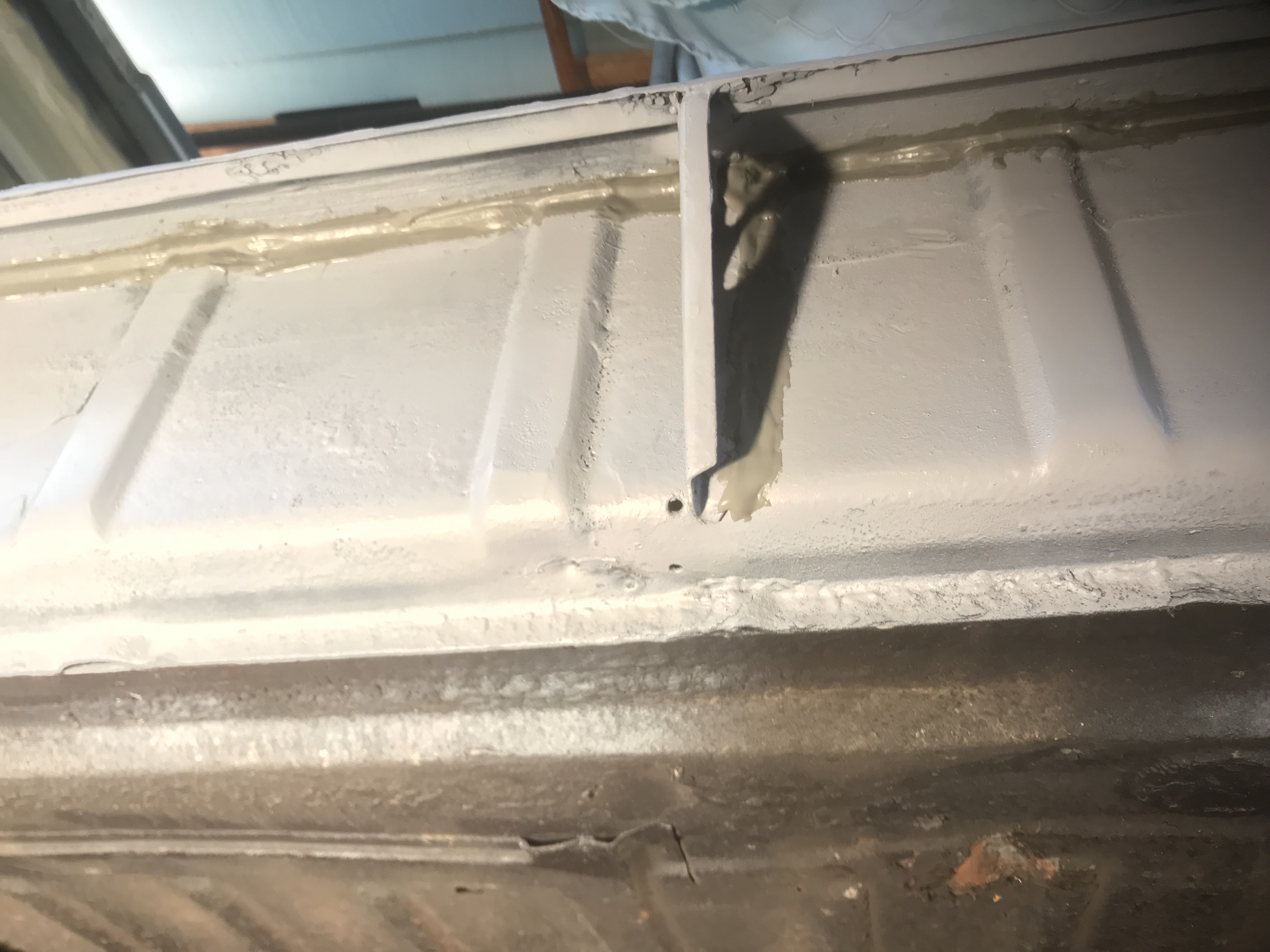

Primered & seam sealed.
Dion
post May 8 2018, 10:22 AM
Post #290
RN
Posts: 2,839
From: Audubon,PA
Member No.: 2,766
Done

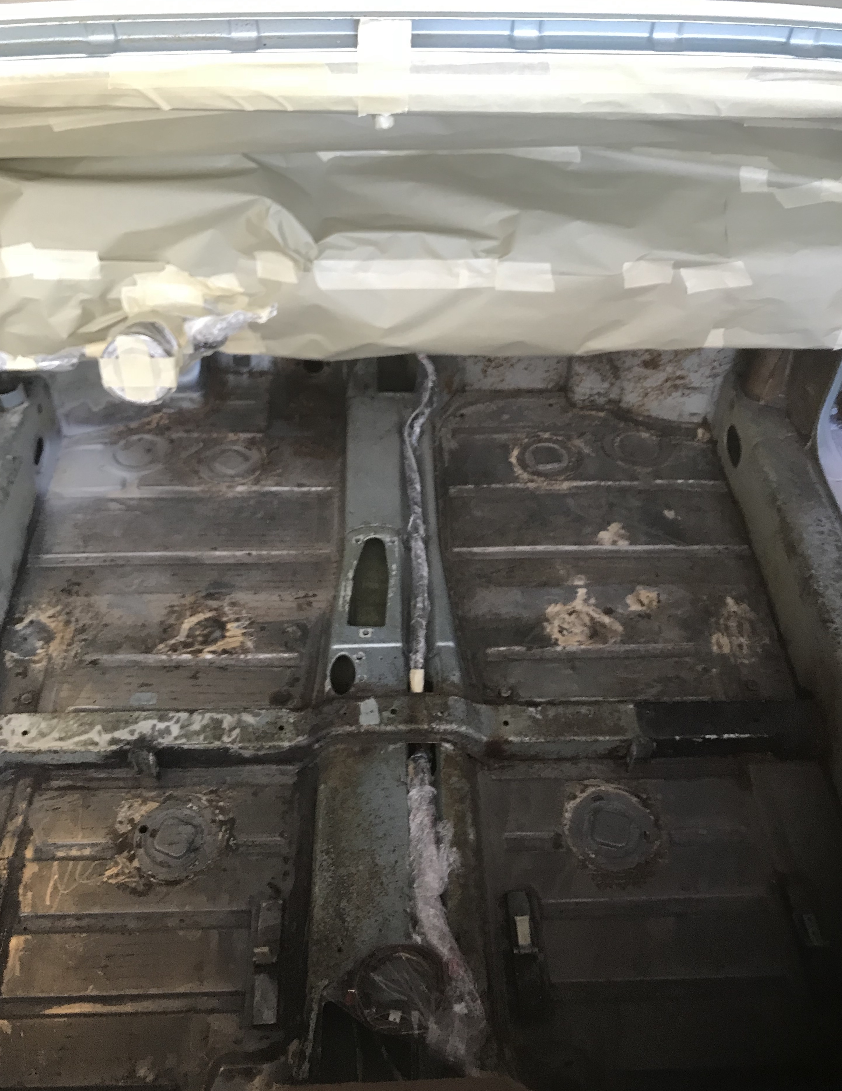

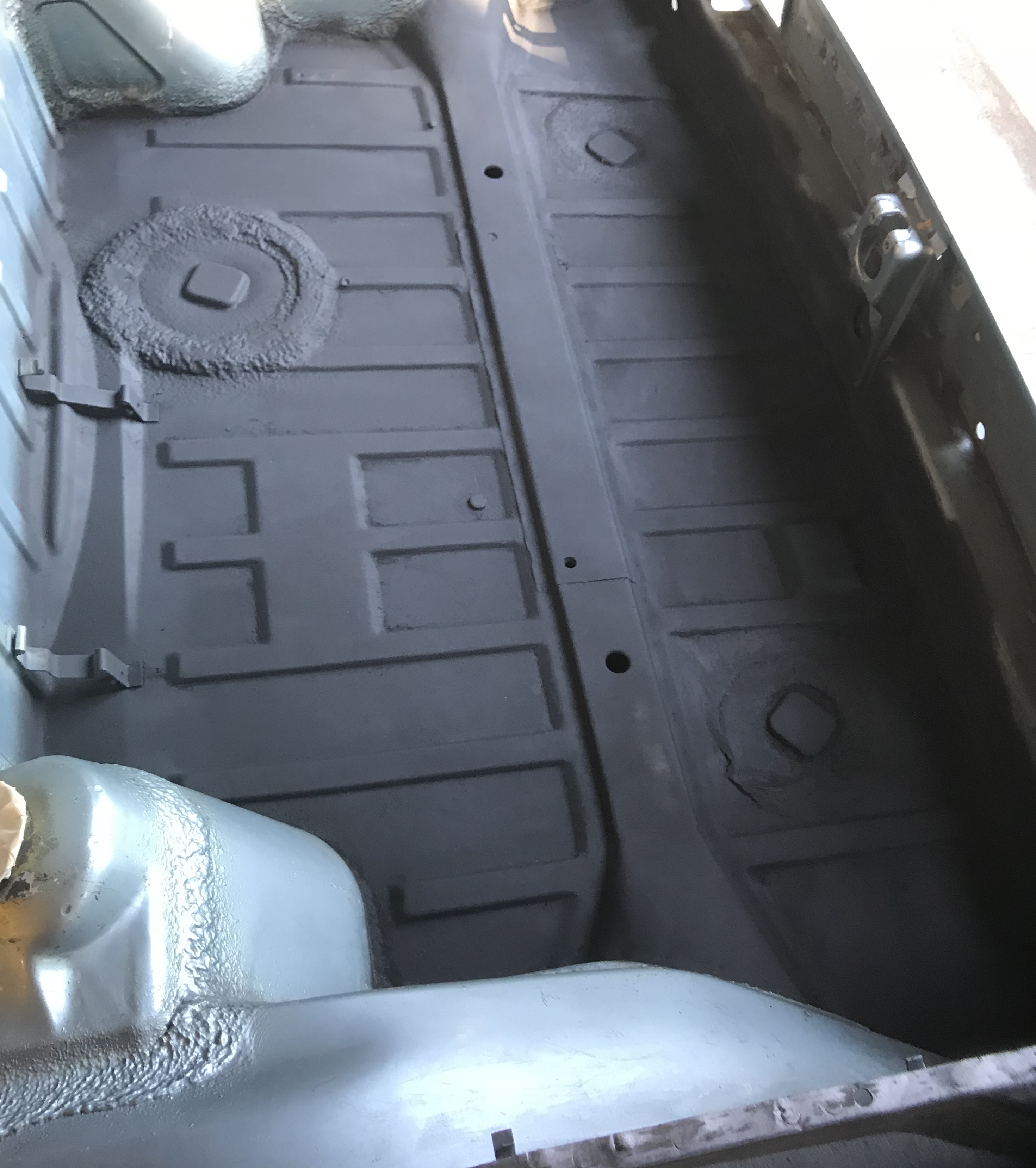

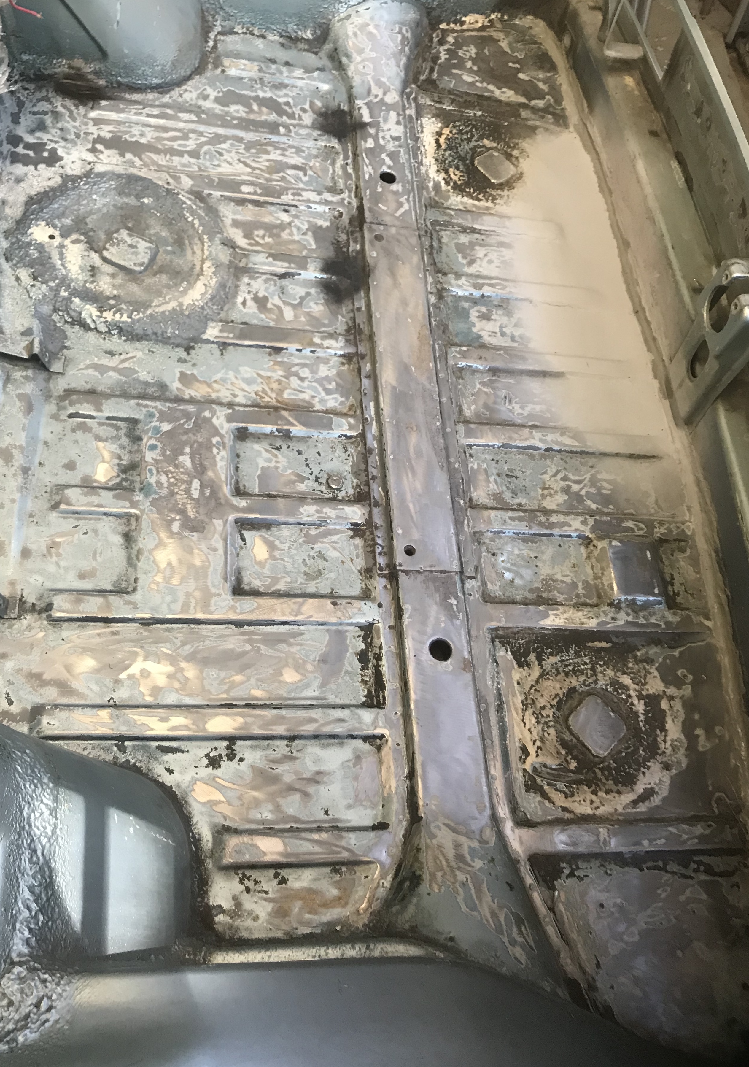

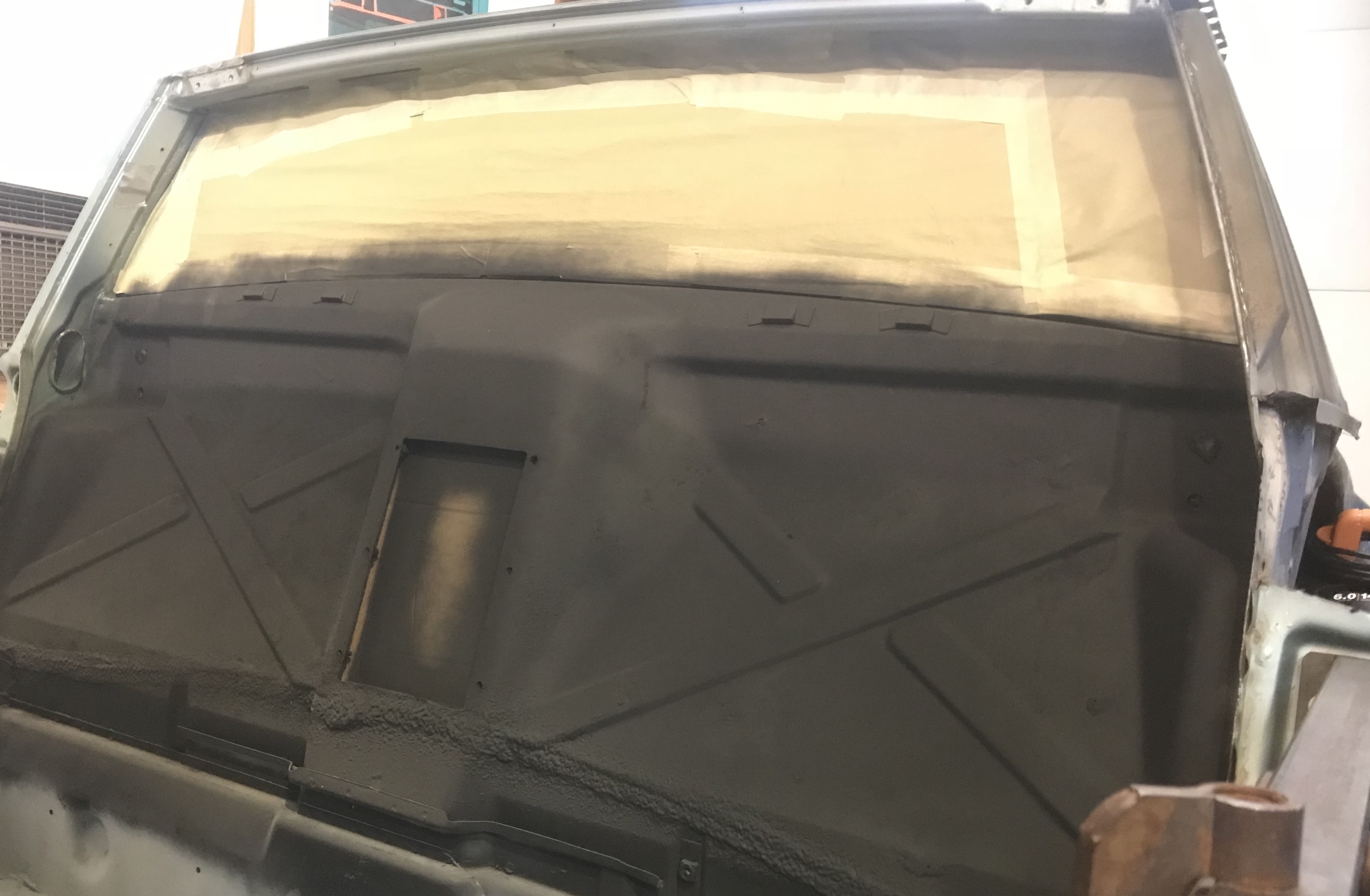

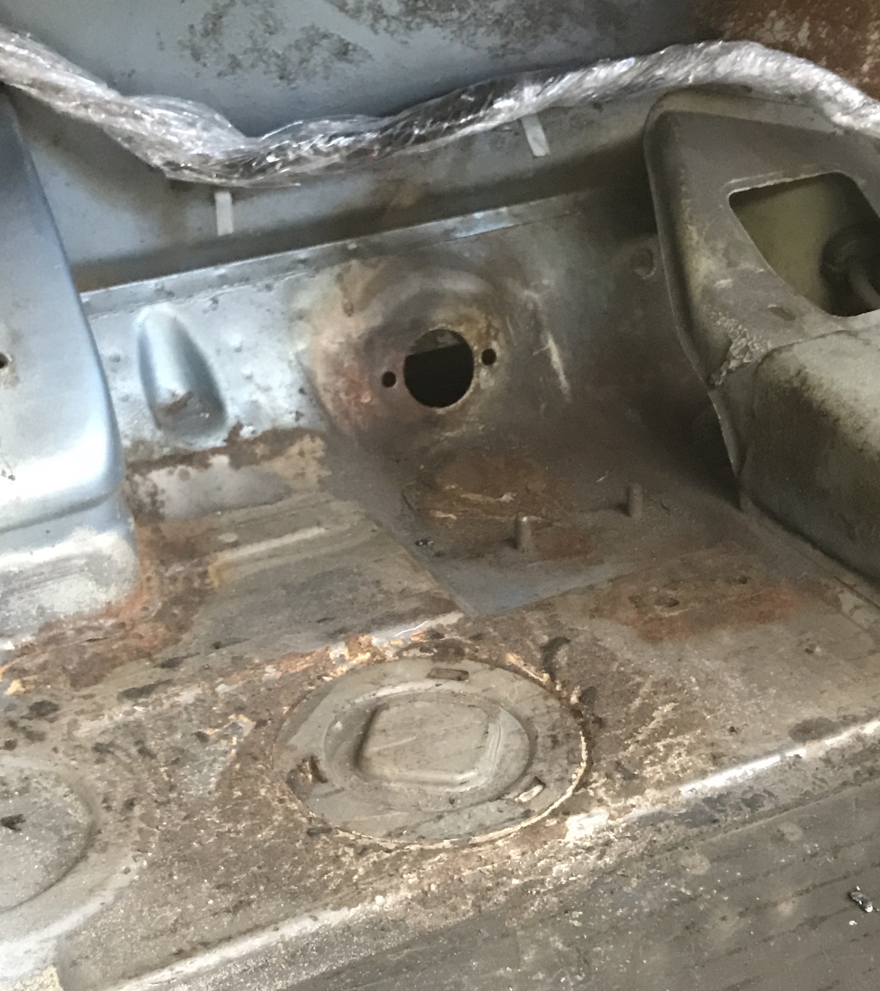

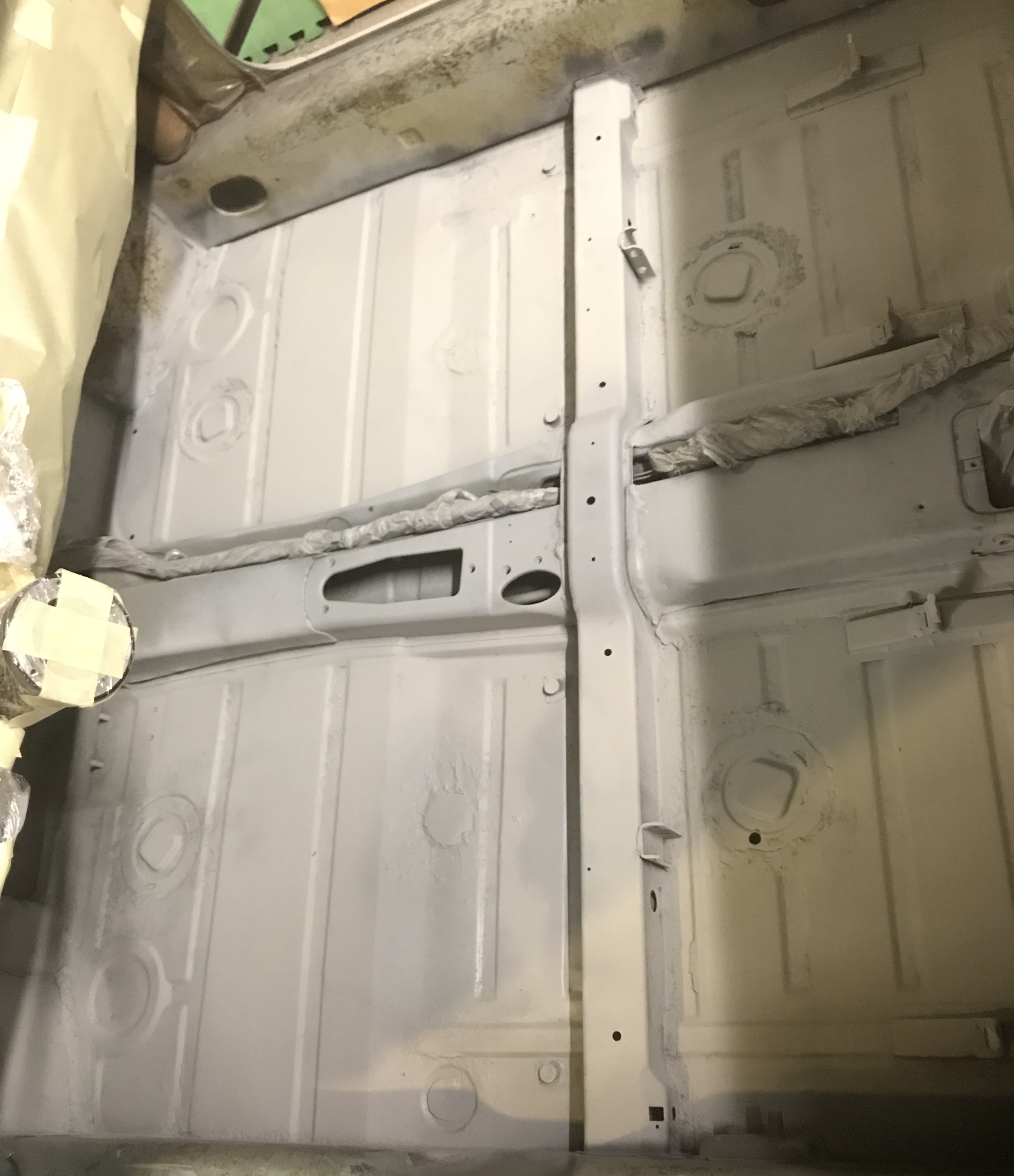

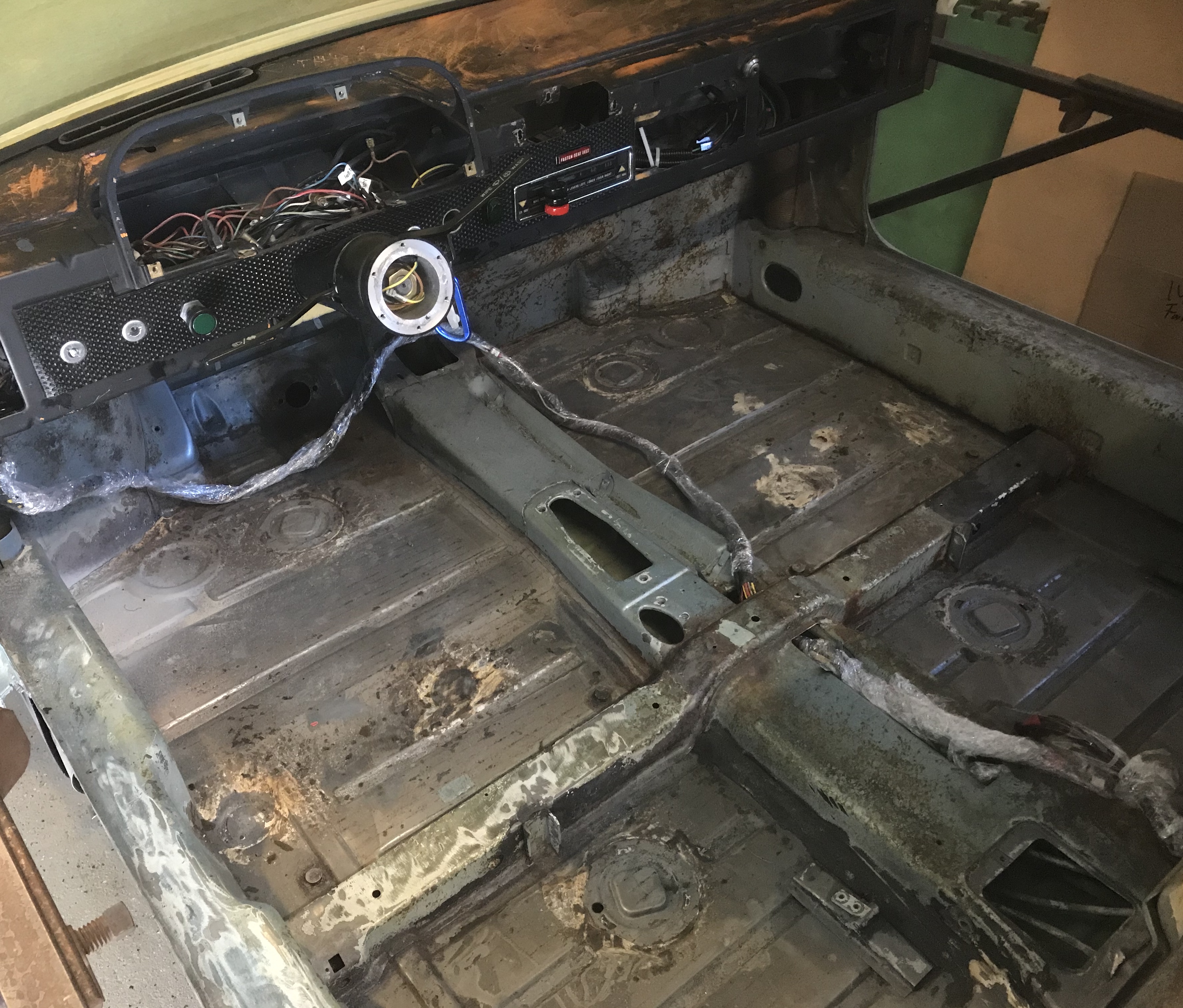

Ok, trying not to piss off Brent anymore (IMG:style_emoticons/default/biggrin.gif) while working on 944s...the weather in PA finally broke. I can breathe again. Damn humidity!
So did some masking around windows and dash to protect them.
Started sanding and cleaning the cabin floor and trunk floor so I could epoxy prime them.
Dion
post Jul 9 2018, 06:24 PM
Post #294
RN
Posts: 2,839
From: Audubon,PA
Member No.: 2,766
Cabin
Dion

Trunk
Dion
post Jul 9 2018, 06:26 PM
Post #296
RN
Posts: 2,839
From: Audubon,PA
Member No.: 2,766
Application of the epoxy primer.

Trunk primed
Dion
post Jul 9 2018, 06:29 PM
Post #298
RN
Posts: 2,839
From: Audubon,PA
Member No.: 2,766
& finally interior firewall primed.
