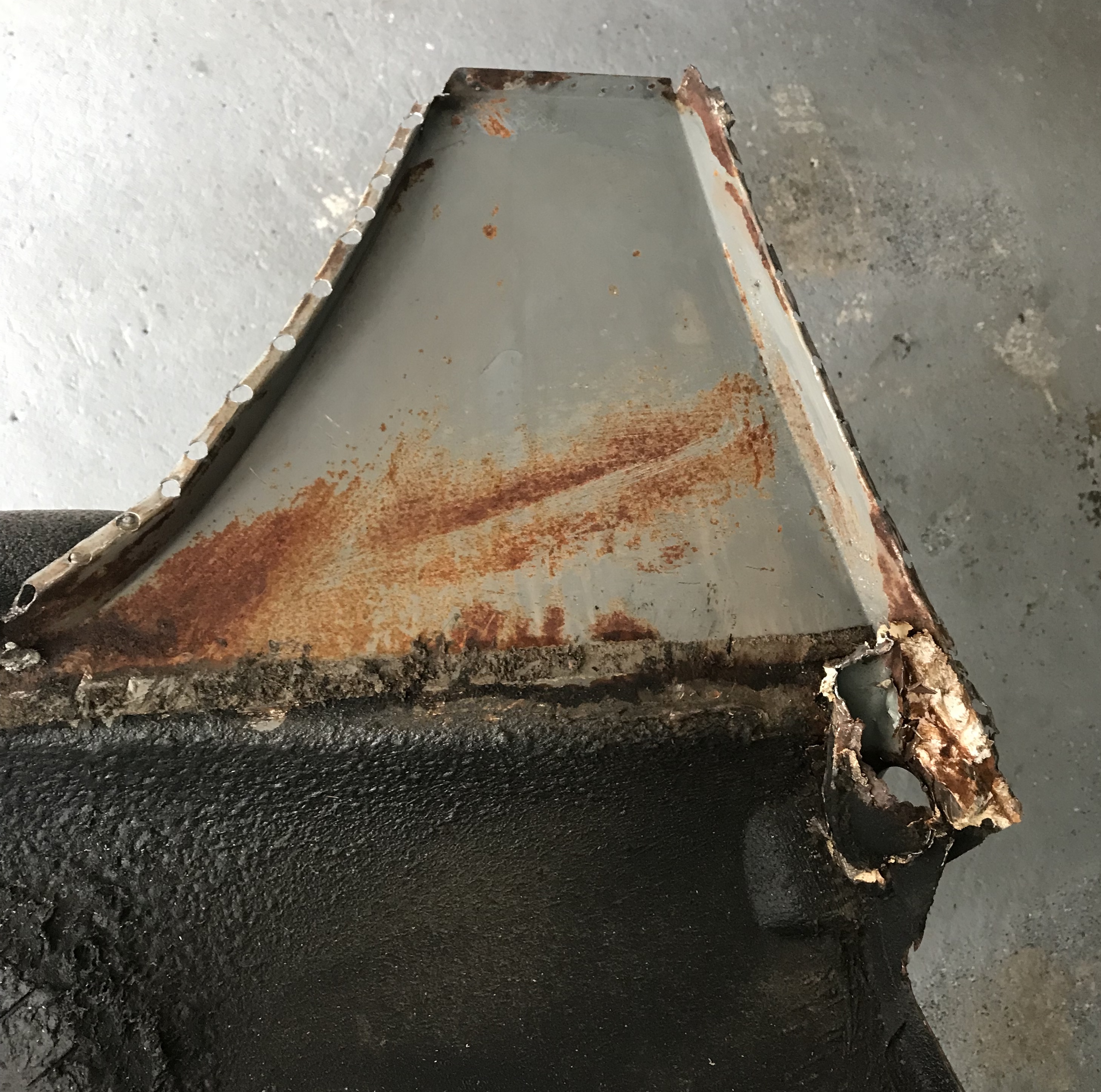

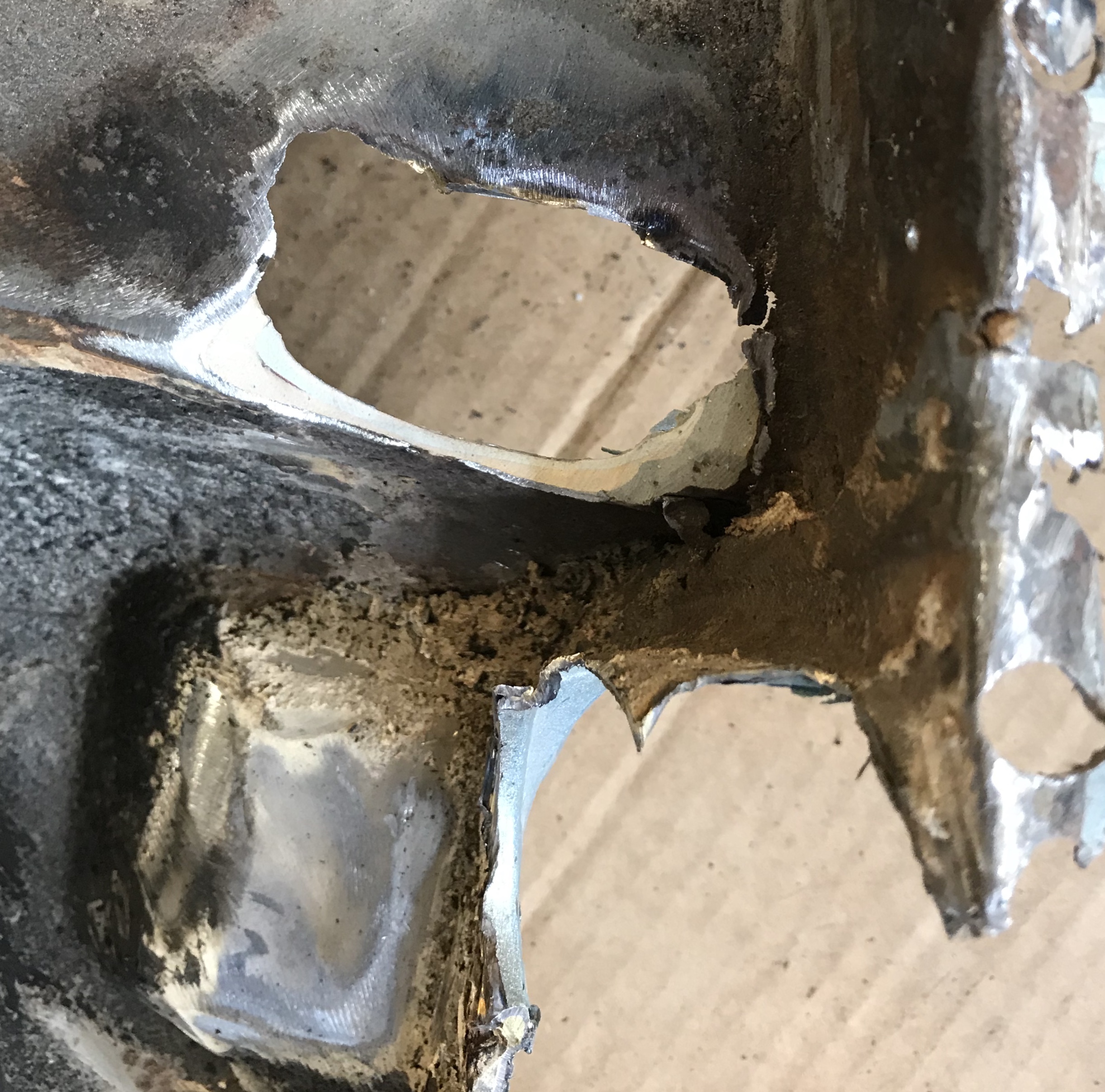

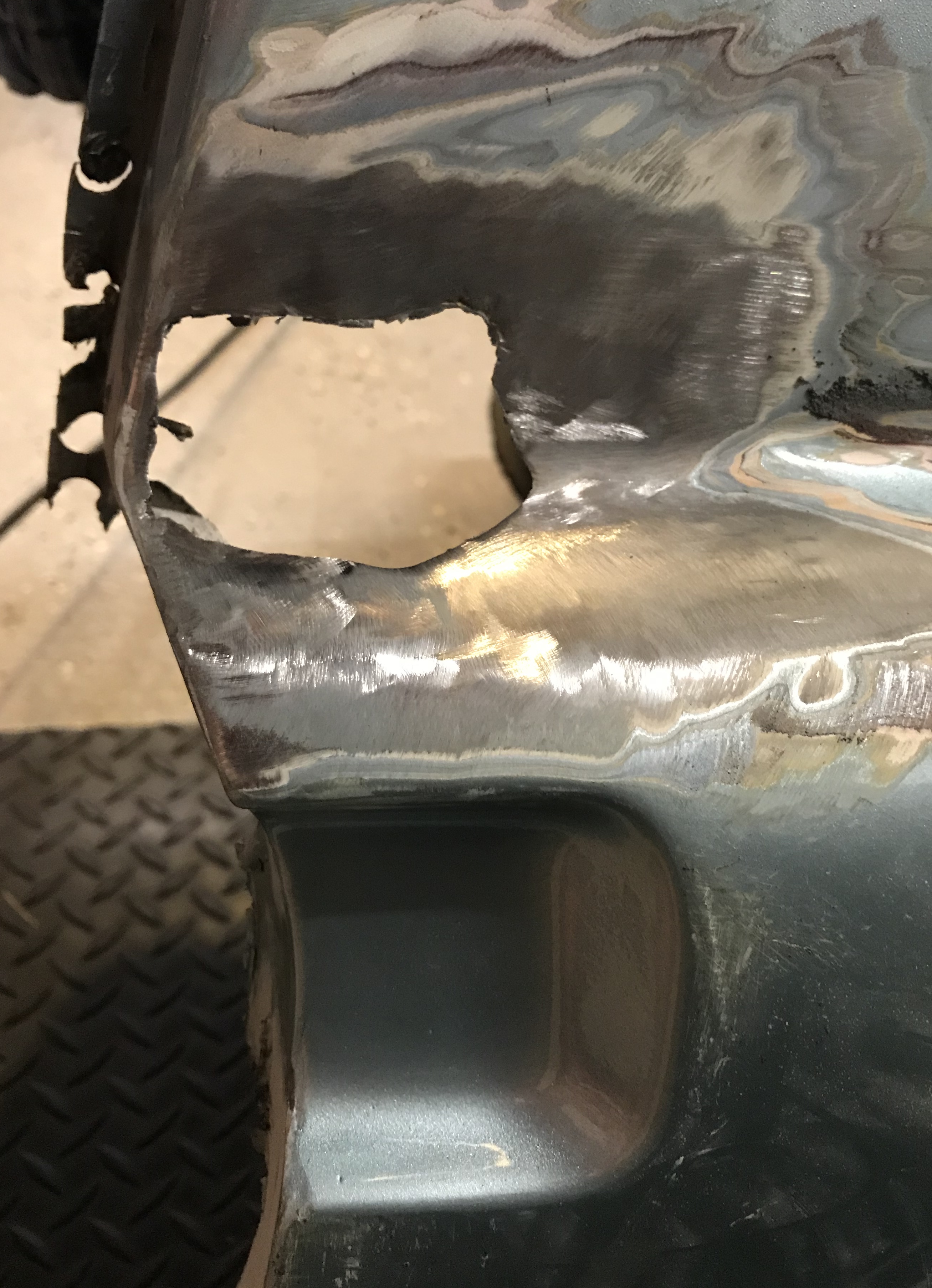

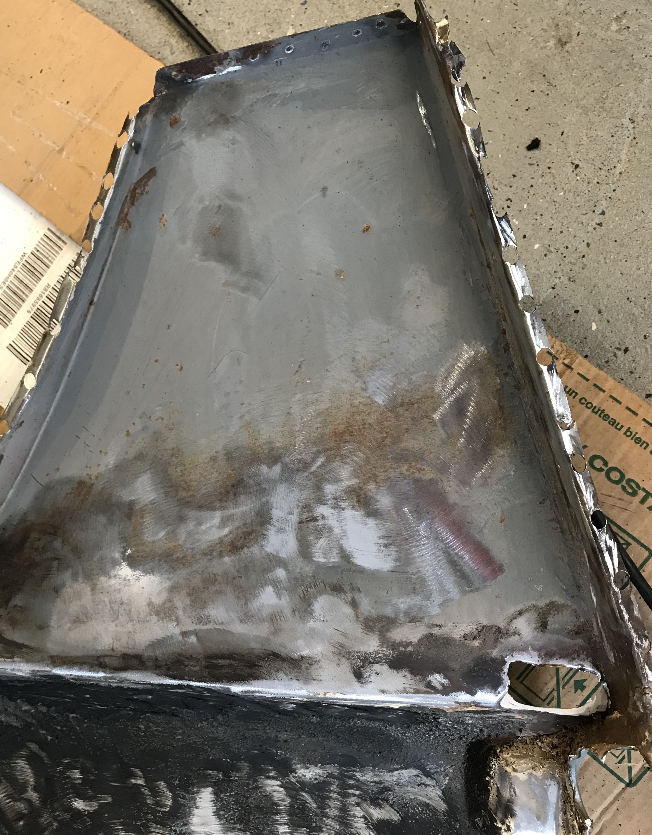

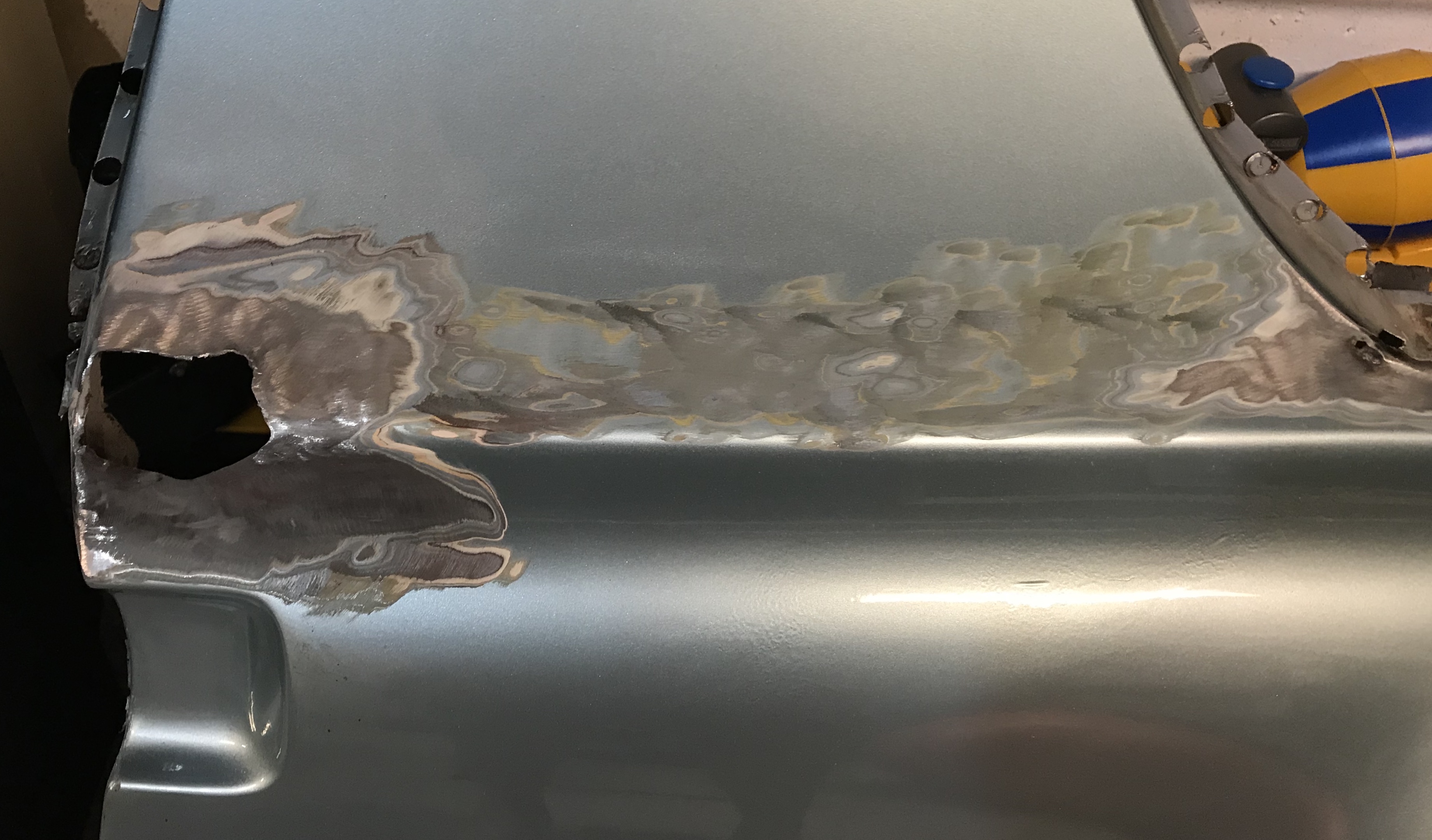

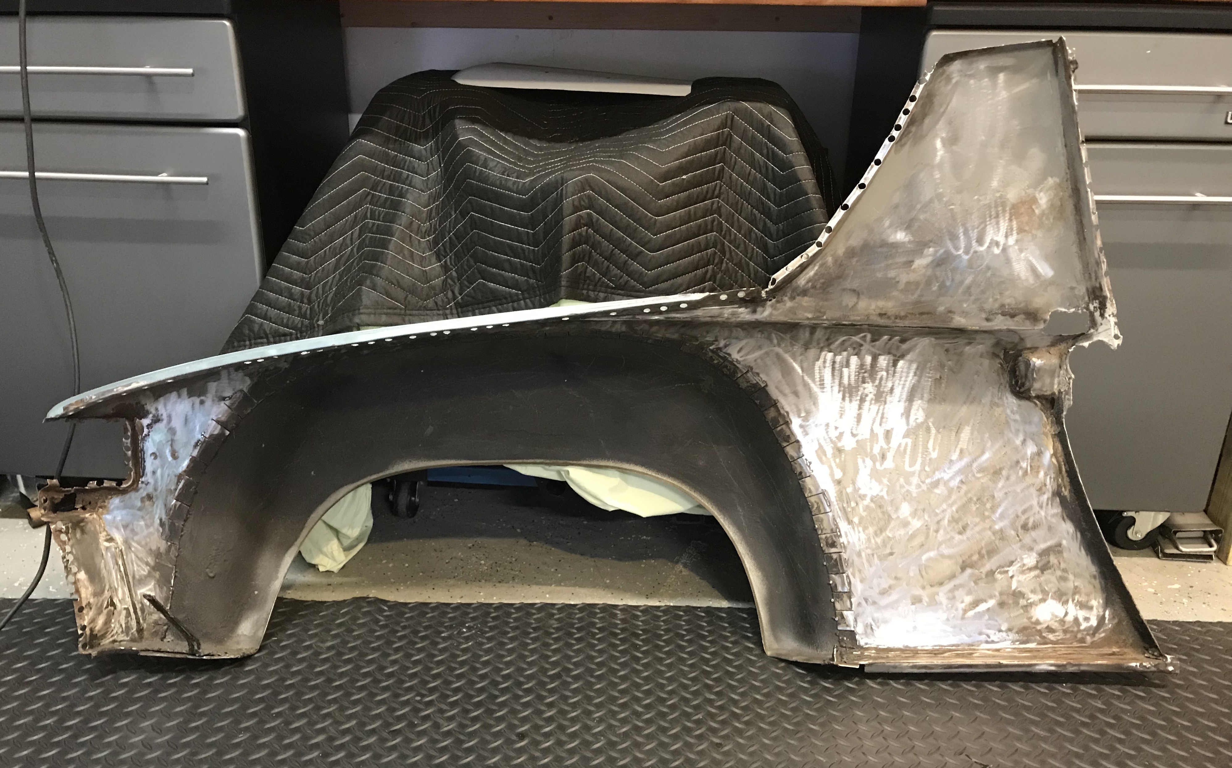

Started prep work on drivers rear quarter panel.
Removed the undercoating with heat gun, left the flare alone since that is
paint and not tar. Found yet another hole lurking. Apparently minding its own
business till the flap disc found him out. Oh how I miss my complete car.....
Oh well we are here to make it whole again. There is a nice chunk missing by the tail lamp I’ll be utilizing a good piece from Garold. I’ll prep
that next week hopefully. So some before and after pics:

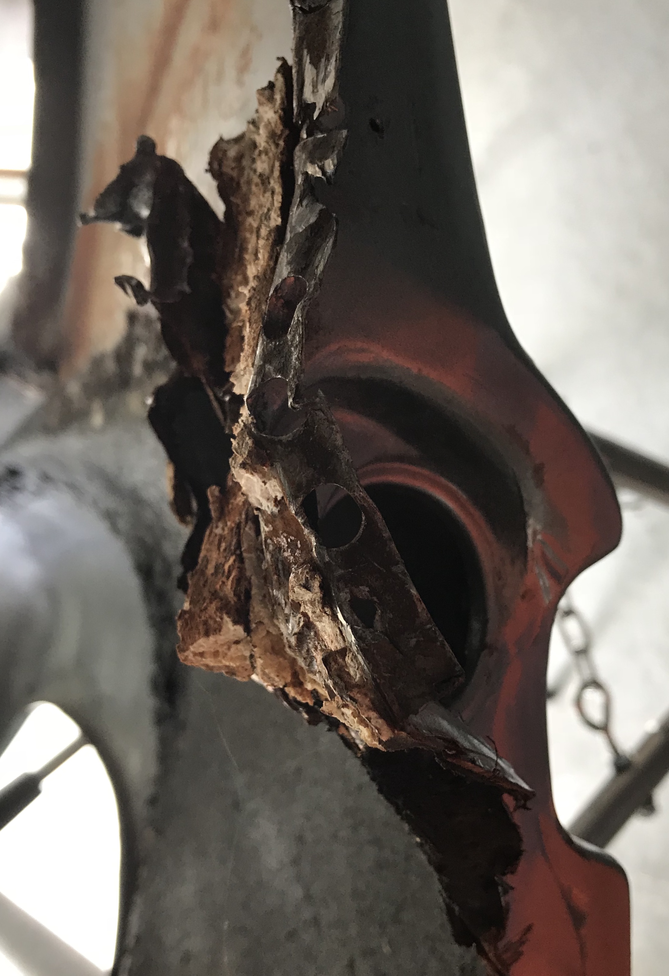

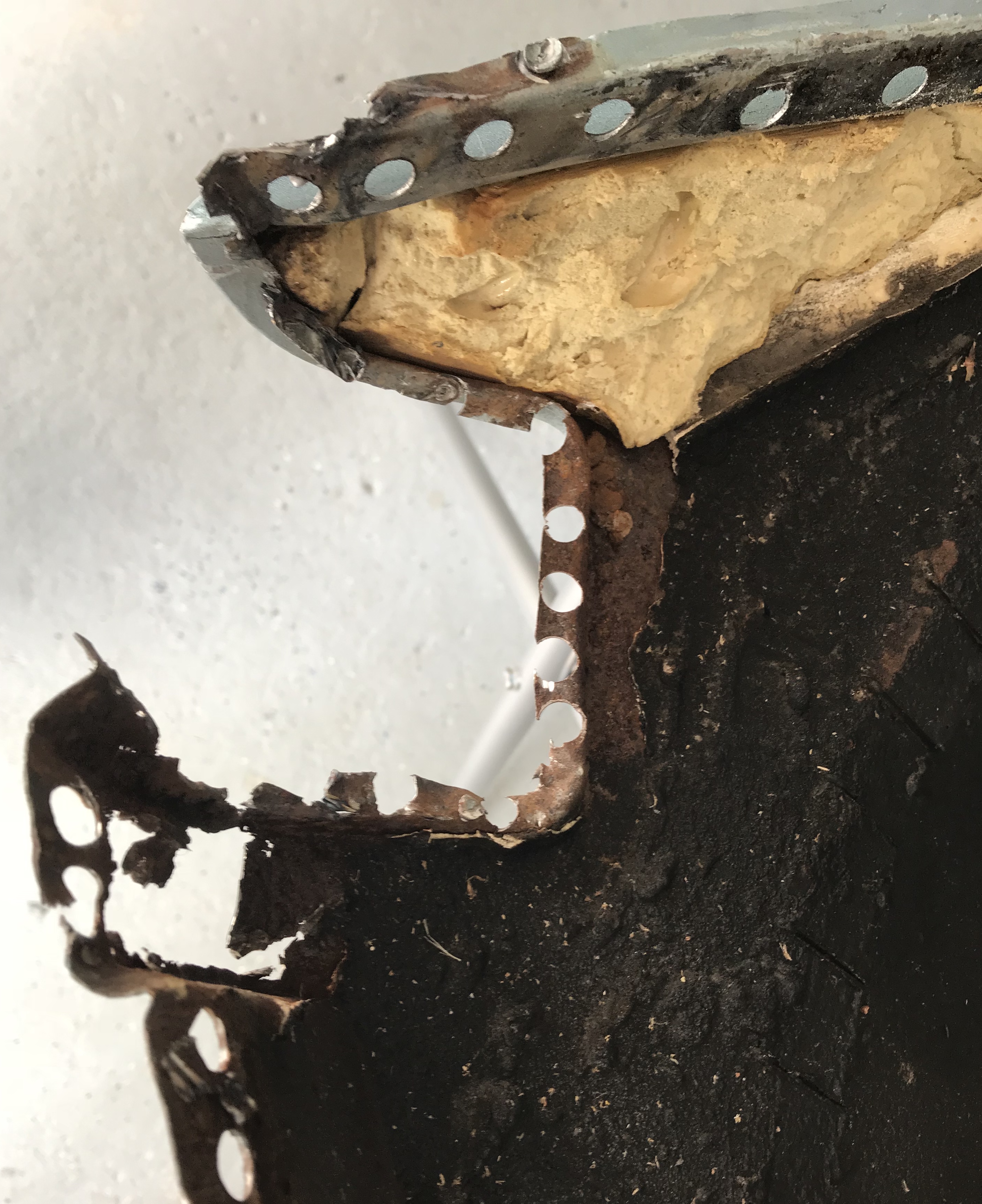

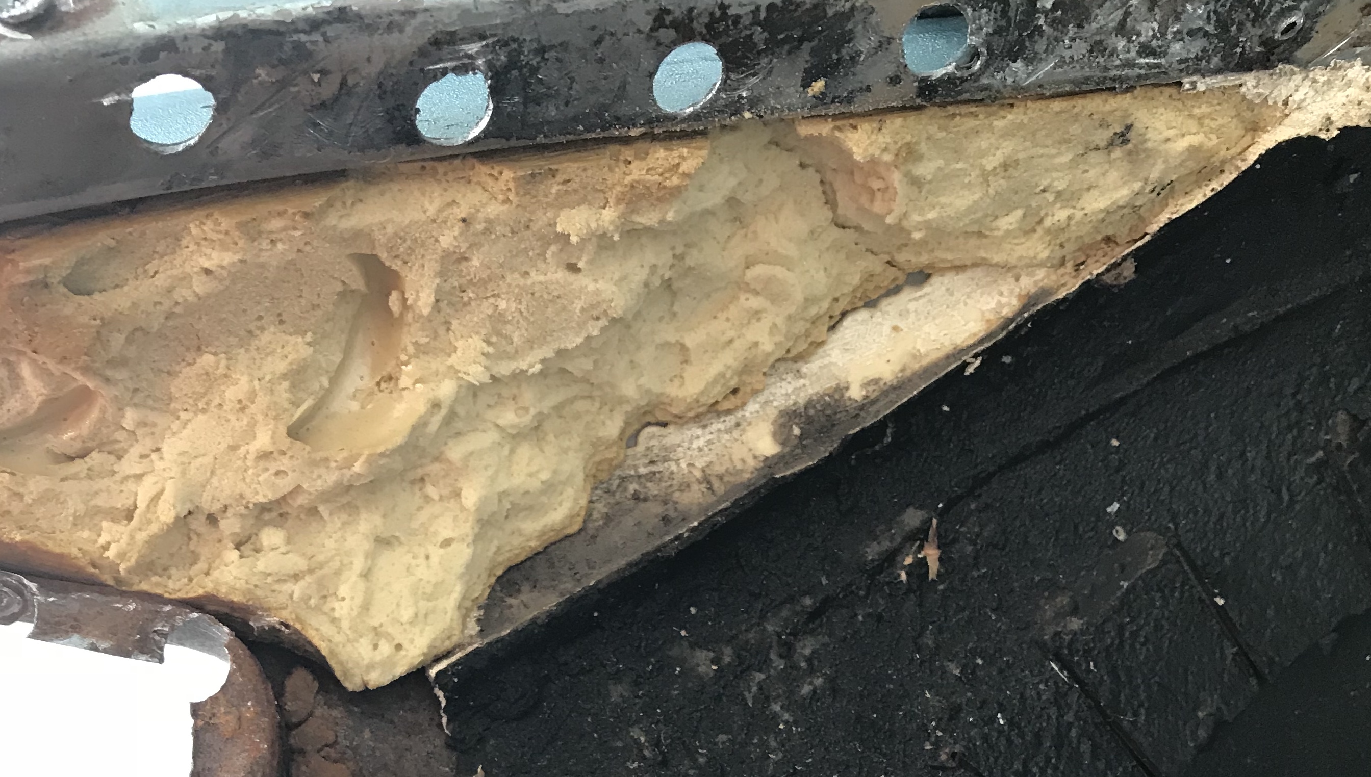

Unbelievable the amount of seam sealer that was around the snorkel. Dug that out.
I have a new snorkel and slam panel for that area.

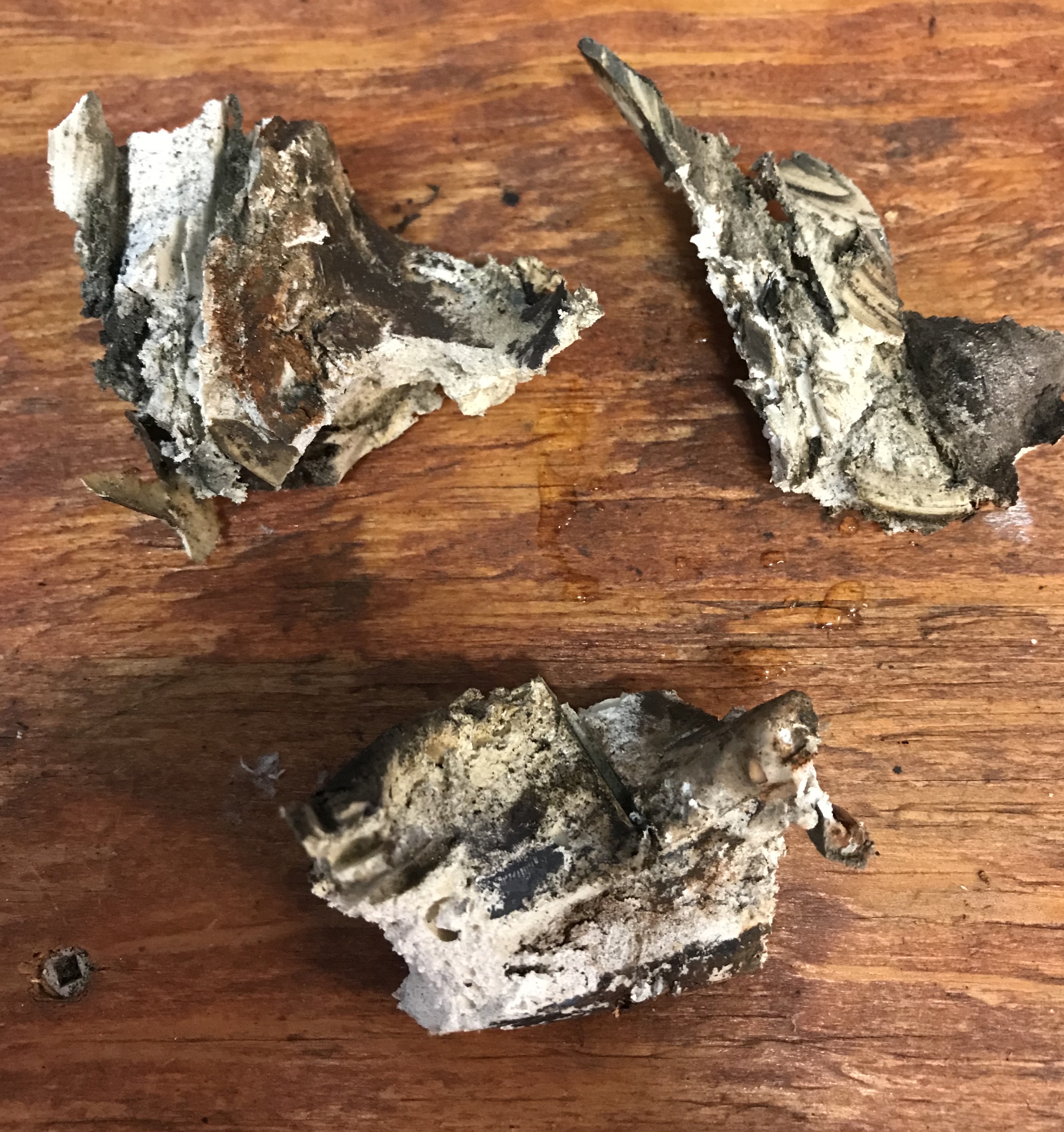

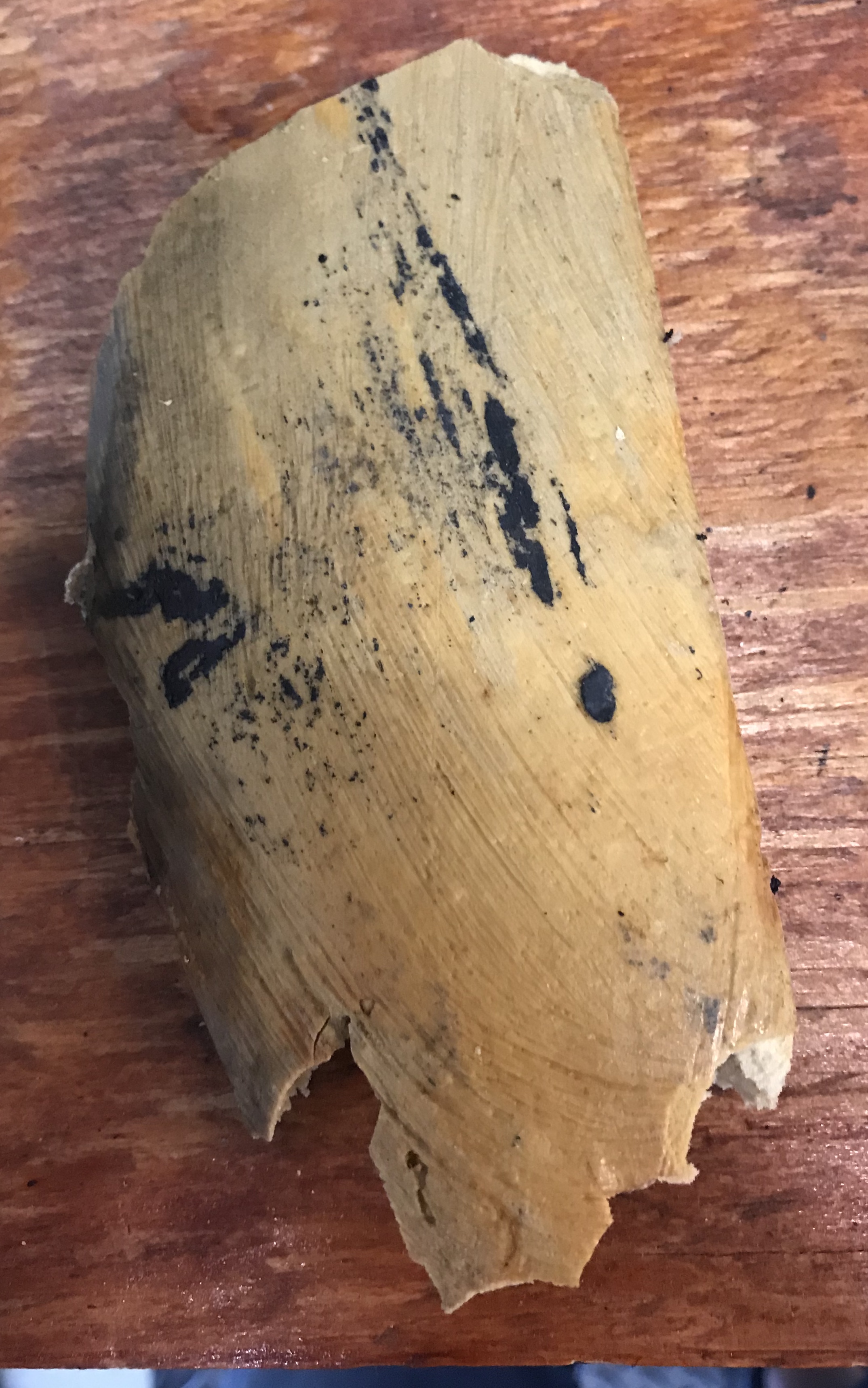

Removed the ..urethane? Foam from the panel as well.

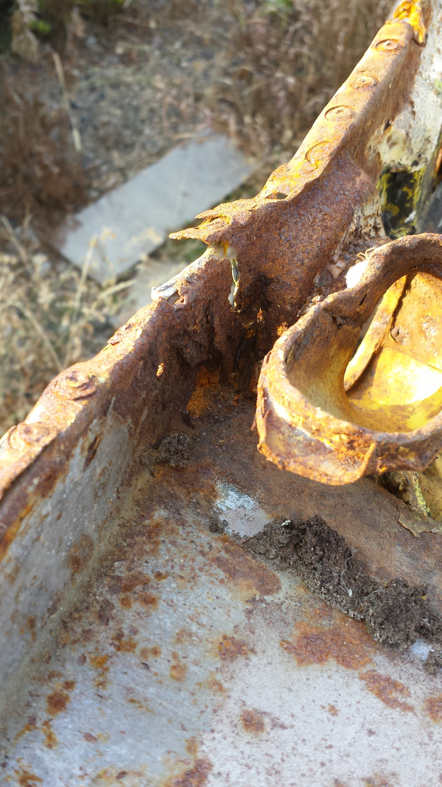

Ugly metal:

Foam

Sail panel damage

Panel

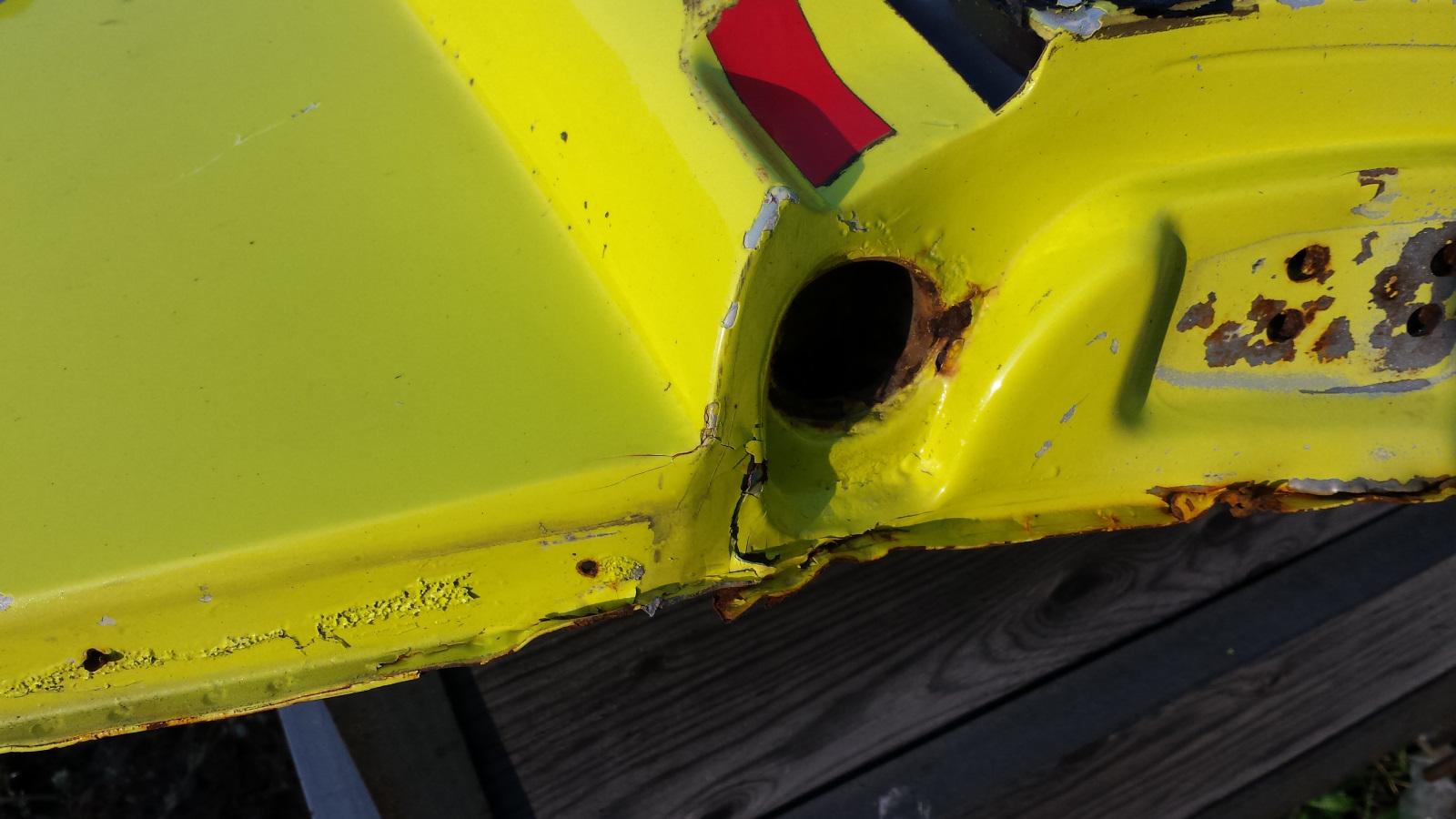

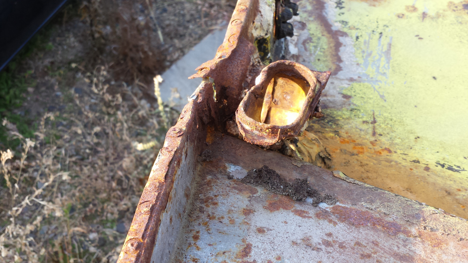

If any one has a compromised panel but not in the area I need to repair
would gladly like to have it so I could make a patch.
Let me know what ya have...thanks for checking in.

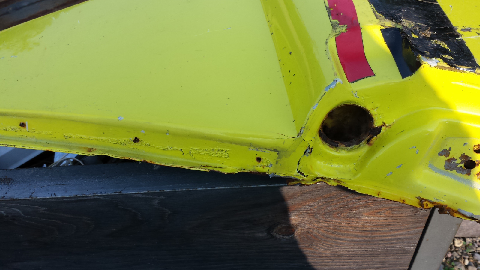

Let me check the scrap pile in the morning. I had a pair of extra sail panels that were too far gone to use to replace mine, but I don't remember where they were damaged. We might get lucky.

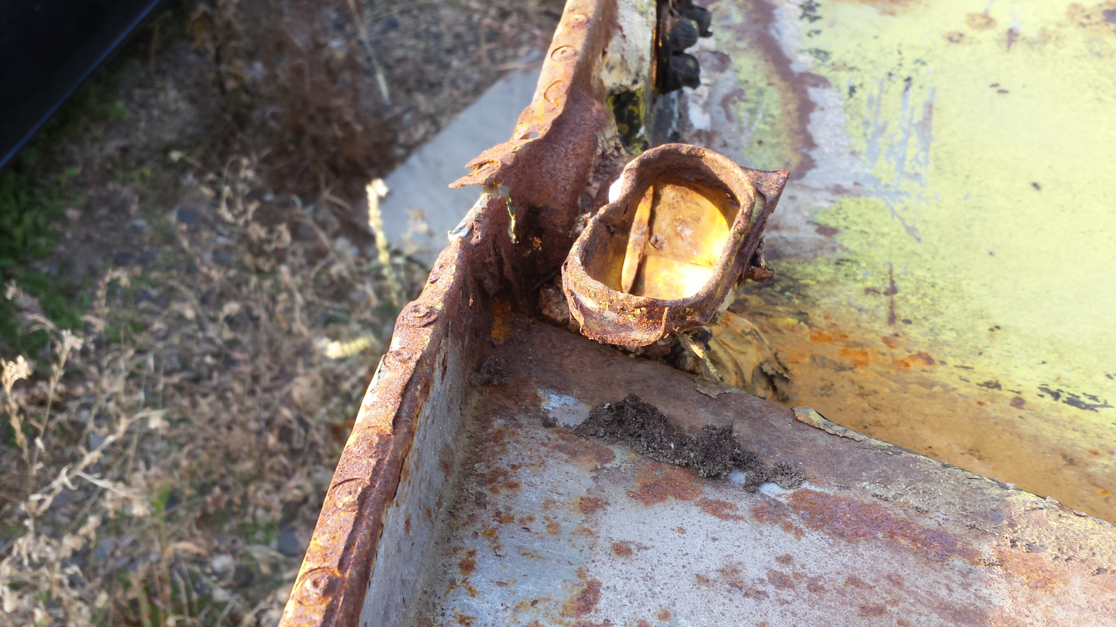

Pulled it out of the scrap pile. It's a bit crusty under vent tube but looks like it might clean up and cover the area you need to patch. If you think it has promise, I can hit it with the media blaster this evening and send more pics. If you decide you want it, pm me with your address and how much you want cut off and it's yours.
Dion
post Aug 3 2018, 09:14 AM
Post #314
RN
Posts: 2,839
Joined: 16-September 04
From: Audubon,PA
Member No.: 2,766
Brent that should do the trick. Will save me trying to duplicate that contour. Thanks buddy!
