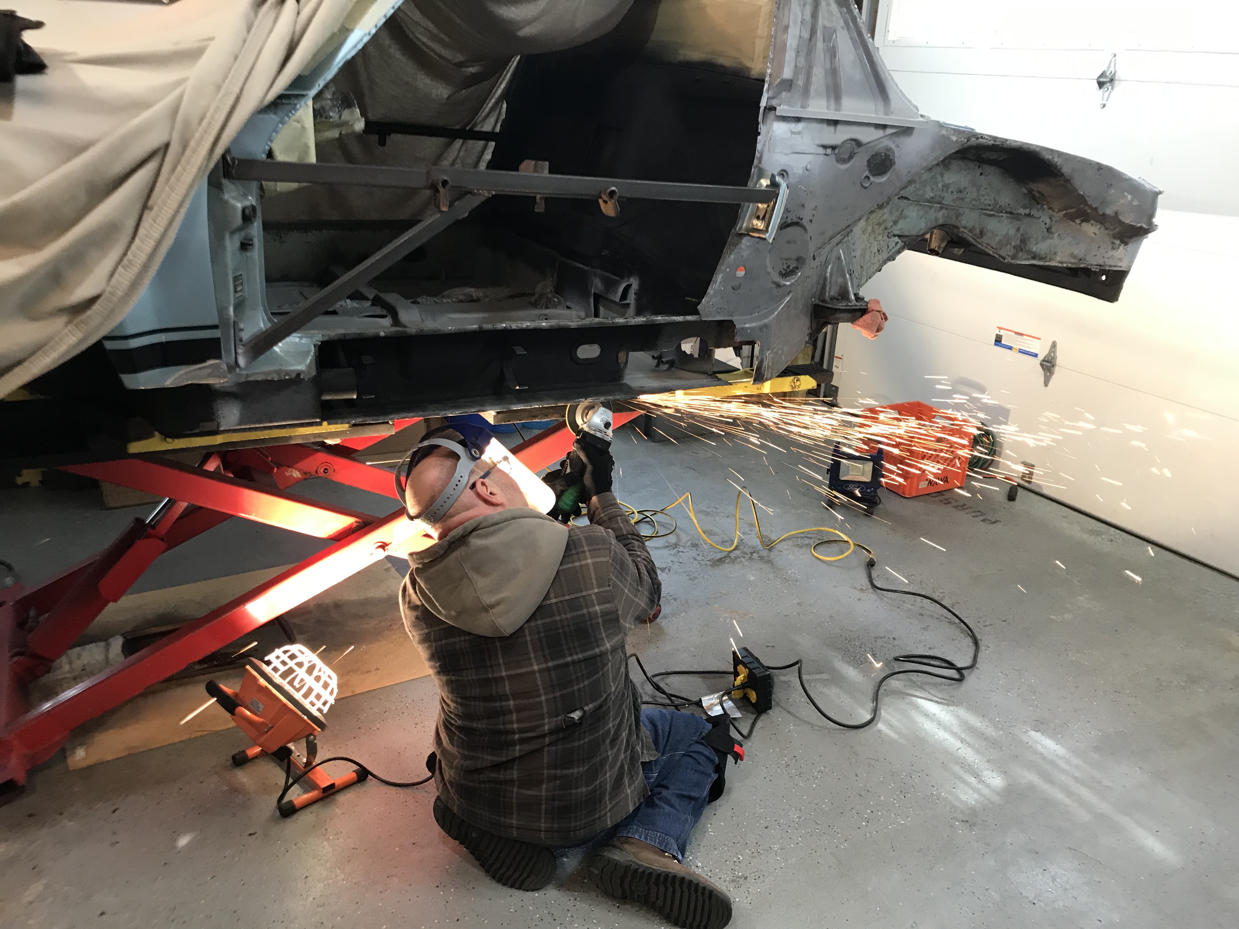

Dion hard at work removing a sketchy patch. Attached Image

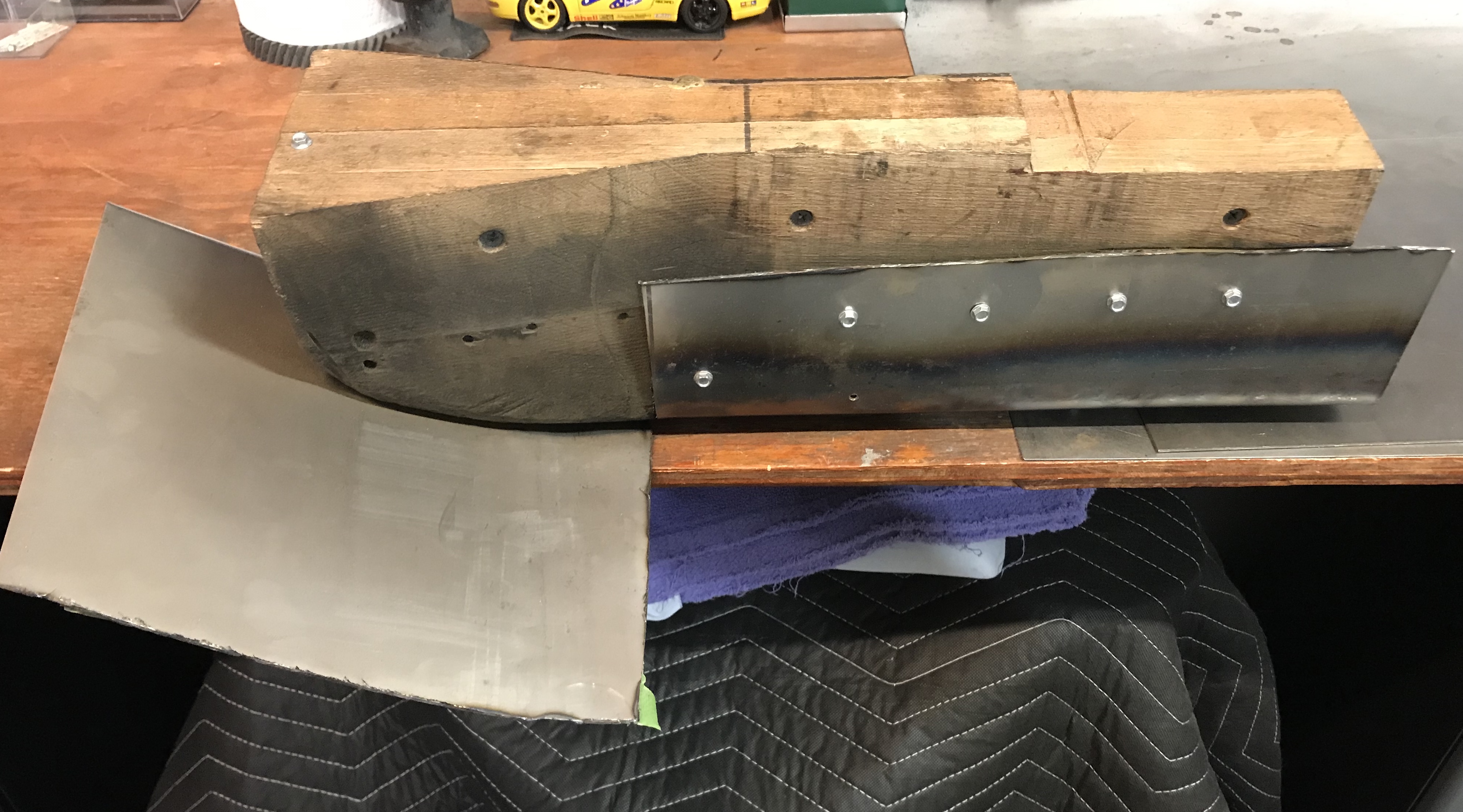

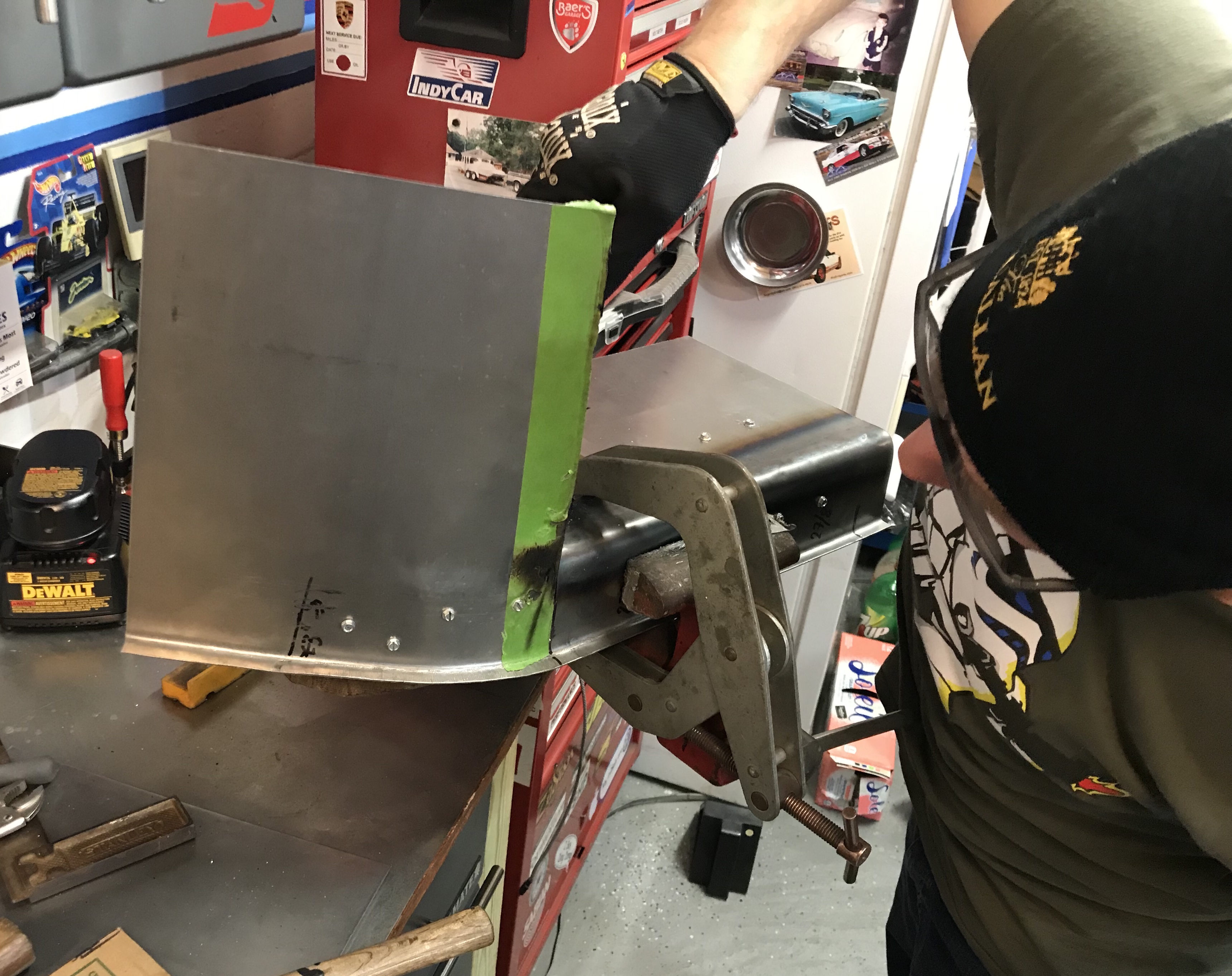

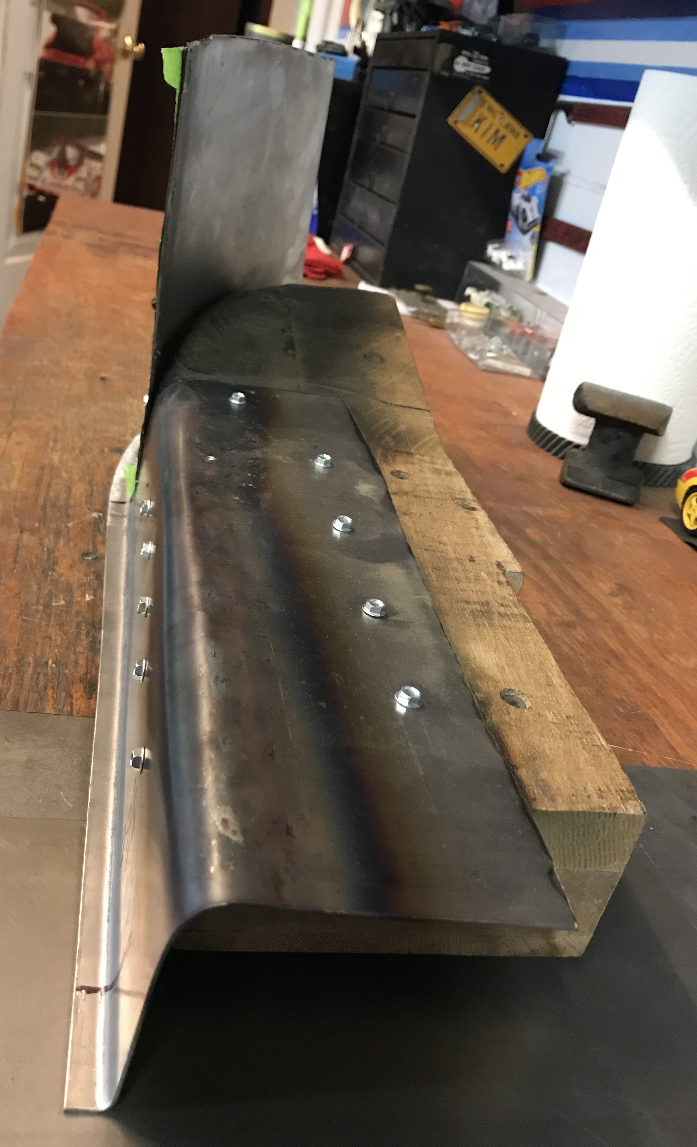

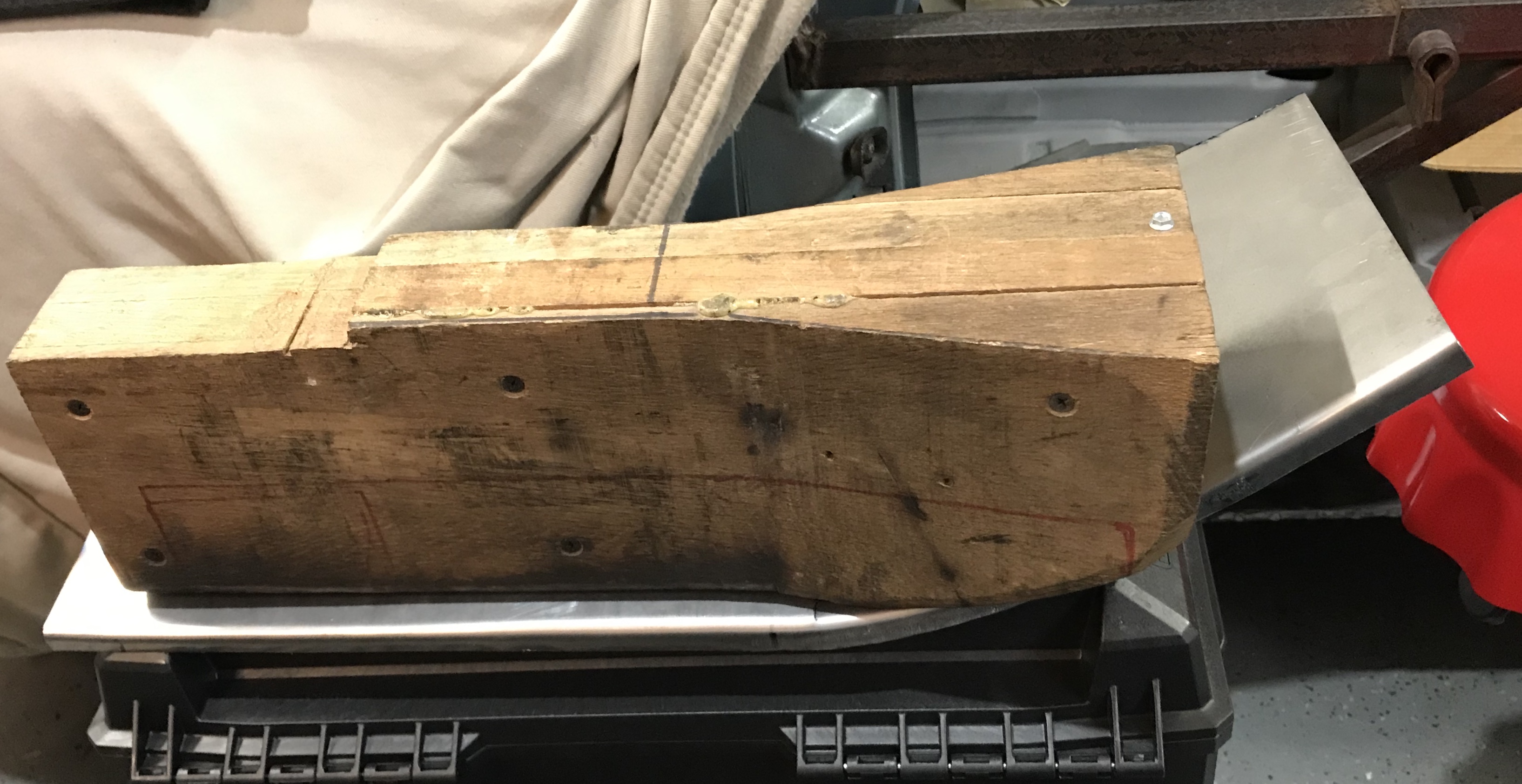

With Dave’s mold making & fabricating skills we started on
the longitudinal. Fantastic work on the outer floor flange and radius.
The steel was screwed onto a buck Dave had made for his 914 repair.
Dion
post Dec 30 2018, 07:46 PM
Post #425
RN
Posts: 2,839
Joined: 16-September 04
From: Audubon,PA
Member No.: 2,766
Securing to buck

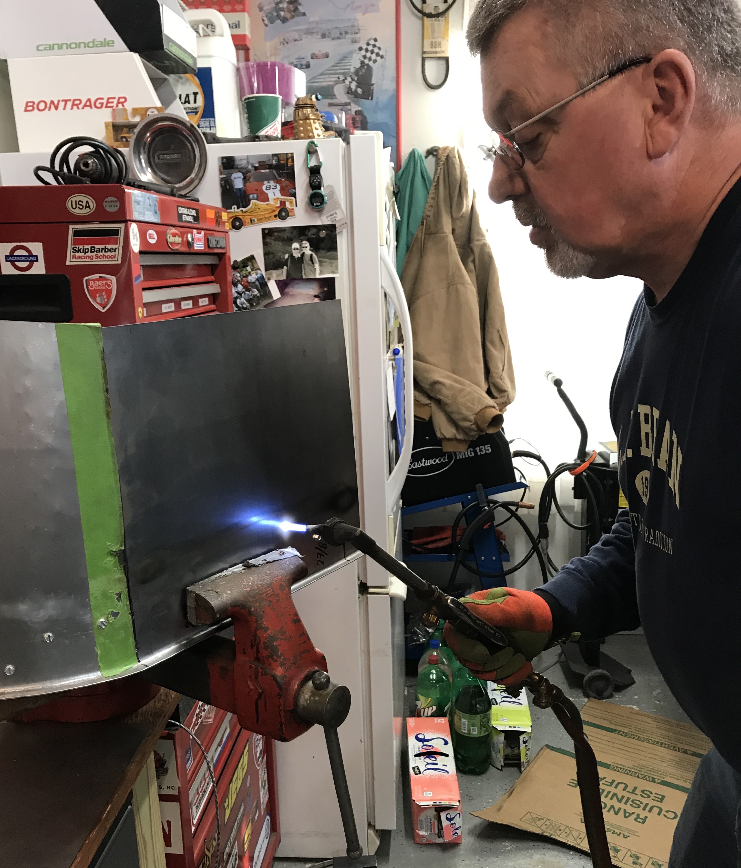

Then the heating with the torch took place to coax that steel into shape.
“ Fire, fire ,yeah ,yeah”
Dion

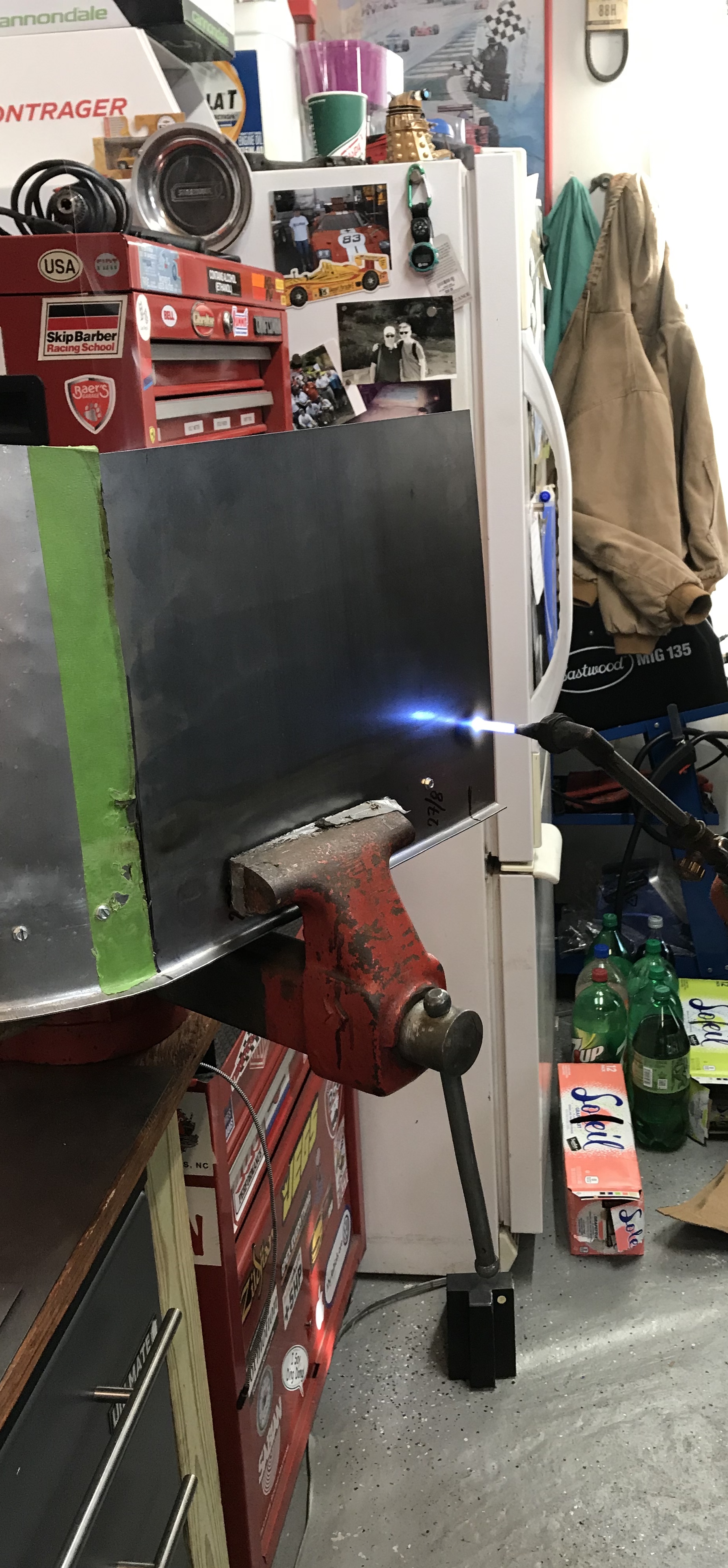

A nice blue-white flame and cherry coloured steel....
Dion

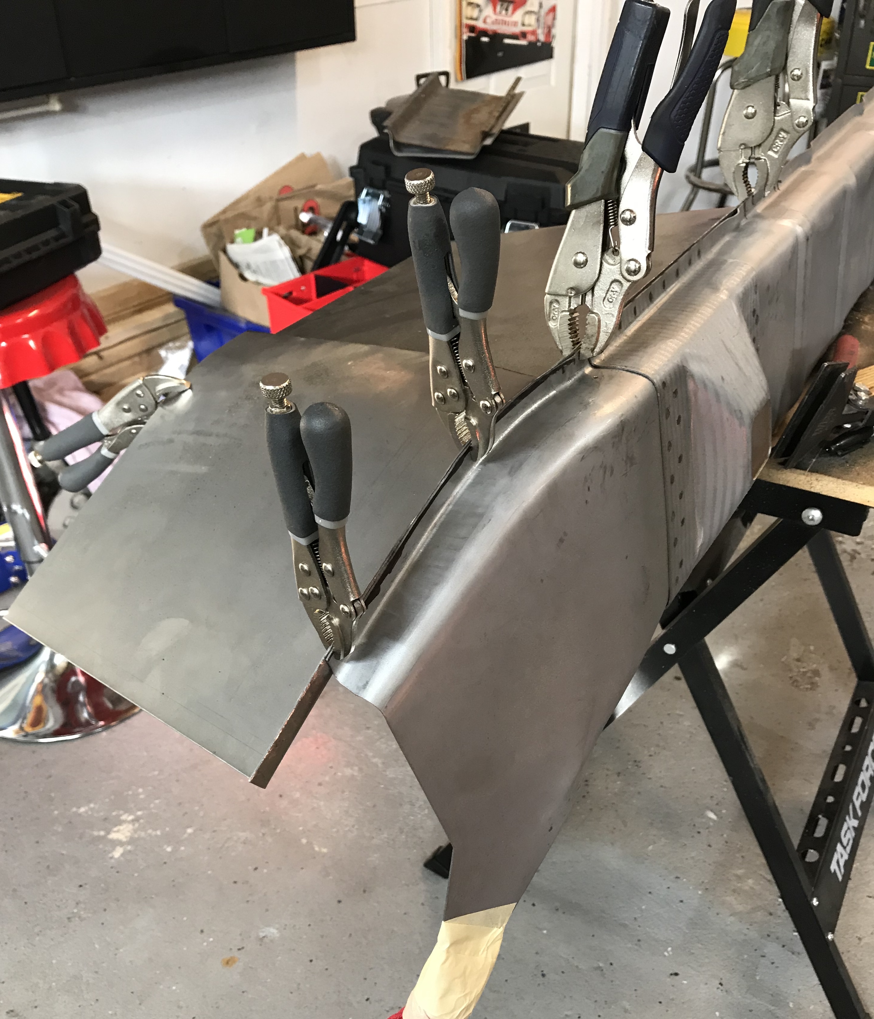

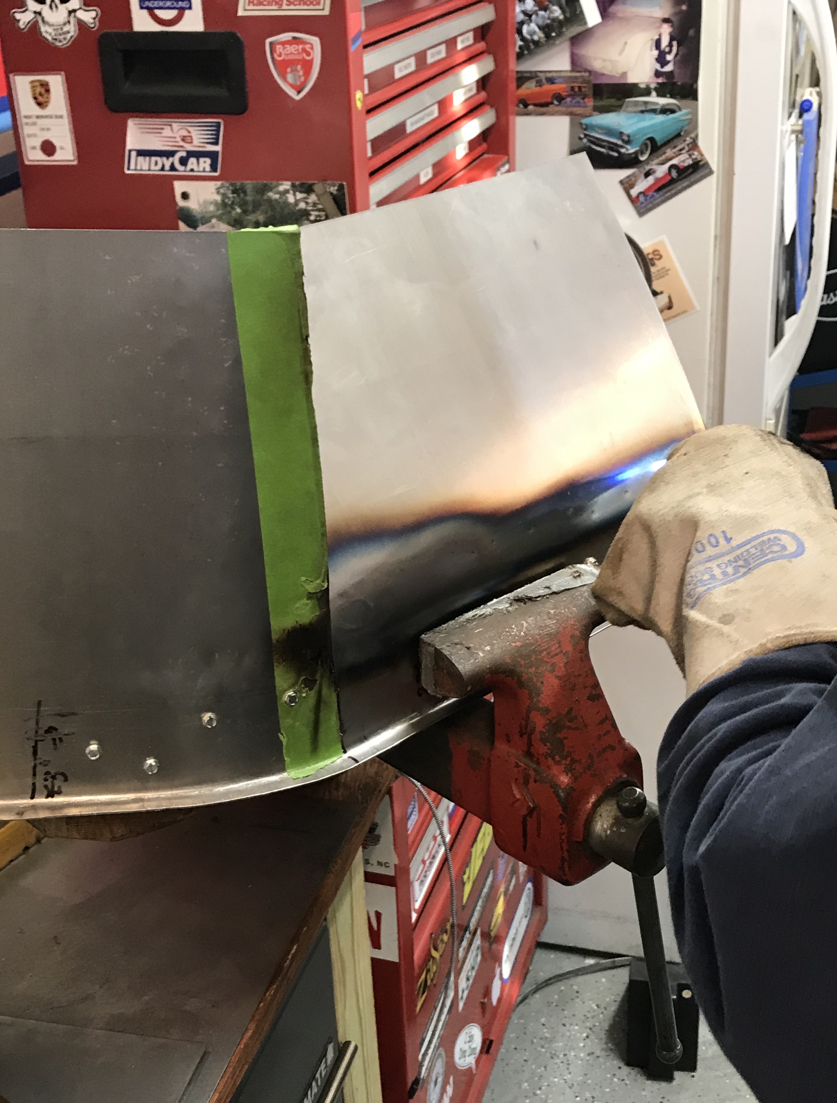

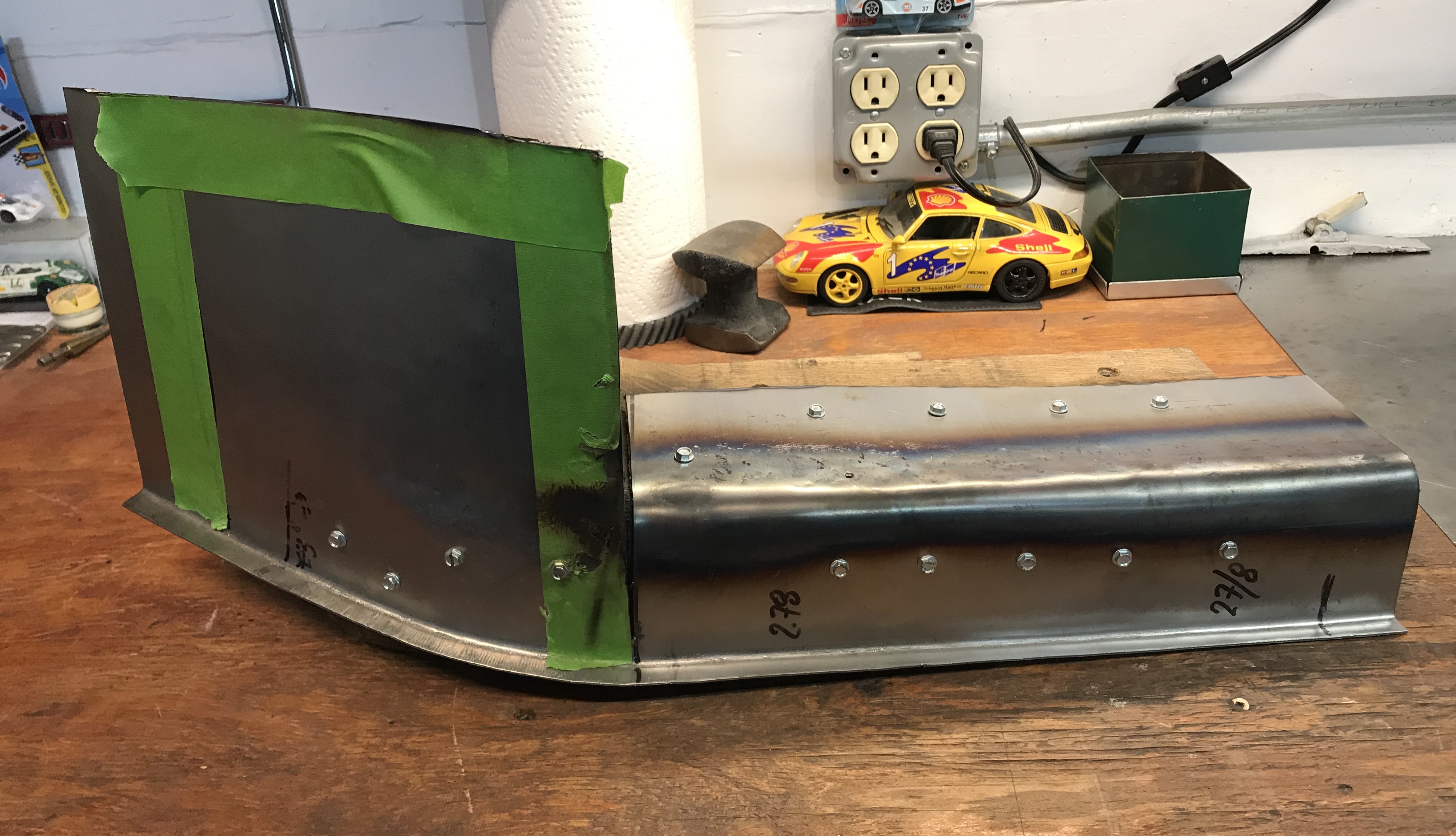

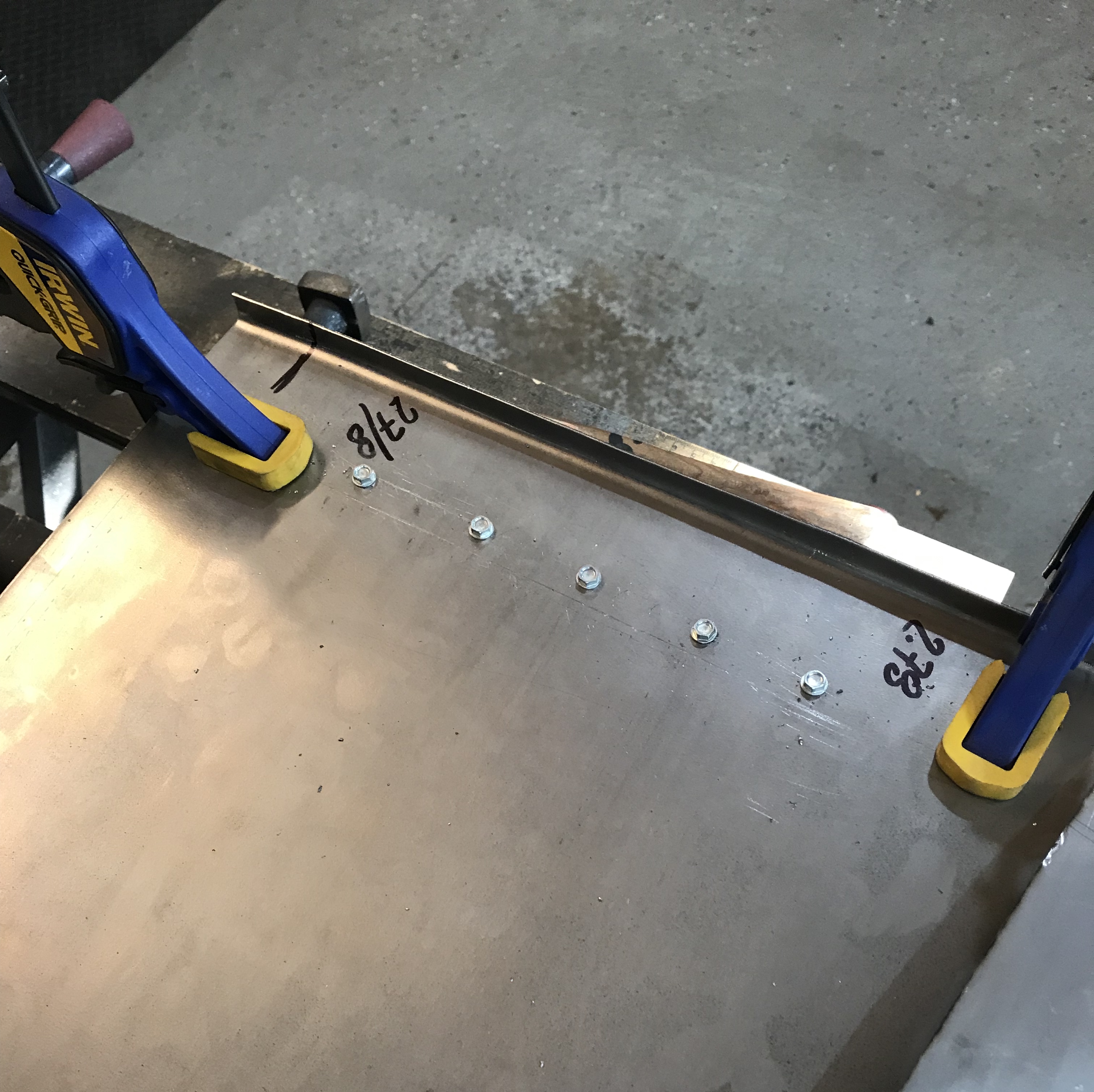

Then the bending and hammering took place and clamped down into position.
Dion

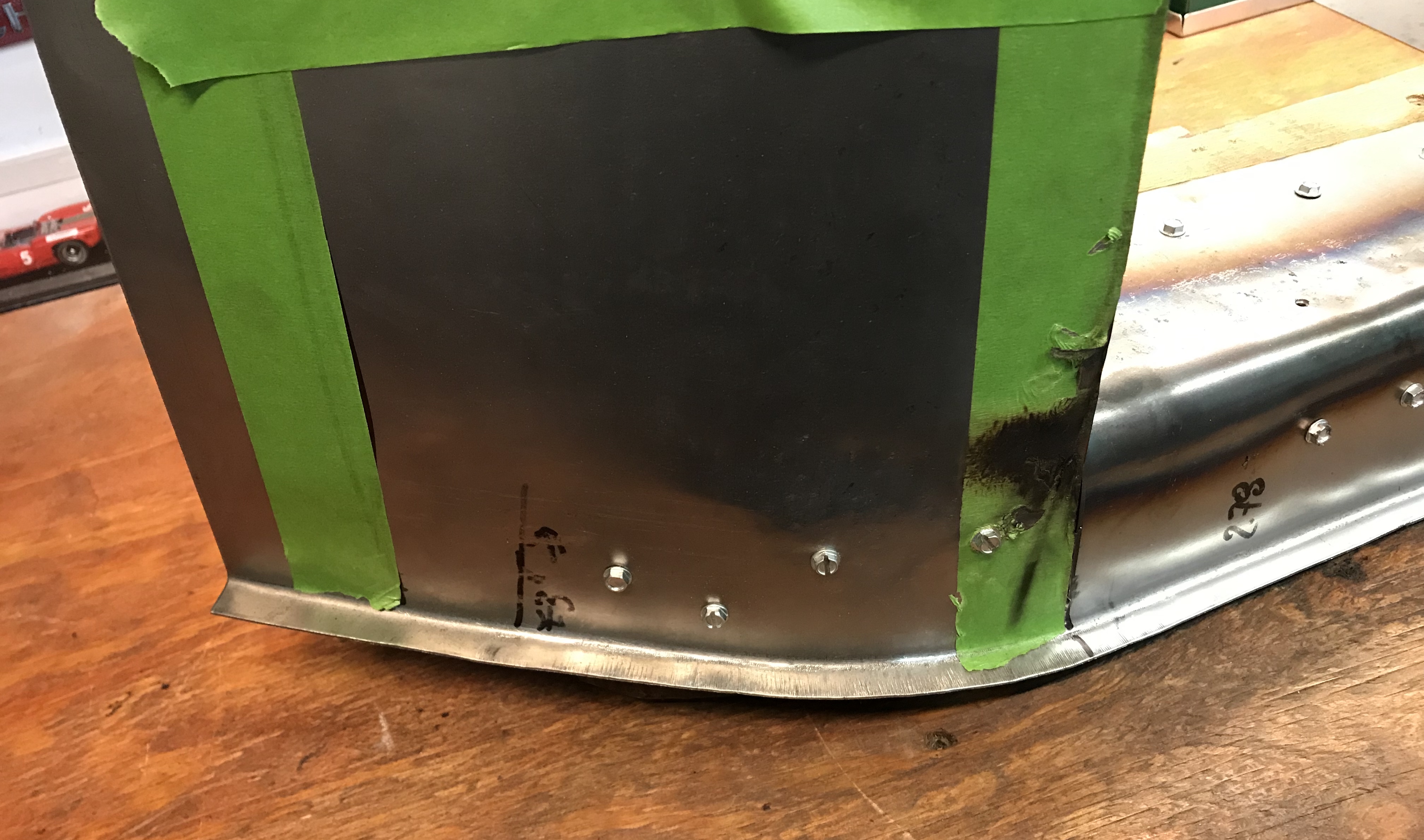

Then the vertically challenged one (me). Secured the bent piece down to the buck.
Dion

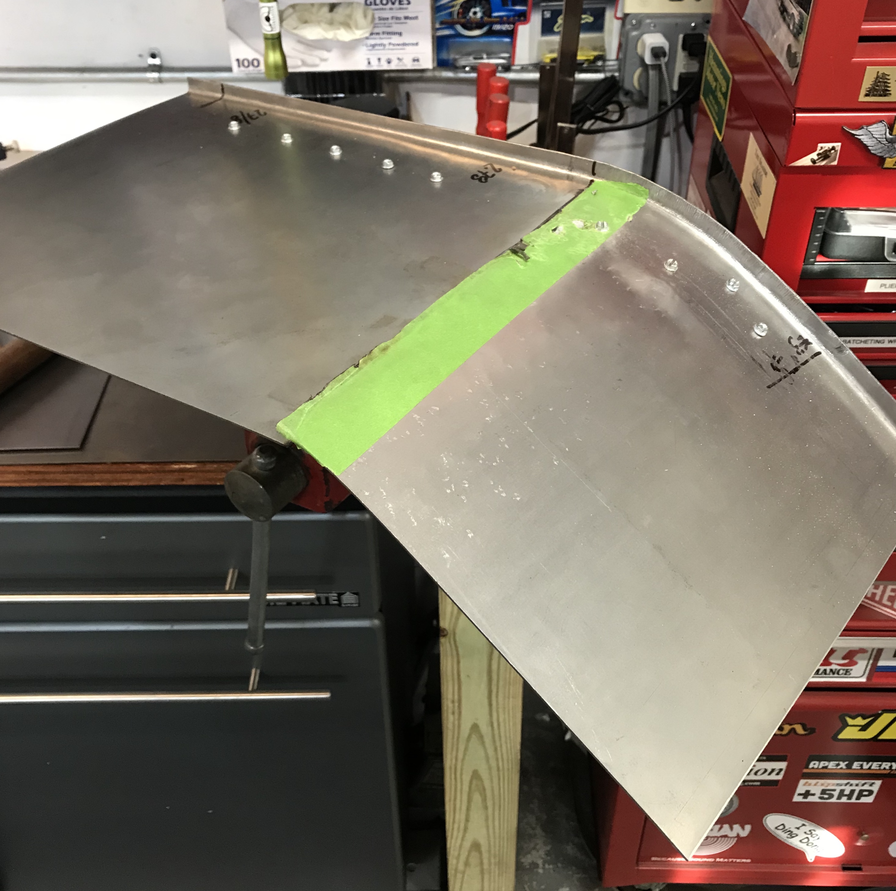

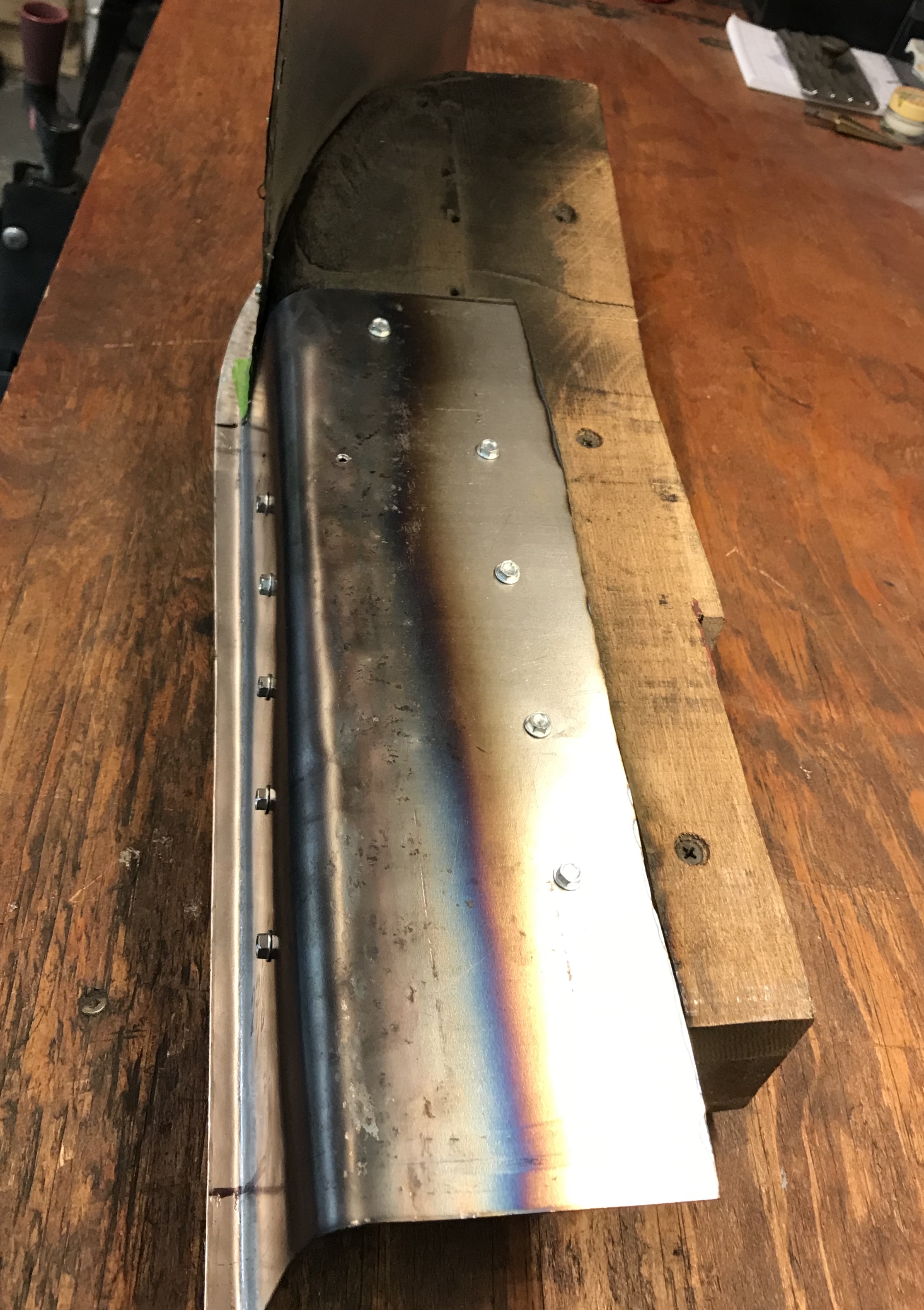

So we have a portion of this rear kick-up piece beginning to take shape!
This is all very cool and exciting. Enjoying this journey.

Kick up
Dion

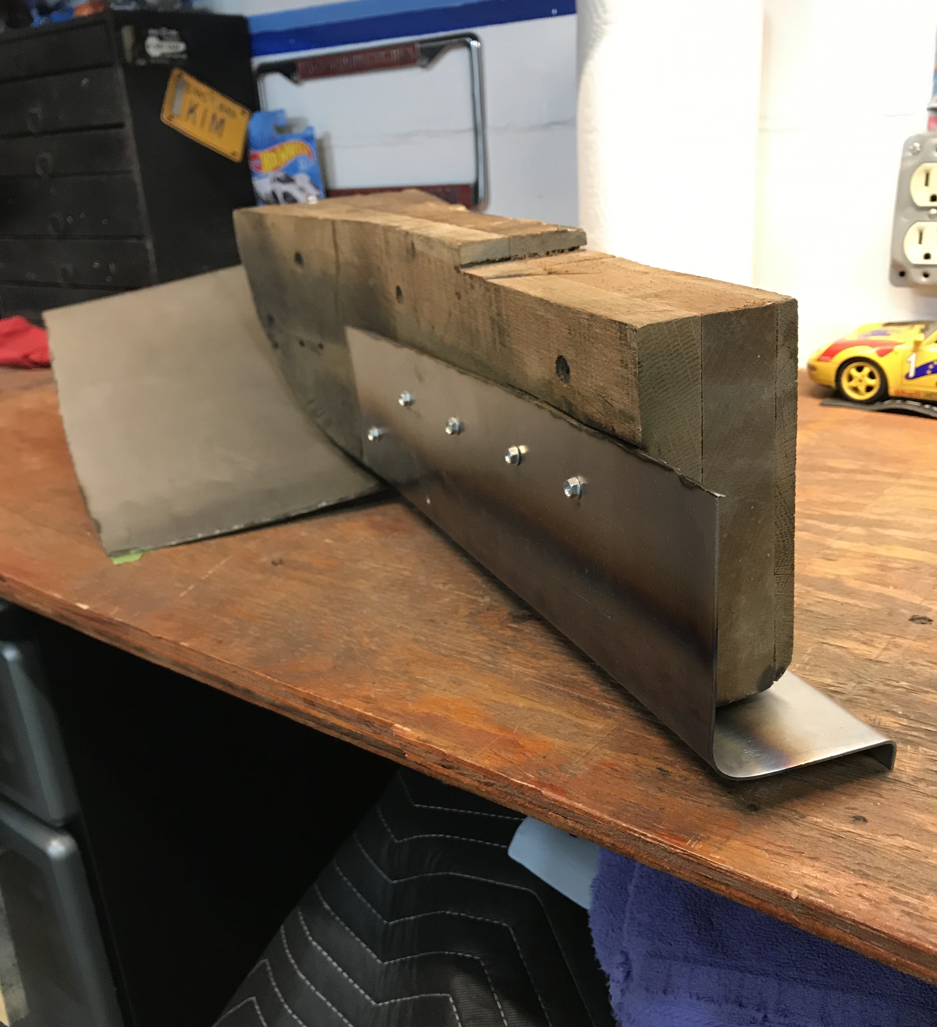

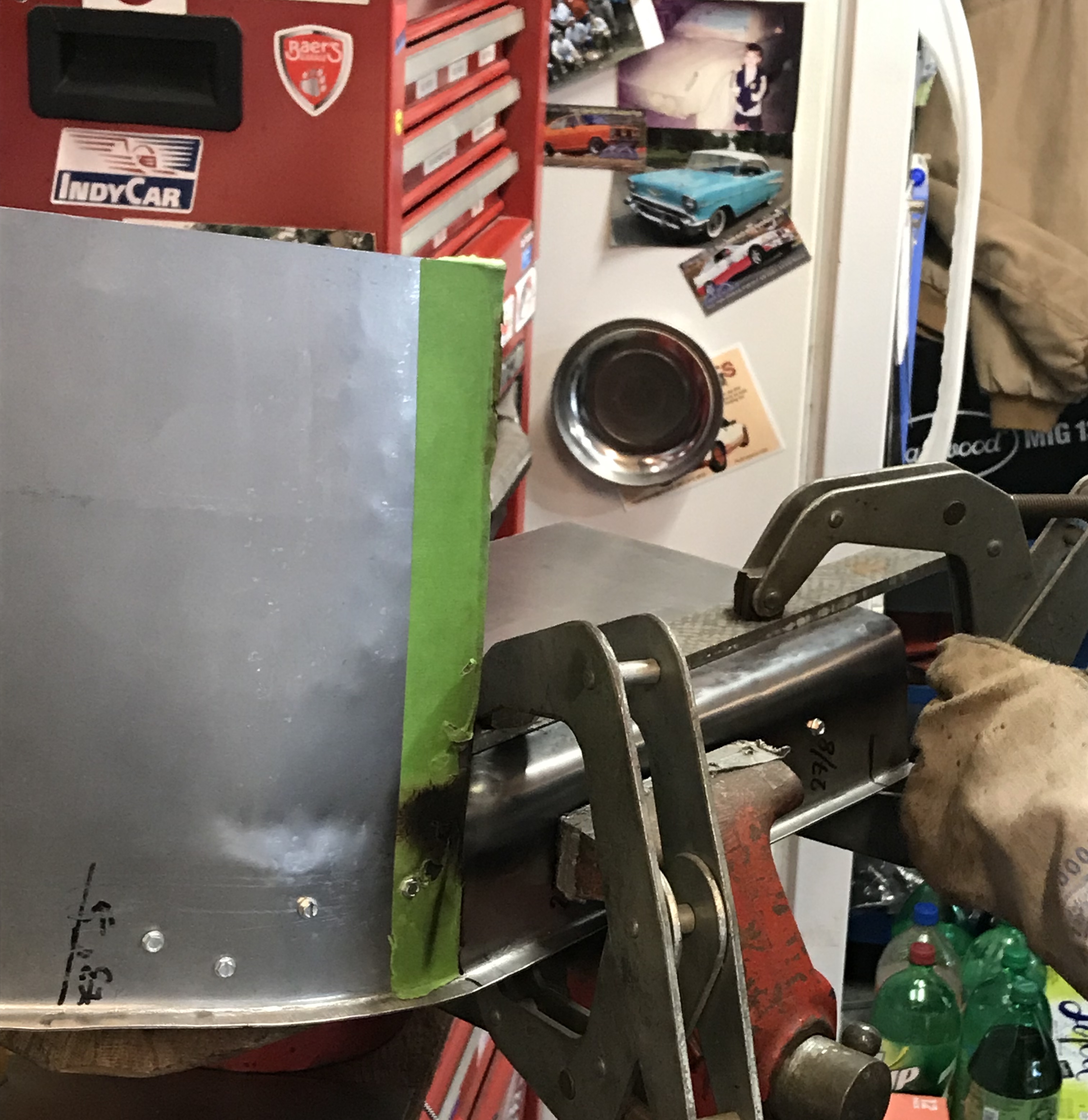

The wide portion is the “floor” of the kickup yet to be pie cut and wrapped around the buck.
Dion

Essentially will be oriented like this when welded to chassis . To be continued....

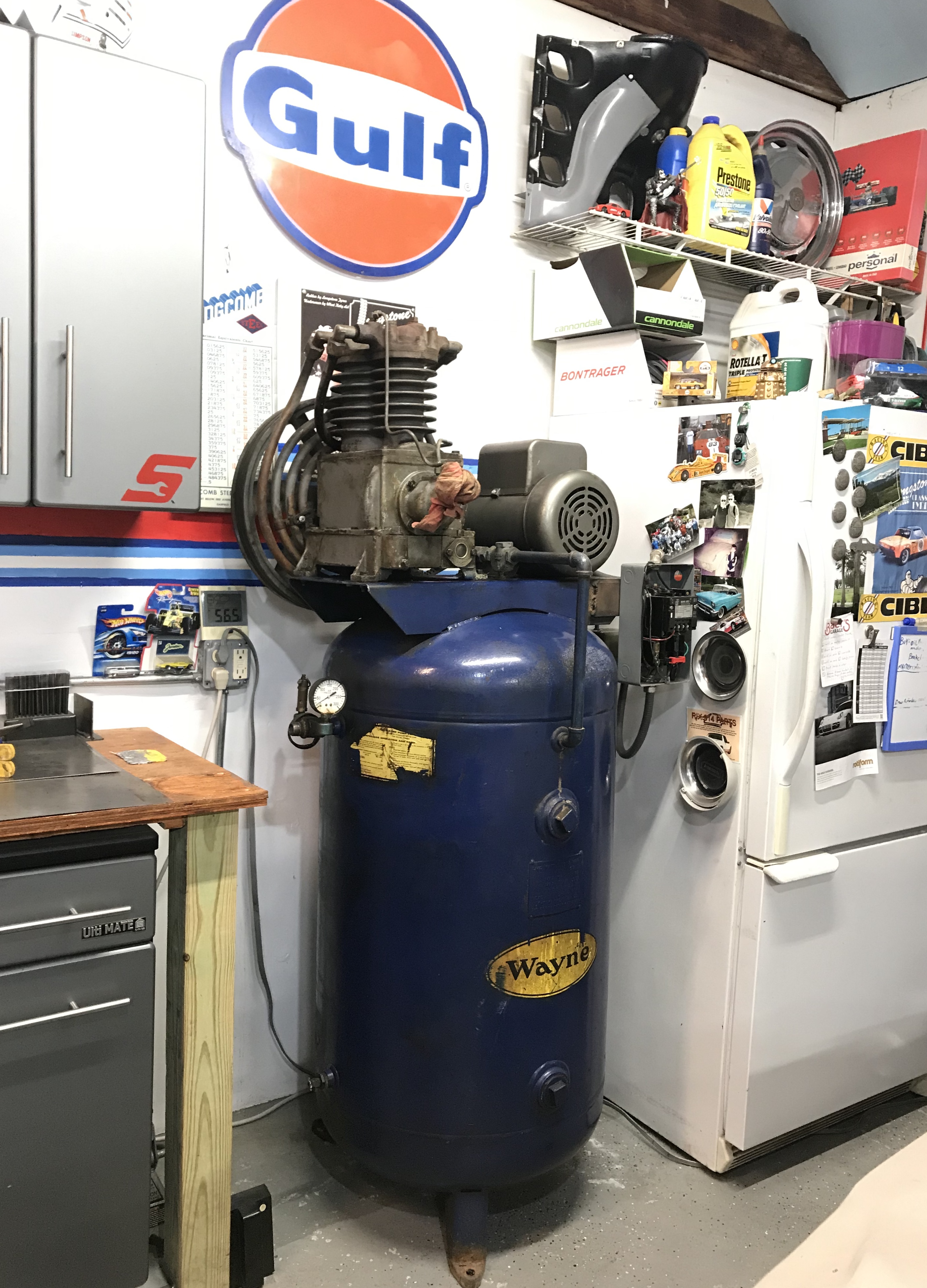

Obtained a bloody great 60’s compressor for future chores, fellow member Howard Hinsdale told me about it. Thanks Howard!
Unfortunately it needs a new tank, found a previous welded patch on the bottom. So no go!
I did find another tank so it’s another project to do. I removed the motor and pump.
Should be a fun project getting it back up to snuff.
