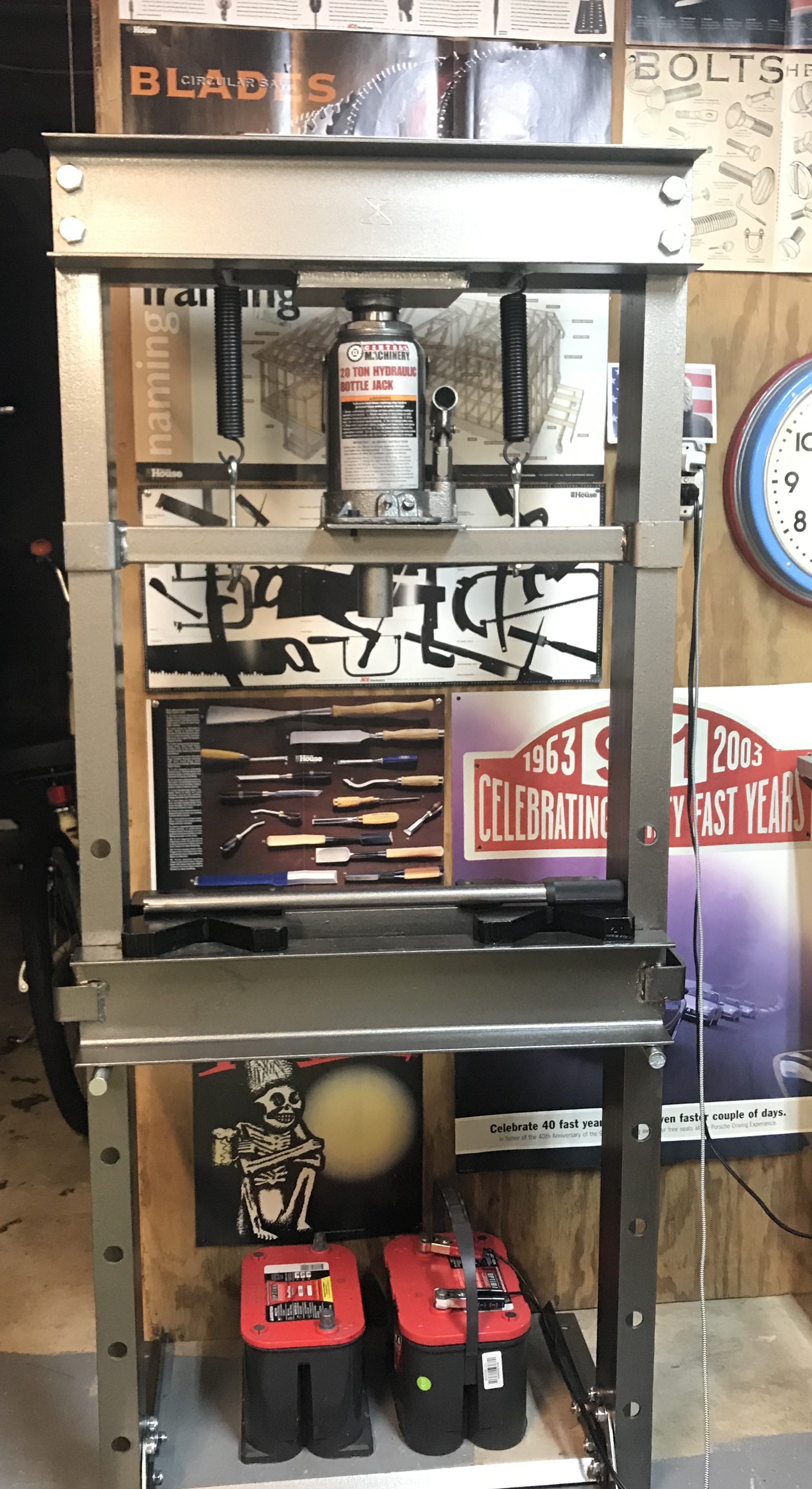

Still tackling the little but absolutely necessary jobs.
With the help of the HF press I removed the rear hubs from the old trailing arms.
As previously mentioned I have a nice new set to place the rear hubs in.
Hope to do that job in the coming days.
So here’s a few pics of progress...
The press, without this I can’t imagine the task!
Dion

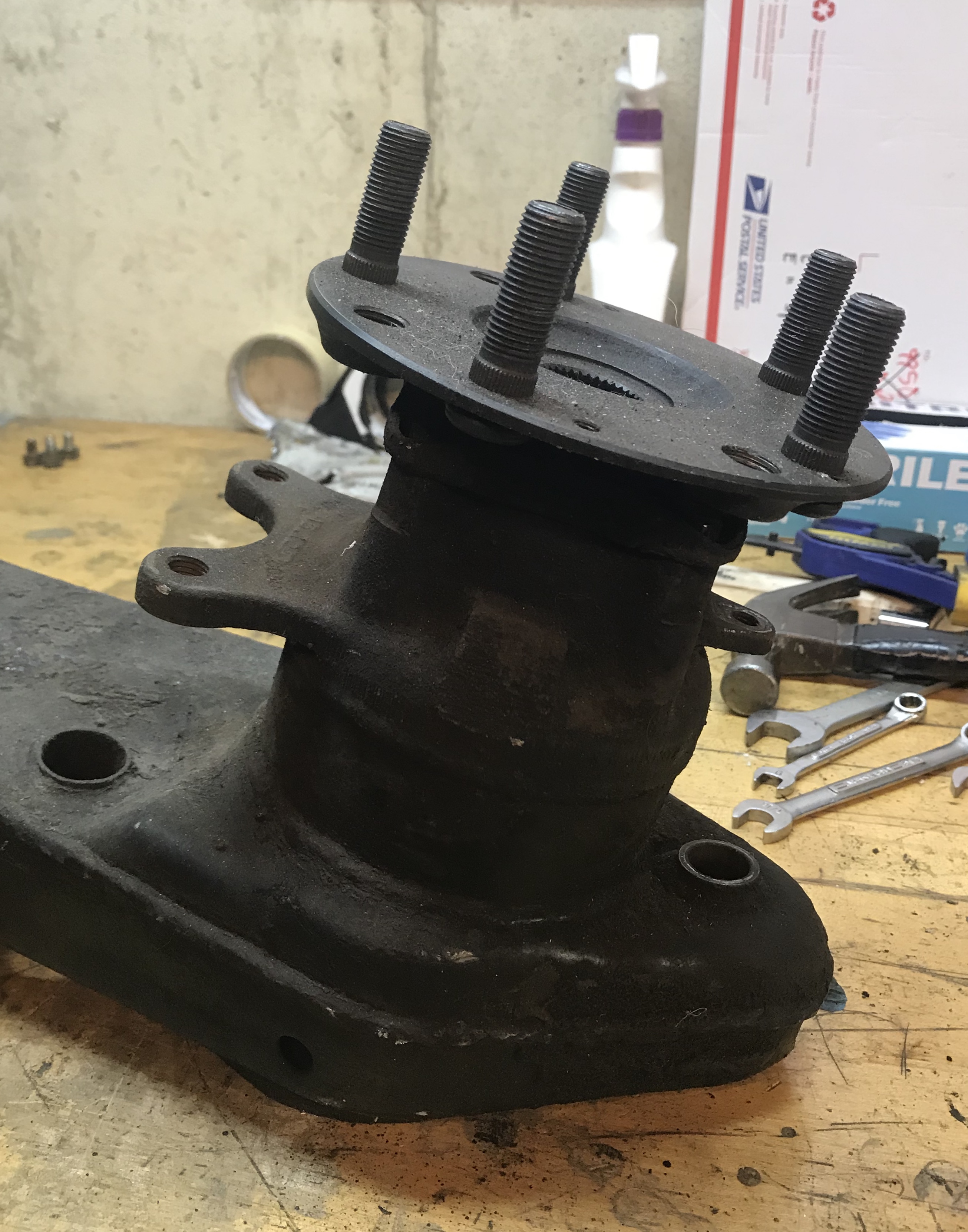

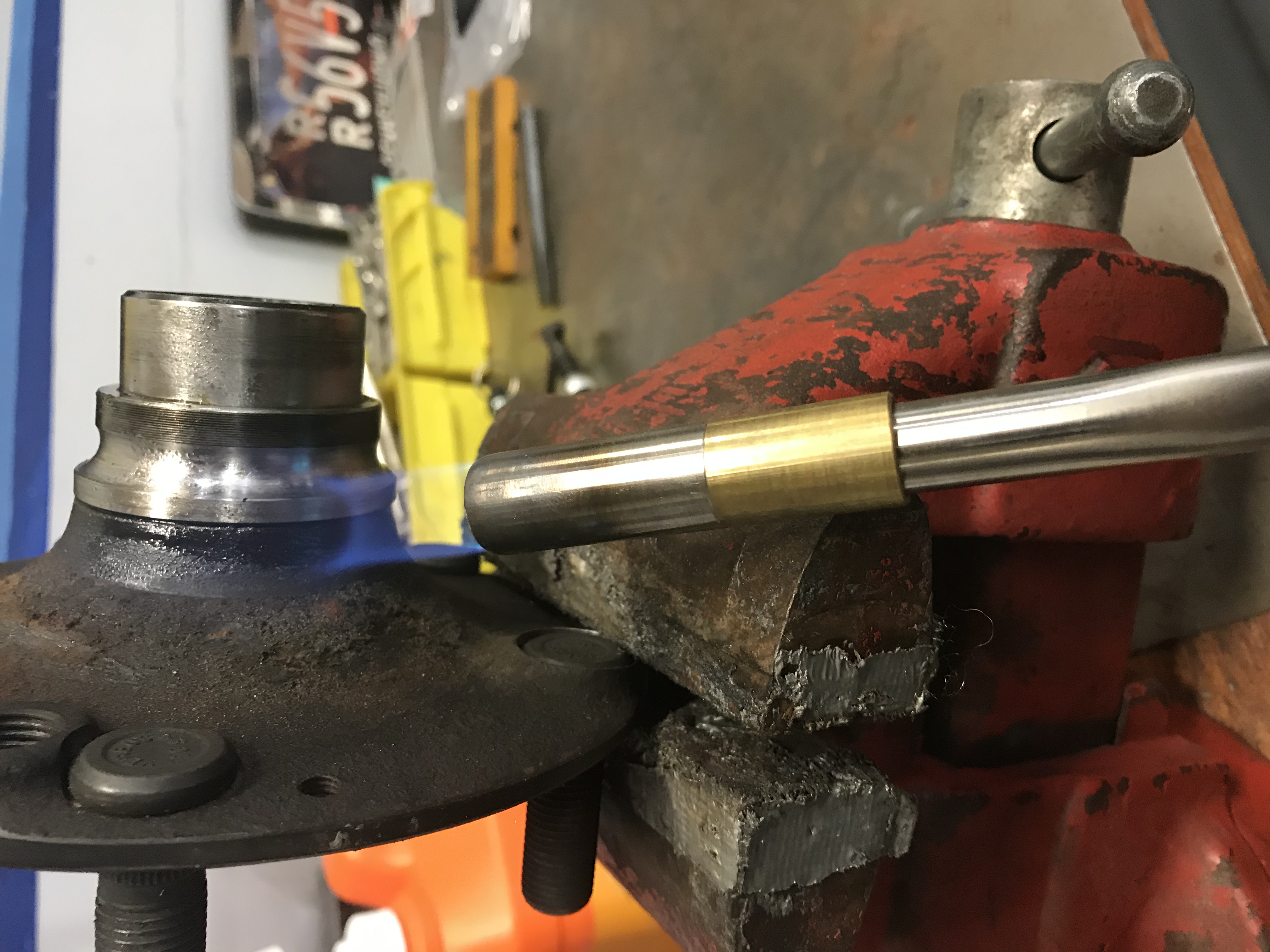

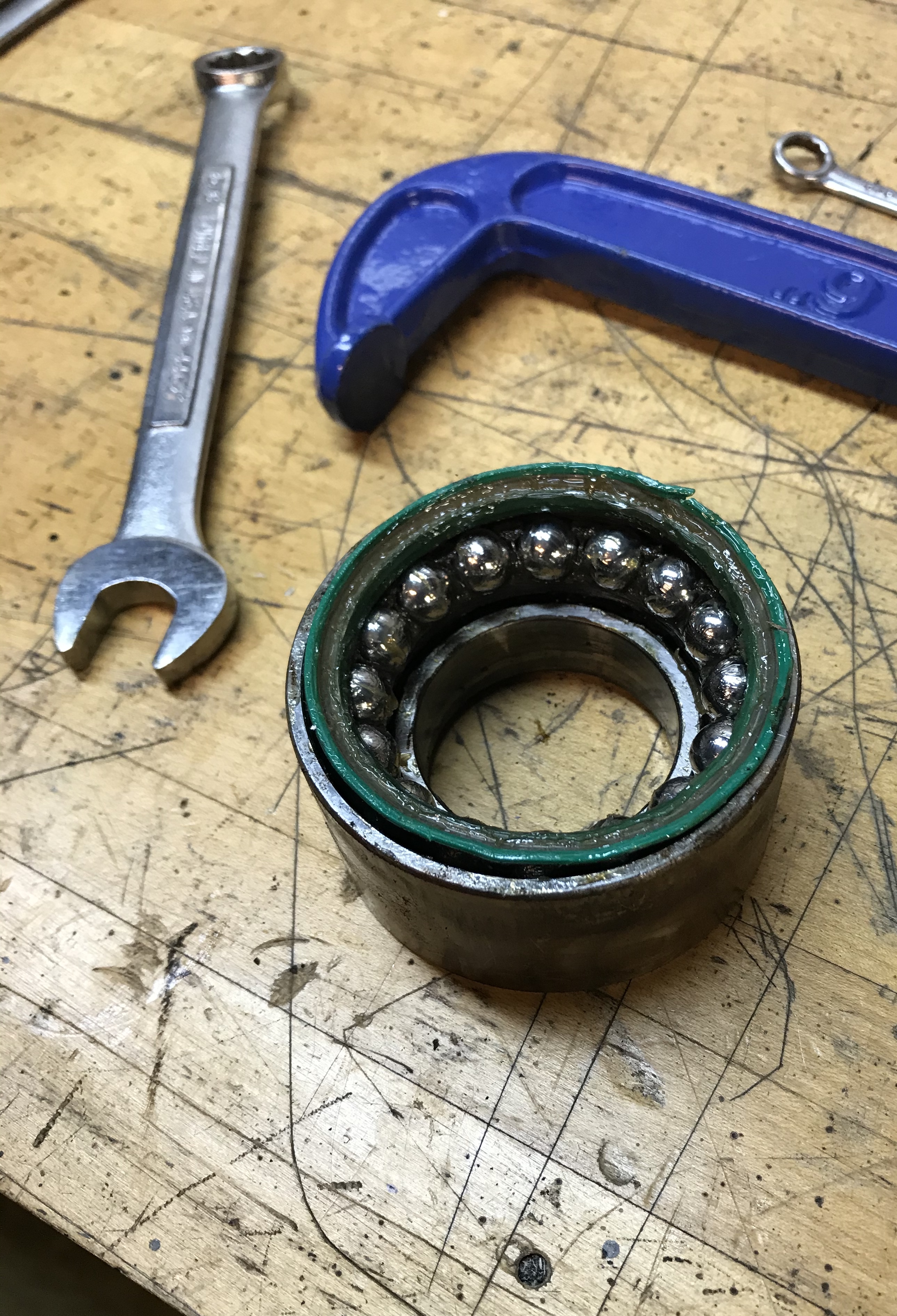

So first removed the hub. Destroying bearing in the process.
Then to get the race off that is left behind on the hub. I followed PMB excellent and entertaining vids to make life easier. Thanks Mr. Shea!
Applied a little MAP gas to heat the hub race and cold chisel it off.
Dion

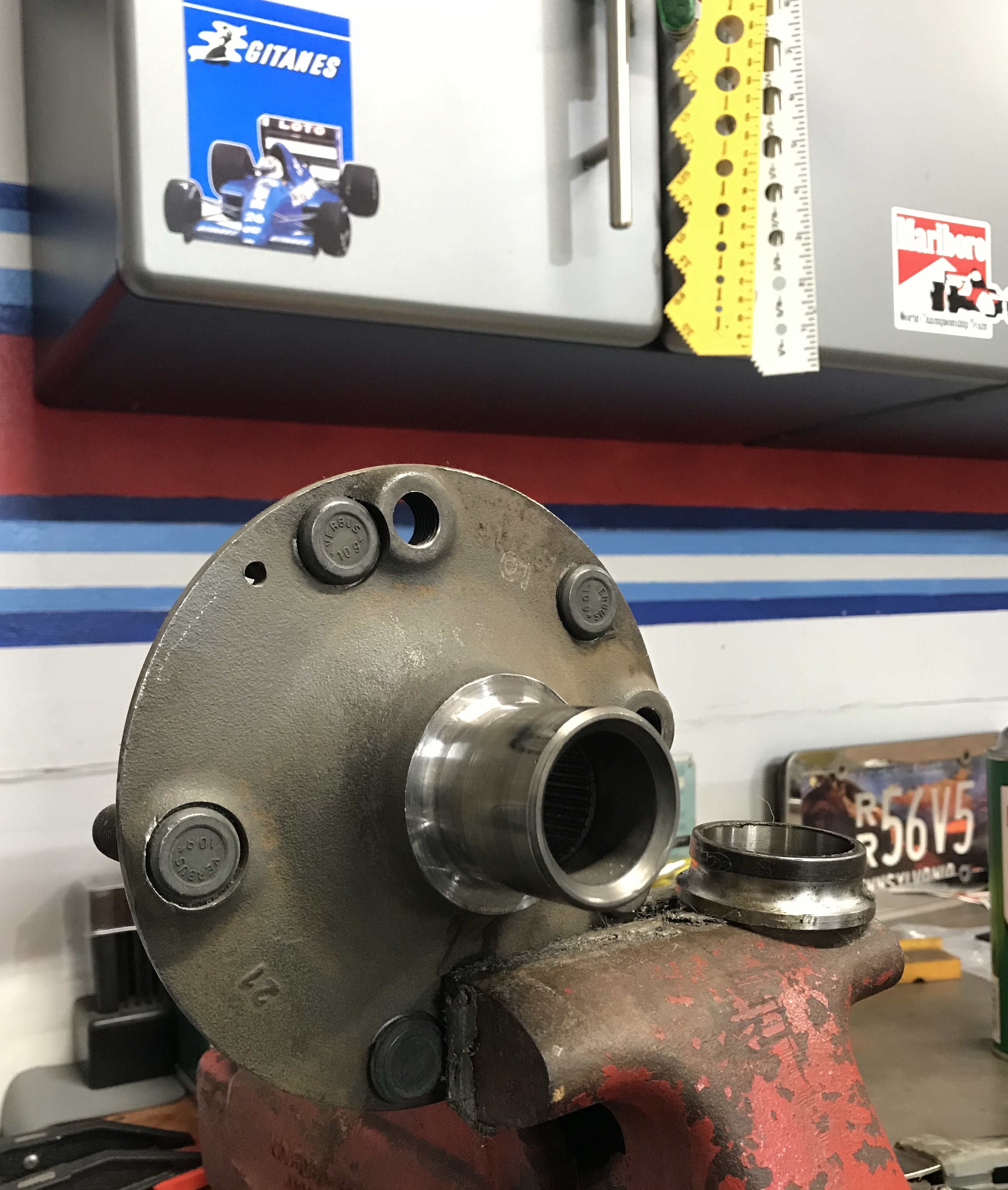

Destroyed bearing
Dion

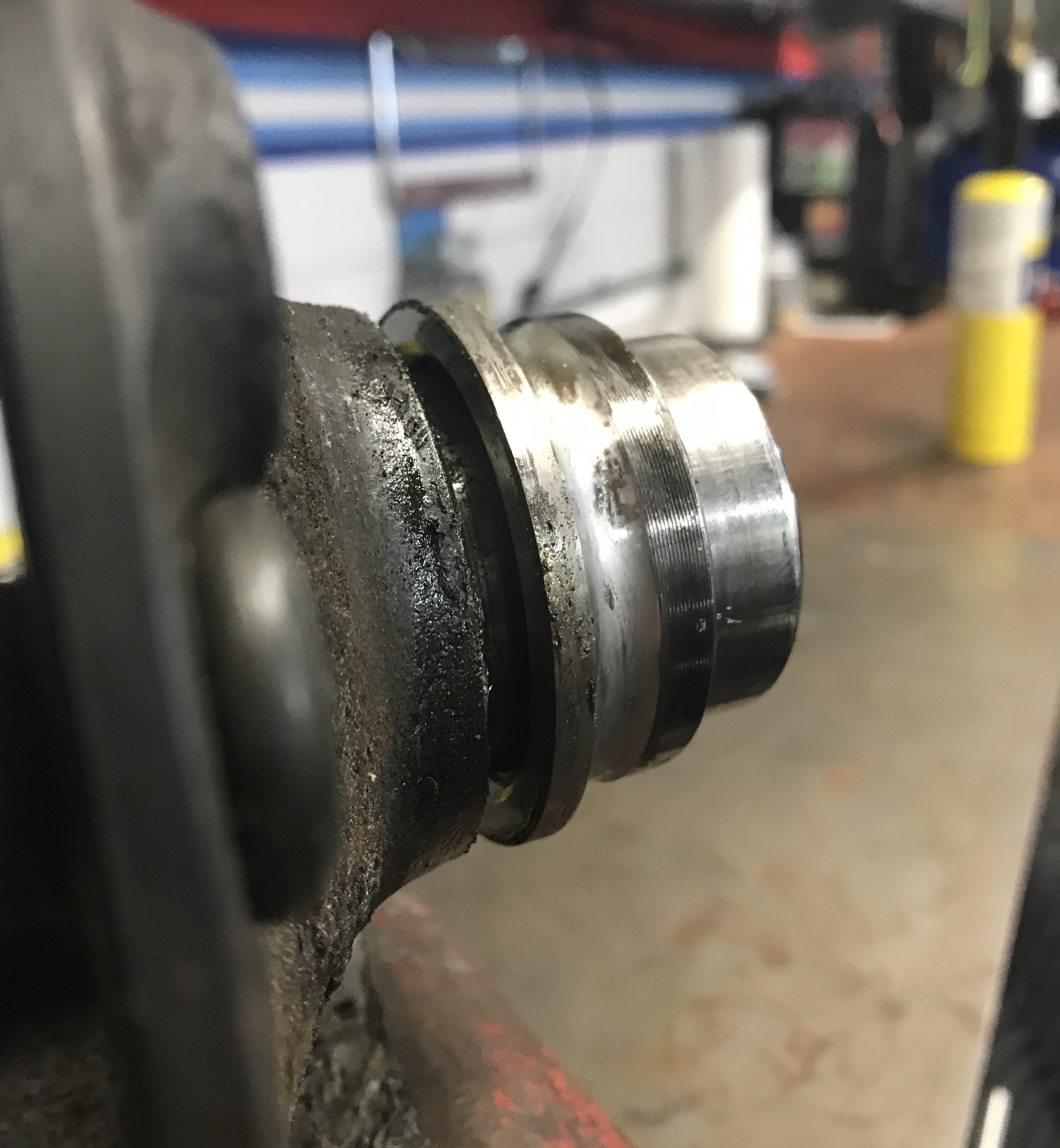

Heat
Dion
post Oct 29 2019, 06:30 PM
Post #567

Movement of race...
Dion

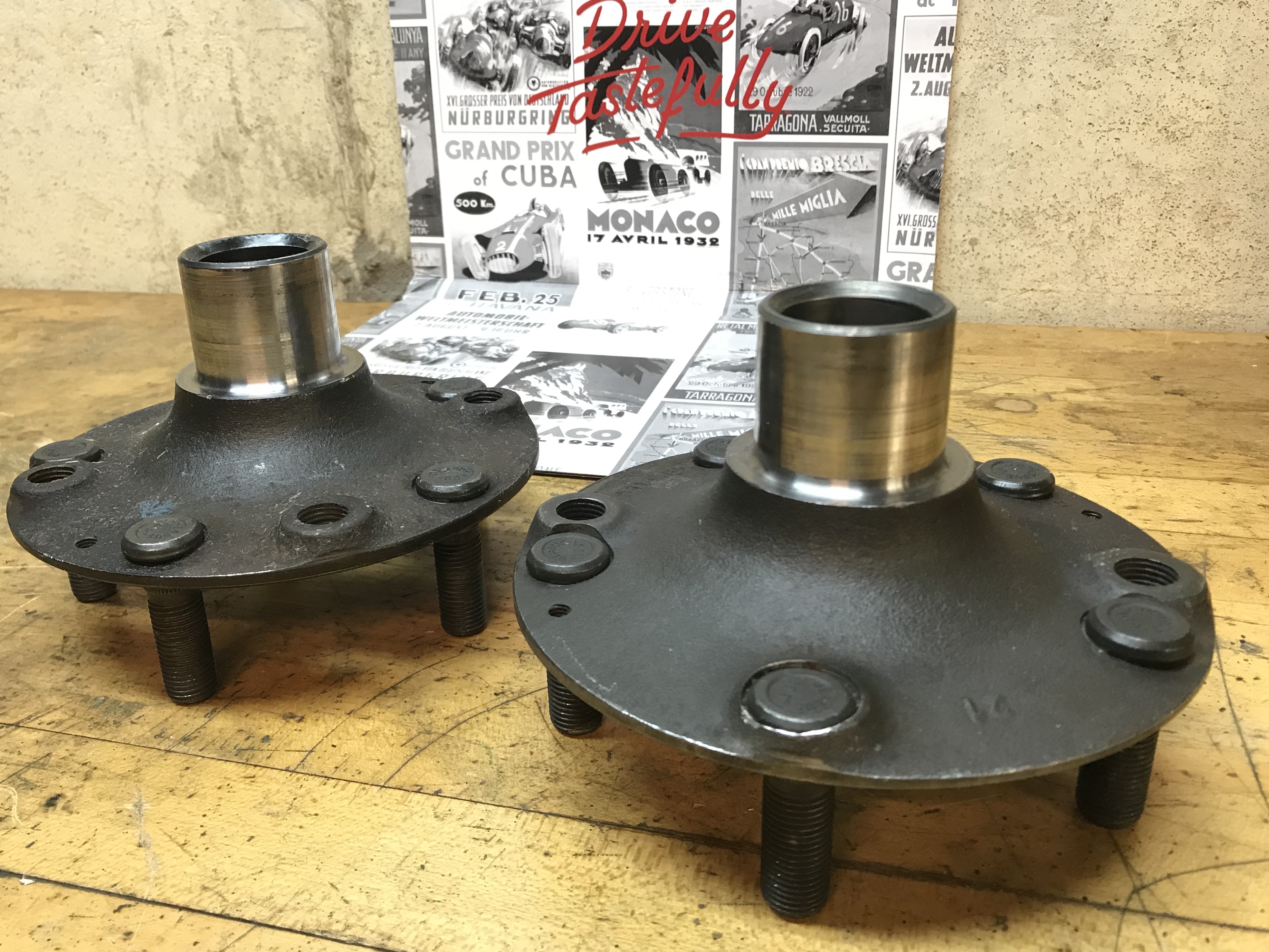

Freedom!
Dion
post Oct 29 2019, 06:32 PM
Post #569
RN
Posts: 2,839
Joined: 16-September 04
From: Audubon,PA
Member No.: 2,766
Ready for new bearings.

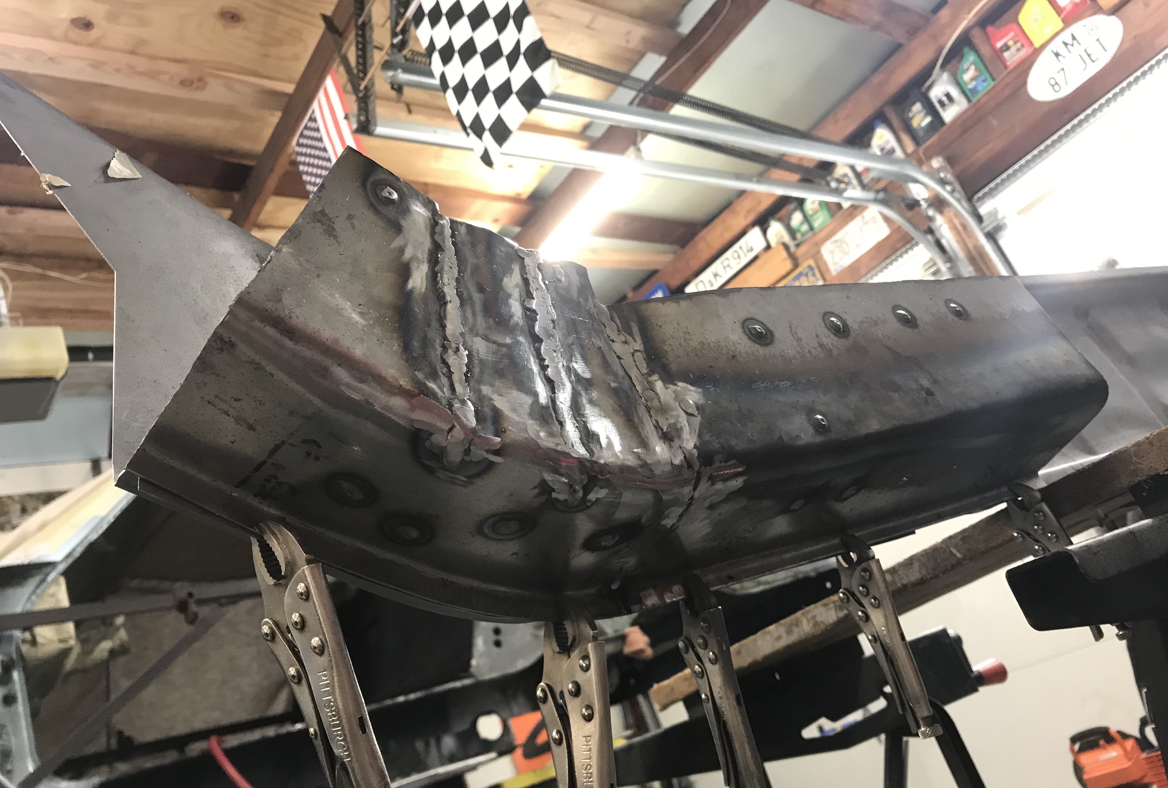

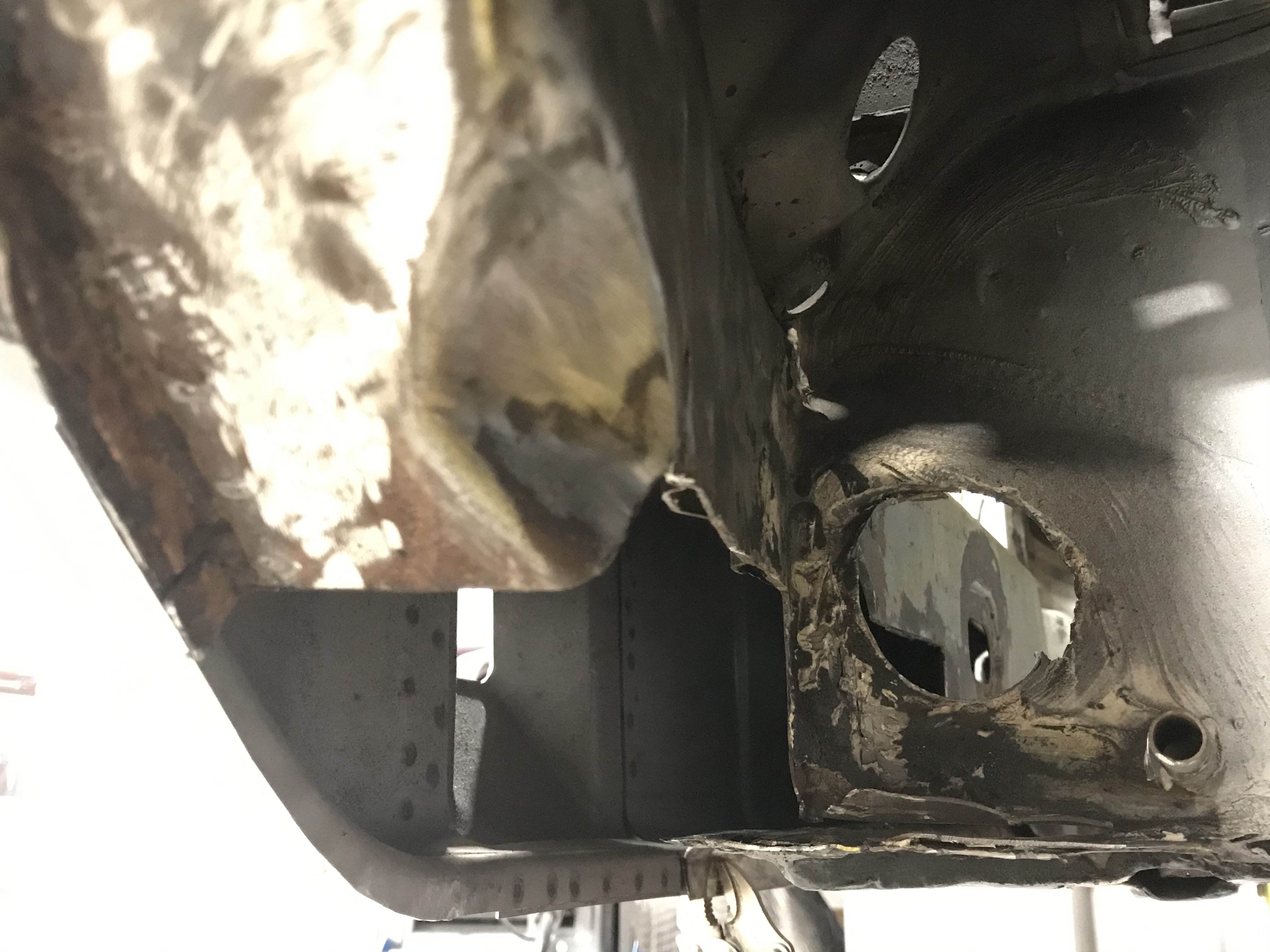

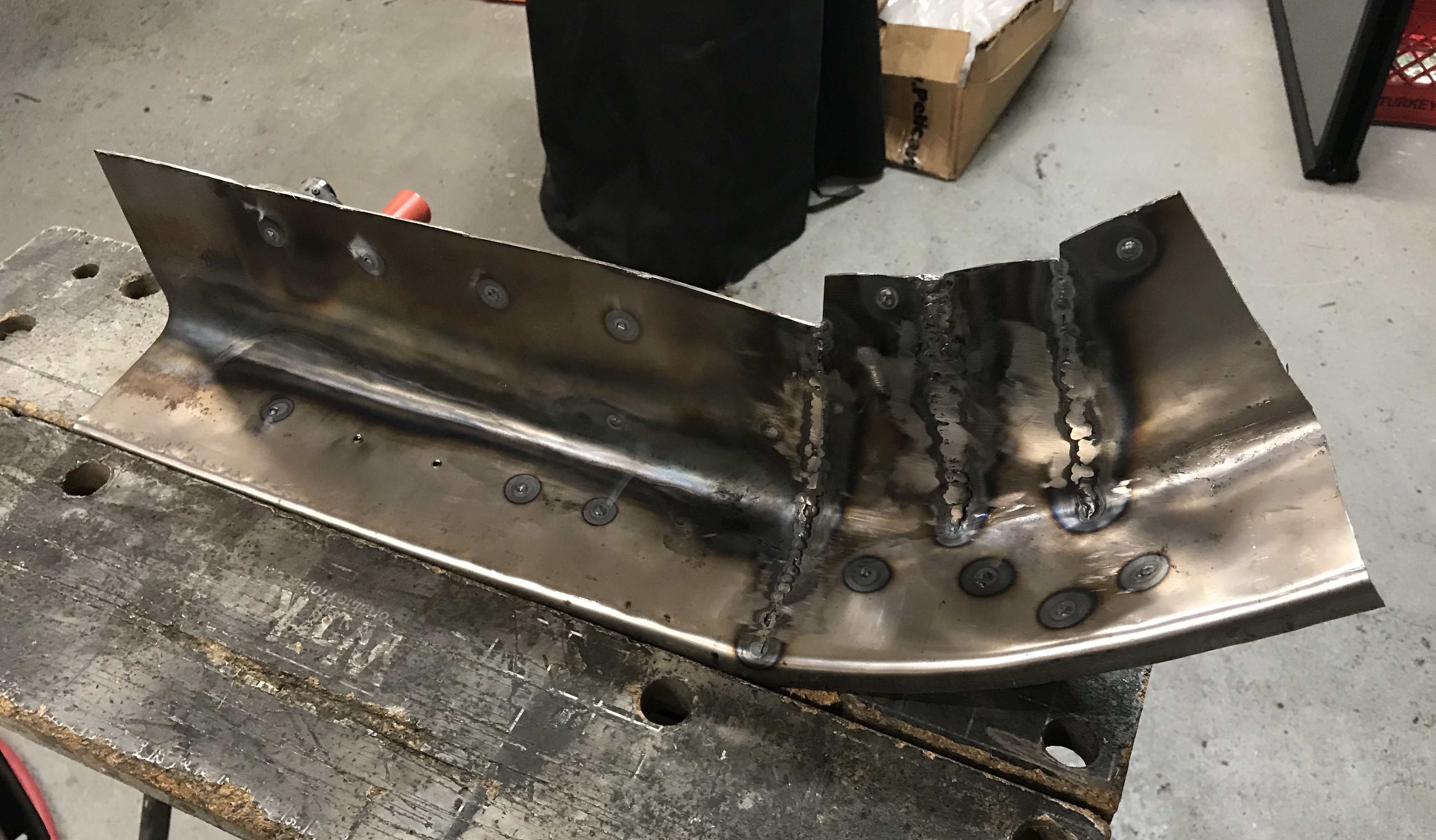

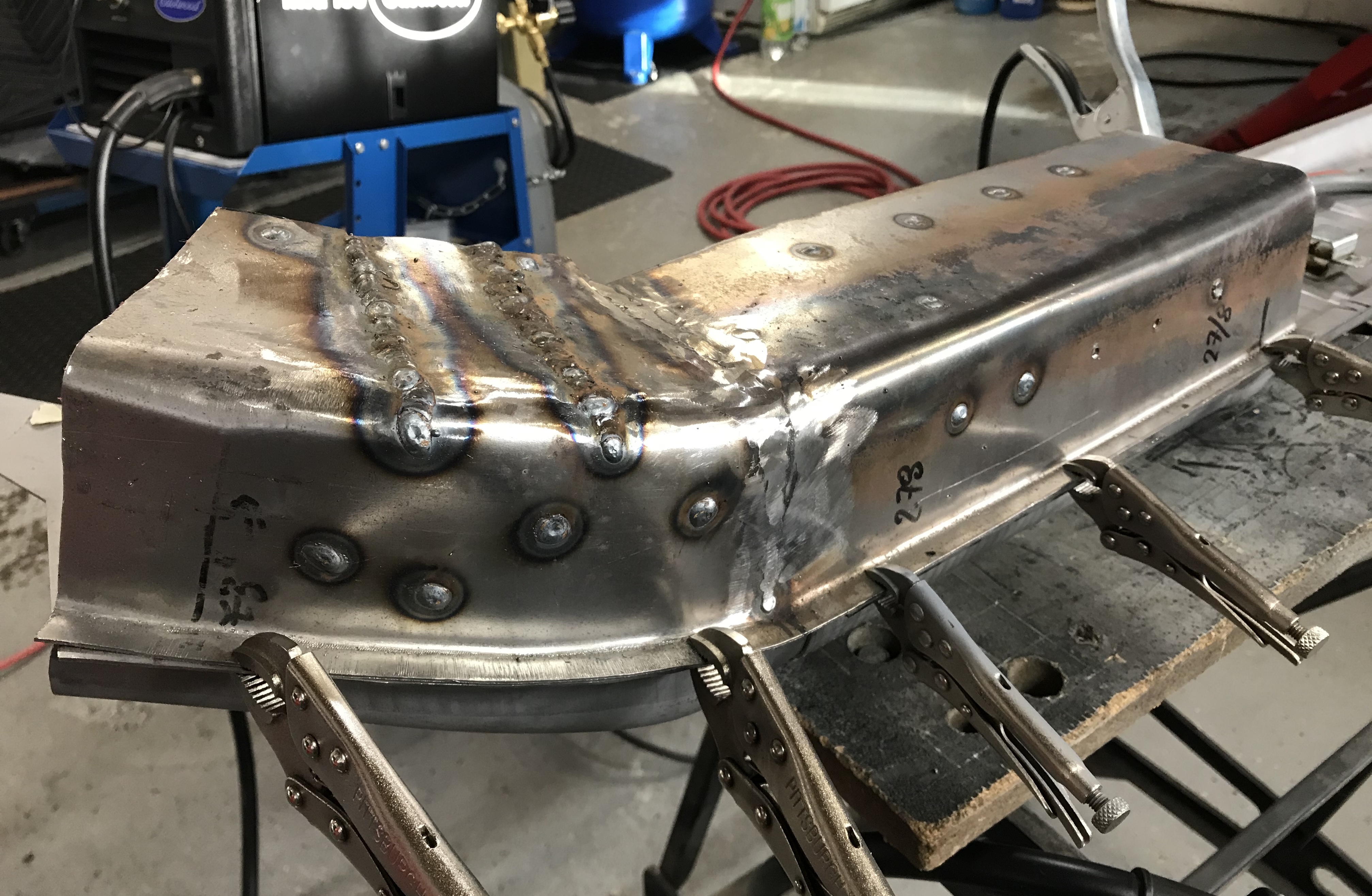

Managed to tackle some chassis work. My bud Dave came by the other day and helped out on the difficult task. When he removed the formed chassis piece from the buck/form
found out real quick on of my welds wasn’t up to the task. Cracked immediately after
due to stresses of the flex. So I cut another straight edge pie cut in that area to be re welded.
Dion
post Jan 5 2020, 08:36 AM
Post #571
RN
Posts: 2,839
From: Audubon,PA
Member No.: 2,766

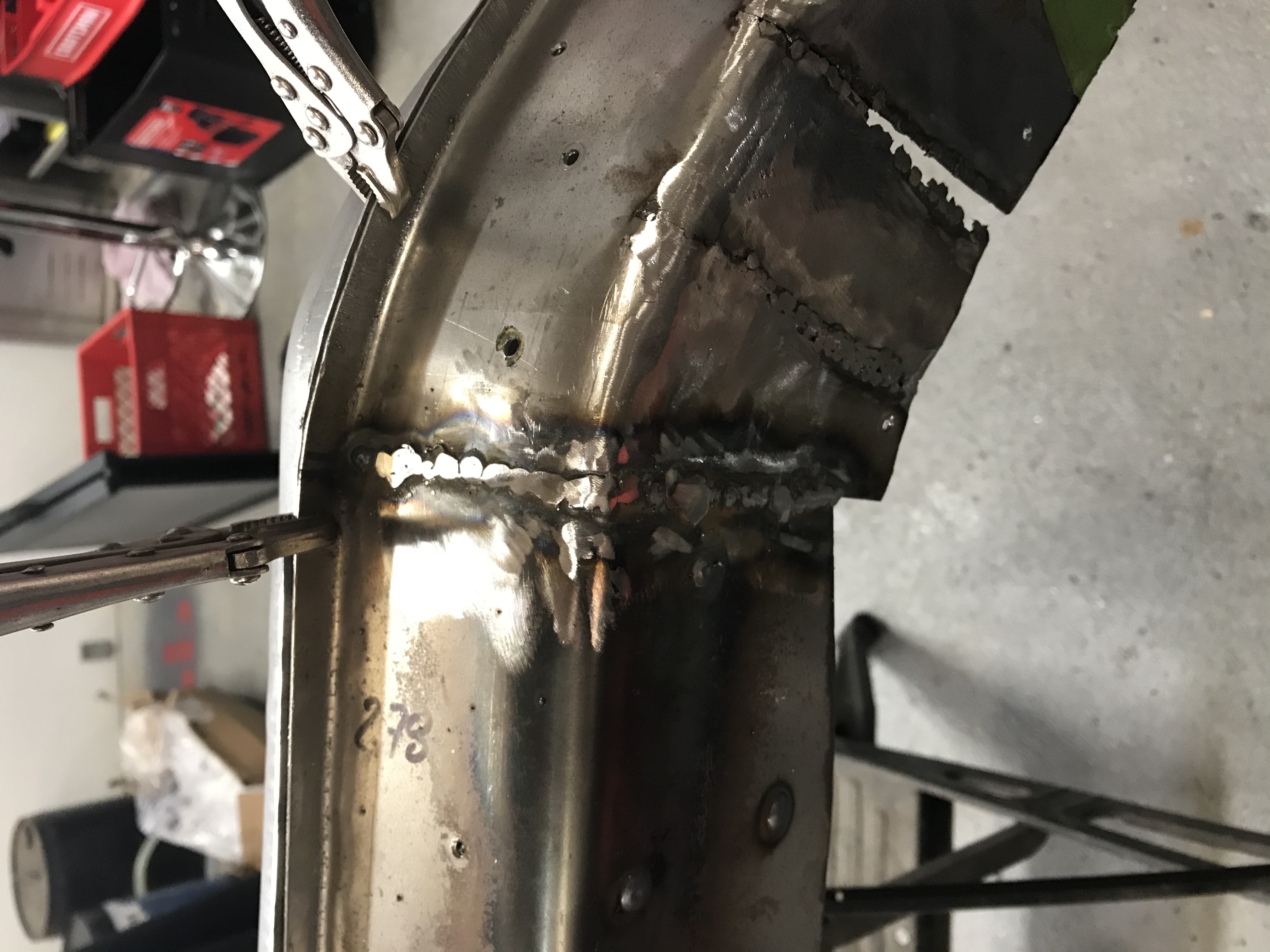

While Dave set up my welders setting found out that maybe one of the reasons the weld didn’t hold (newbie mistakes) the gas flow wasn’t sufficient.
He took to the task of welding up the crack. I went ahead and trimmed up some more of the long to help orient the new piece.

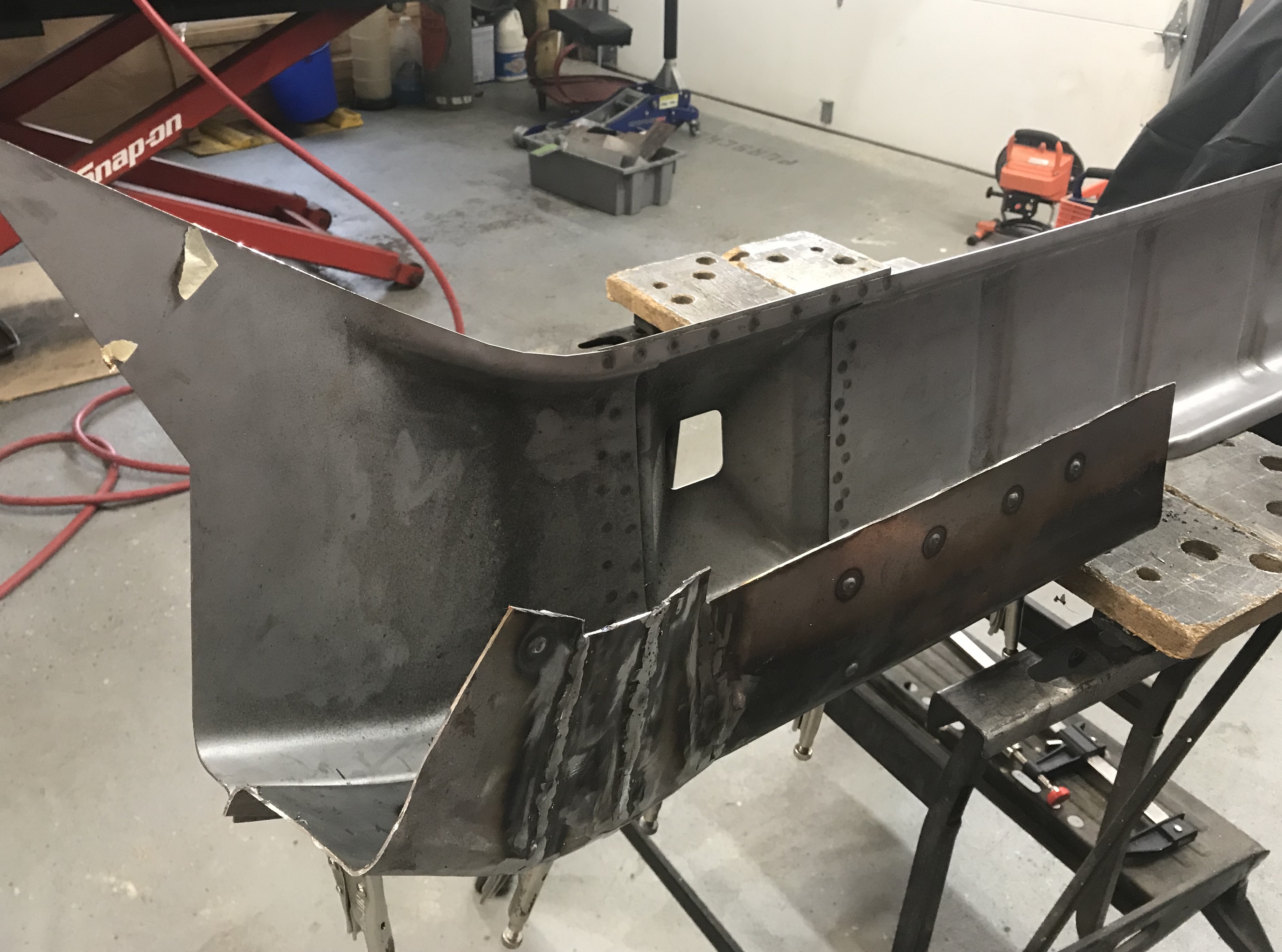

Trimmed out
Dion
post Jan 5 2020, 08:38 AM
Post #573
RN
Posts: 2,839
From: Audubon,PA
Member No.: 2,766
Cut
Dion
post Jan 5 2020, 08:41 AM
Post #574
RN
Posts: 2,839
From: Audubon,PA
Member No.: 2,766

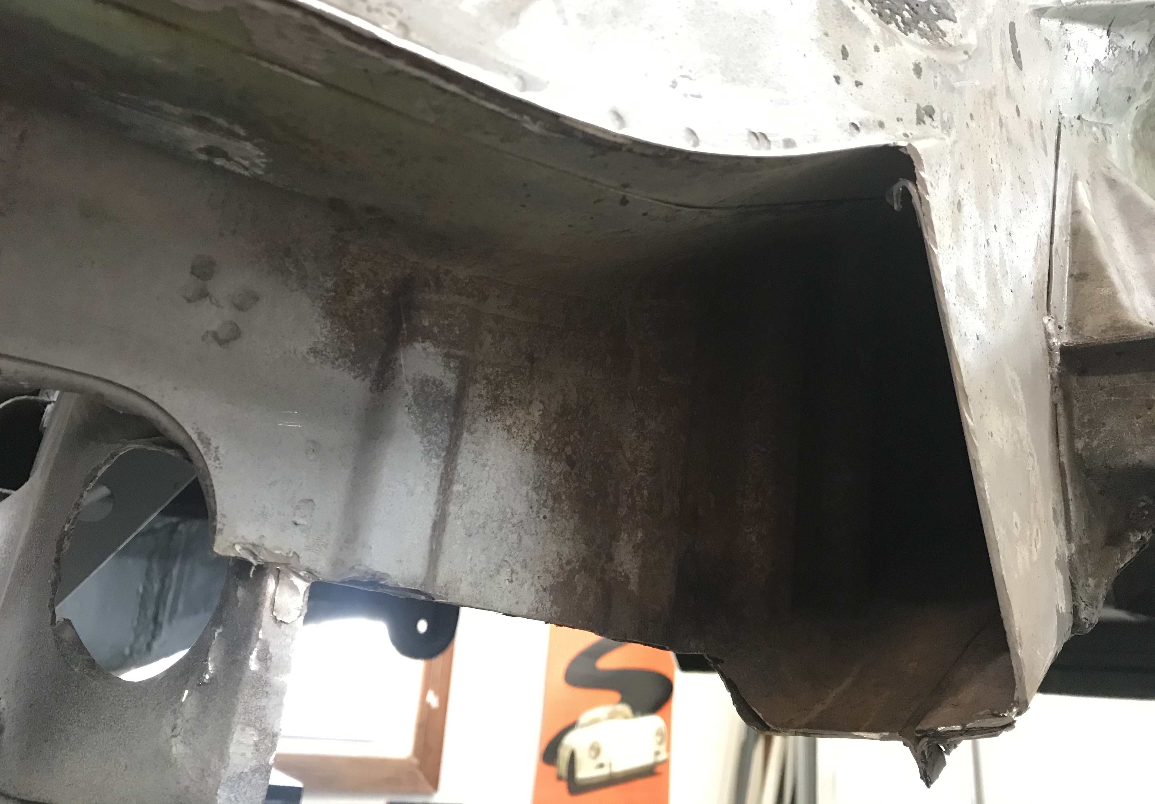

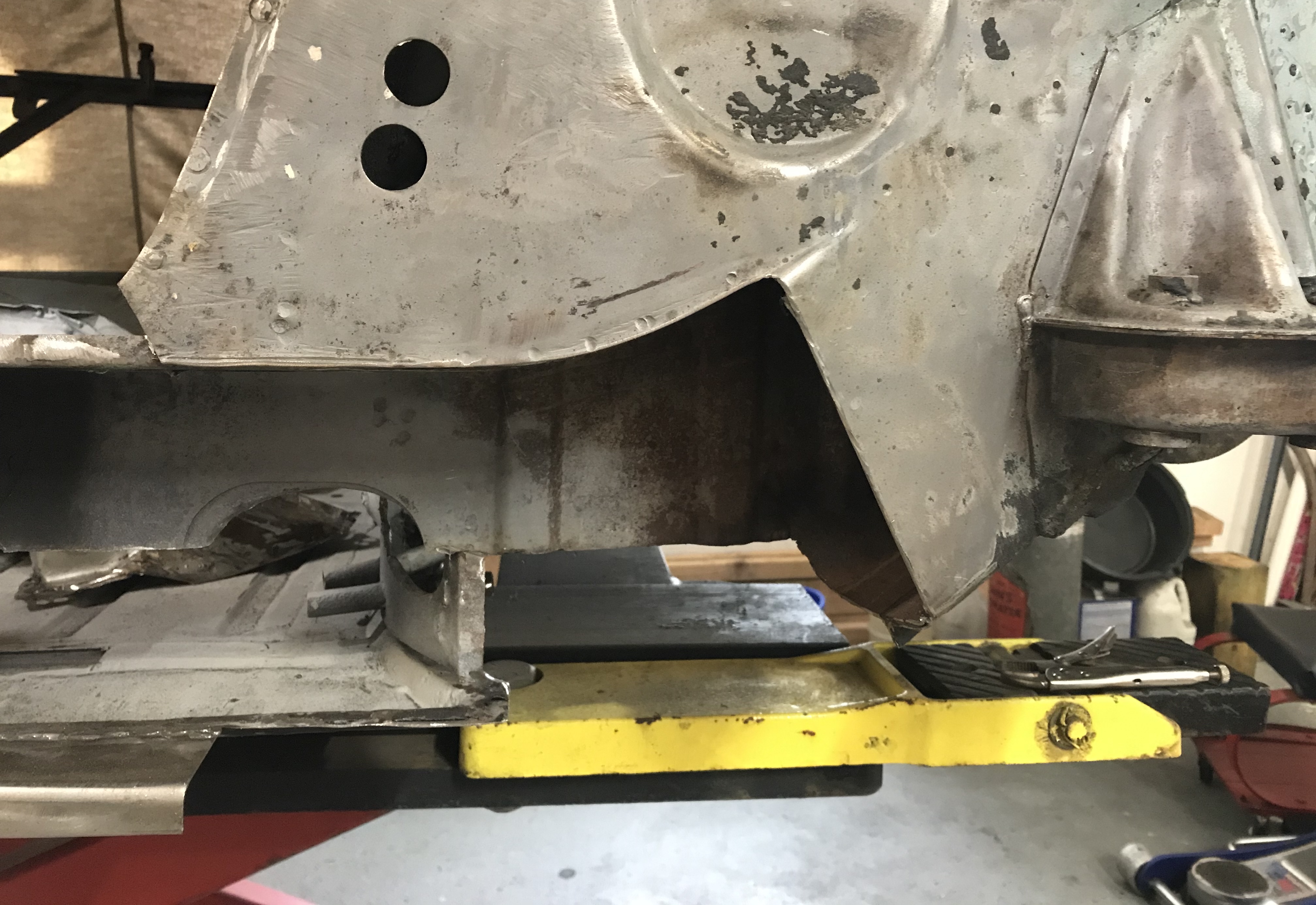

Mock up of two pieces together that will form the new “long” kick up.
Dion
post Jan 5 2020, 08:43 AM
Post #575
RN
Posts: 2,839
From: Audubon,PA
Member No.: 2,766
Joined temporarily
Dion
post Jan 5 2020, 08:47 AM
Post #576
RN
Posts: 2,839
From: Audubon,PA
Member No.: 2,766
Will need more trimming. Getting there.
Progress is progress. Not the most glamorous. More metal needs to be added to this piece. Goal to make sure there will be NO FLEX here. More to come....

Happy New Year Dion! Great documentation and helpful pointers.
You may have mentioned it in an earlier post so apologies if I missed it but I'm assuming you have plans to make sleeves where these pieces will be fit to the chassis?
I found Jeff Hail's post about this topic super helpful and ended up copying his approach when I did a similar repair to my car.
See post # 43 here:
http://www.914world.com/bbs2/index.php?sho...76791&st=40
Again, sorry if you already had this covered.
Keep up the great work and you'll be (IMG:style_emoticons/default/driving.gif) in 2020!

@Tygaboy Happy New Year Chris & thank you for all your encouragement.
Yes do plan on a “sleeve” for this area. No apologies ever needed.
