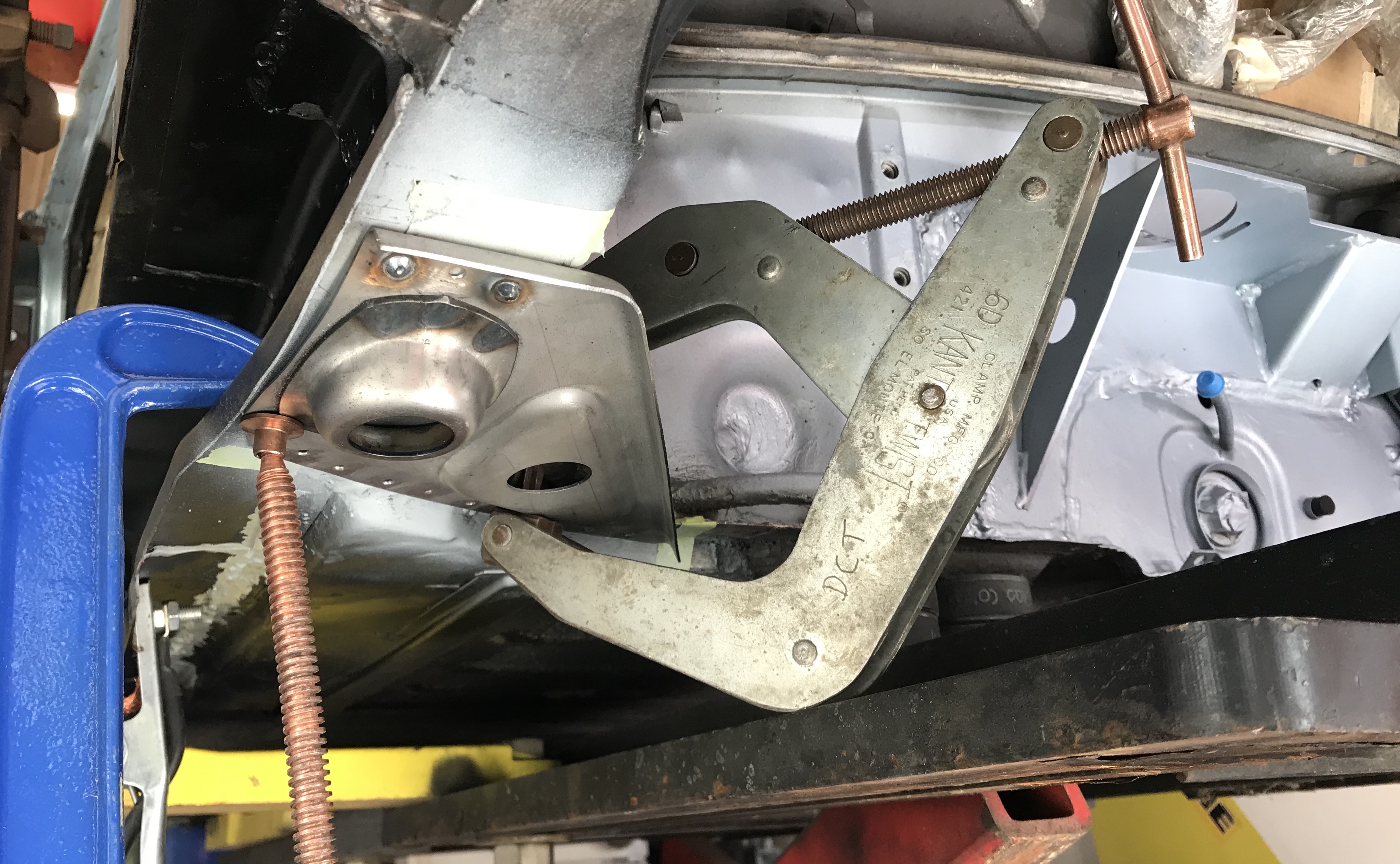

Time for coffee & donuts. I had the Yeti filled with coffee while dealing with this donut. Donut is courtesy of Restoration Design.
Dion
post Apr 7 2020, 06:41 PM
Post #624
RN
Posts: 2,839
Joined: 16-September 04
From: Audubon,PA
Member No.: 2,766
After a few hammer hits to shape the donut to the contour of the curved kick-up, arc was then applied.

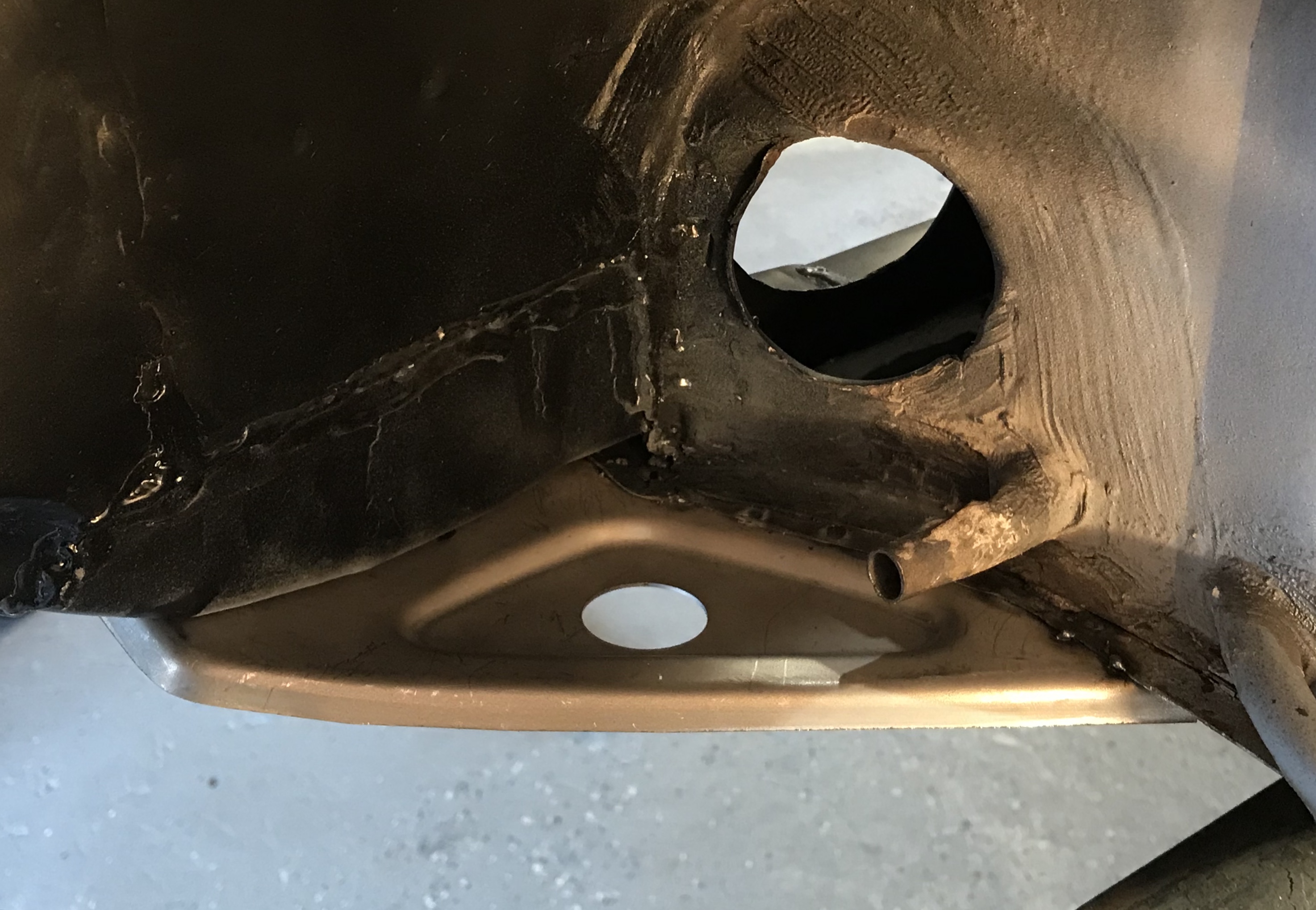

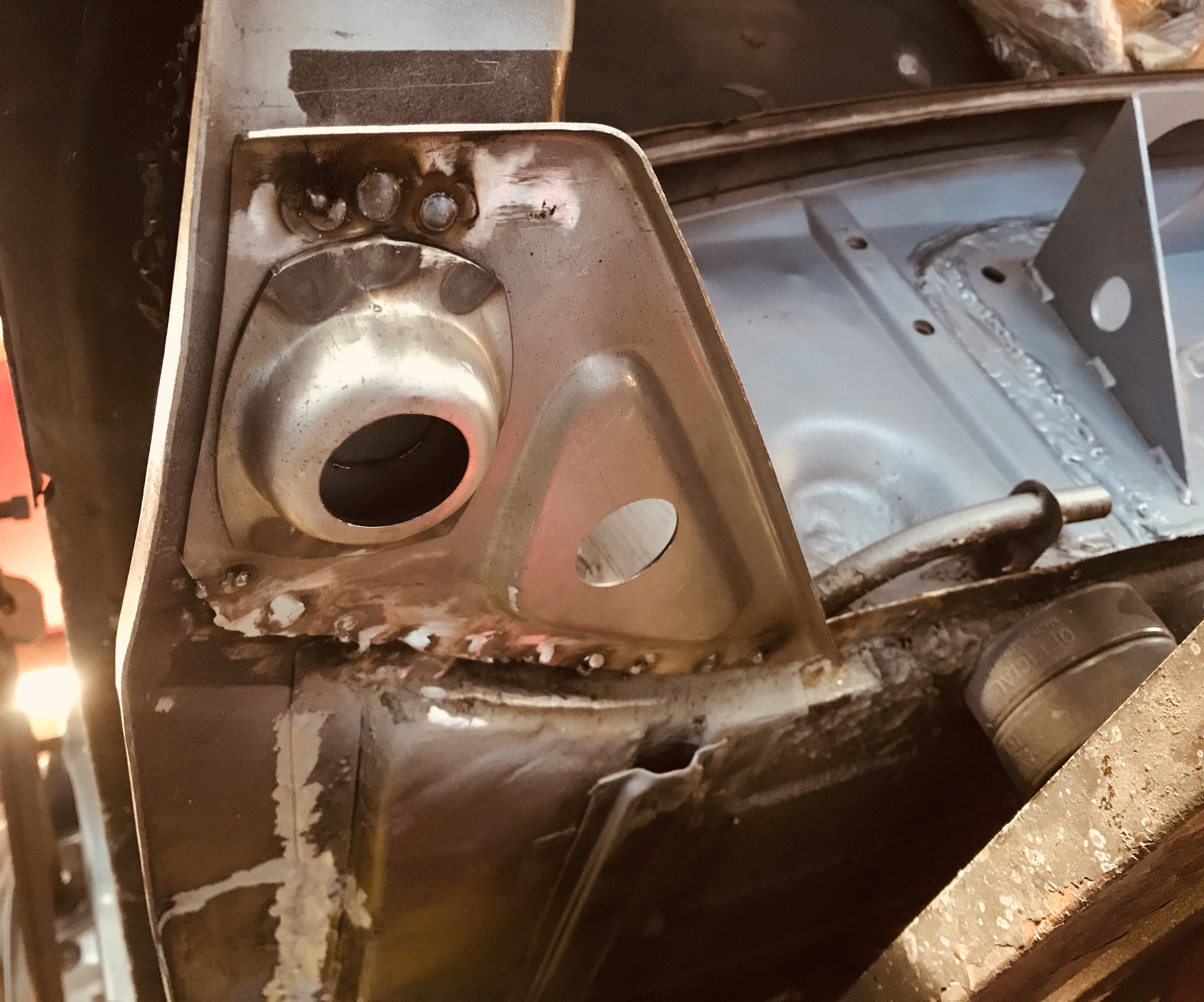

Latest task is the seatbelt bolt and plates.
Here’s a reminder pic of why this COTM car was torn apart.
Before i was going to install the six I thought I’d put a new carpet set in,BUT....
This is what was lurking under “nice” paint.
Dion
post Apr 16 2020, 07:38 PM
Post #629
RN
Posts: 2,839
From: Audubon,PA
Member No.: 2,766

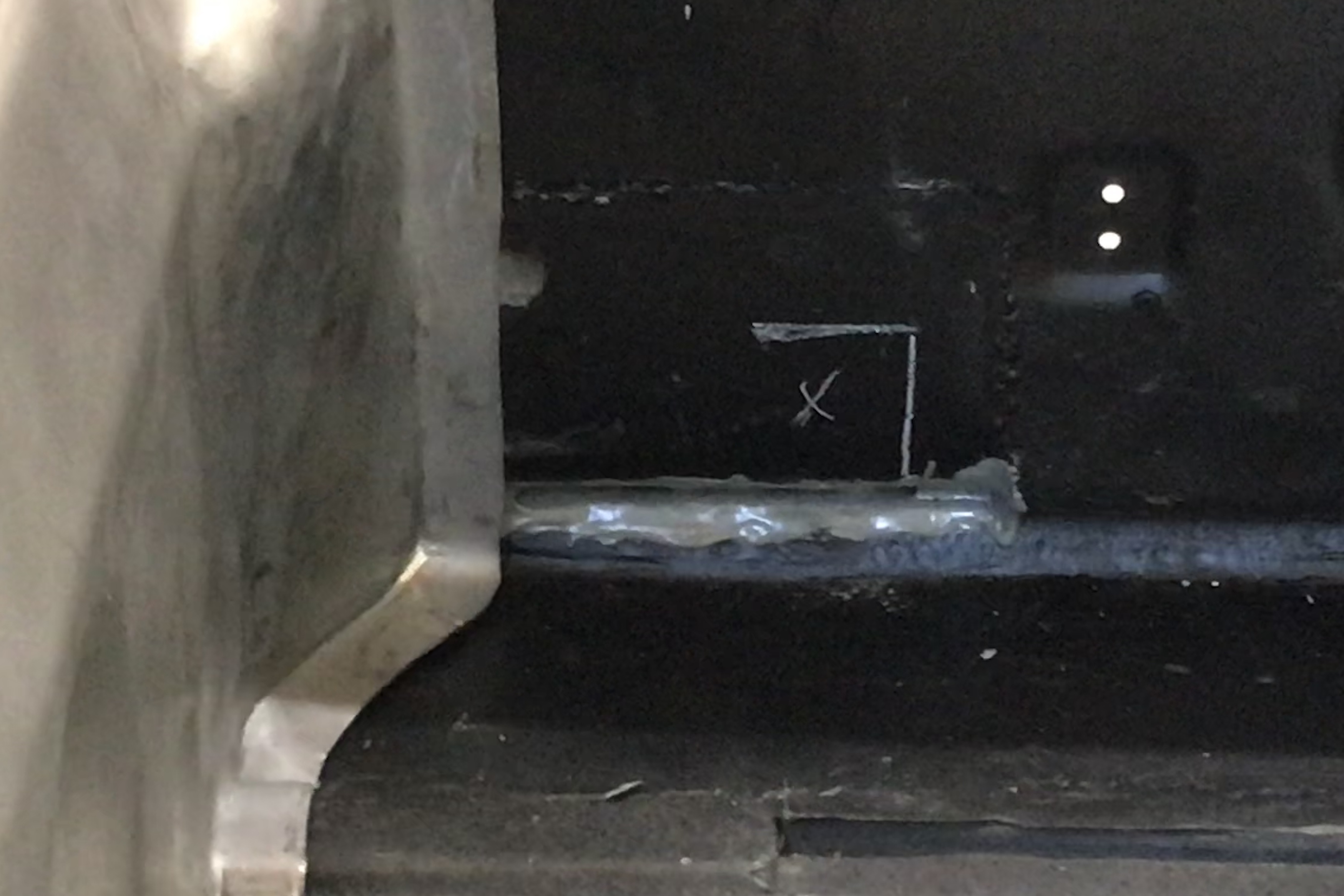

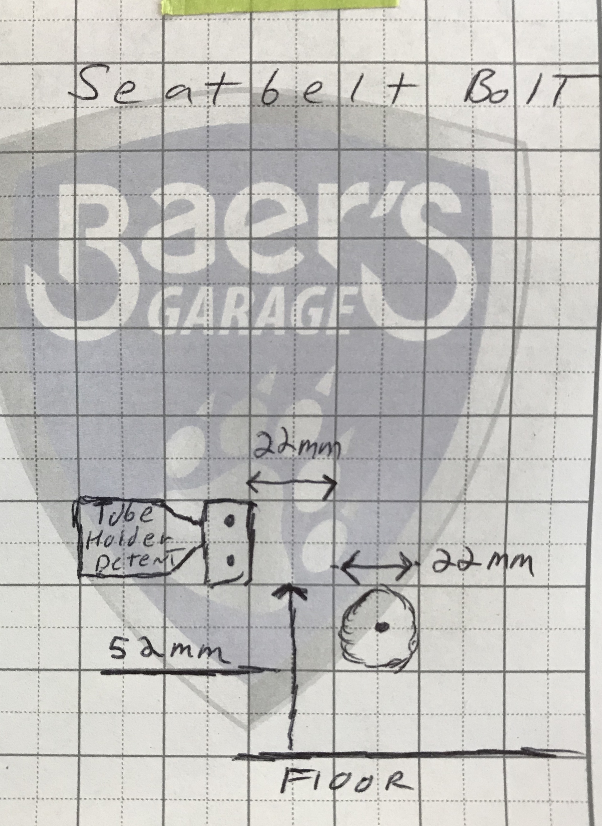

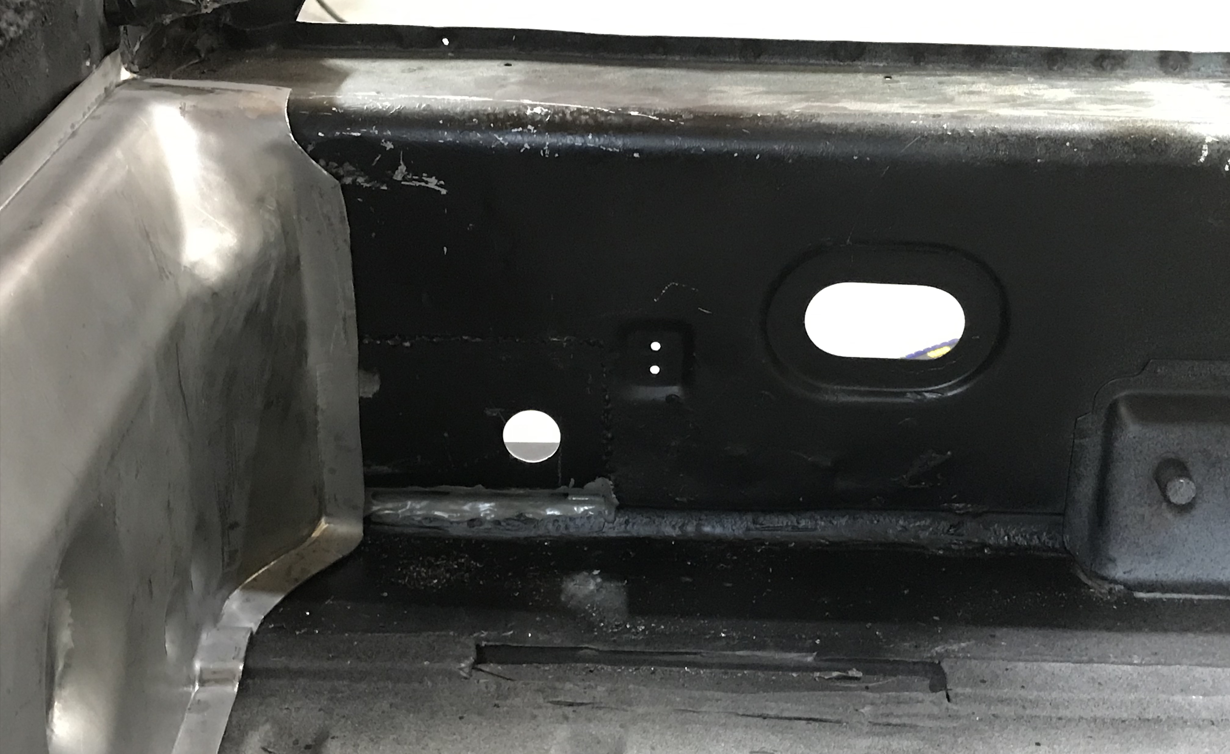

So got some measurements from the passenger side. Did a rough sketch of the set up
X marks the spot.
Dion
post Apr 16 2020, 07:40 PM
Post #630
RN
Posts: 2,839
From: Audubon,PA
Member No.: 2,766

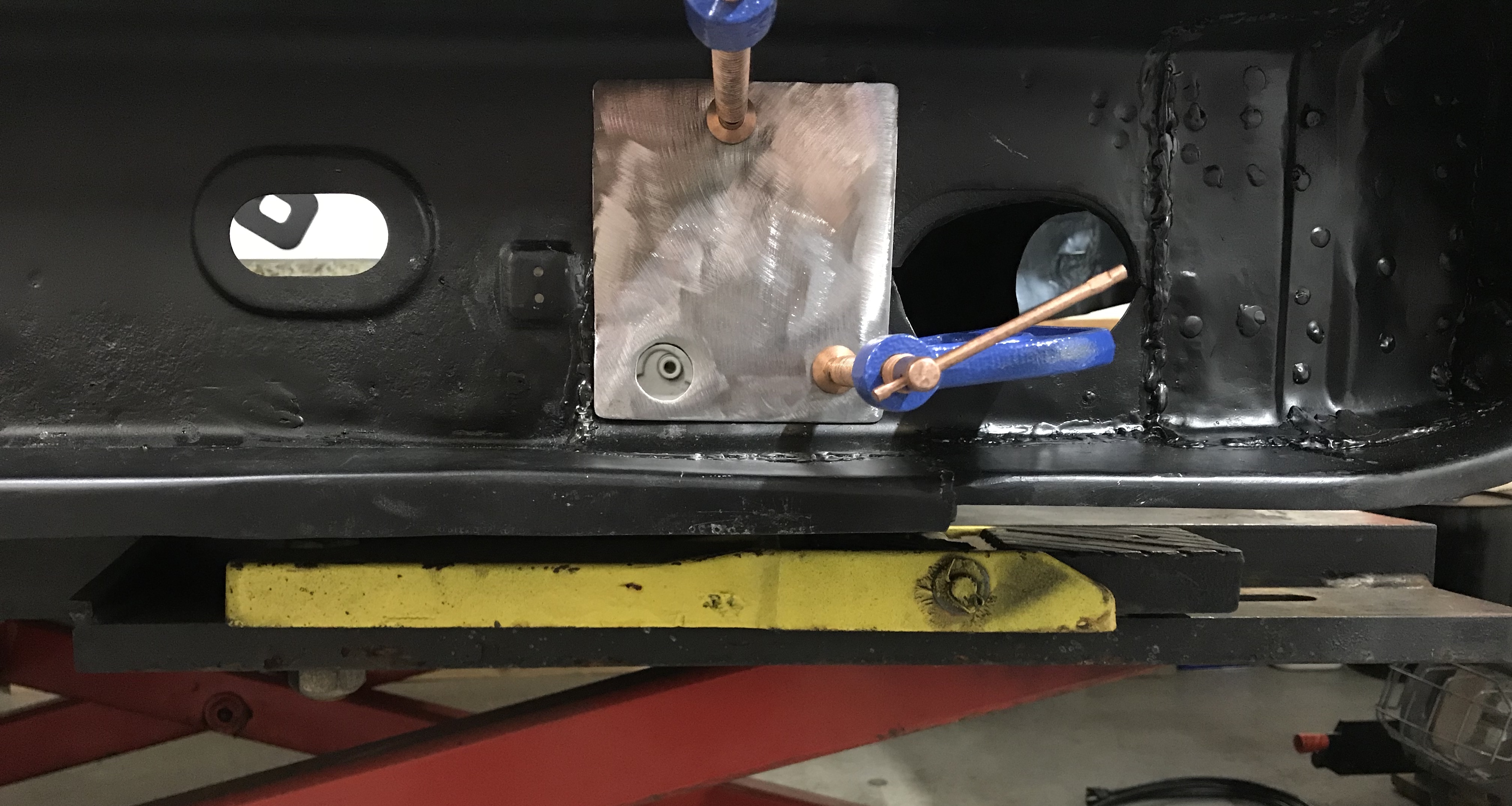

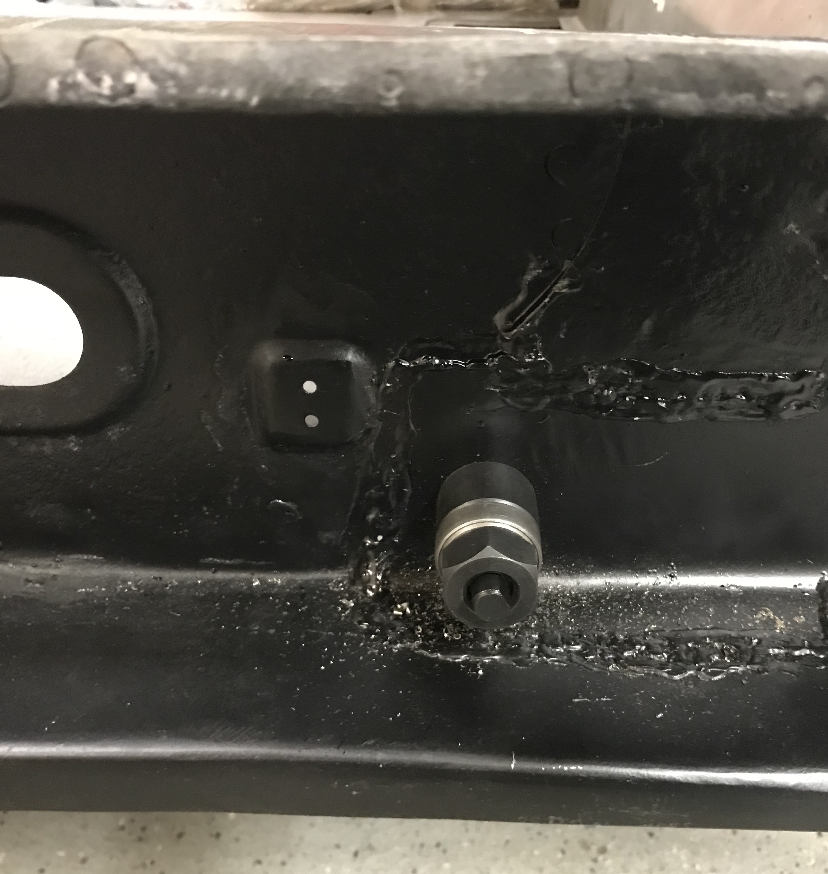

Used a metal punch to make a nice cut-out. Then did the same to the 16g plate.
Dion
post Apr 16 2020, 07:42 PM
Post #631
RN
Posts: 2,839
From: Audubon,PA
Member No.: 2,766

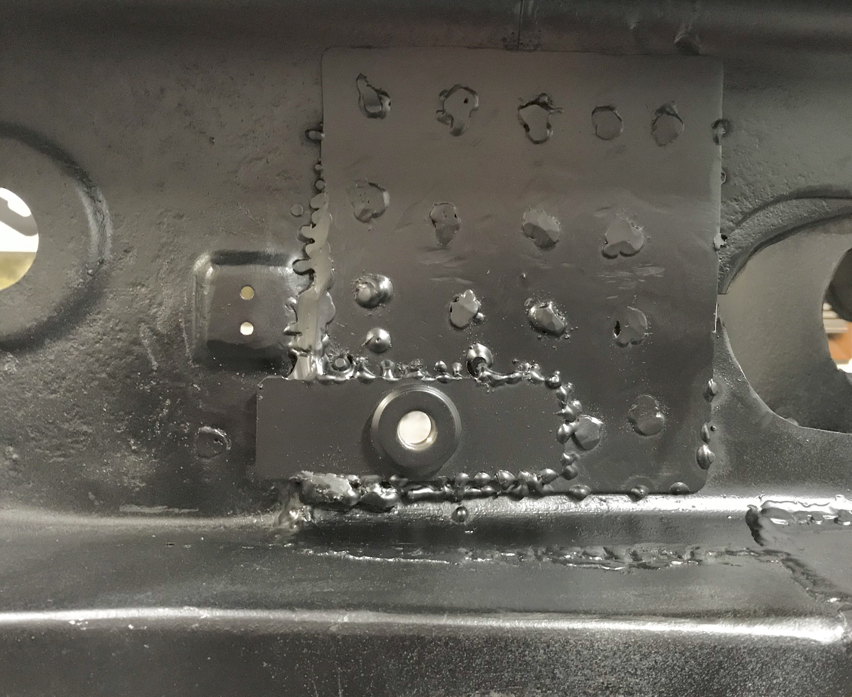

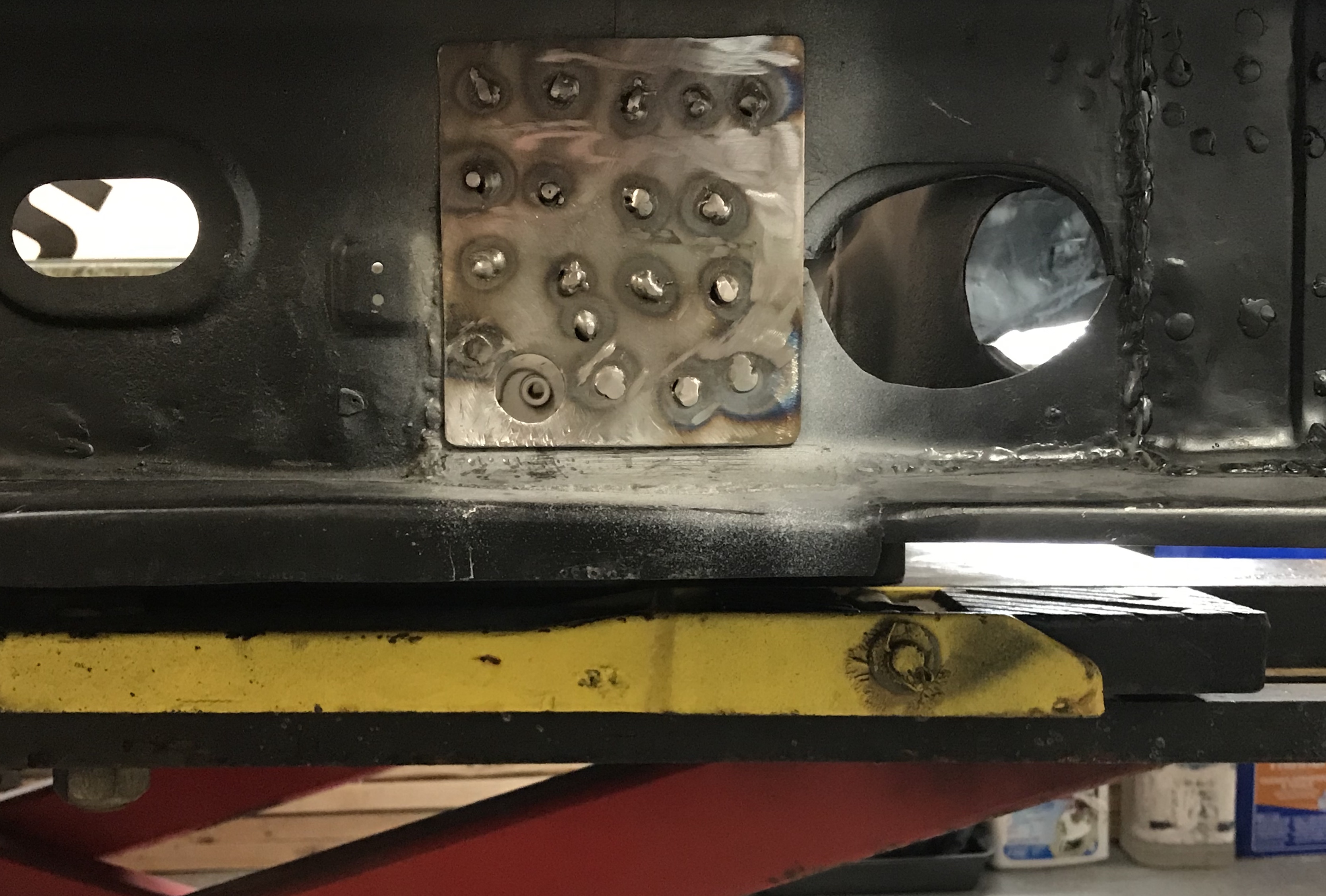

16g plate with punch out and then plug welded together.
Dion
post Apr 16 2020, 07:45 PM
Post #632
RN
Posts: 2,839
From: Audubon,PA
Member No.: 2,766

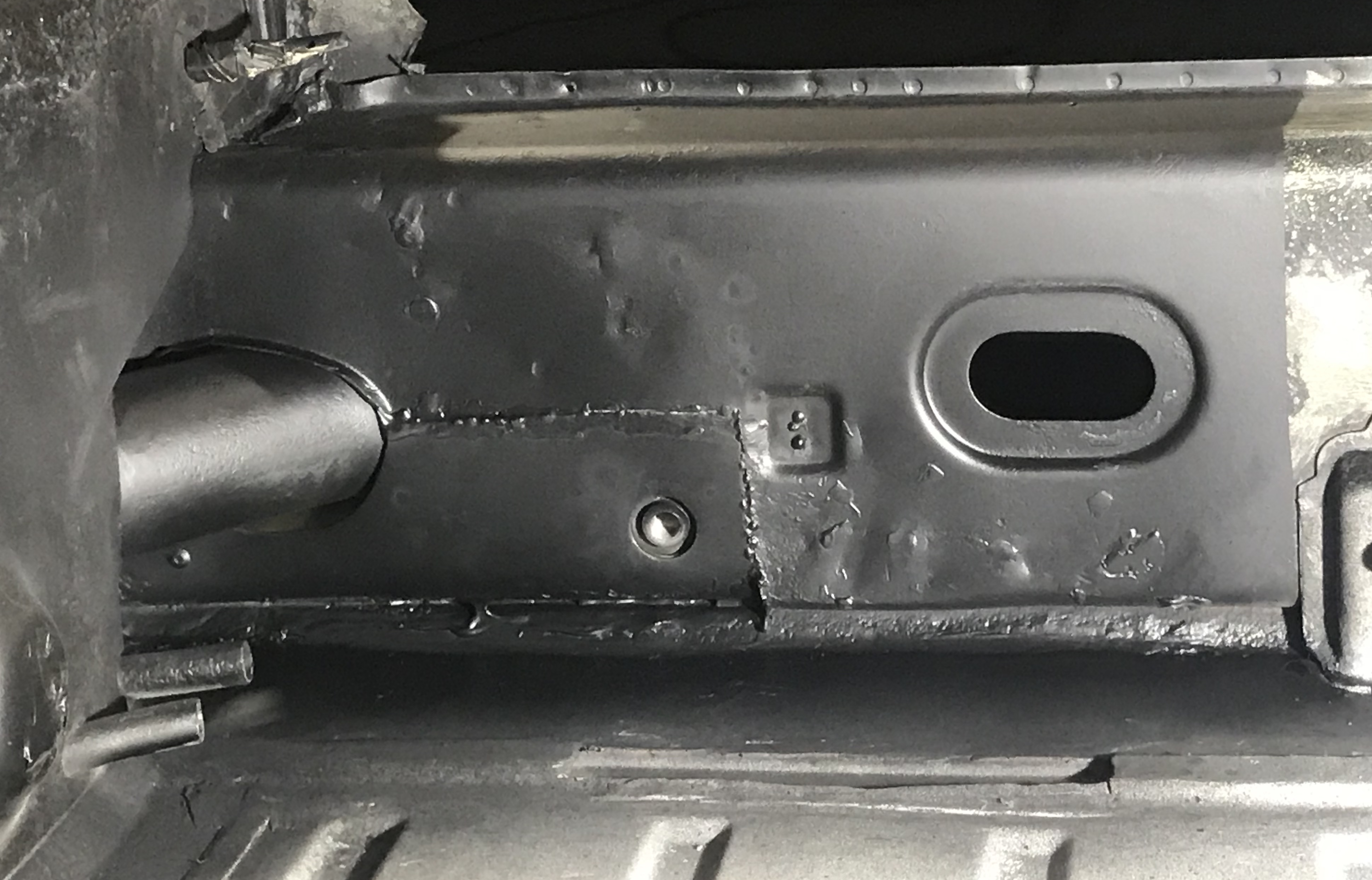

Actual seatbelt bolt/plate courtesy Restoration Design.
Welded in place.

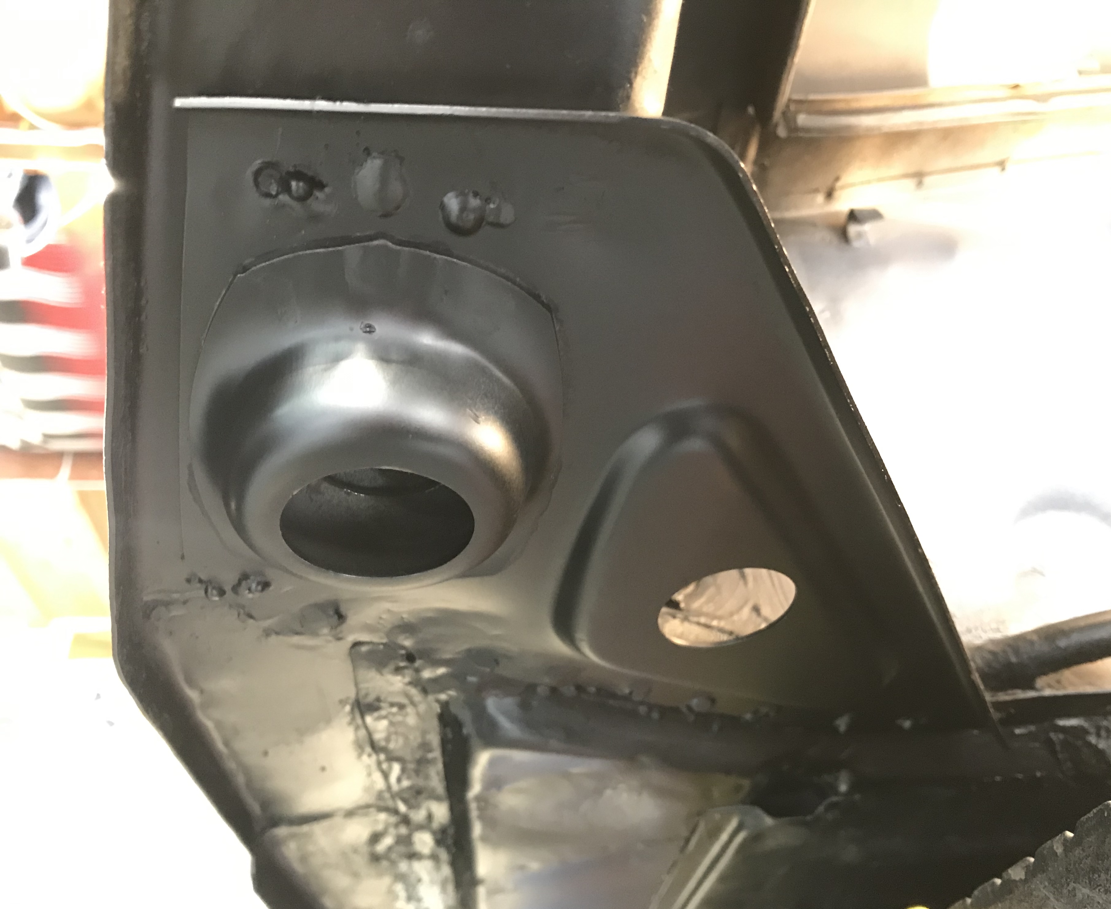

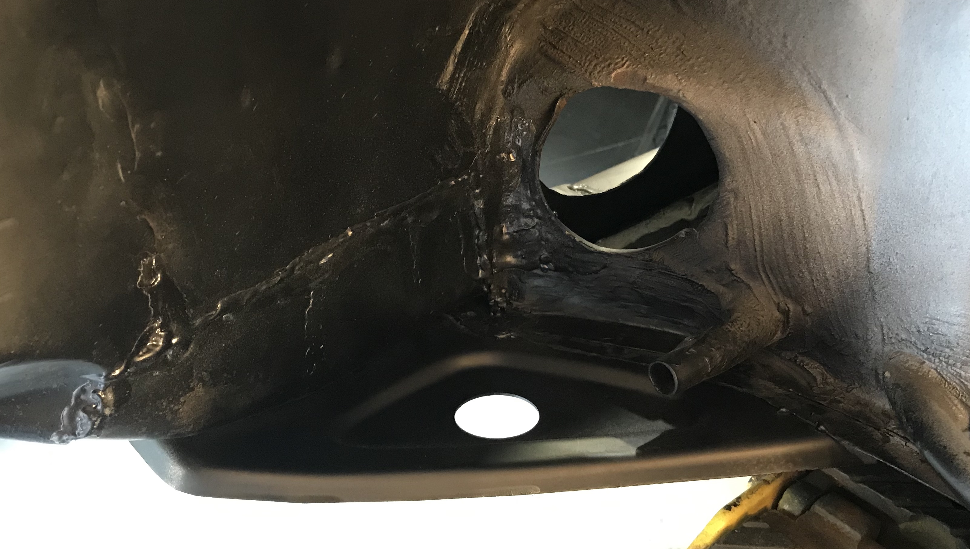

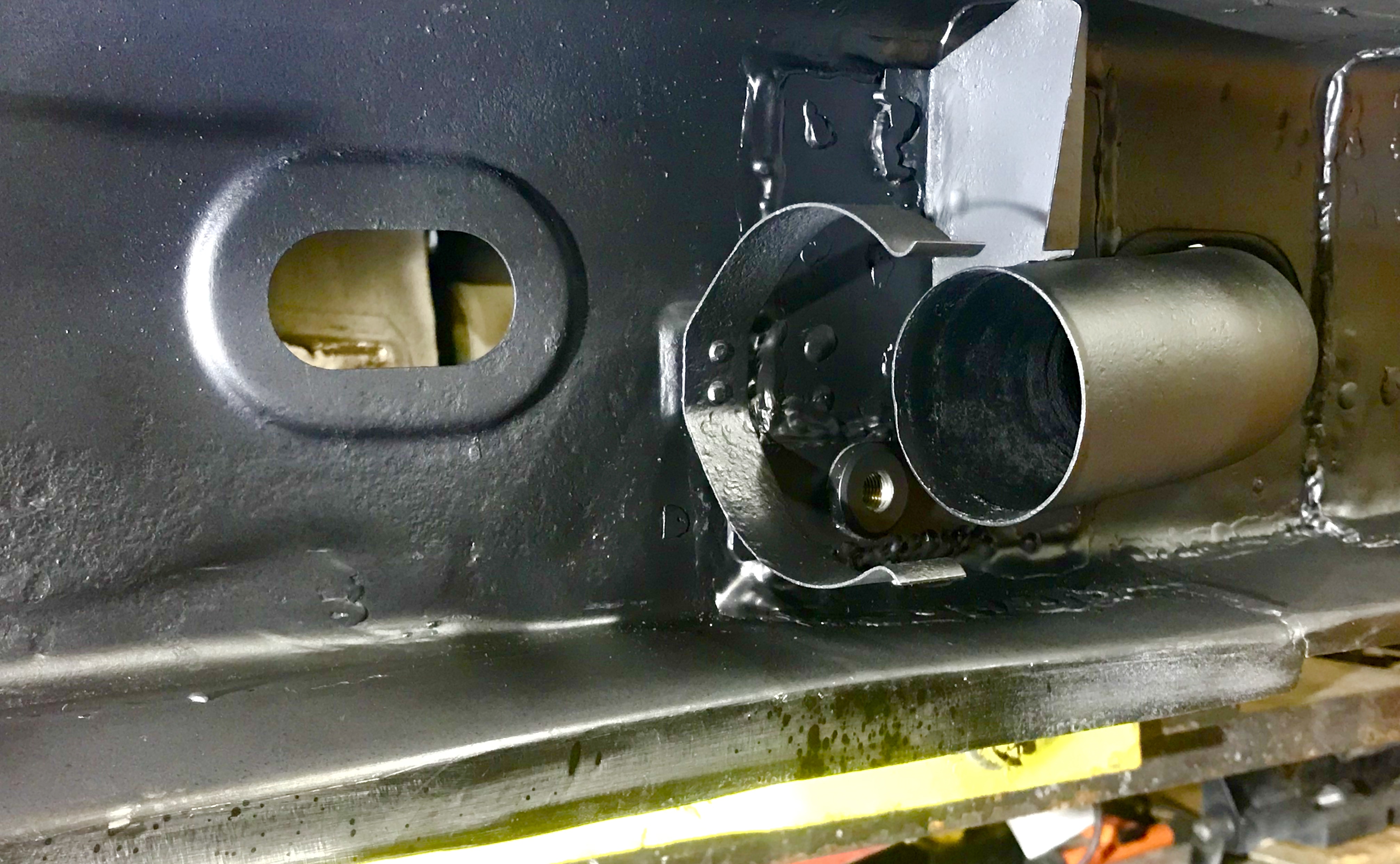

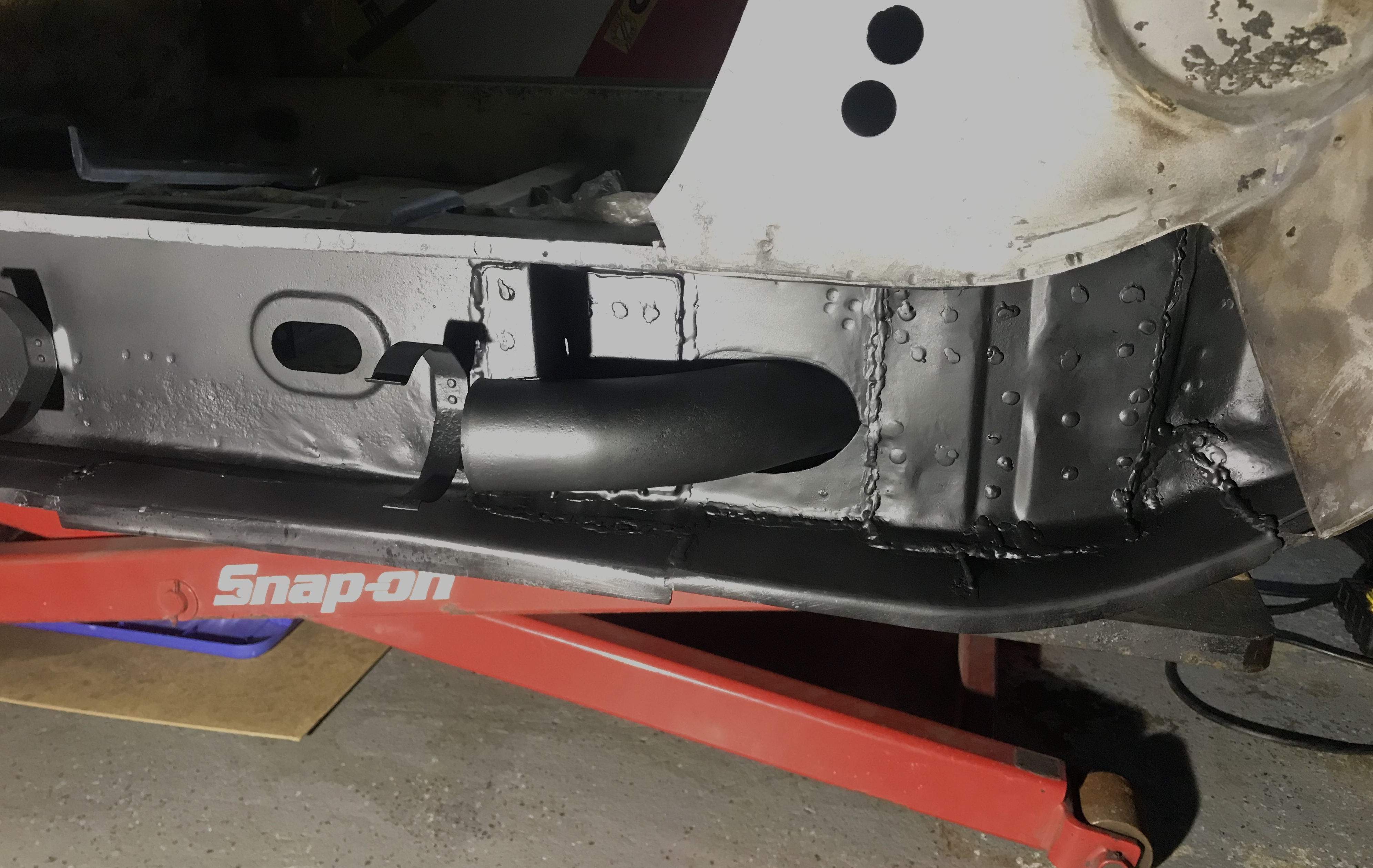

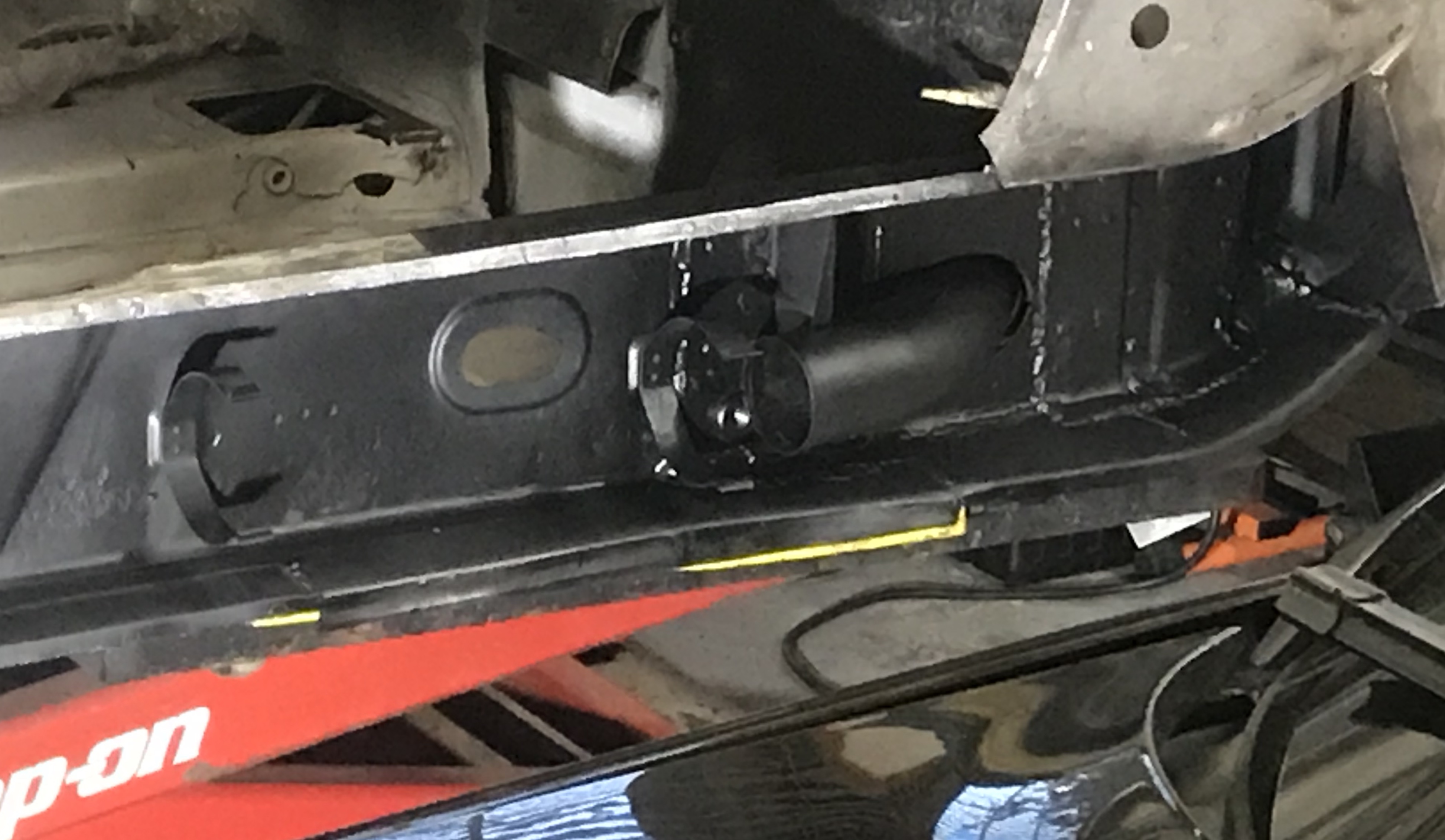

Next tacked on the heater tube and the flexible tube bracket.
Dion
post Apr 16 2020, 07:49 PM
Post #634
RN
Posts: 2,839
From: Audubon,PA
Member No.: 2,766
Starting to look proper again.
