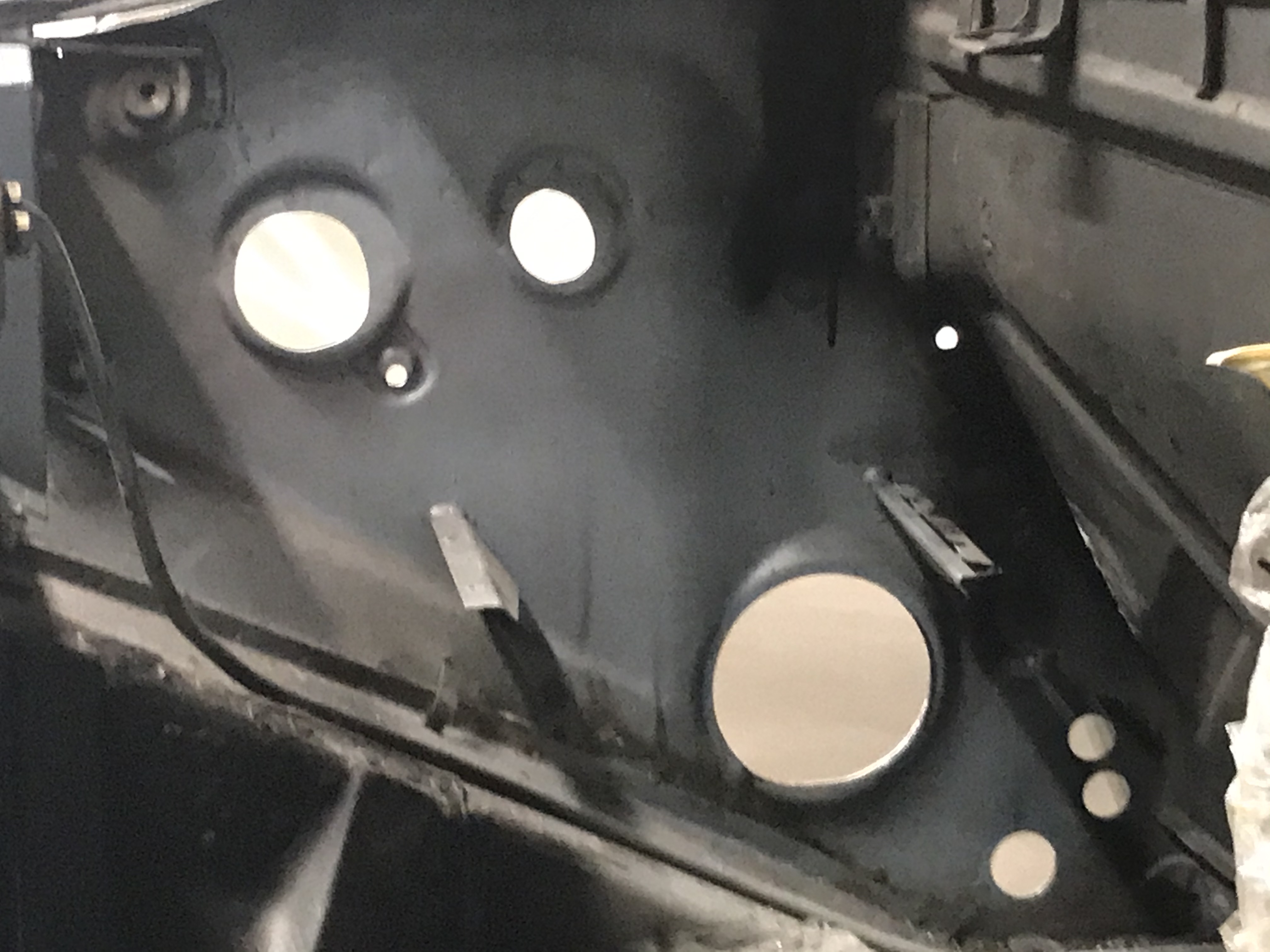

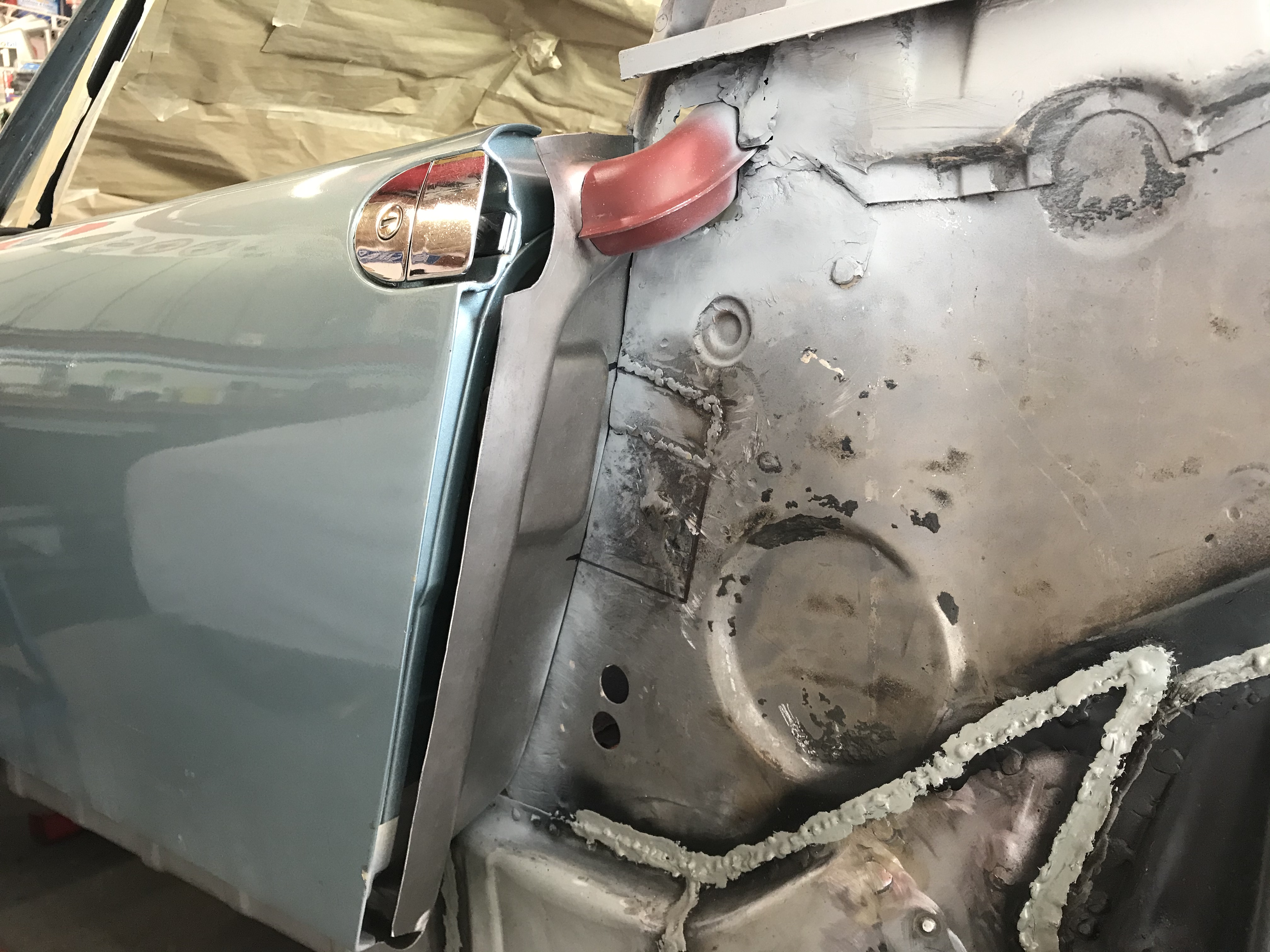

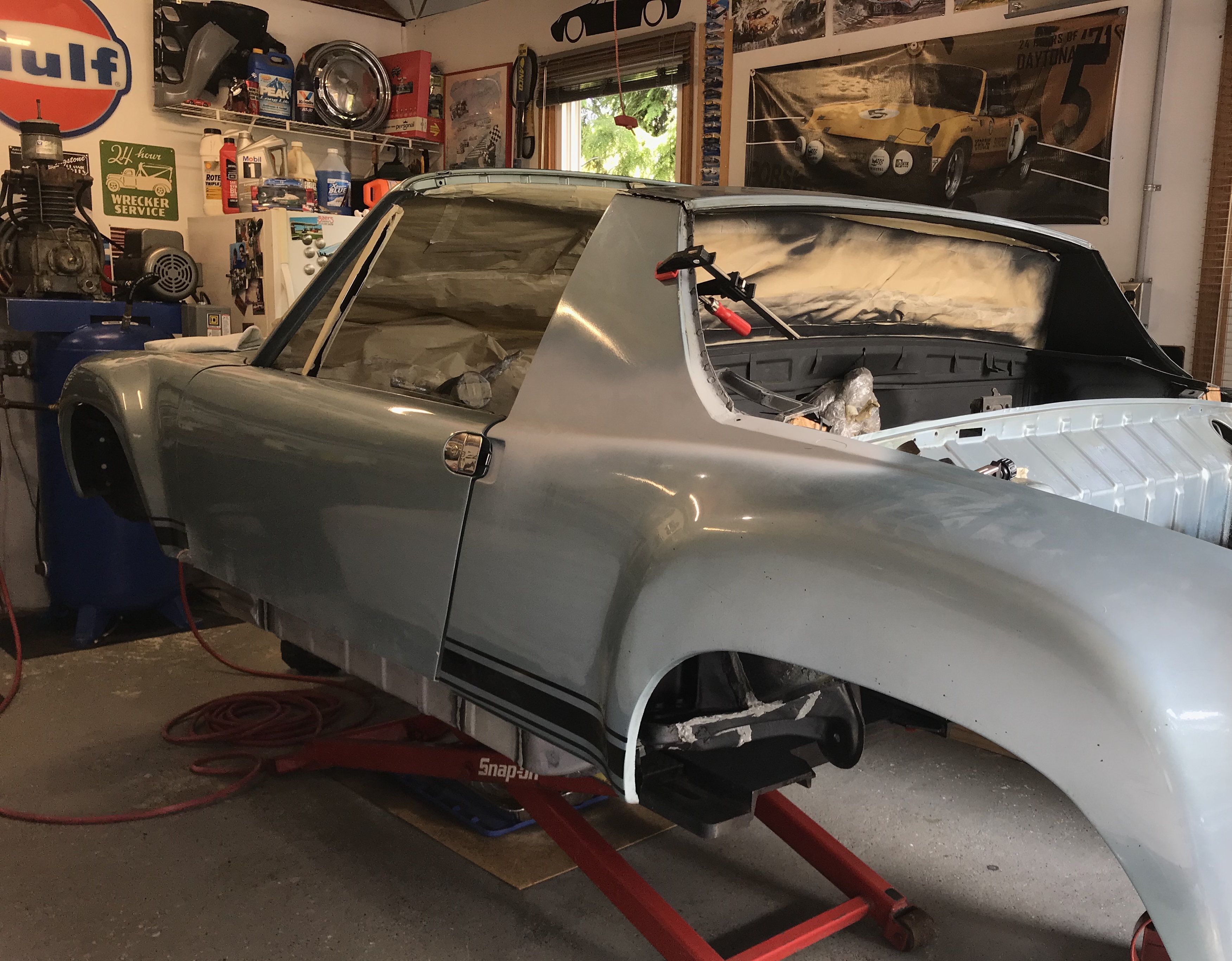

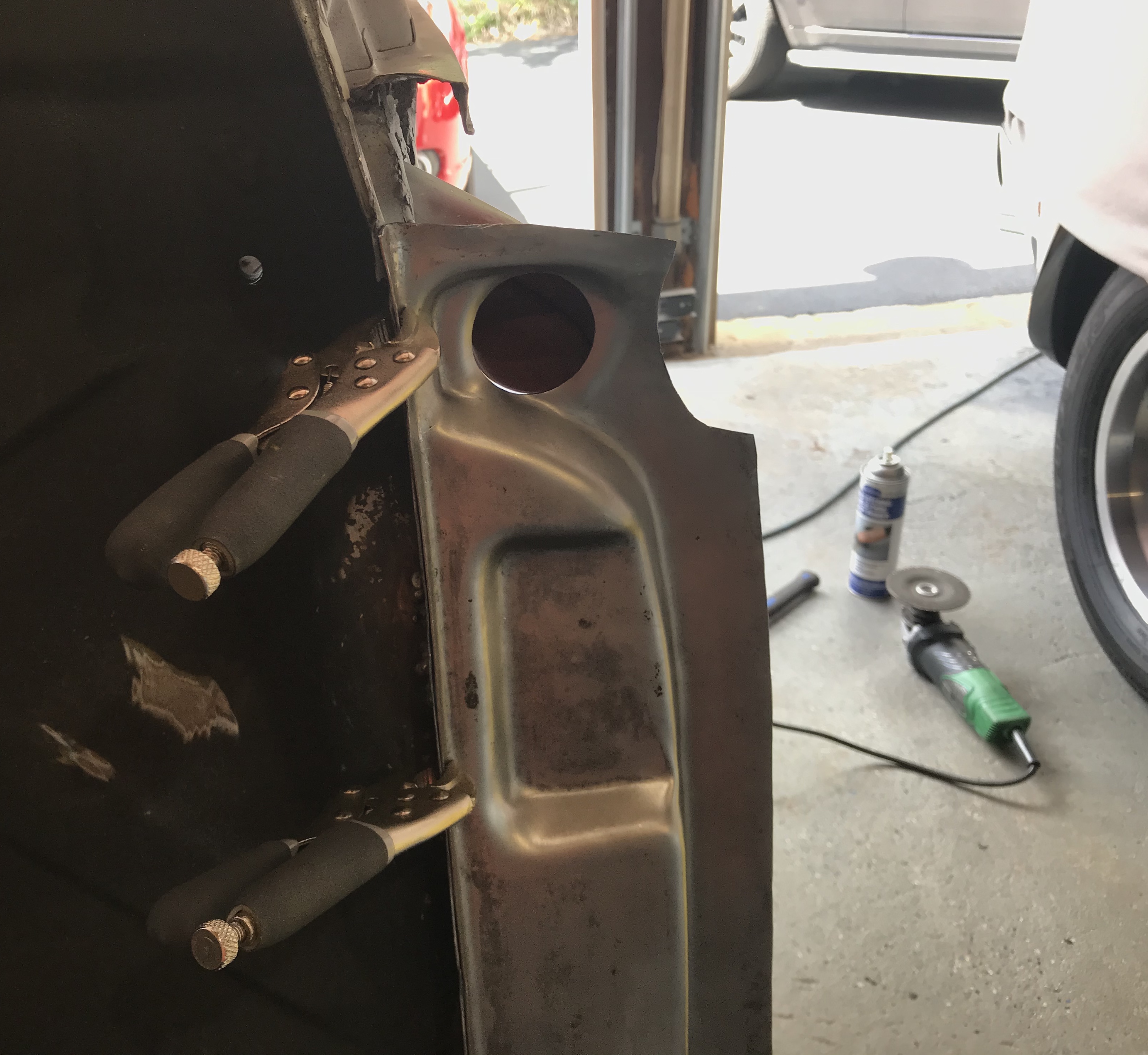

In addition to adding the new metal, I needed to make another hole for the fresh air elbow and test fit the door jamb.
Dion
post Jun 29 2020, 01:54 PM
Post #702
RN
Posts: 2,839
Joined: 16-September 04
From: Audubon,PA
Member No.: 2,766
Trying to line everything up. Talked with @bbrock for a few ideas.
Dion
post Jun 29 2020, 01:57 PM
Post #703
RN
Posts: 2,839
From: Audubon,PA
Member No.: 2,766

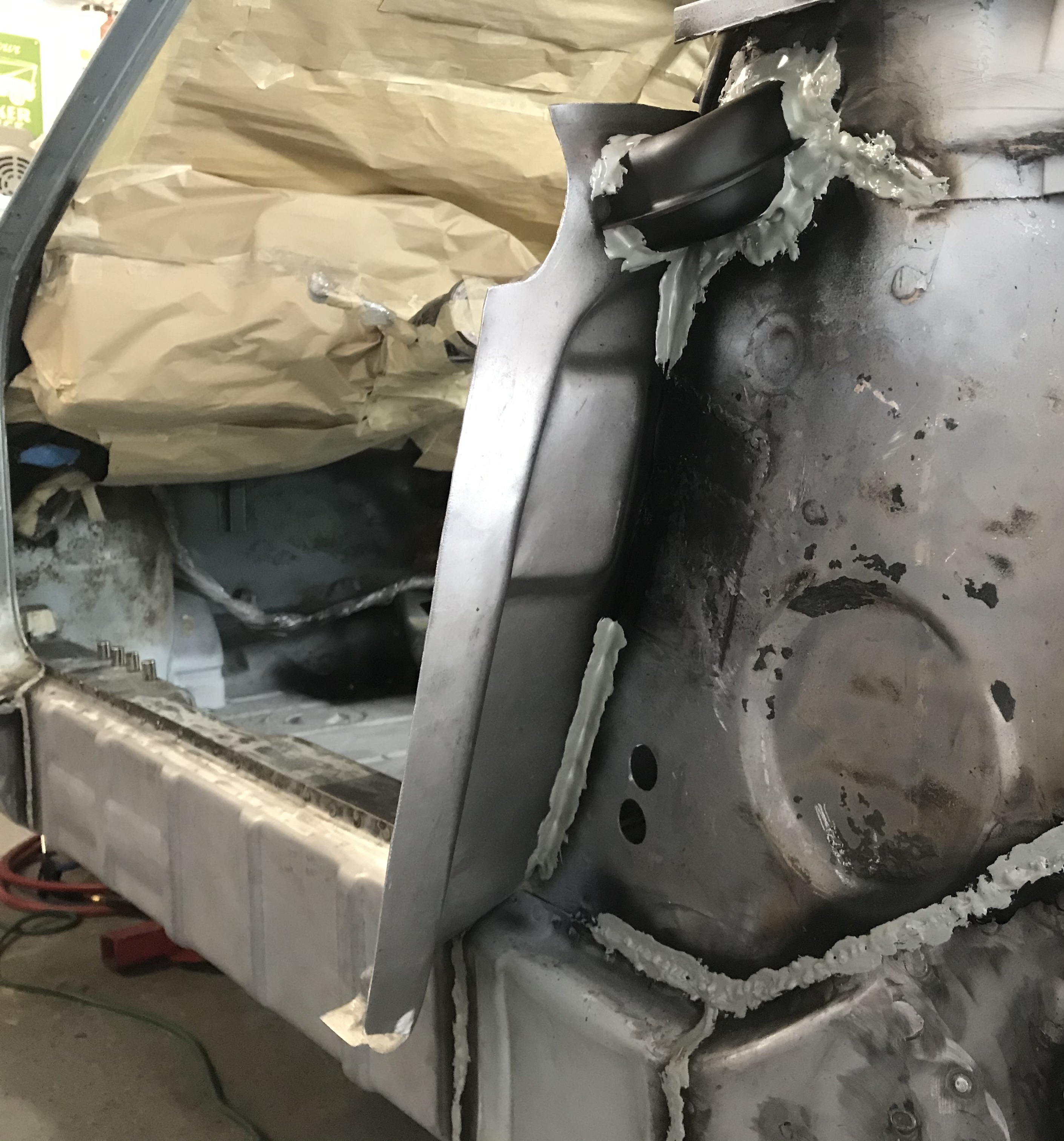

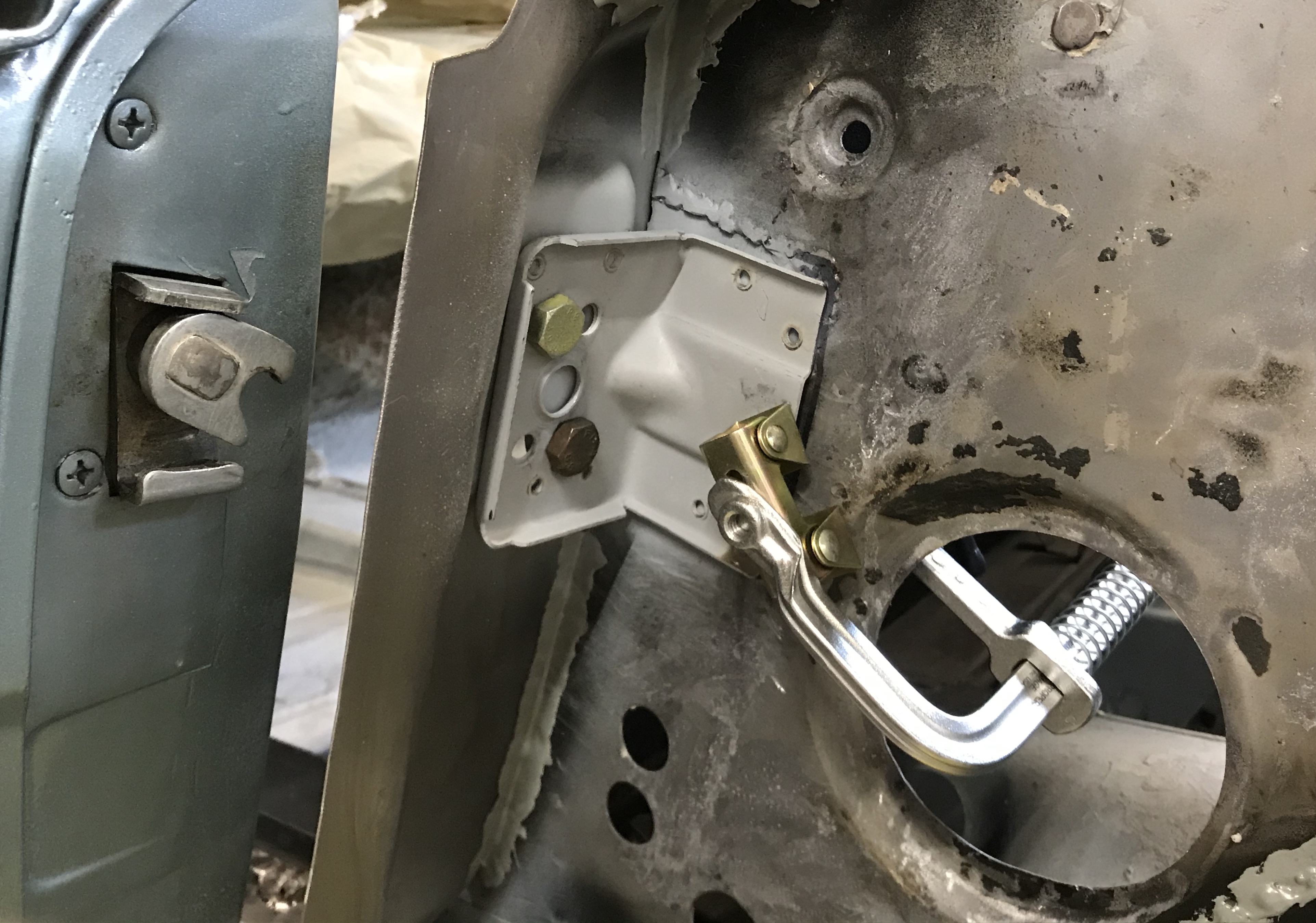

Door jamb positioned and clamped. Welded it in.
Some of the outer edge will need to be ground down as it sits too proud and pushes out the rear fender.
Dion
post Jun 29 2020, 02:04 PM
Post #704
RN
Posts: 2,839
From: Audubon,PA
Member No.: 2,766

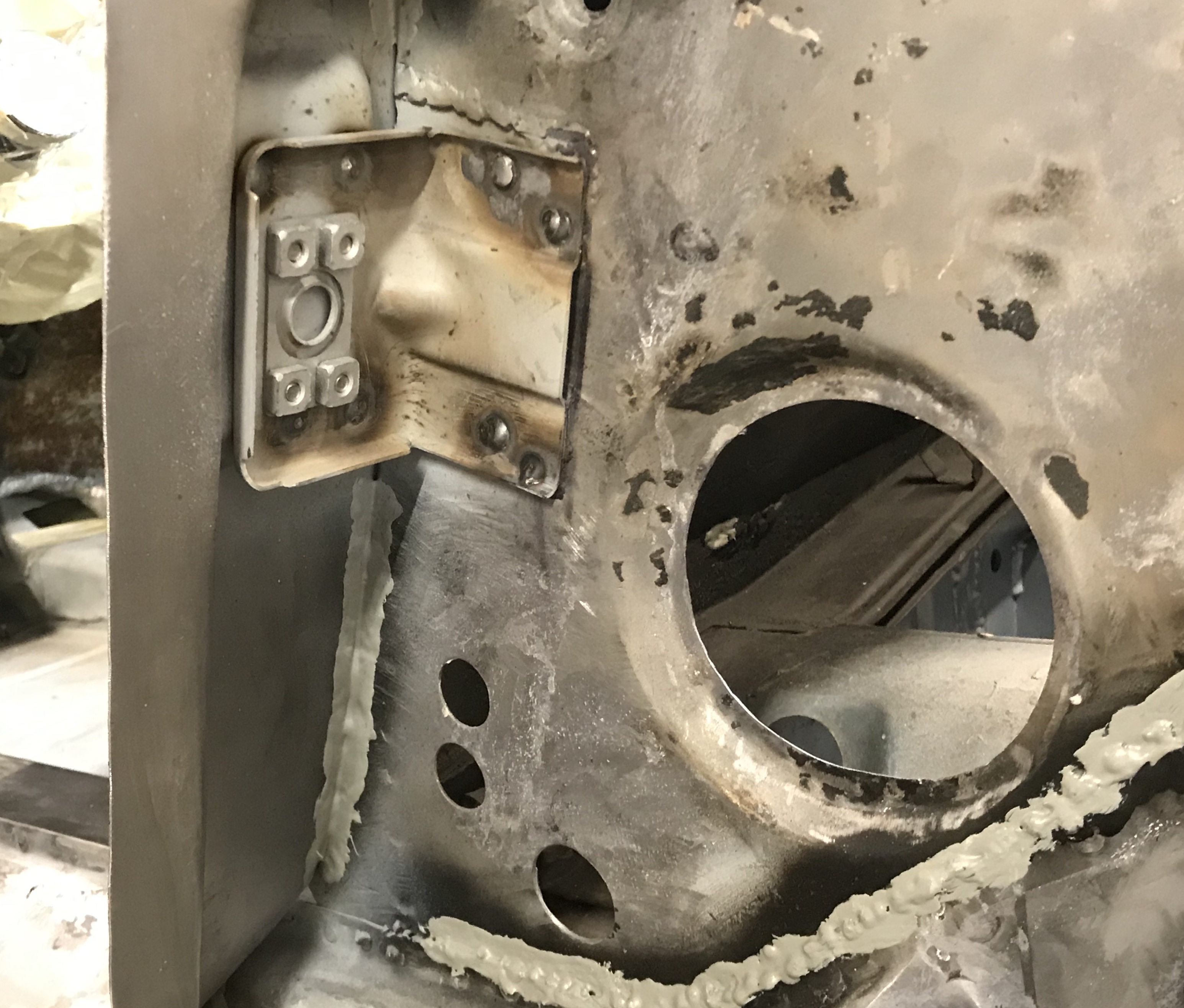

Seam sealed around air tube. Still need backing plate for latch to go on and placement f the sill & triangles. That’s up next.
As well as need to drill out the holes for the six oil tank.
Thanks for listening. (IMG:style_emoticons/default/biggrin.gif)

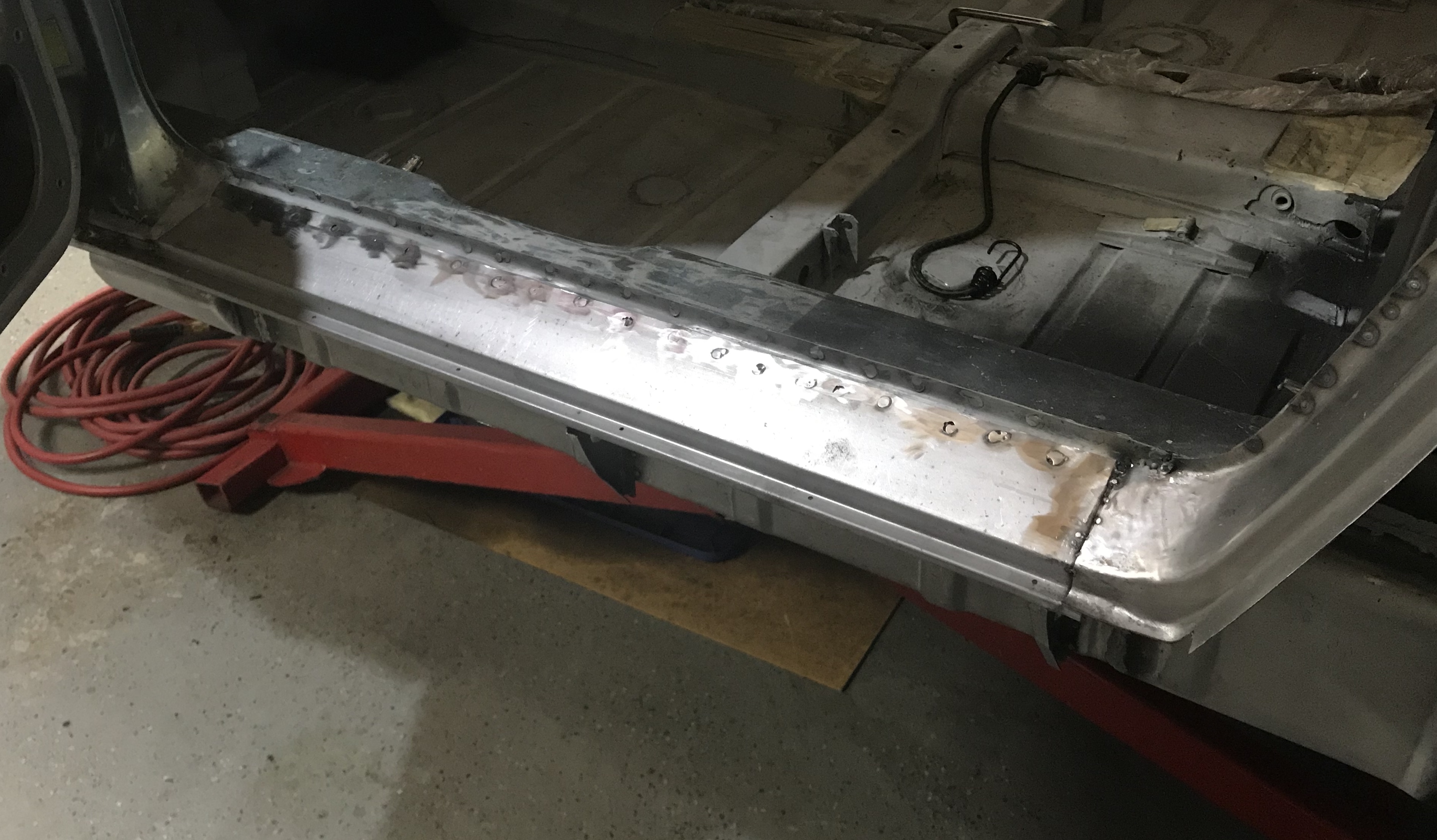

Some updates.

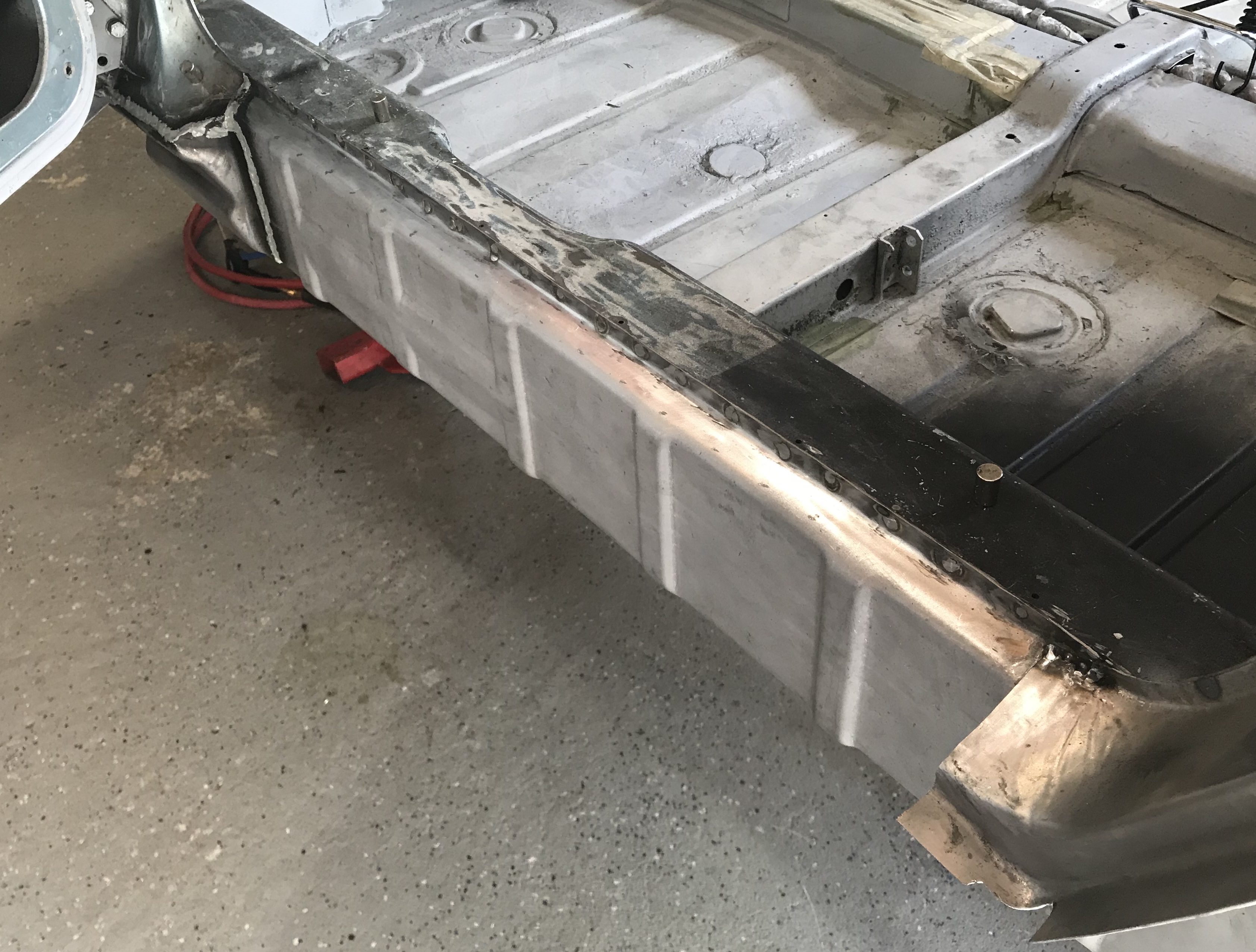

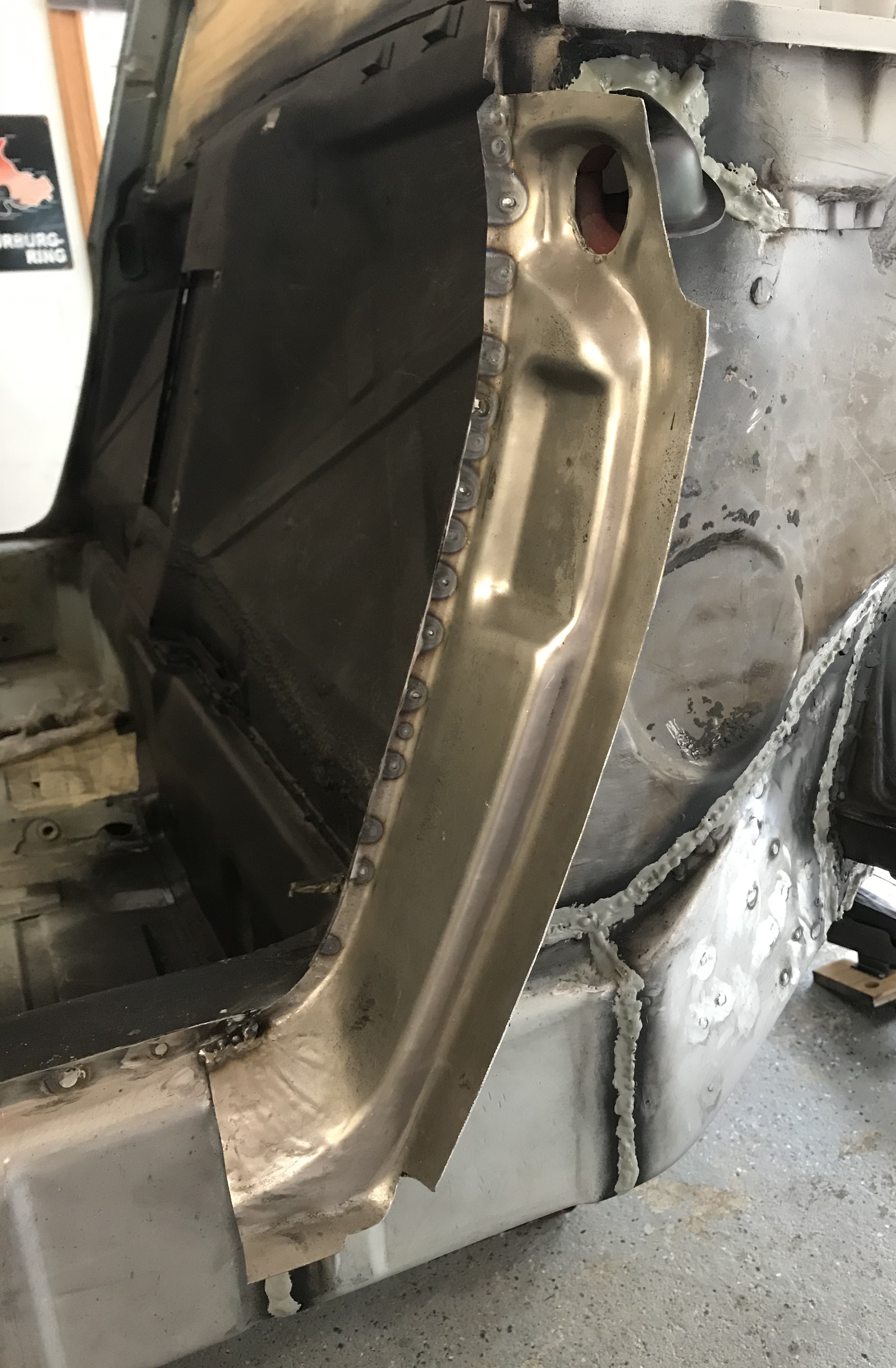

Welded on the new sill and triangle supports.
still need to make one for the very front of long and make another triangle for the passenger side. Right side has been without one for the past twenty plus years!
I’ll venture to say not needed but I’ll make one anyway. Just want to wait now till temps drop. It’s been 90 plus degrees all week here. Humidity is off the wall.

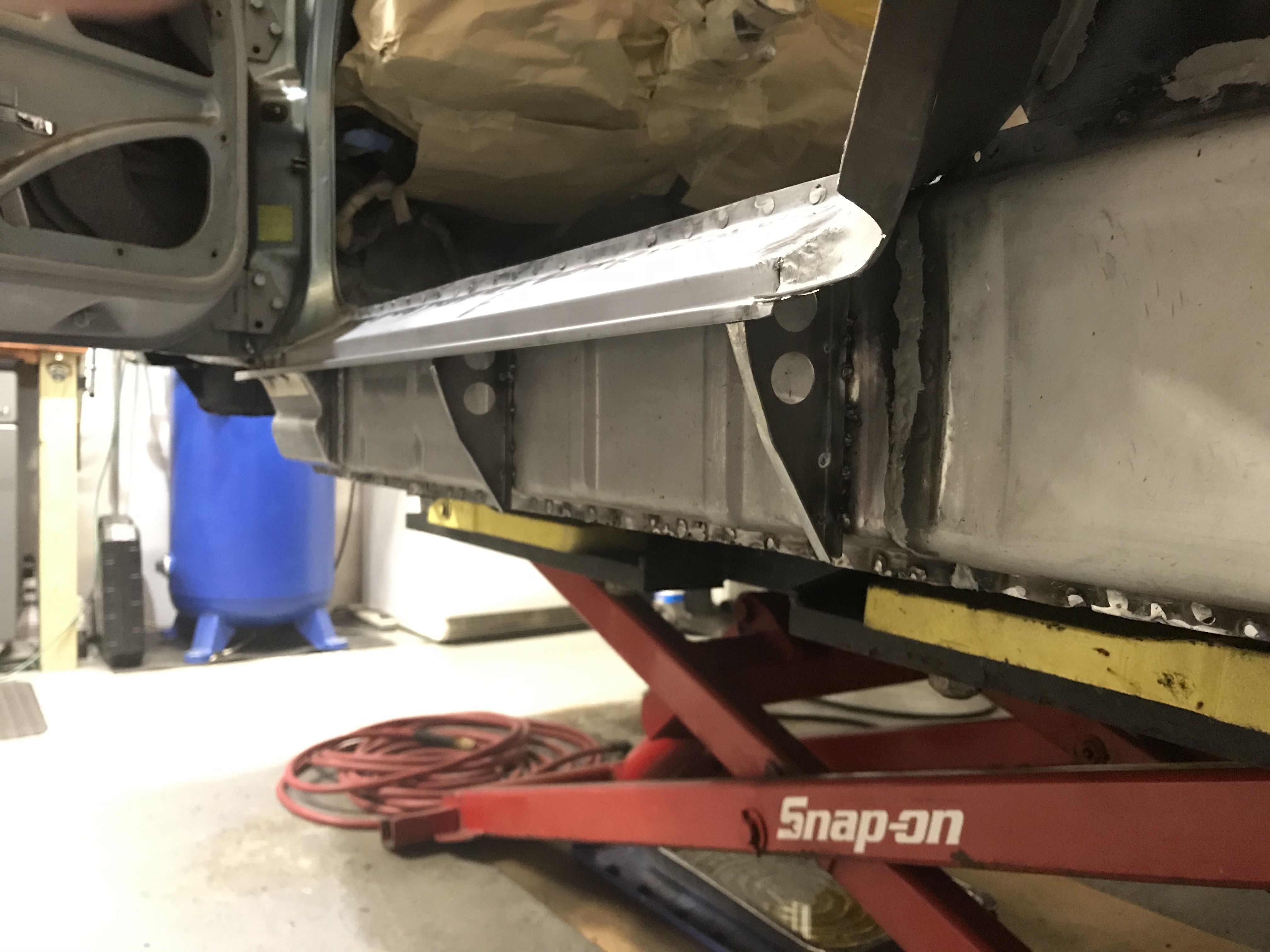

Triangle supports

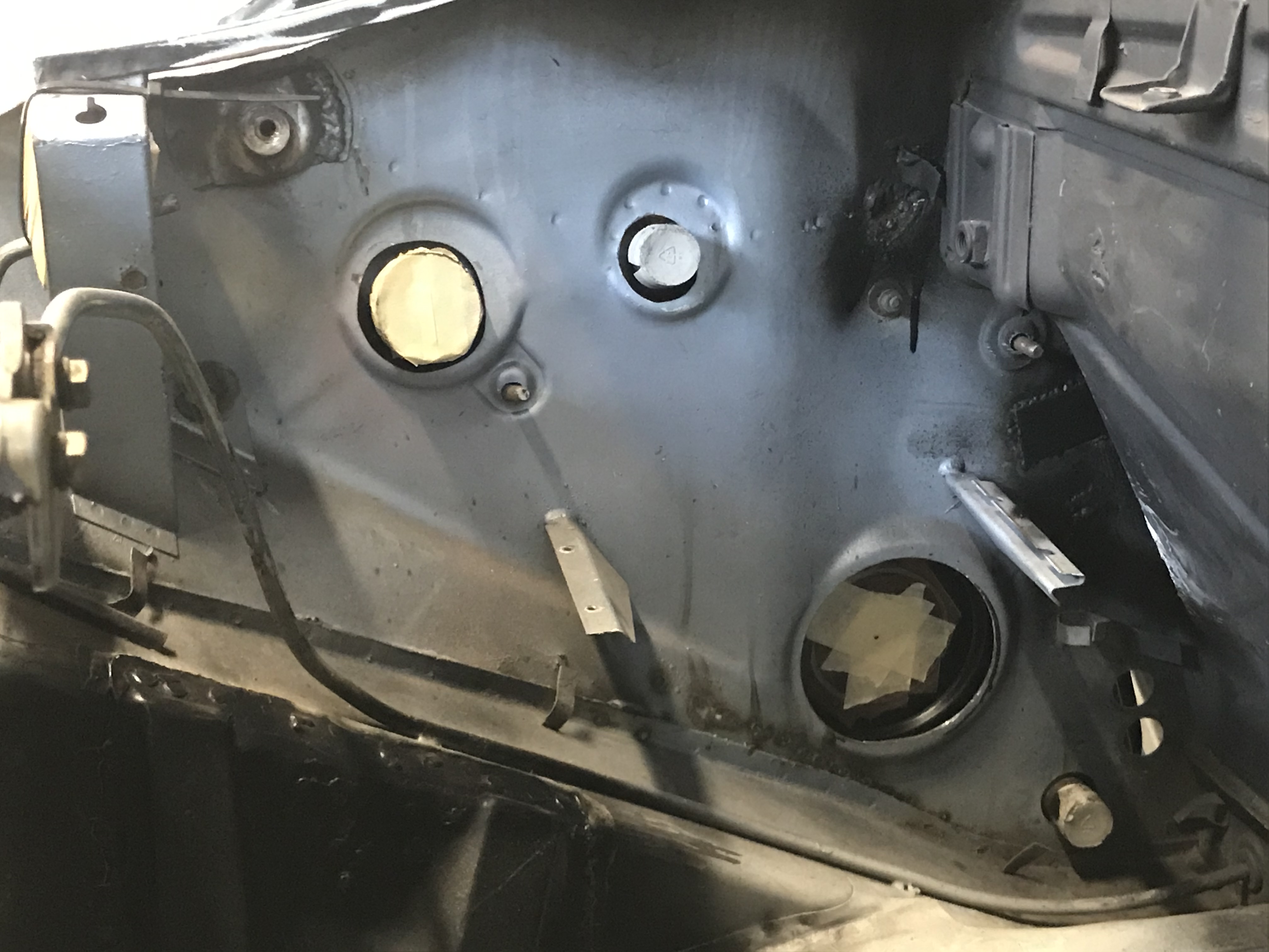

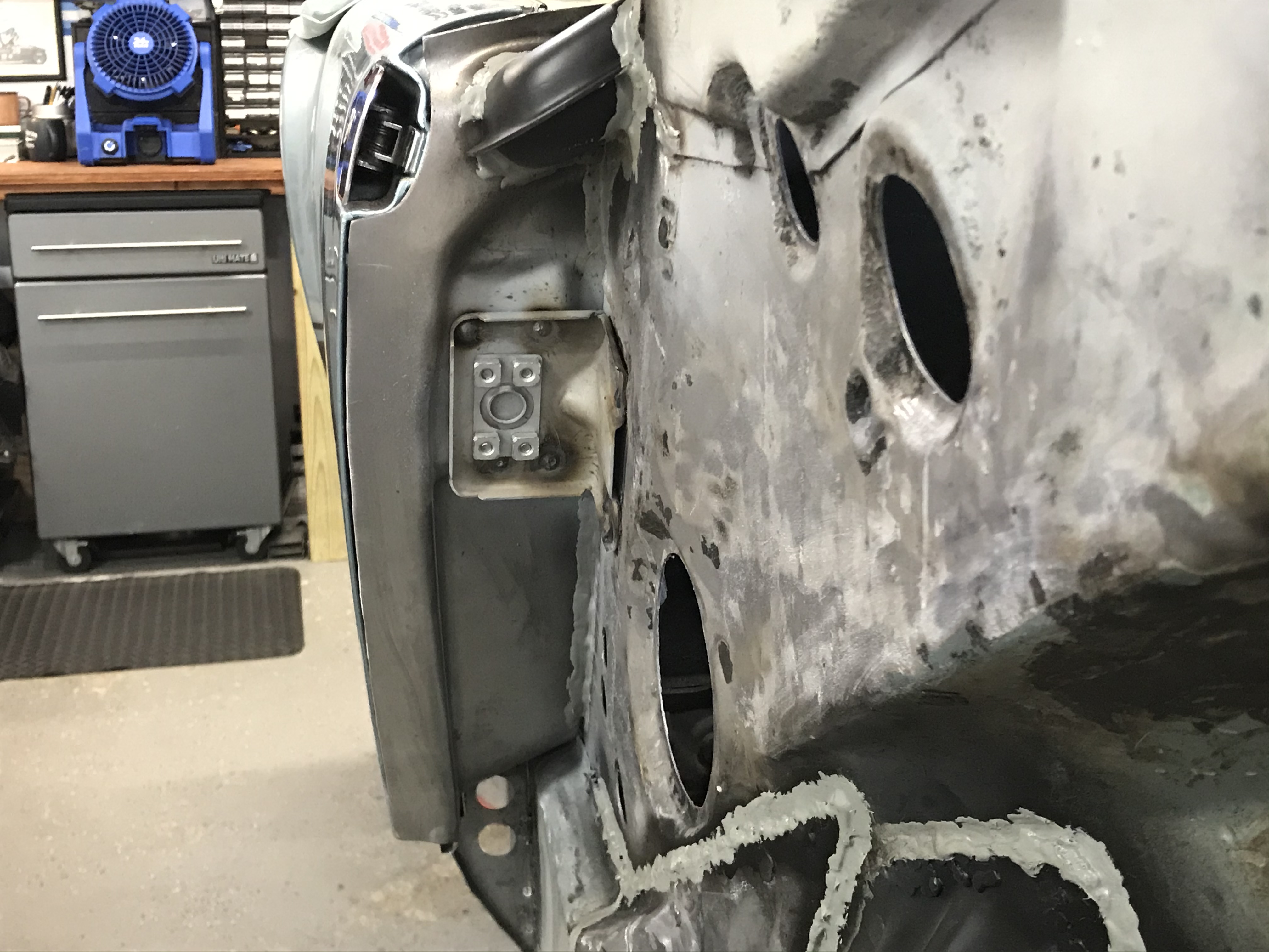

Moved on to opening up the oil tank bosses. Anyone who drilled these open with an engine in place or the fender still on.... well ... hats off to ya! That 4” hole was a mother!

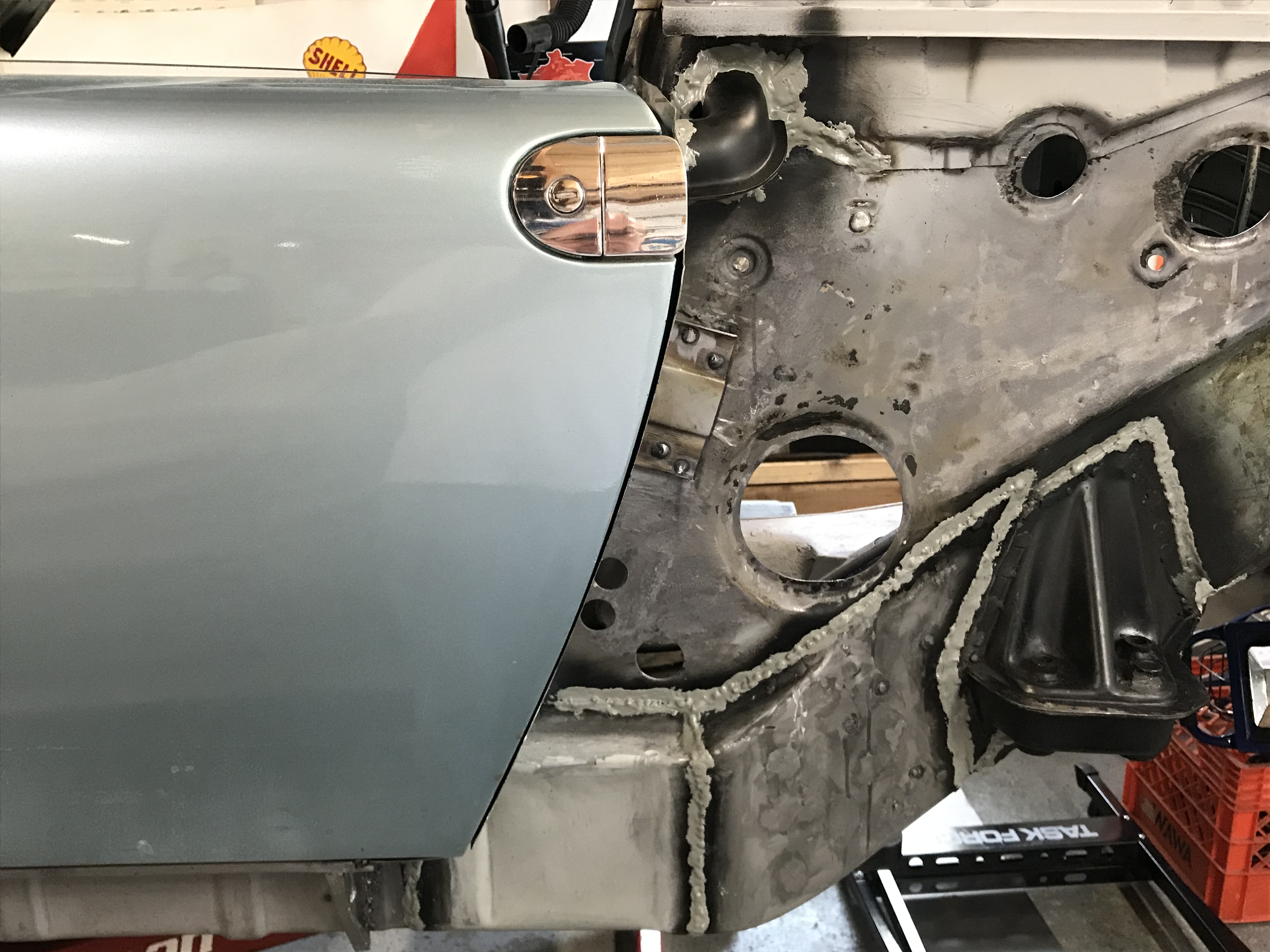

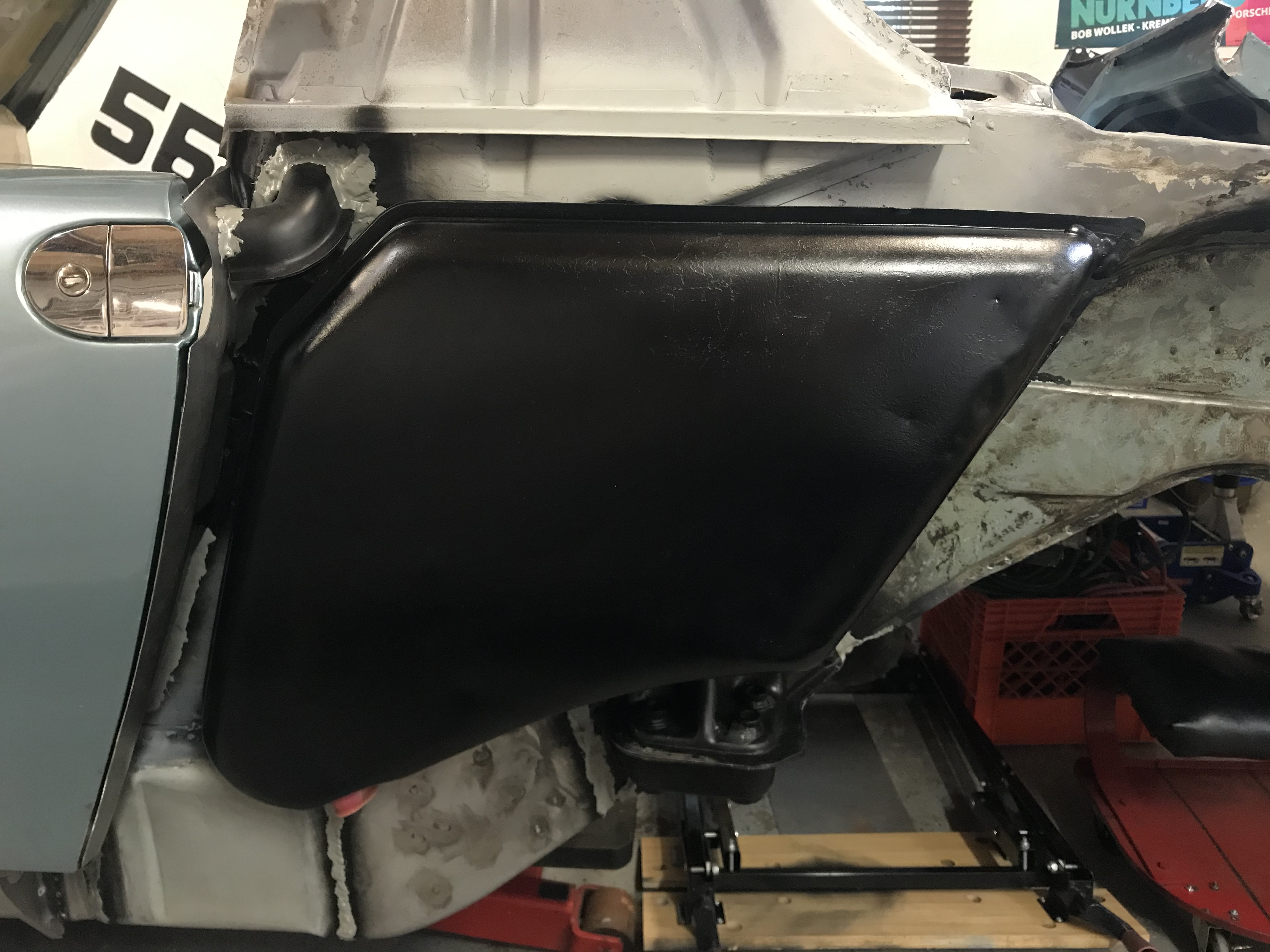

Test fit the tank. All is well.

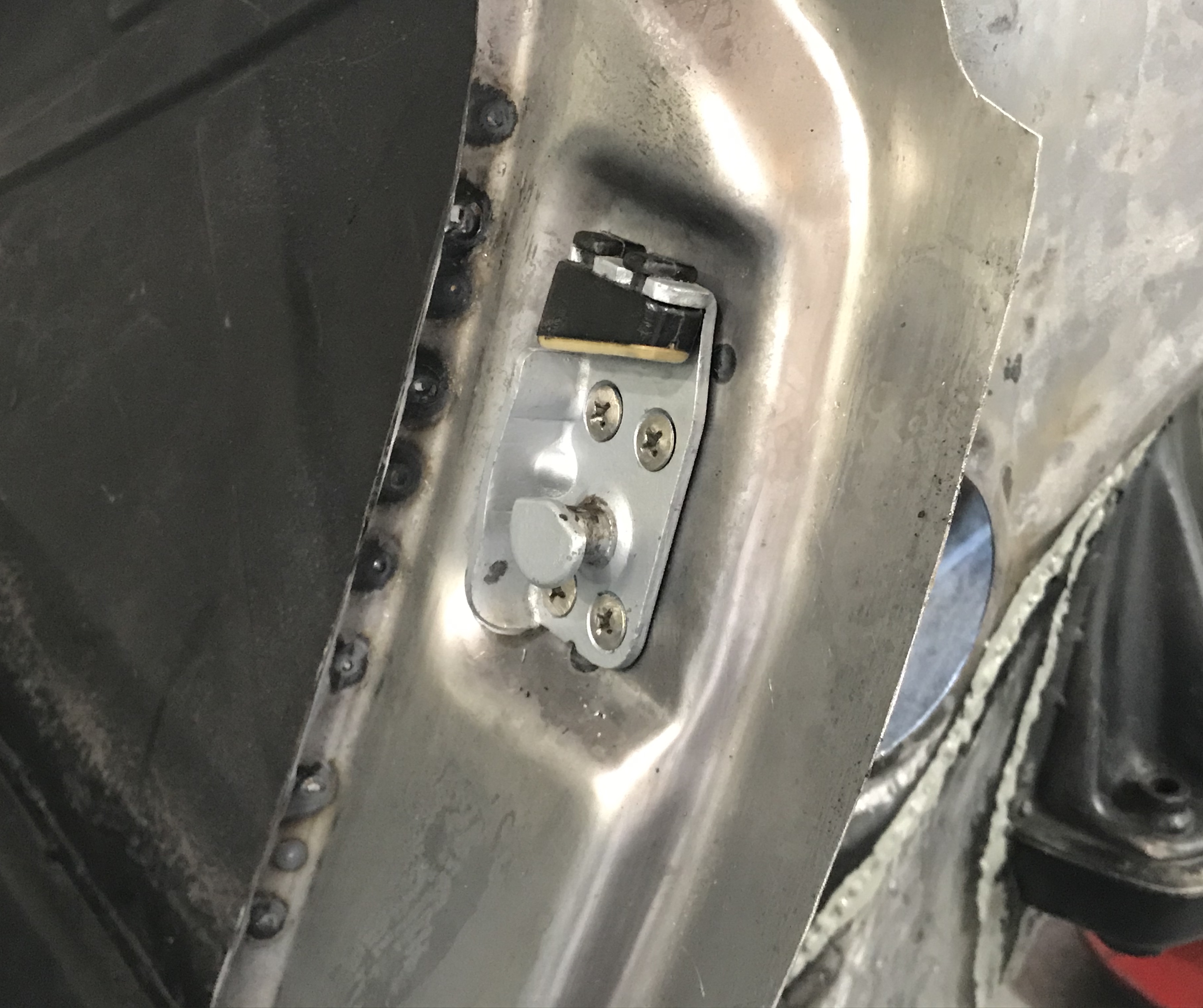

Welded in the door catch plate.

Door and jamb seem to be good. Rear fender needs some more TLC before I place it back on, so that’ll be up next.

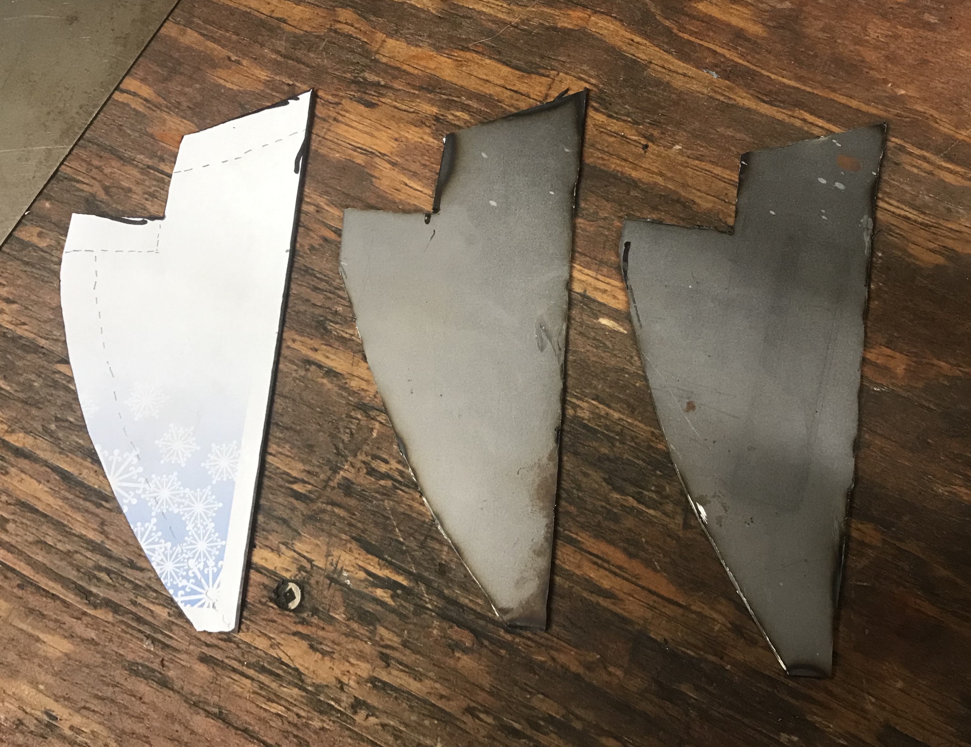

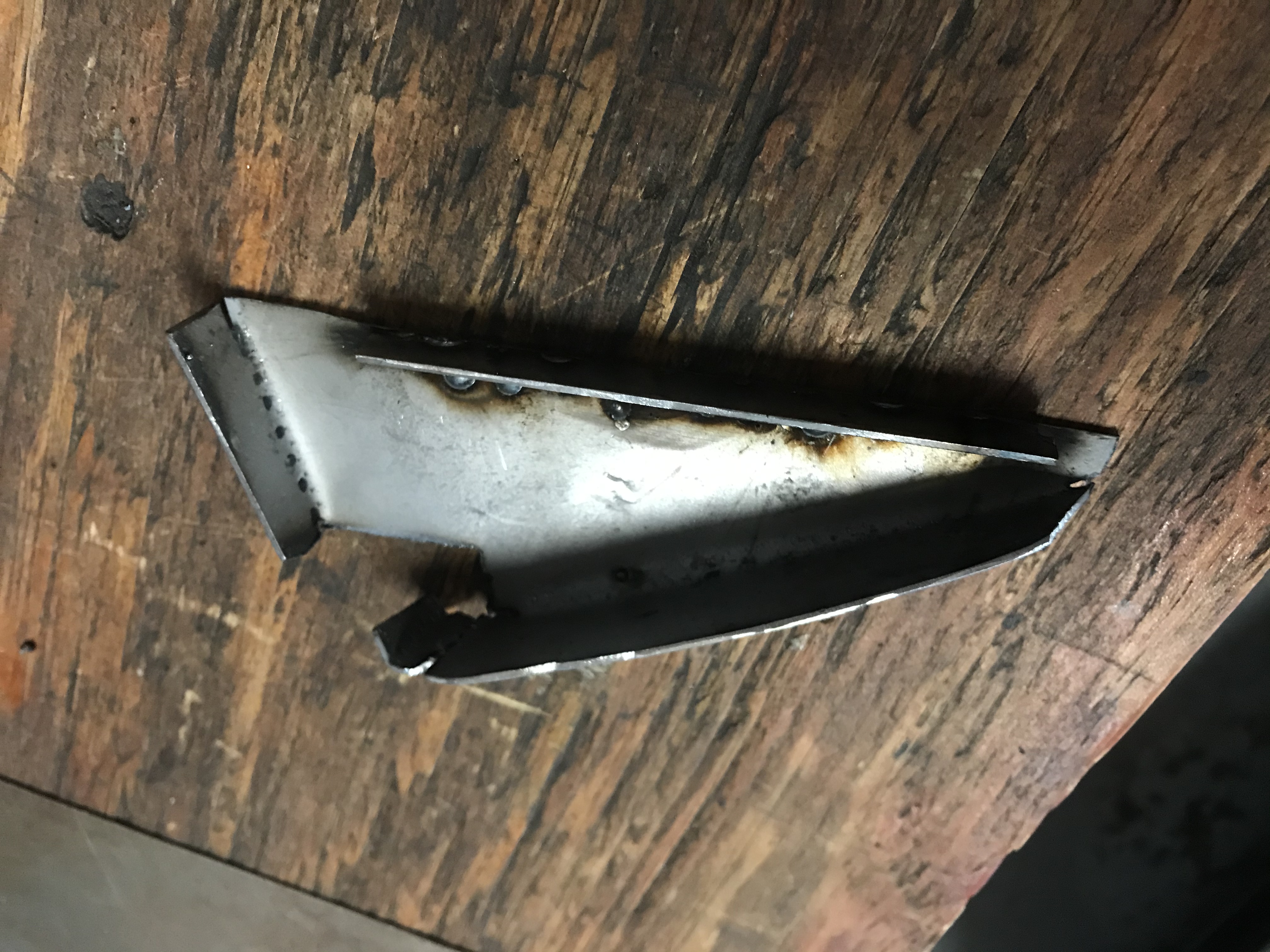

Had some time today and made up those sill triangles.
As I said my right sill only had one support all these years after being worked on back in the 90’s. I’ll need to primer them yet. One more item off the list.

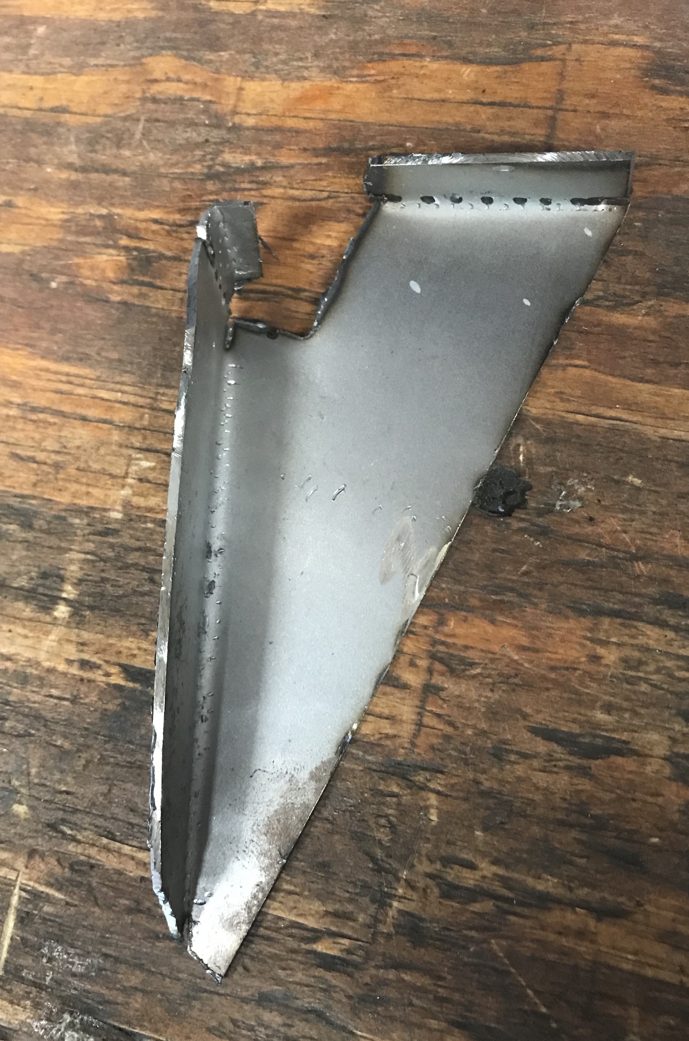

Made a small template then crudely cut out a shape. Started forming it using a small brass hammer and my vice/anvil.
Dion
post Jul 13 2020, 09:33 PM
Post #720
RN
Posts: 2,839
From: Audubon,PA
Member No.: 2,766
Then tacked on a base plate.
