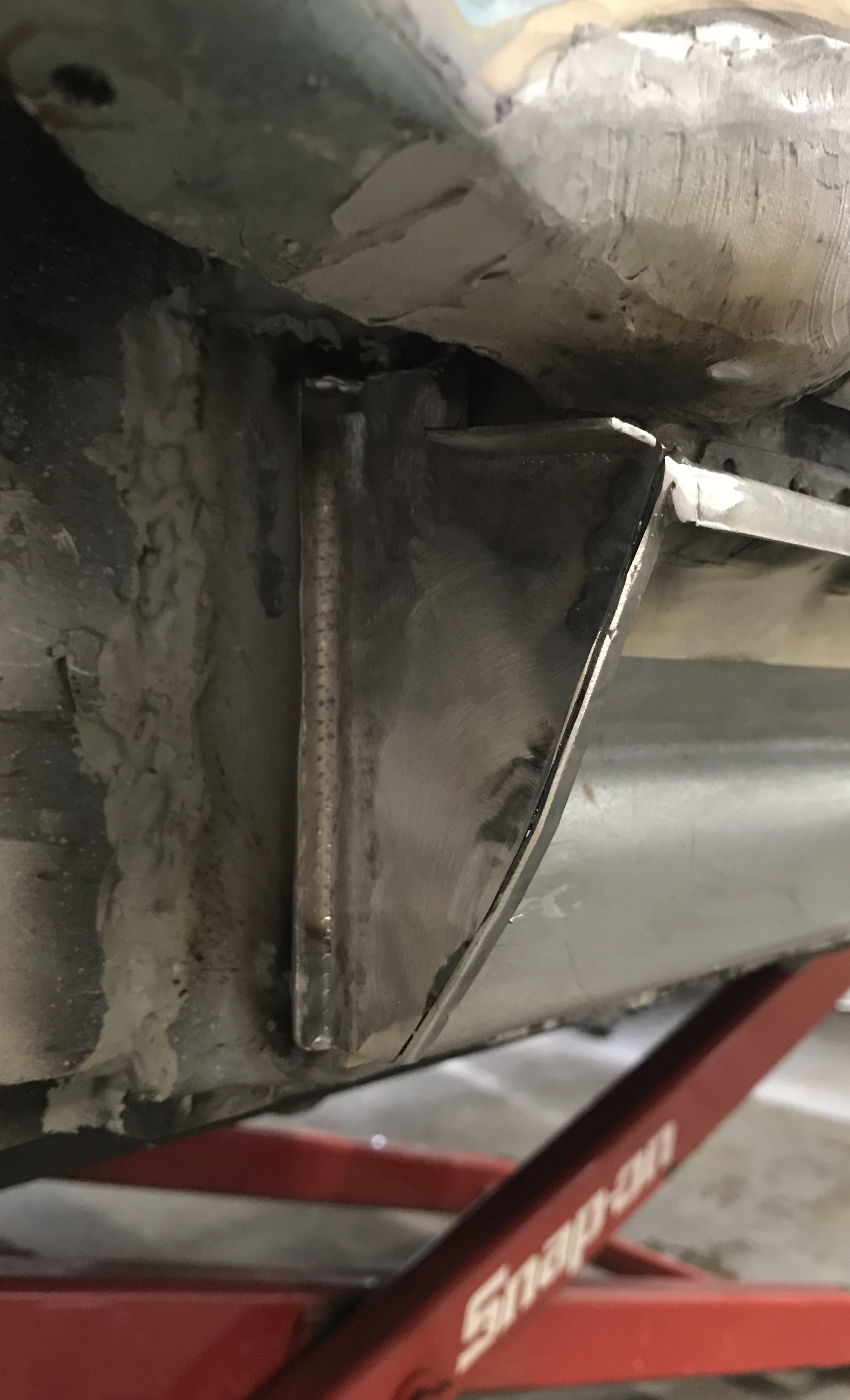

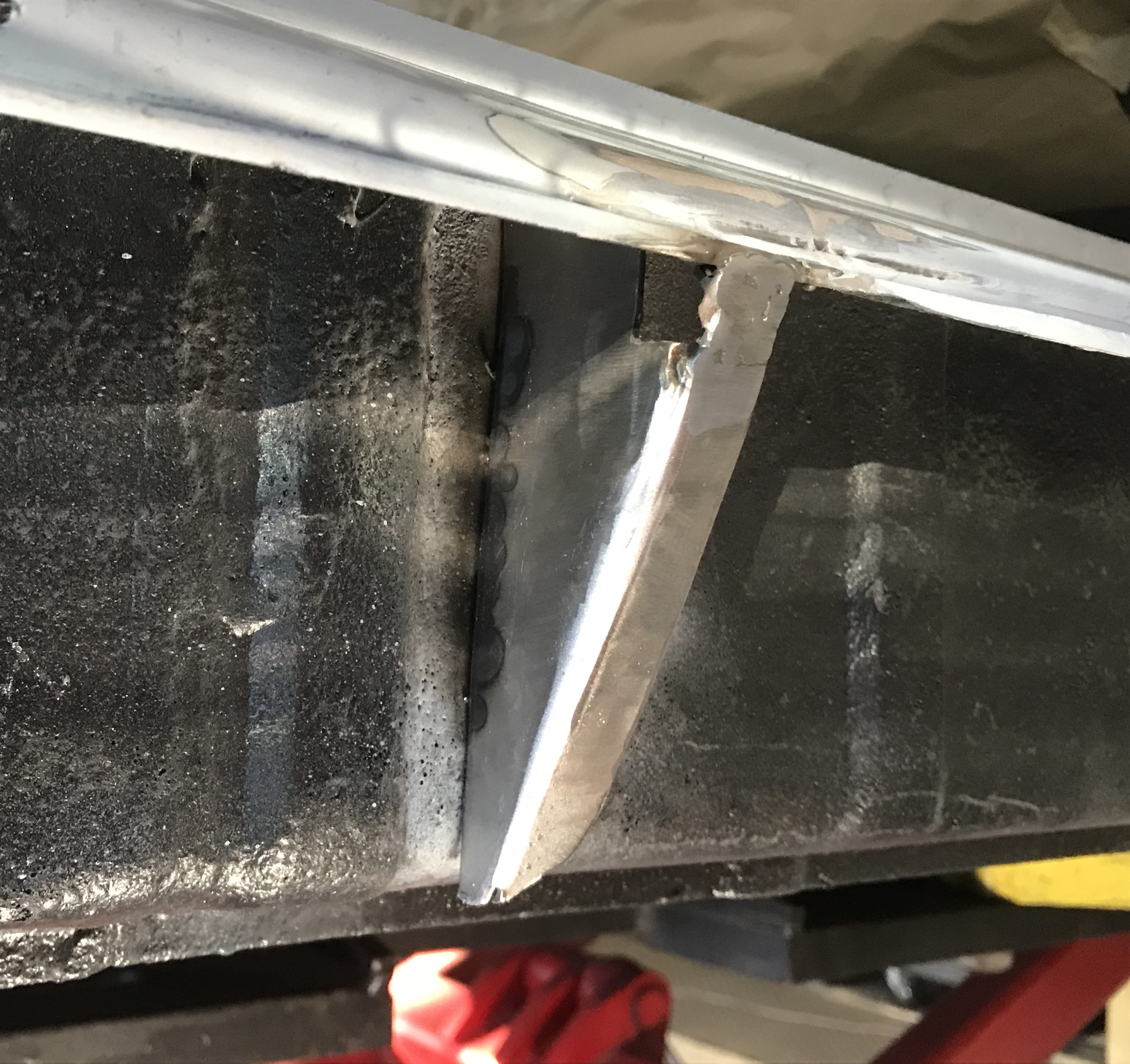

Positioned and then welded it on.

Right sill support. Now onto the Left rear fender. That won’t happen until after
The Northeast 914 gathering (IMG:style_emoticons/default/beerchug.gif) (IMG:style_emoticons/default/aktion035.gif)
Look forward to seeing some of you guys!

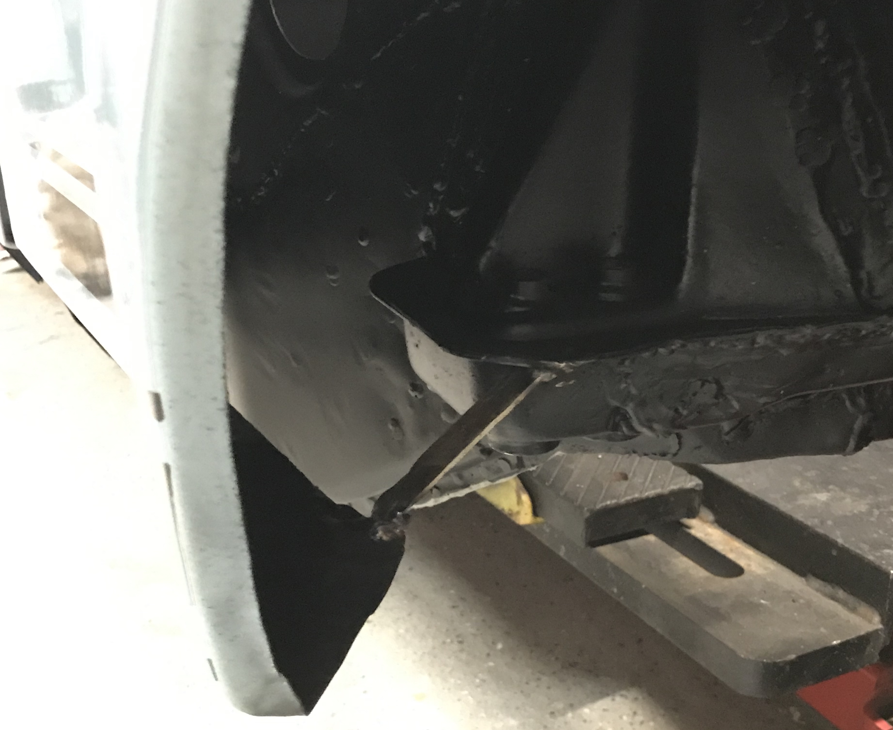

Update time.
After a nice break at the 914 NorthEast Gathering was inspired to get back to this project.
Minor in the scheme of things but necessary.

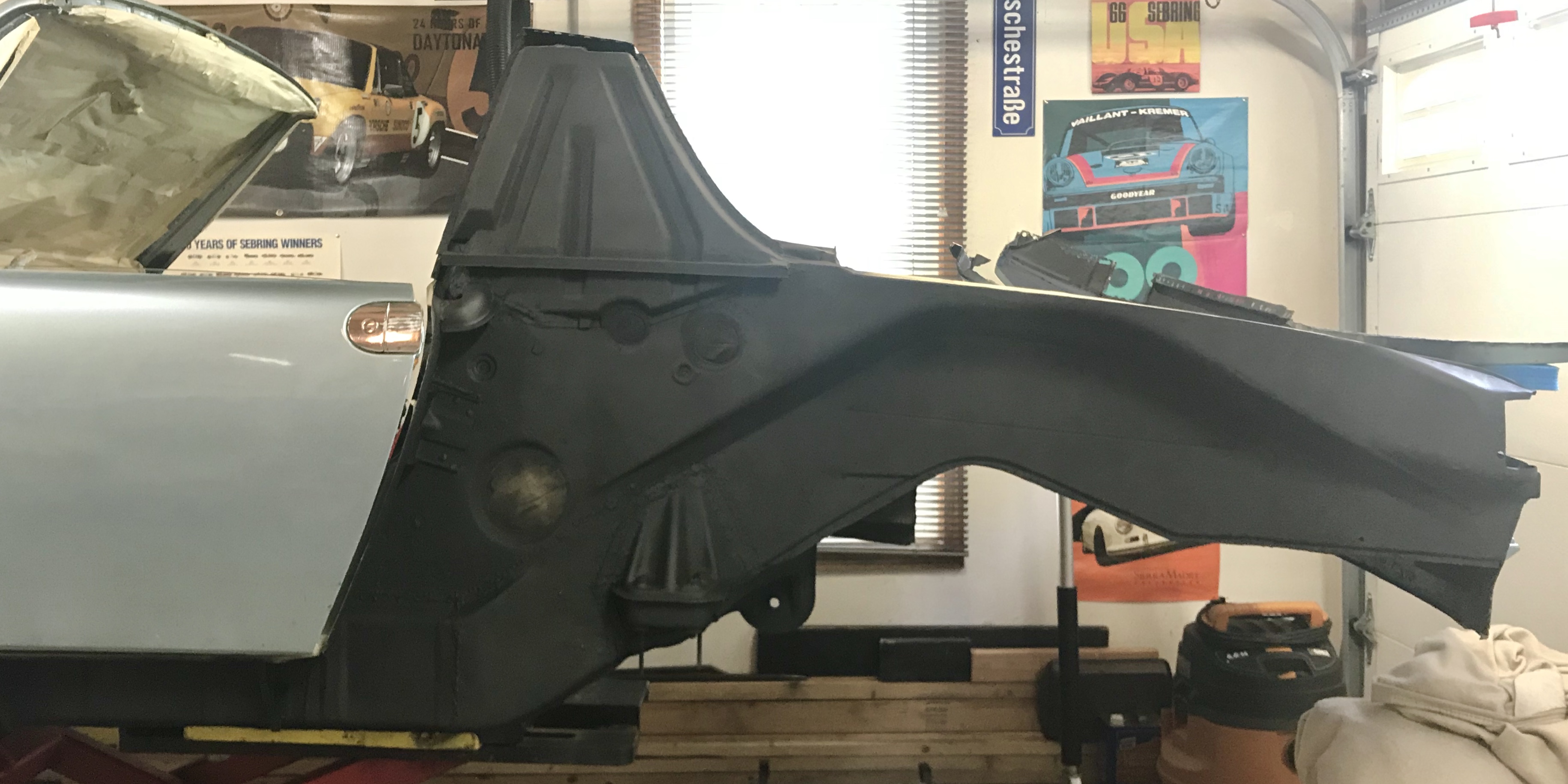

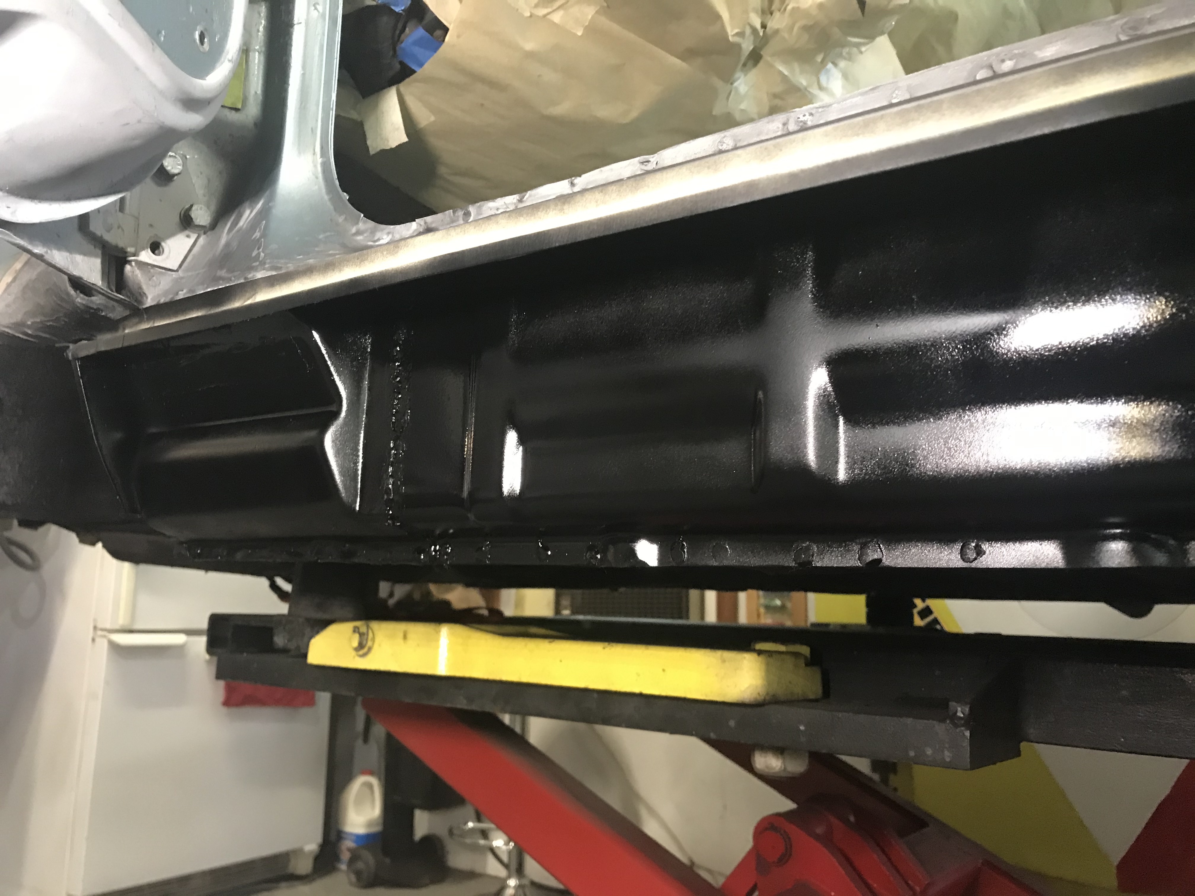

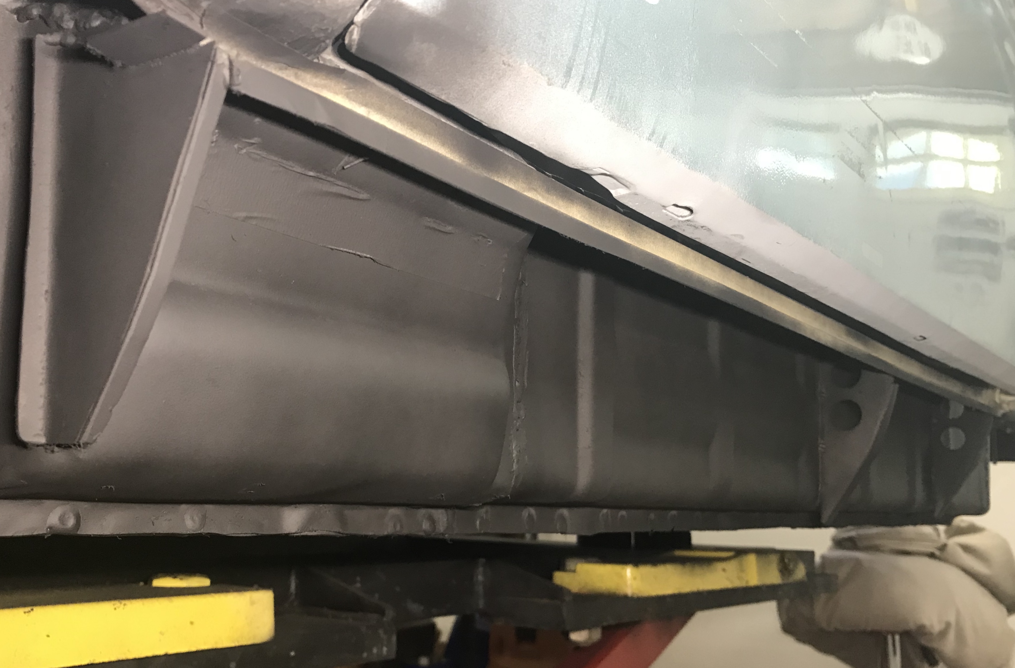

Epoxy primed the left longitudinal and left rear of chassis. Followed that up with Eastwood’s chassis black paint.

Member No.: 2,766

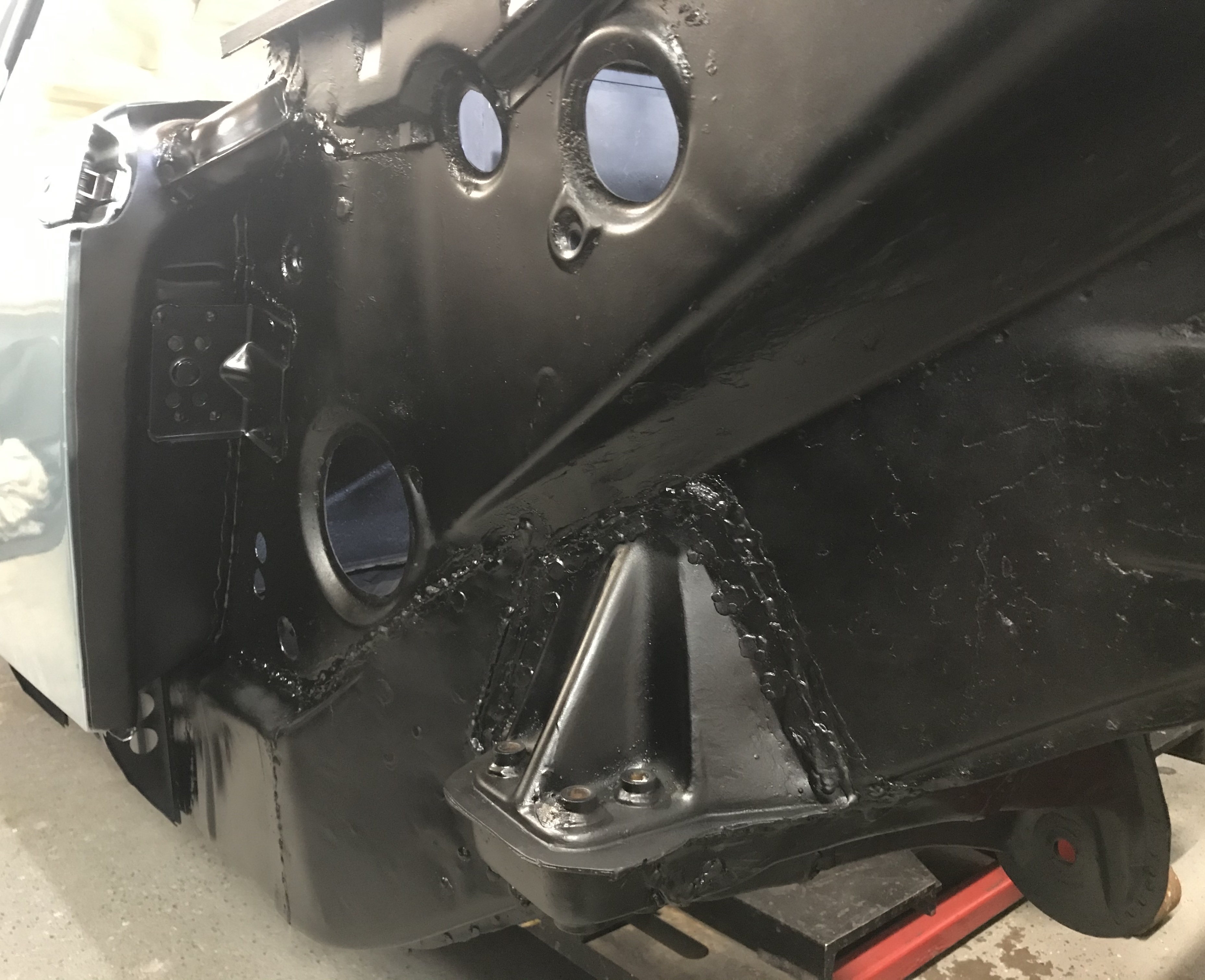

Chassis black

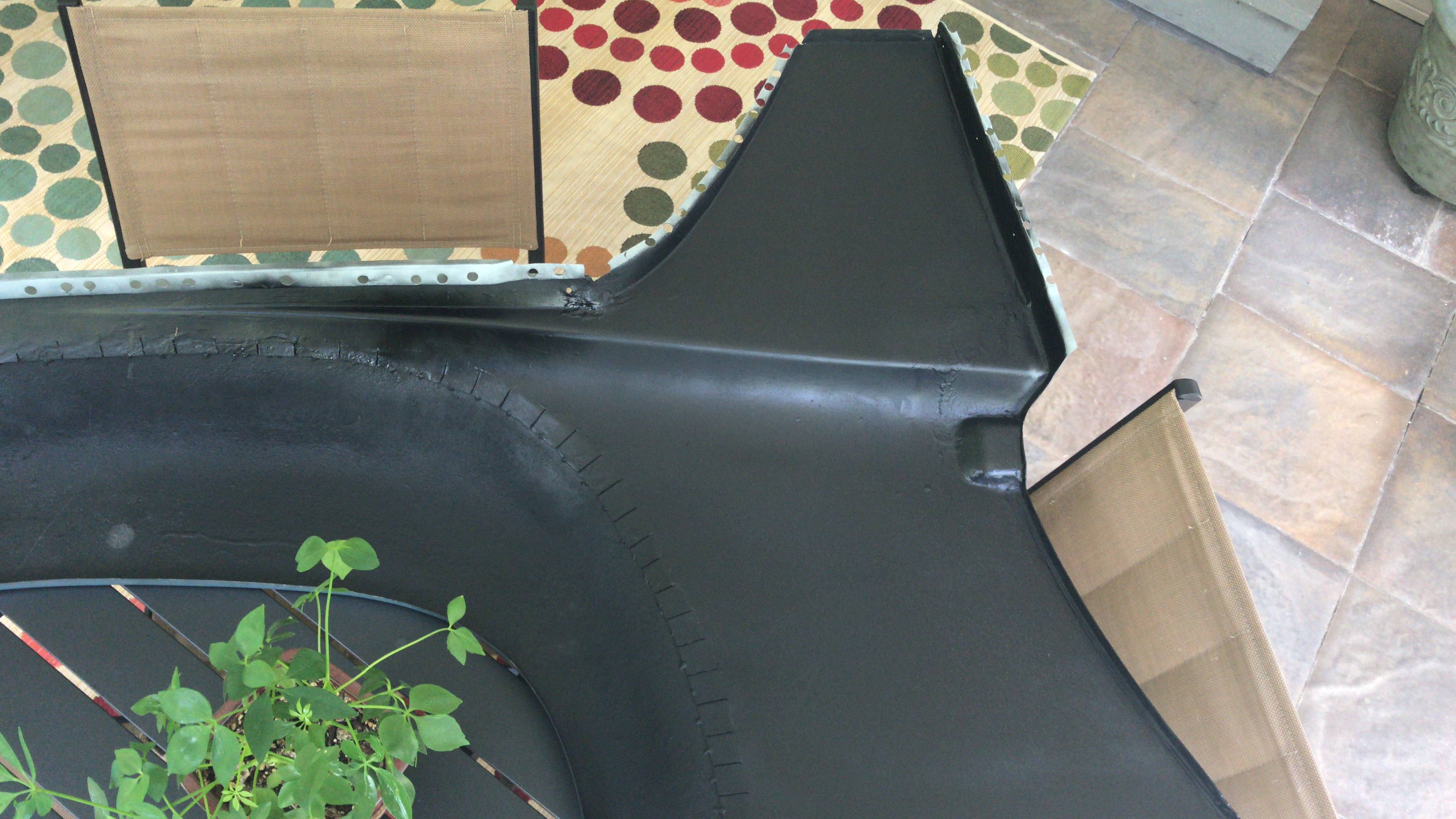

Member No.: 2,766
Chassis black

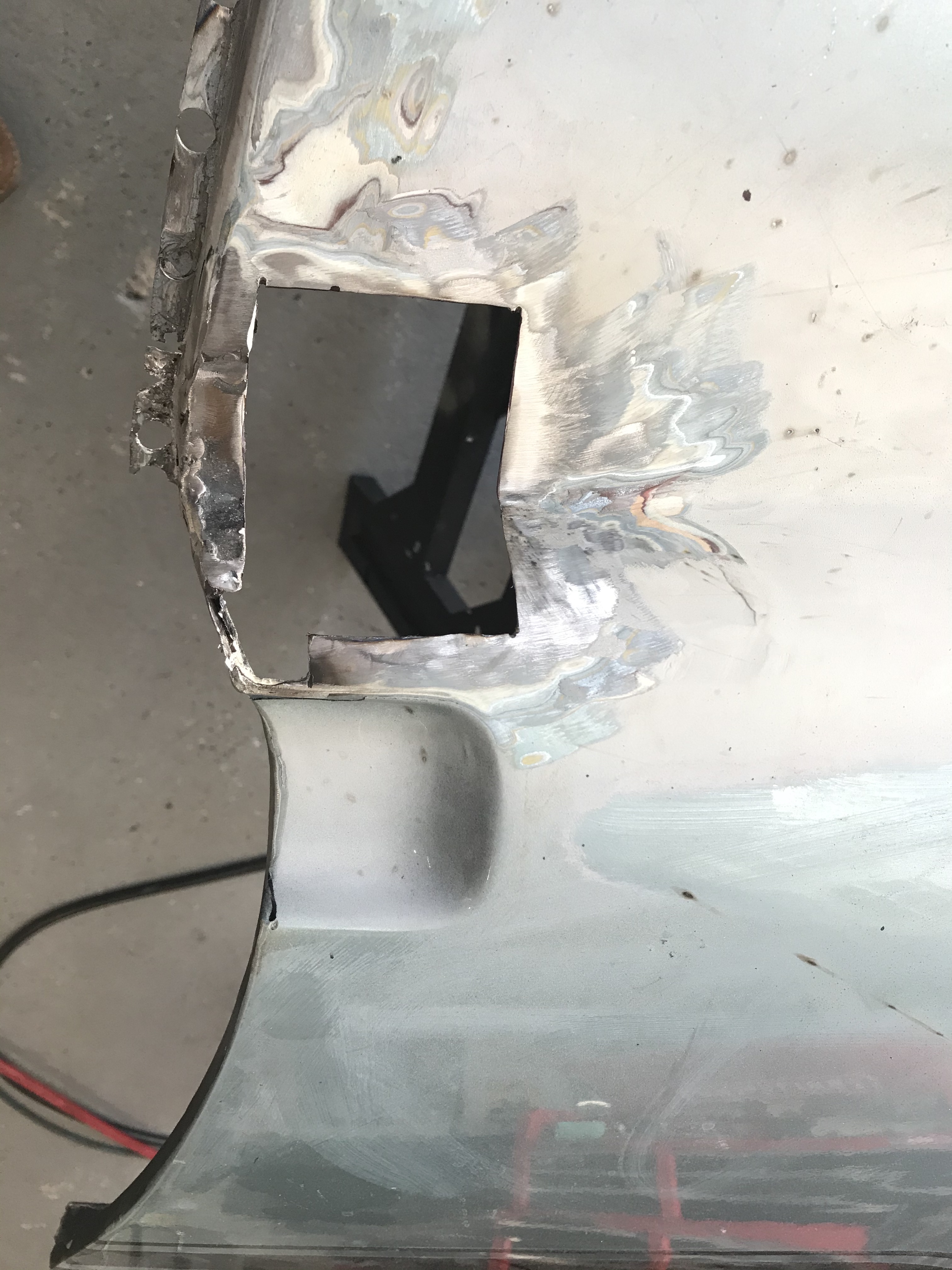

Brent @bbrock I have to apologize. The small part of the sail panel I wanted to use didn’t
fully cooperate. (IMG:style_emoticons/default/mad.gif) Was prepping the rear fender for the chassis black.
Scuffing up the epoxy primer and discovered more rust in that vicinity of the sail where
the handle and snorkel sit. Uggh! Hit it with grinder and it revealed more issues.
I went ahead and cut out the metal, I had nothing to weld to. It was so thin. Just blowing holes on the minimal settings. The foam backing did it in all those years.
So ordered a new sail panel from Restoration D.

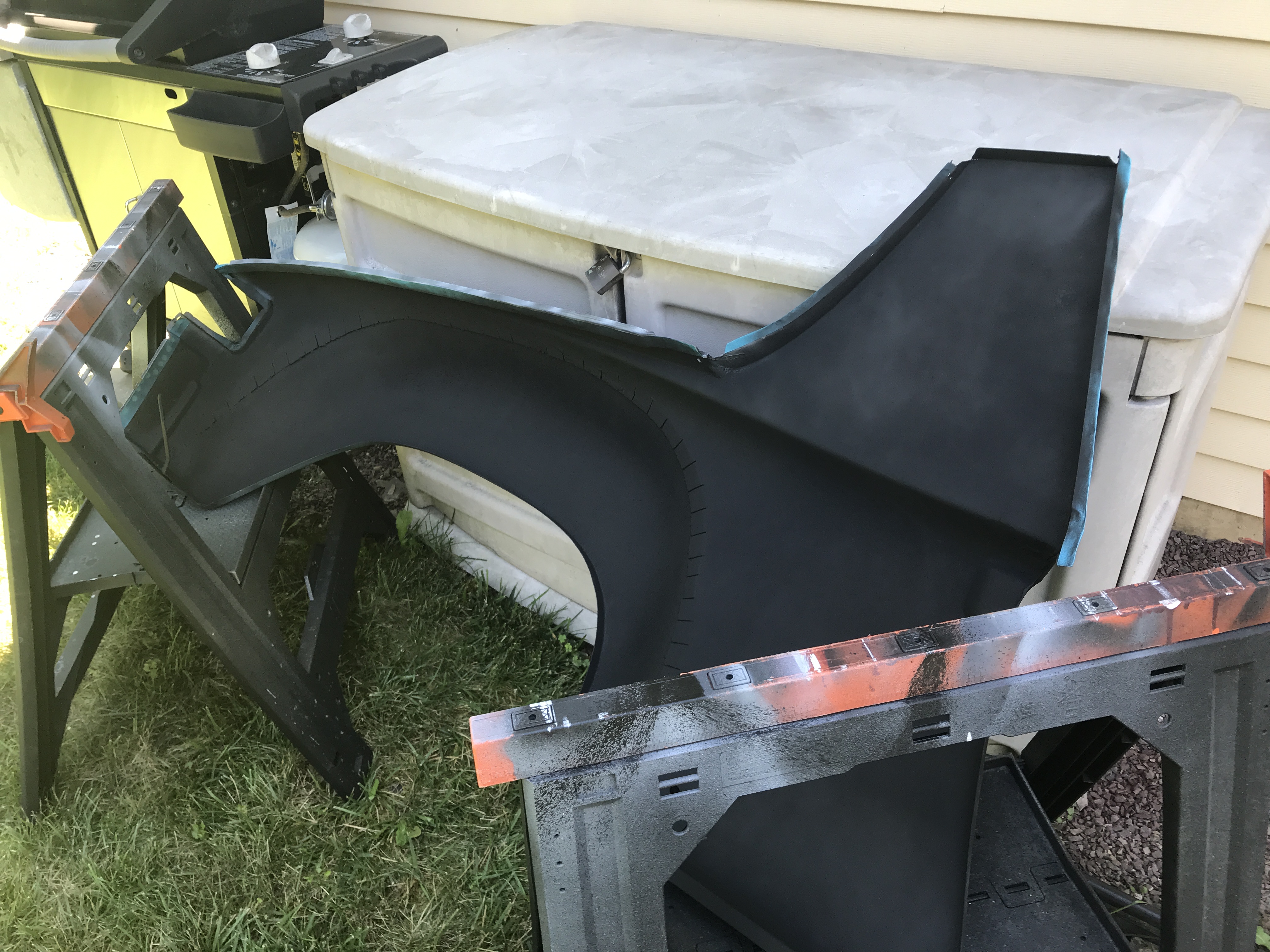

Bad sail

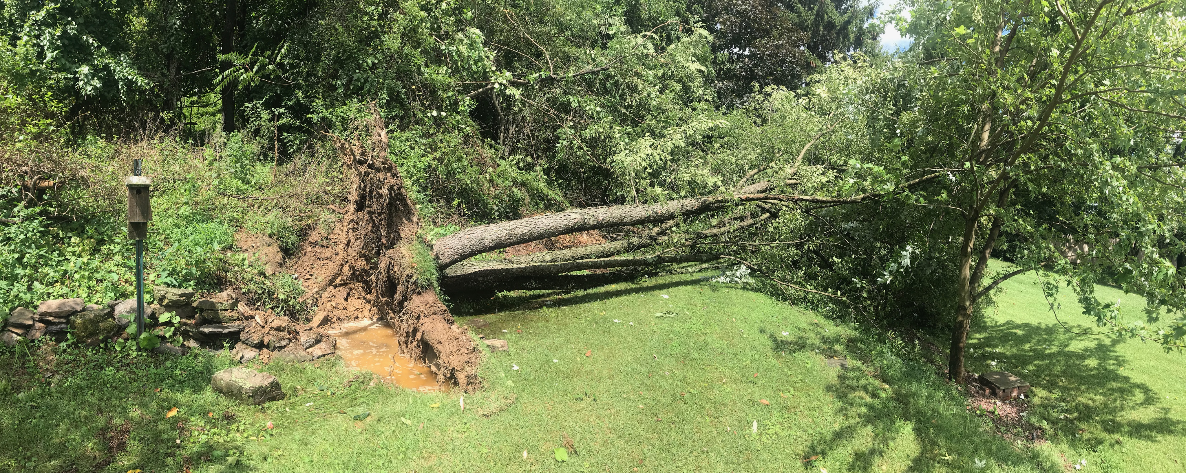

Isaias handy work. The end of the tree is on top of my shed. The John Deere is in there
so I need to rescue him. (IMG:style_emoticons/default/biggrin.gif)

Not the biggest tree, just landed wrong! Be nice if it just fell in the woods!
Ok hopefully more 914 stuff soon. Stay safe and dry.

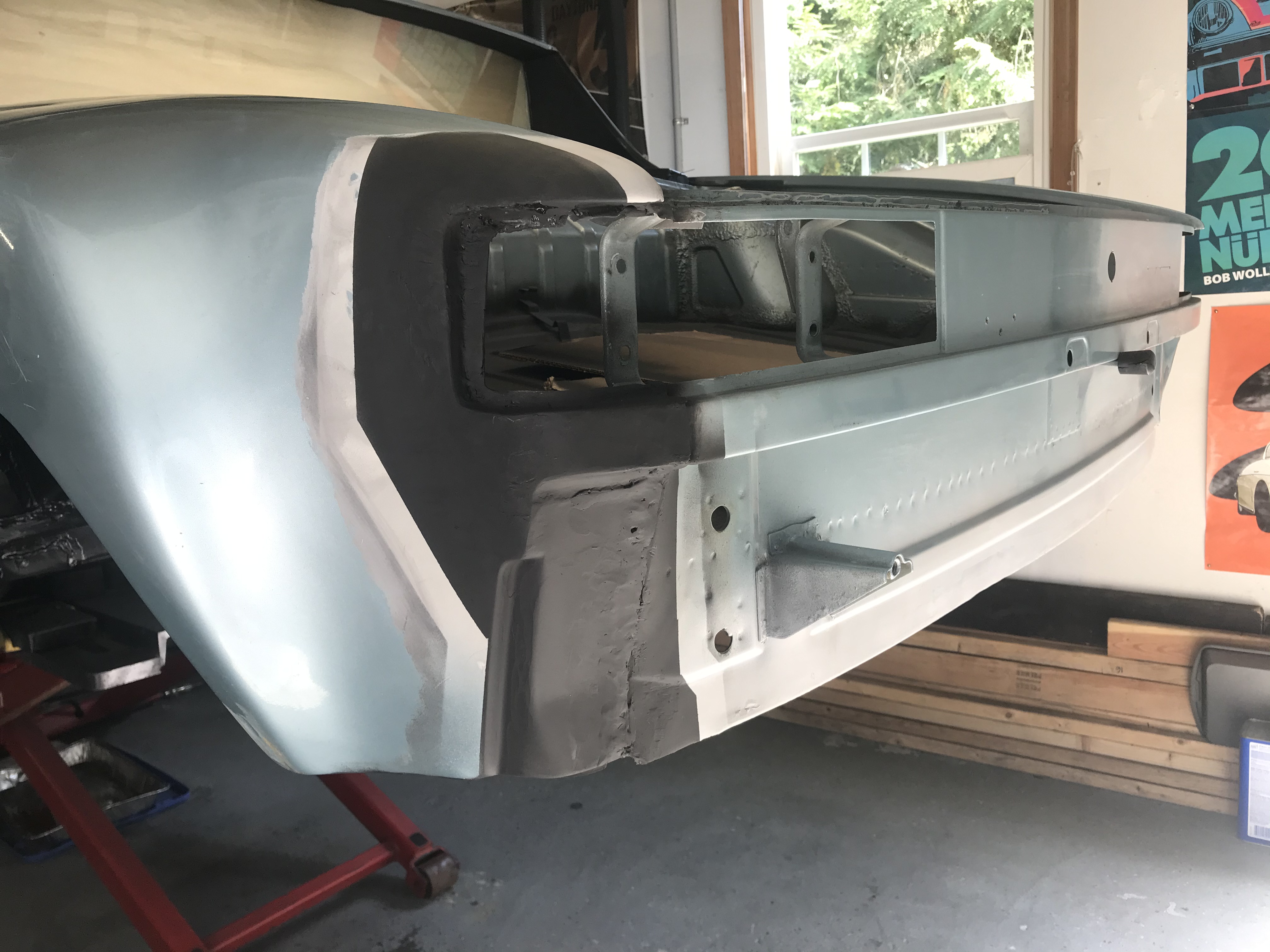

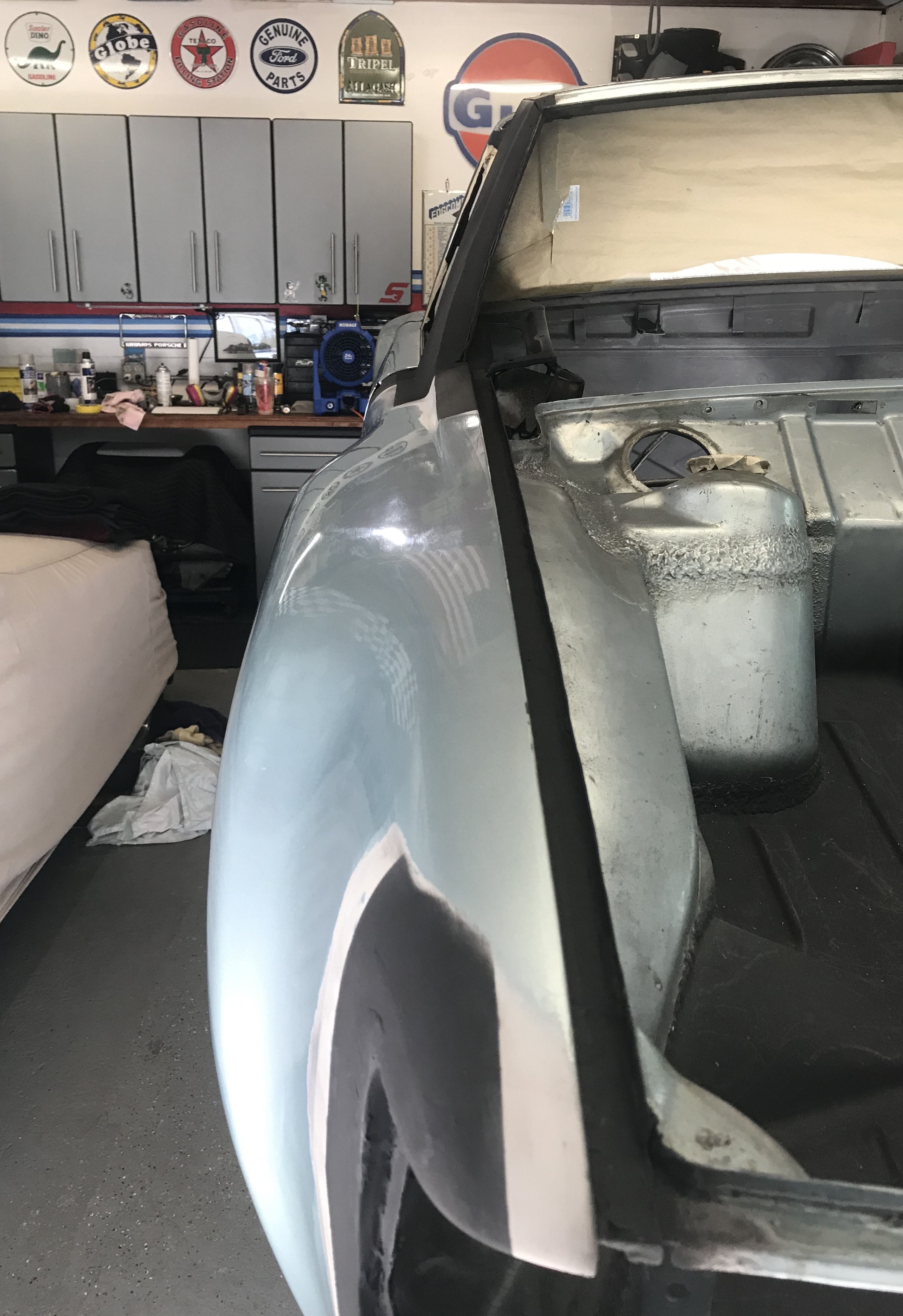

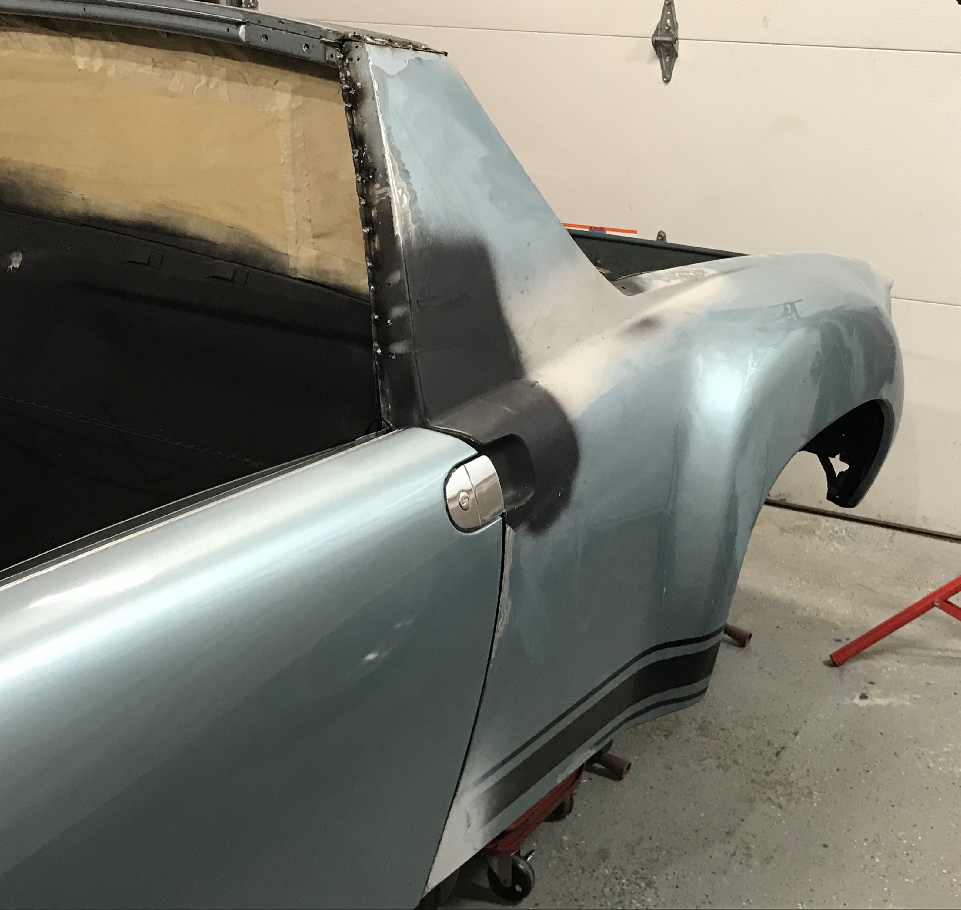

Time for an update. So I received the Restoration Design sail panel. I kinda cheated and used only the section from it to do repairs on my fender. I wanted to keep the original
outline of the sail so it would match up to the chassis without a lot of fettling. I’m not a body shop guy so trying to make it easier on me. Concentrating on that task I didn’t
take a lot of pics, oh well.

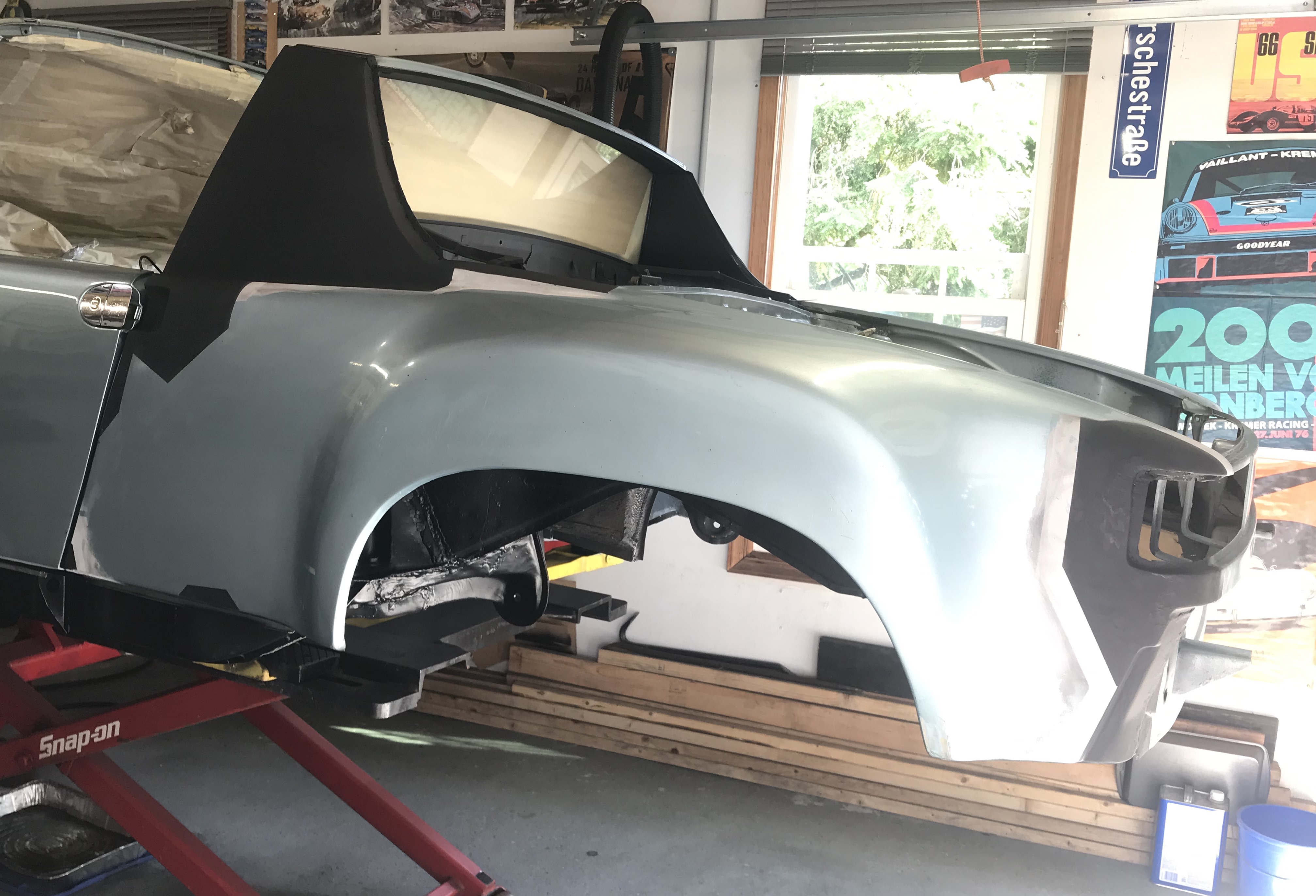

Securing the fender/trunk area

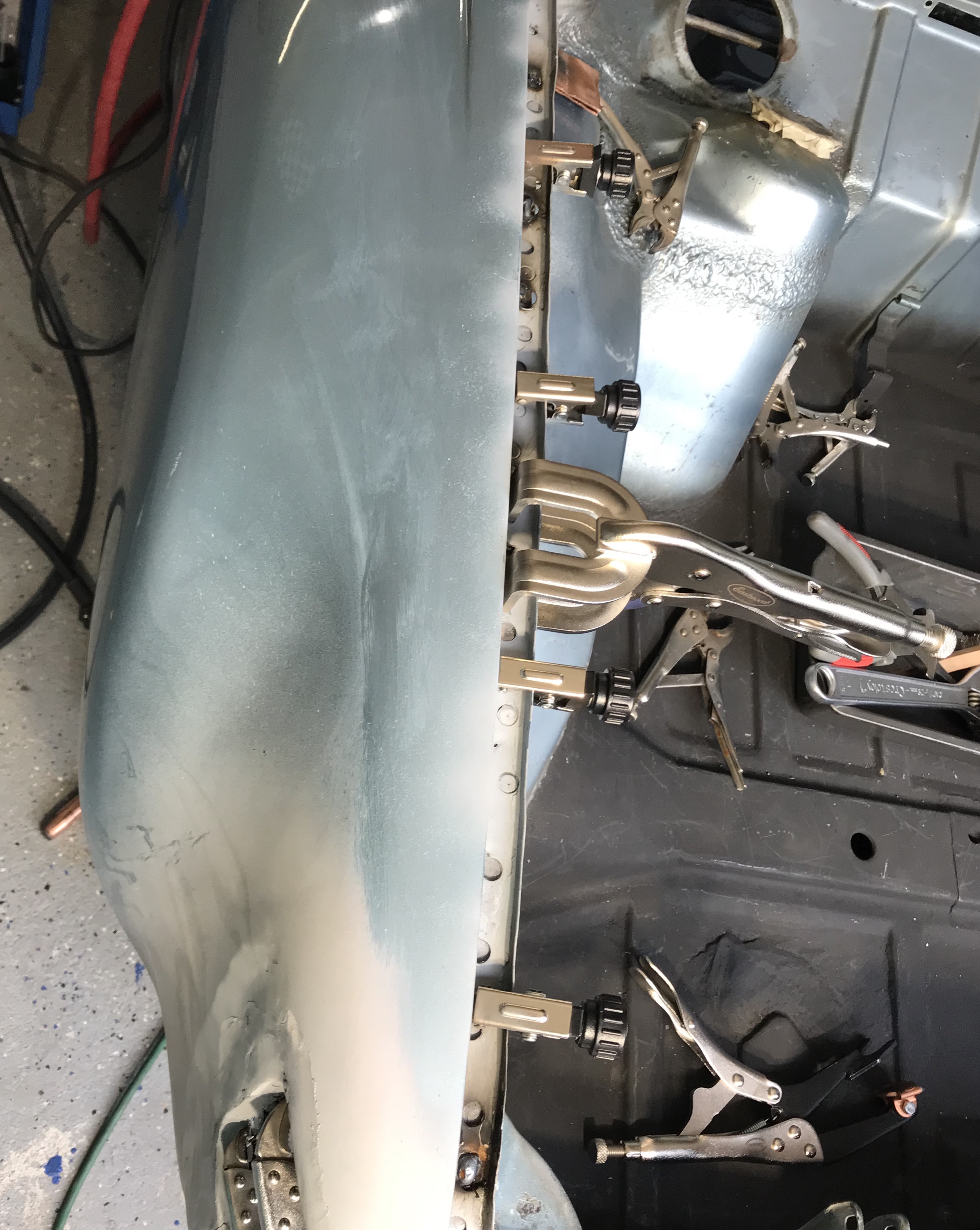

Fender

Fender/Trunk seam
