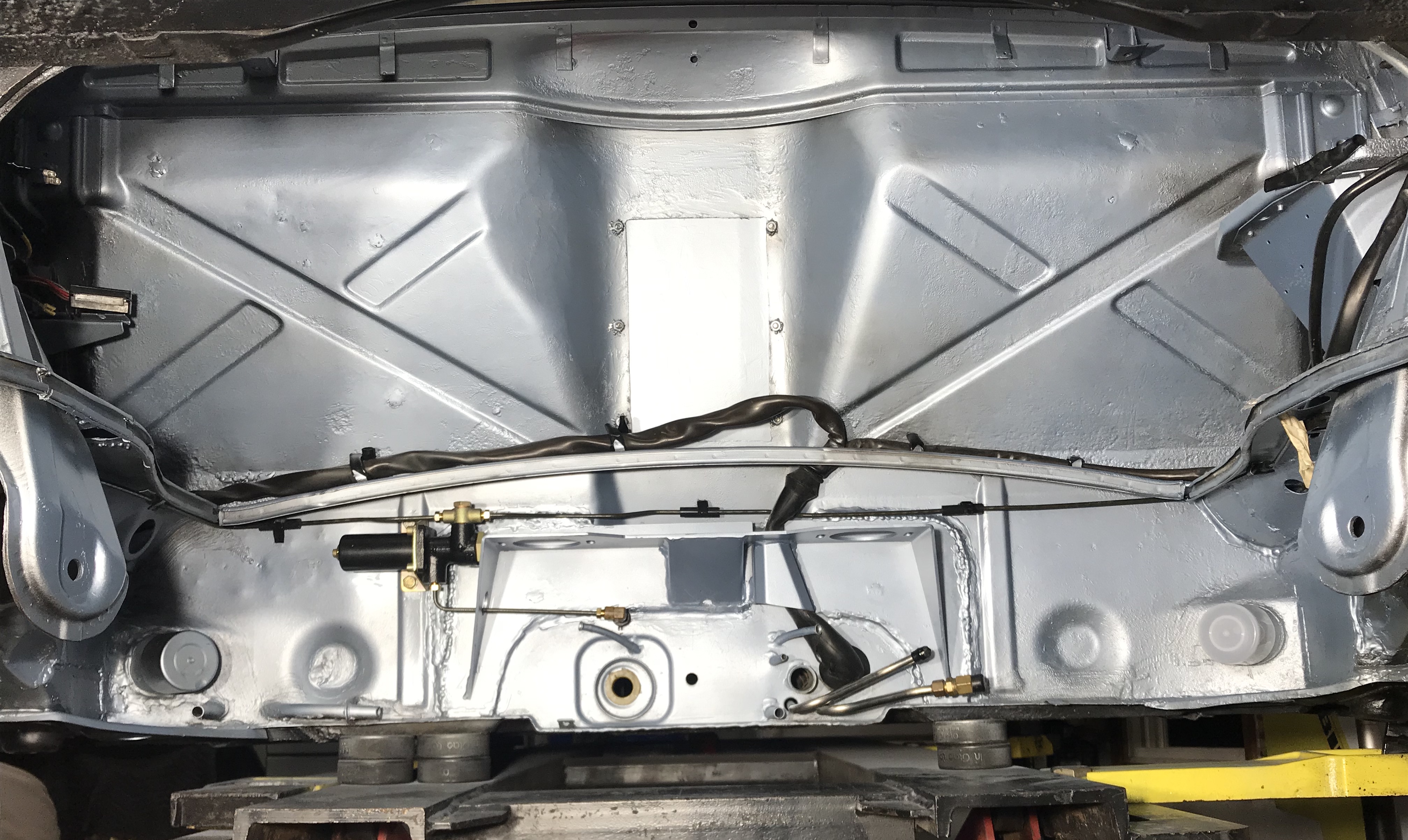

Started assembling the basics back to the chassis.

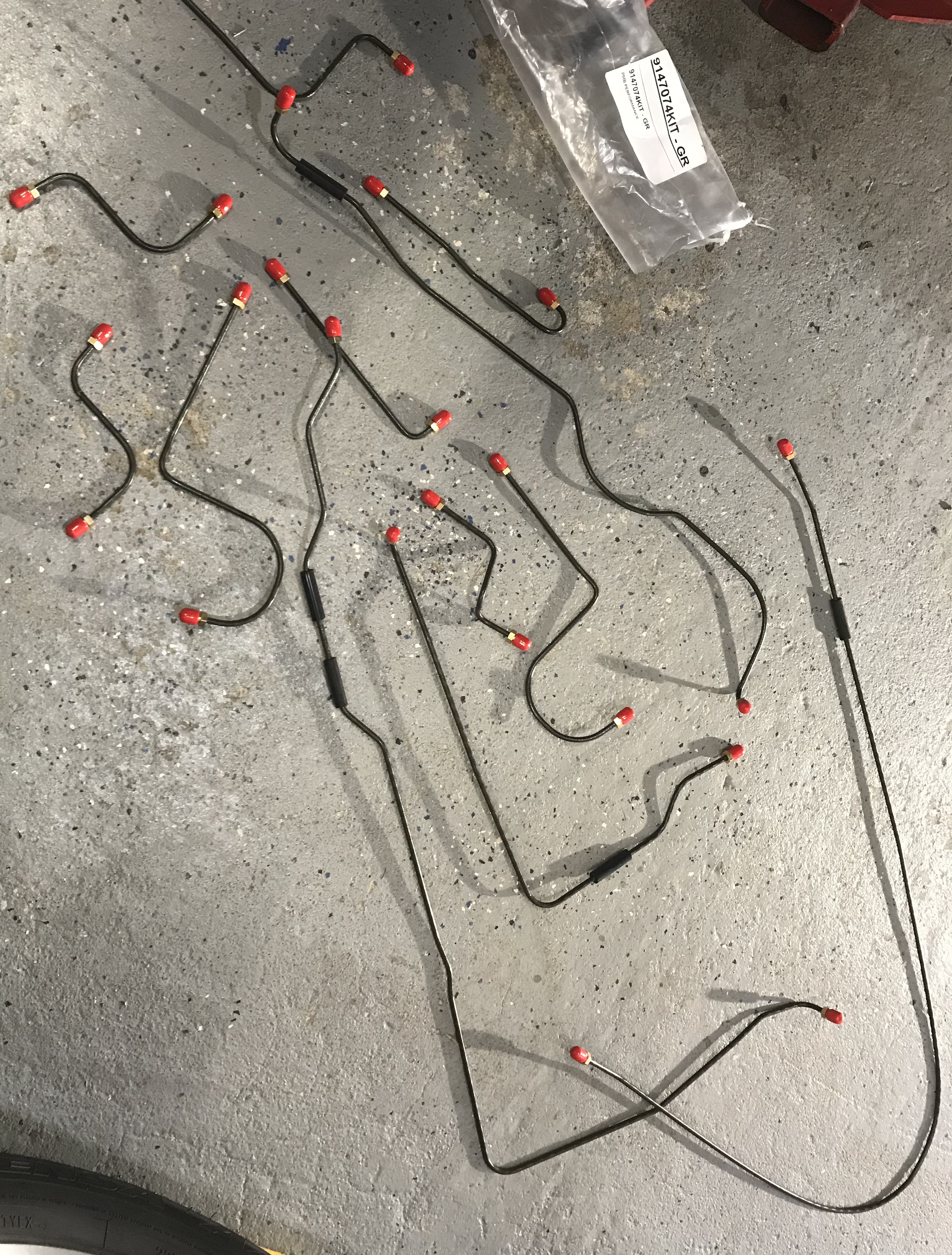

First up was the hard brake lines and pressure regulator.
I purchased the OEM lines from PMB. They also restored the regulator for me.

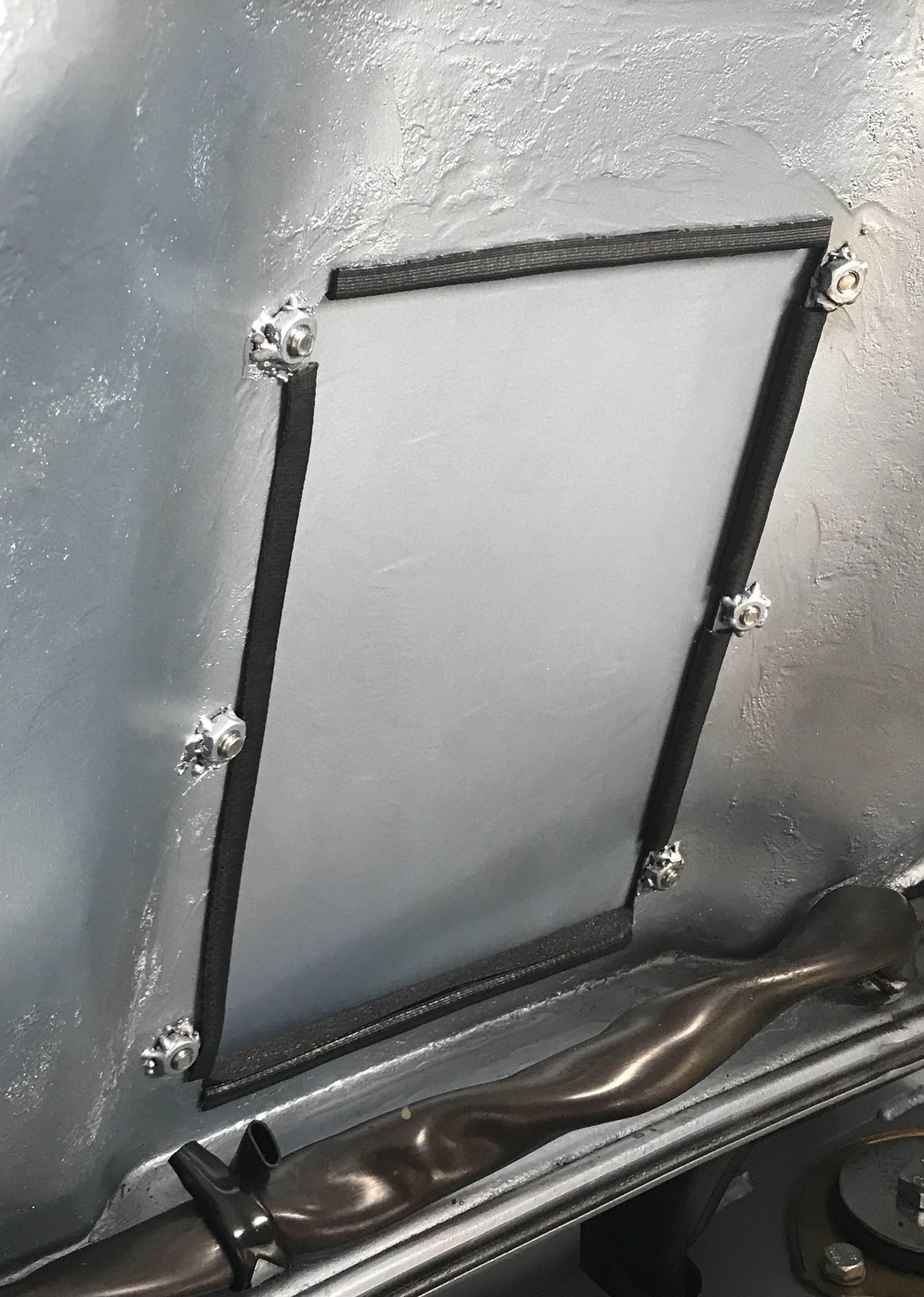

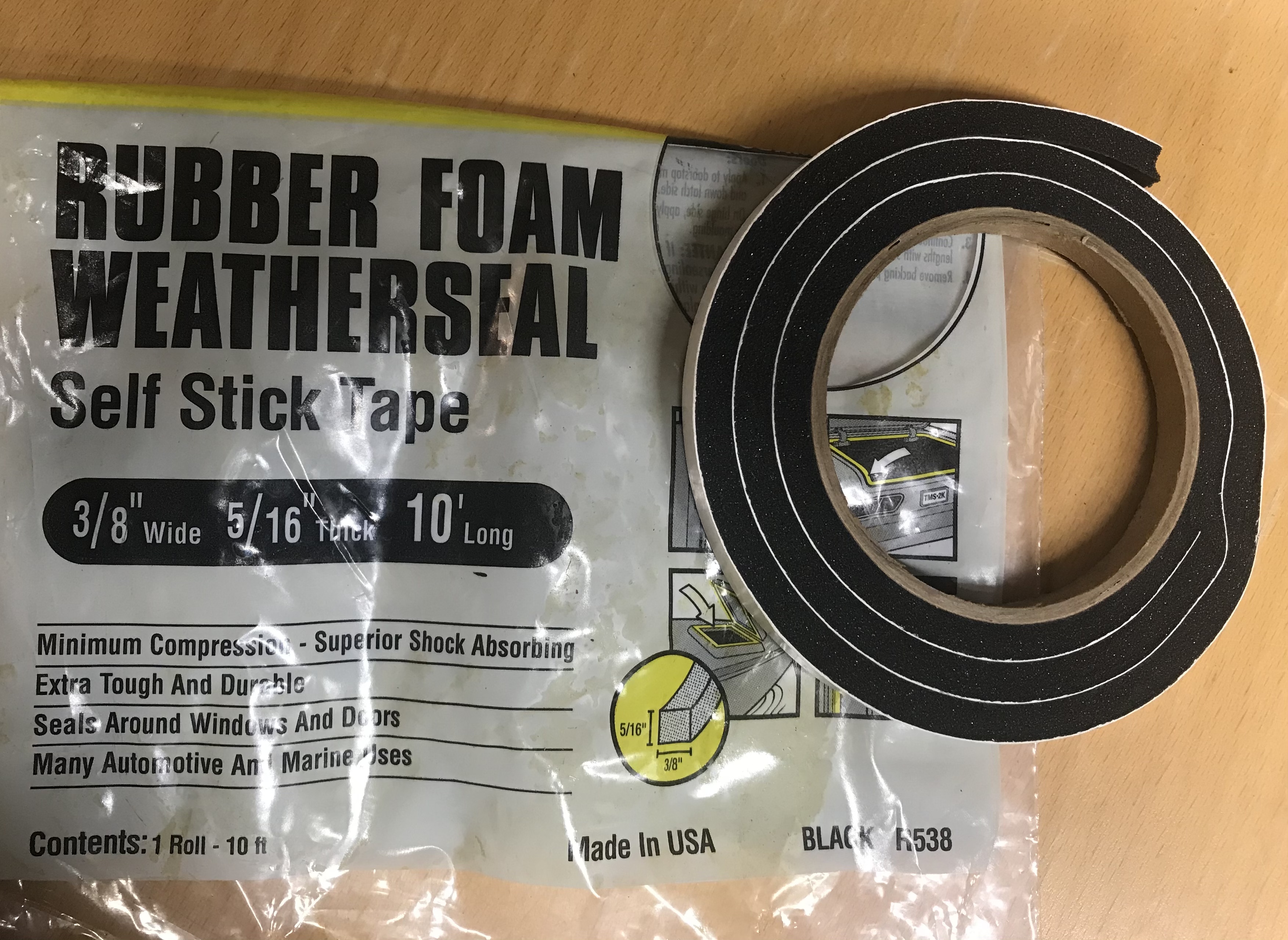

For the engine “hatch” I applied some foam weather stripping to aid in sealing out noise,fumes. That is placed in between the metal surfaces and I utilized some extra engine
grille edging for the opening edges.

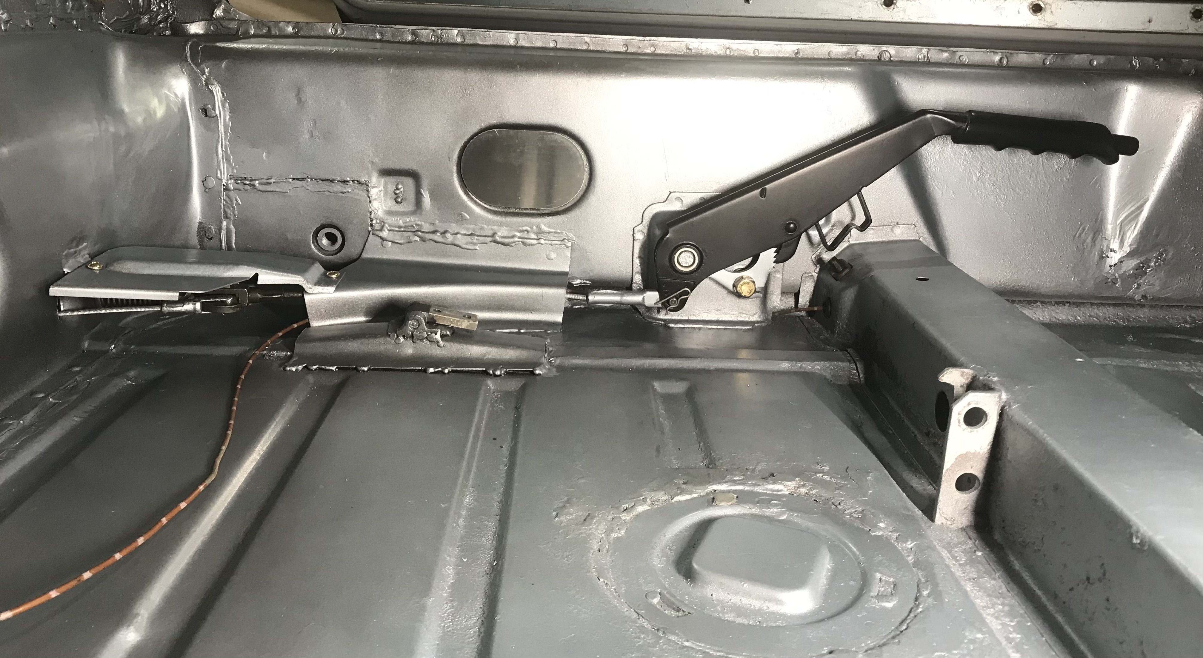

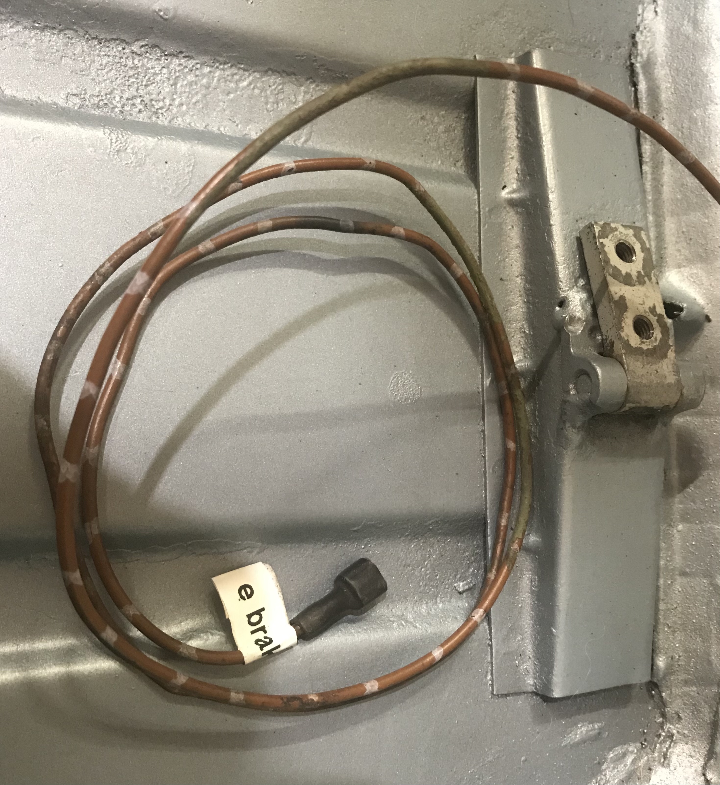

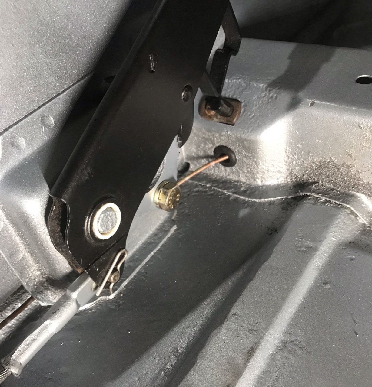

E-brake handle installed with cables and it’s warning lite wiring.
Dion
post Oct 4 2020, 08:42 PM
Post #767
RN
Posts: 2,839
Joined: 16-September 04
From: Audubon,PA
Member No.: 2,766
E-brake

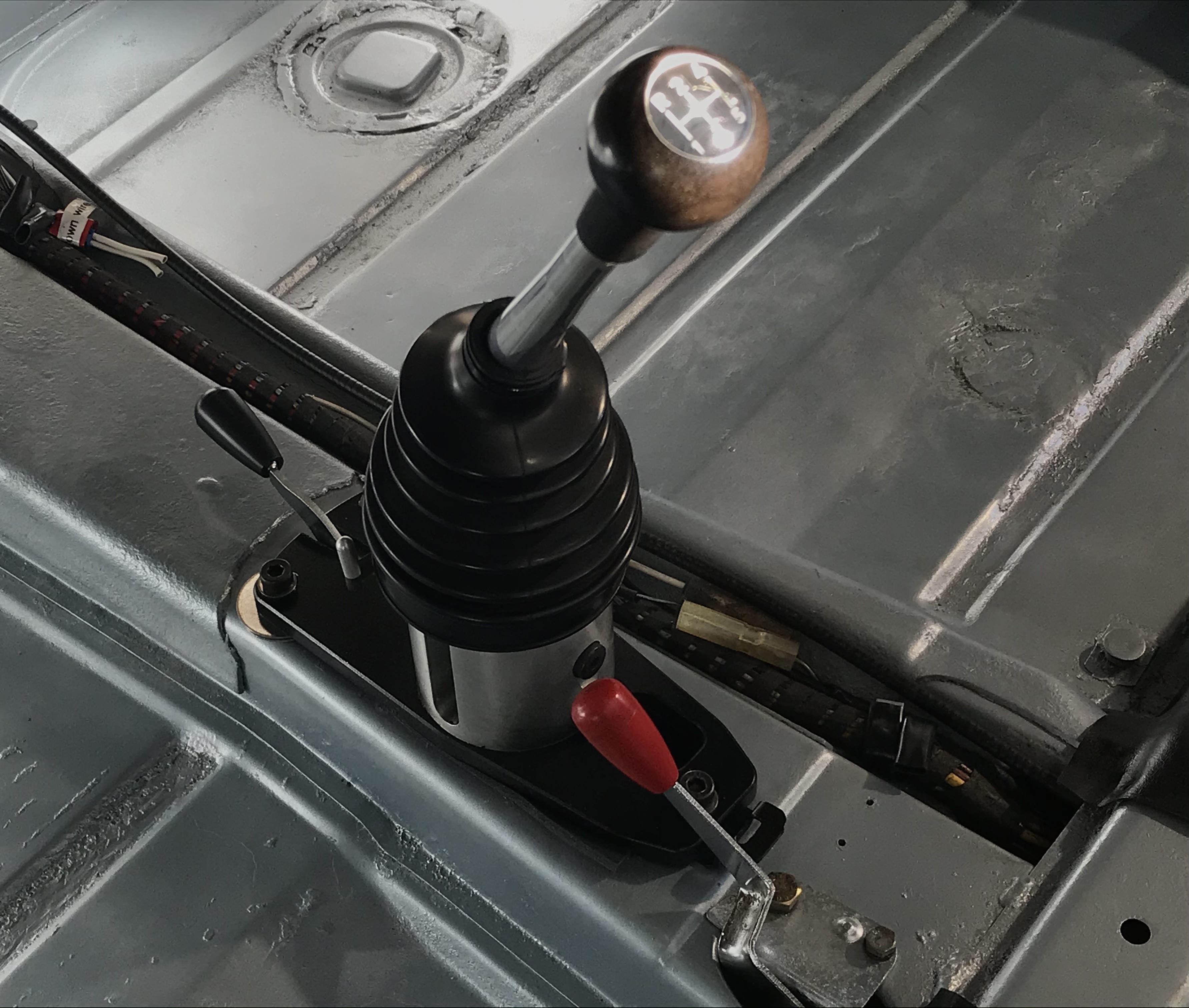

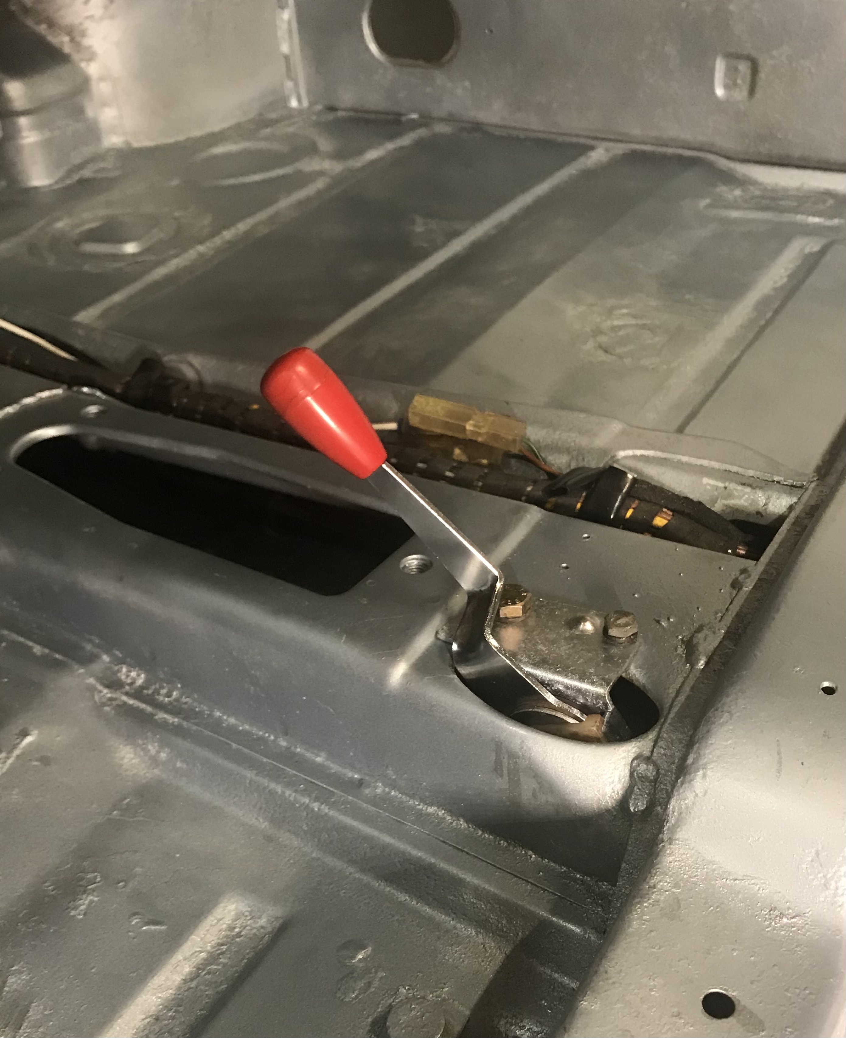

Lastly for this weekend, a nicely restored heater lever courtesy @raynekat . Thanks Doug!

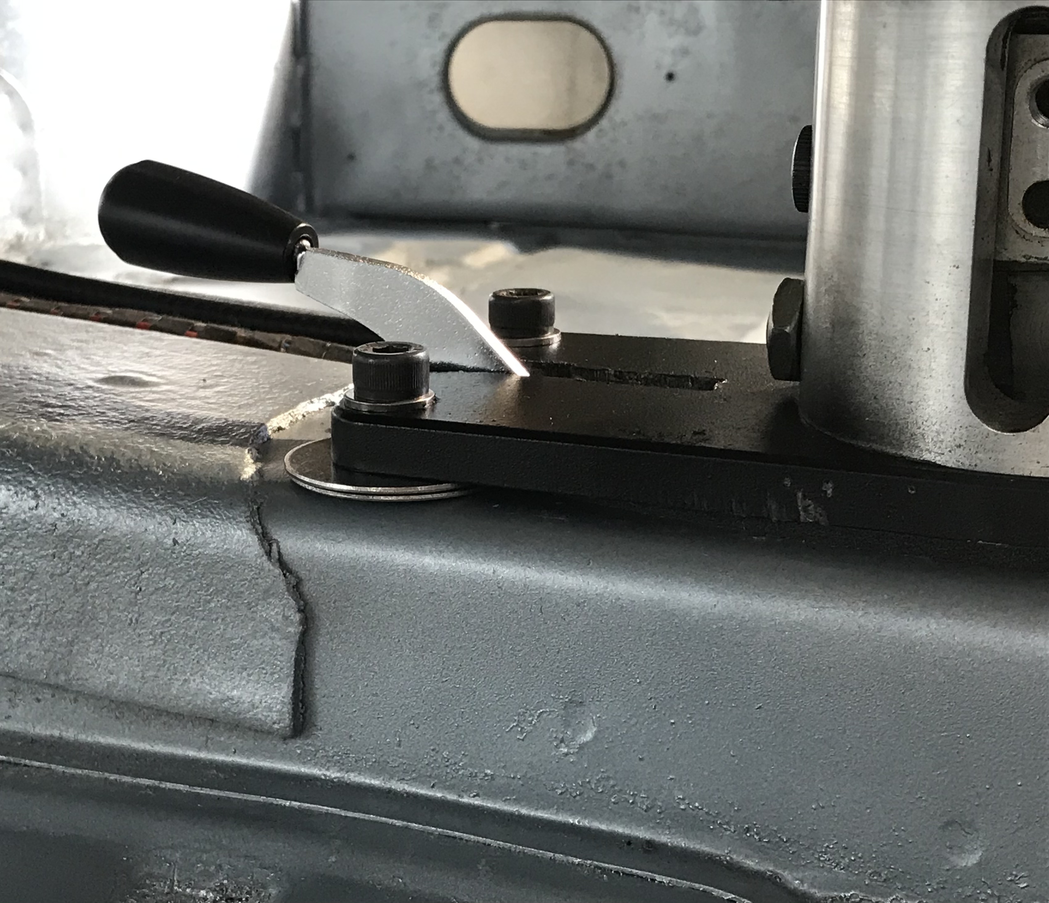

First up, throttle control for the carbs. I’m using 914Rubbers kit. Pretty straightforward.
I welded the little shark fin on the pedal end. I also had to take a slice out of my JW shifter console so this whole setup can function.
Turned out pretty good.

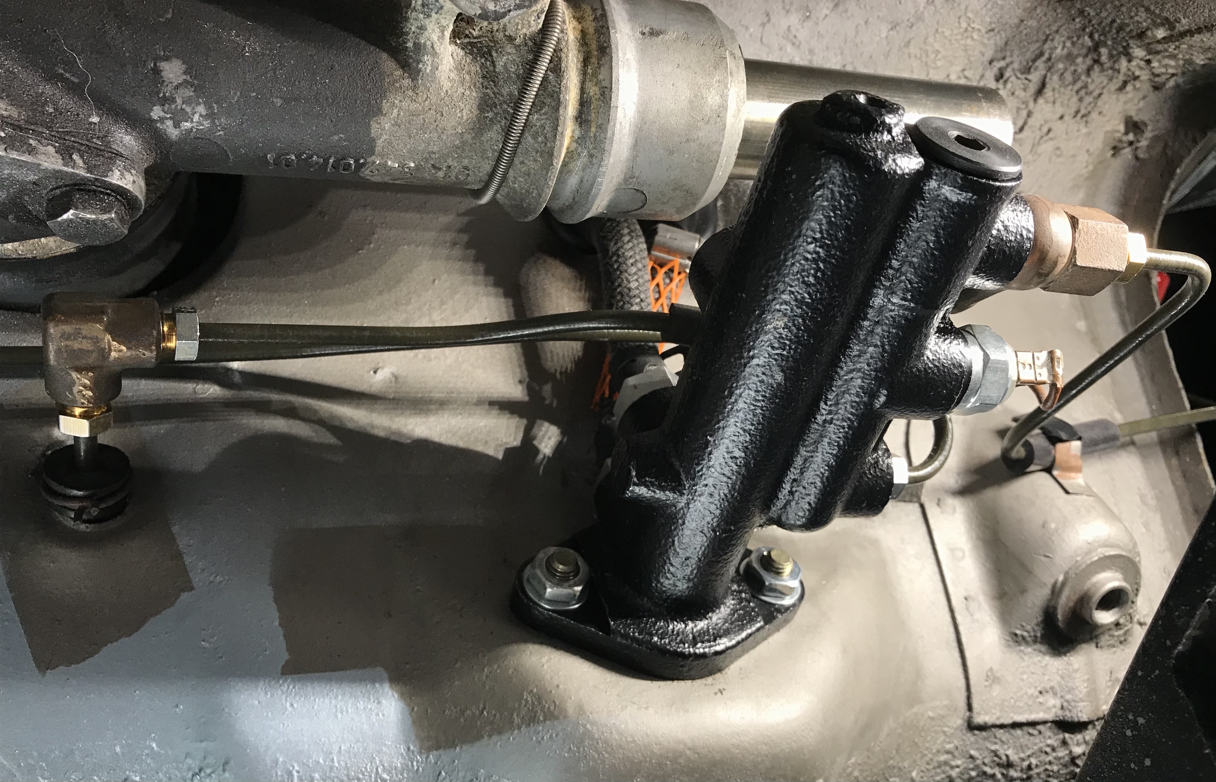

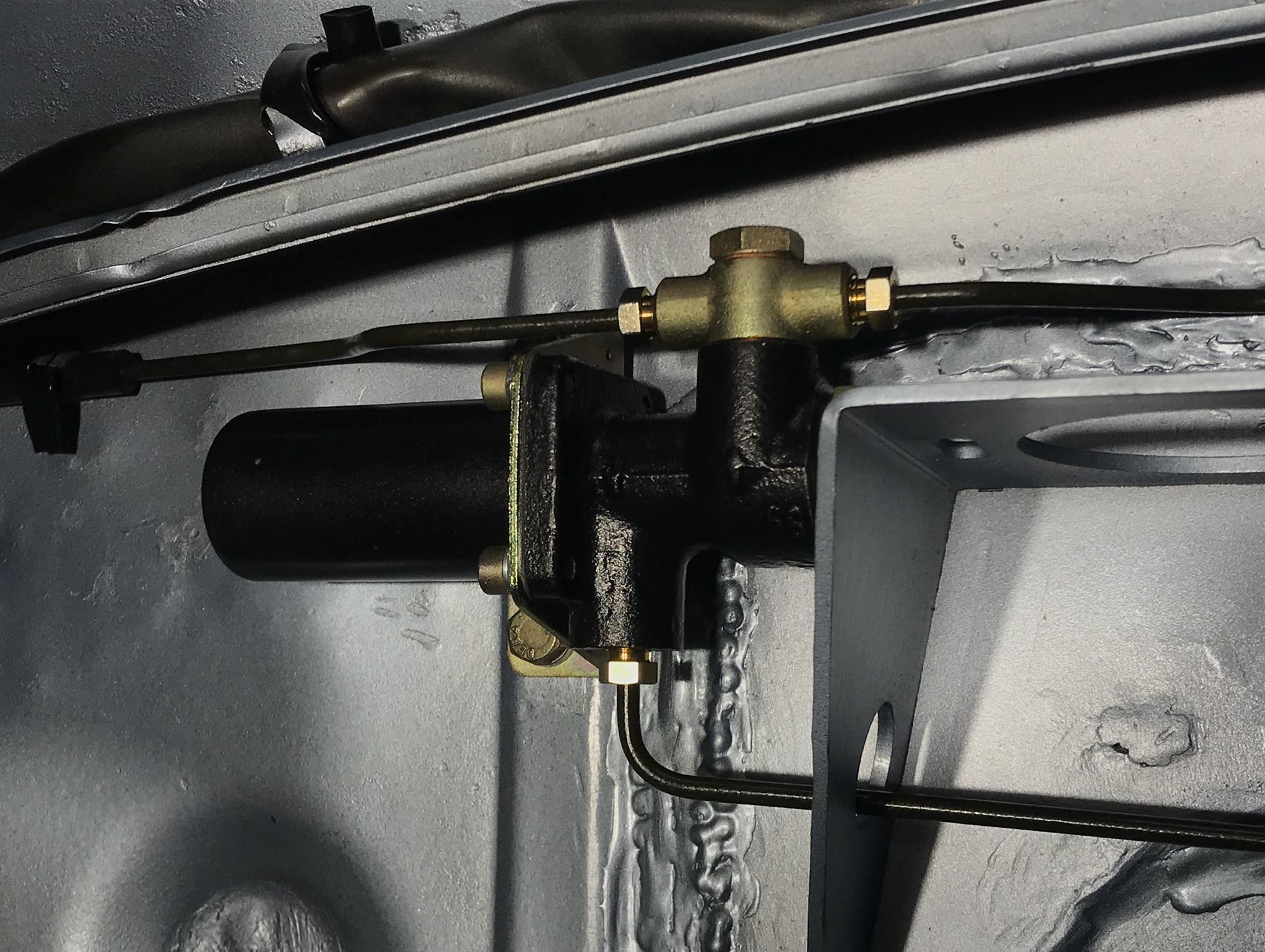

Installed a new master cylinder. Followed Ian’s brilliant video. It was a bit of a pain in the arse as my lifts crossbar happens to lay in the region I needed to access. Moving the car on the lift isn’t an option yet. The test of wills for me was getting the hoses to lay against the bulkhead. I was getting some interference from the steering rack bellows.
I used the EZ install where the hoses go into the cylinder. All worked out.

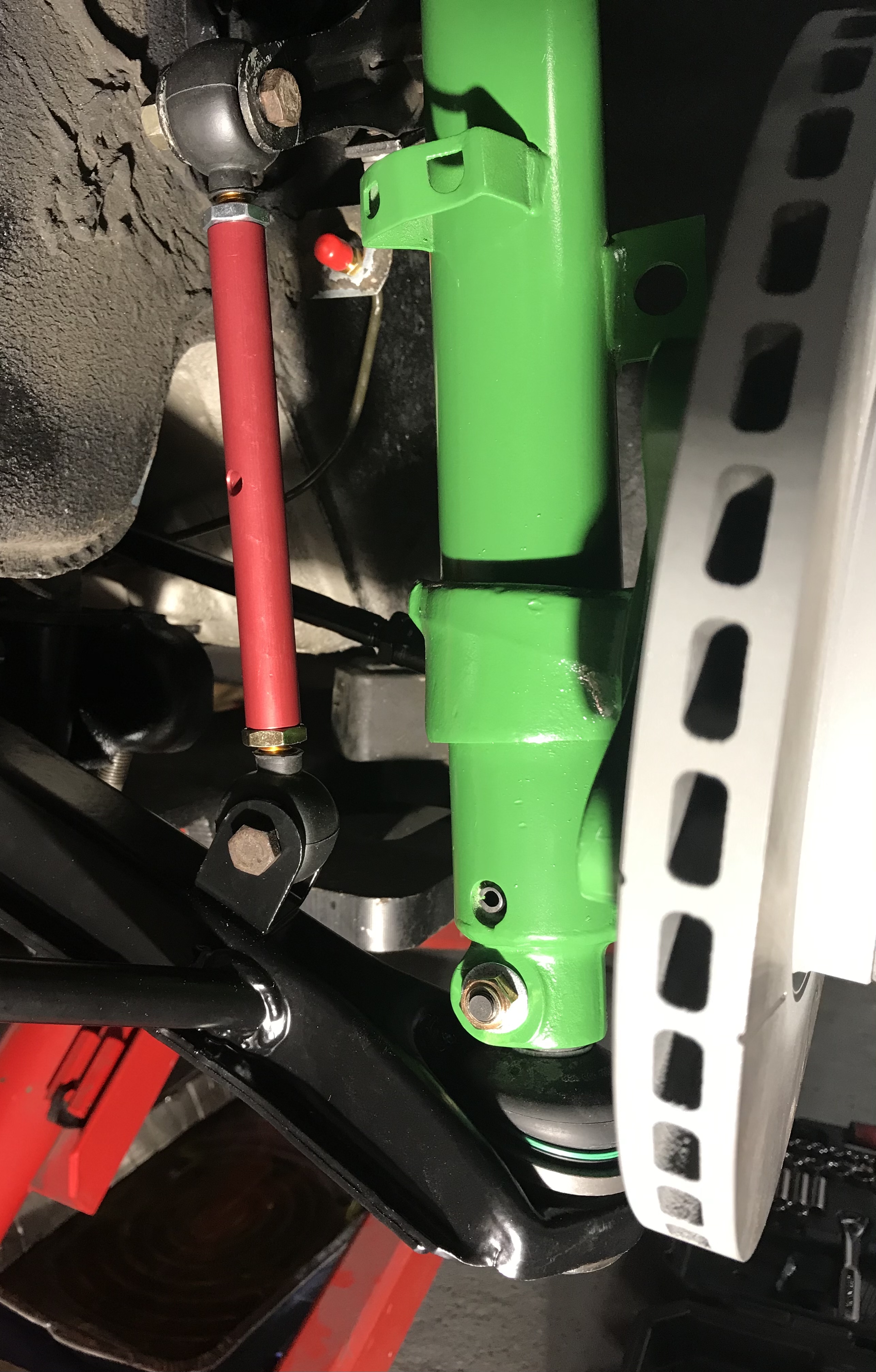

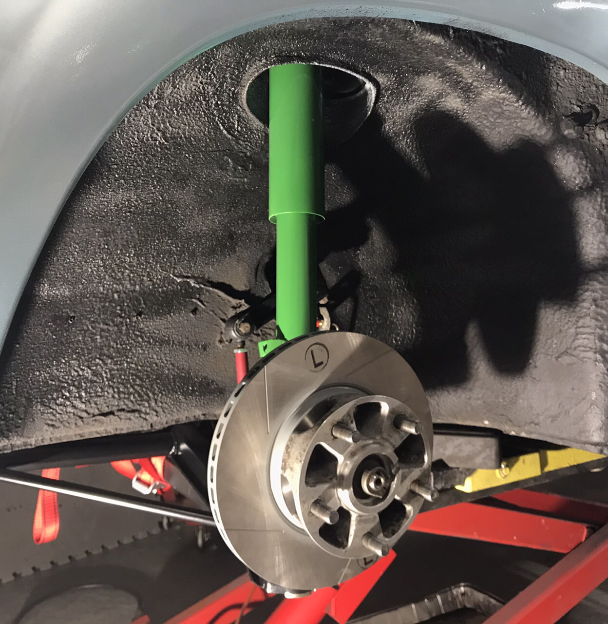

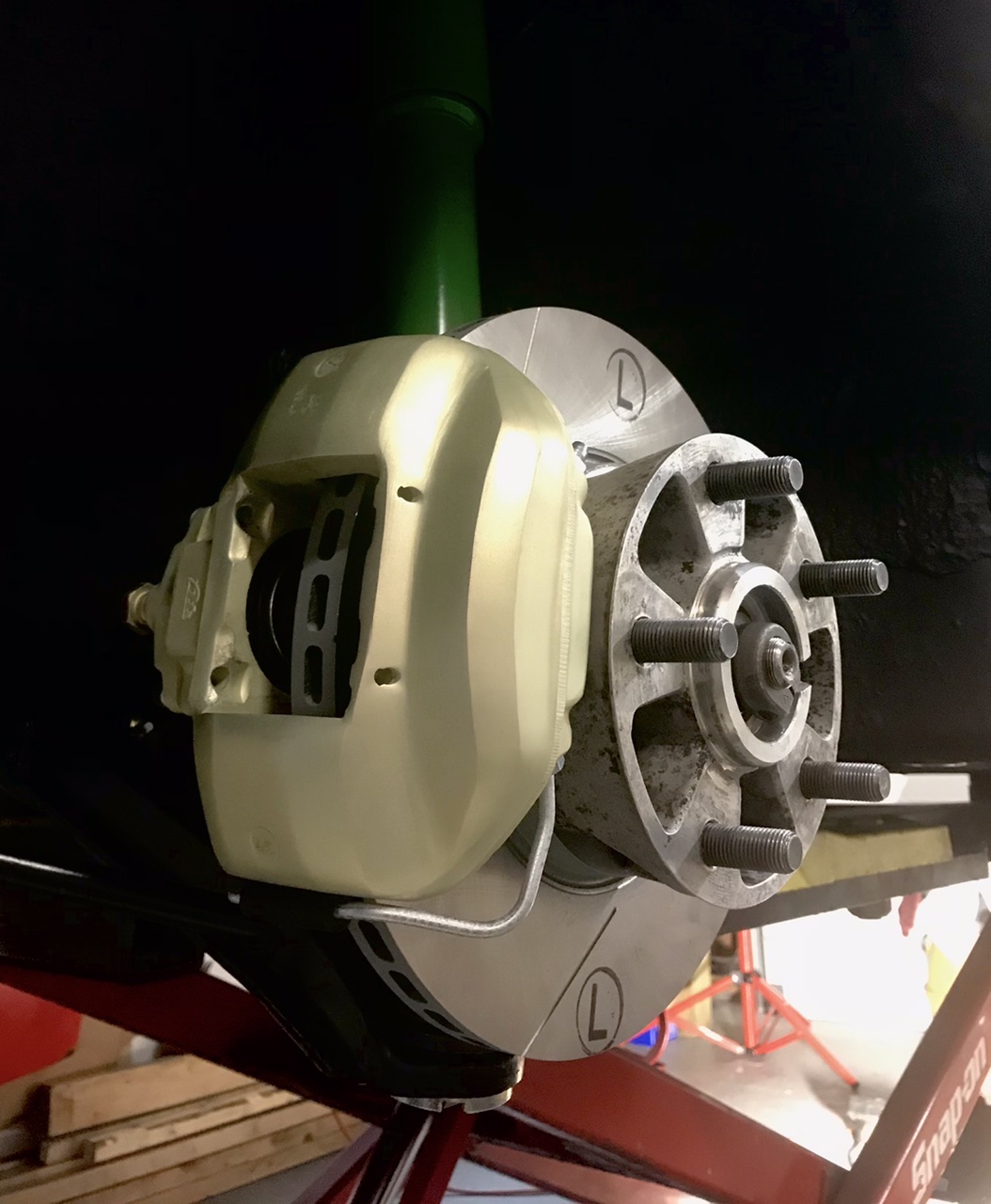

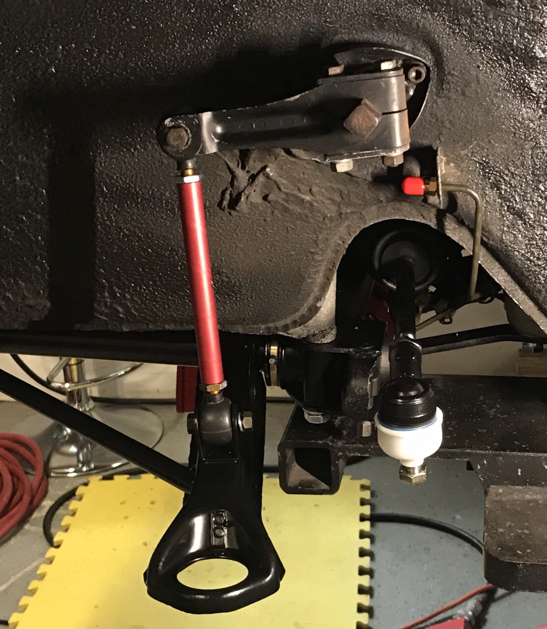

Front suspension went on. Bilstein struts, reconditioned A-arms with Elephant Racing’s polybronze bushings and some Sebro vented rotors.

Close-up. You have to love some John Deere colour.

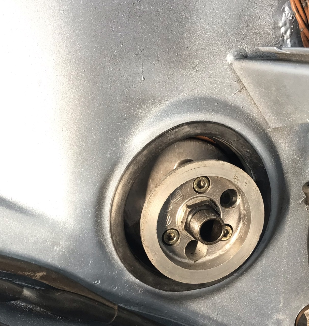

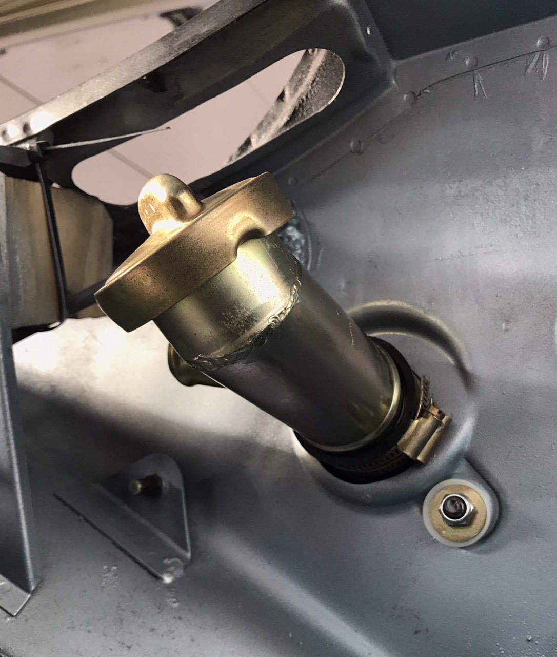

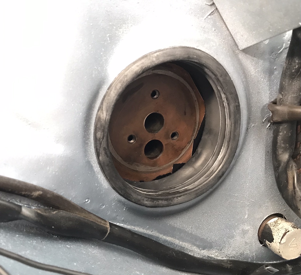

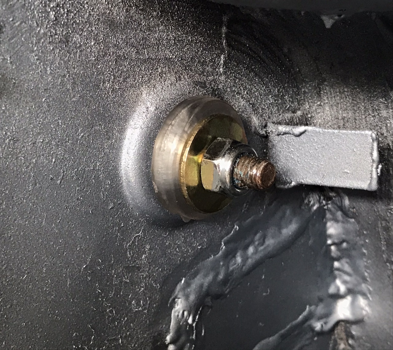

Oil tank. Sourced the proper “plastic” washers from Stoddard to mount the tank and also the rubber grommet around the console. The foam piece for around the oil fill neck is a
nutty price. Not installed yet, no pic.

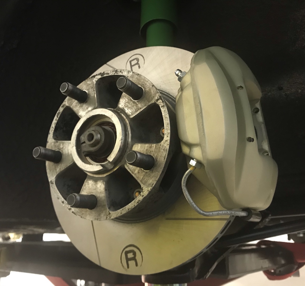

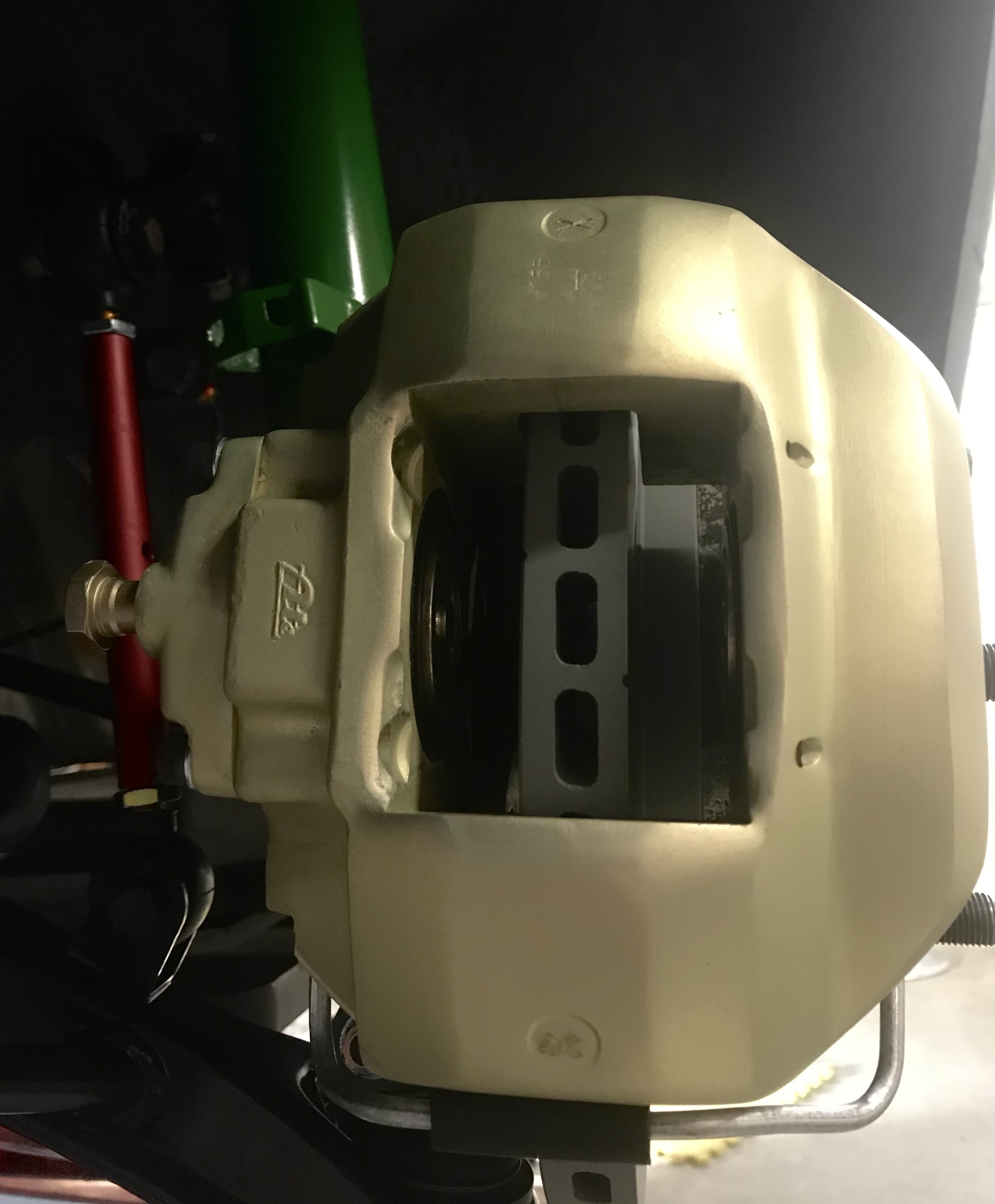

Some tasty bits that will bring this to a halt. S calipers restored courtesy of Eric & the gang at PMB. They turned out beautiful.
