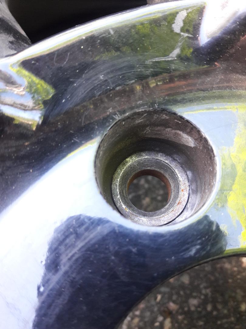

do you also know if there are supposed to be inserts in the minlite wheel lug holes, or did someone add those to mine?

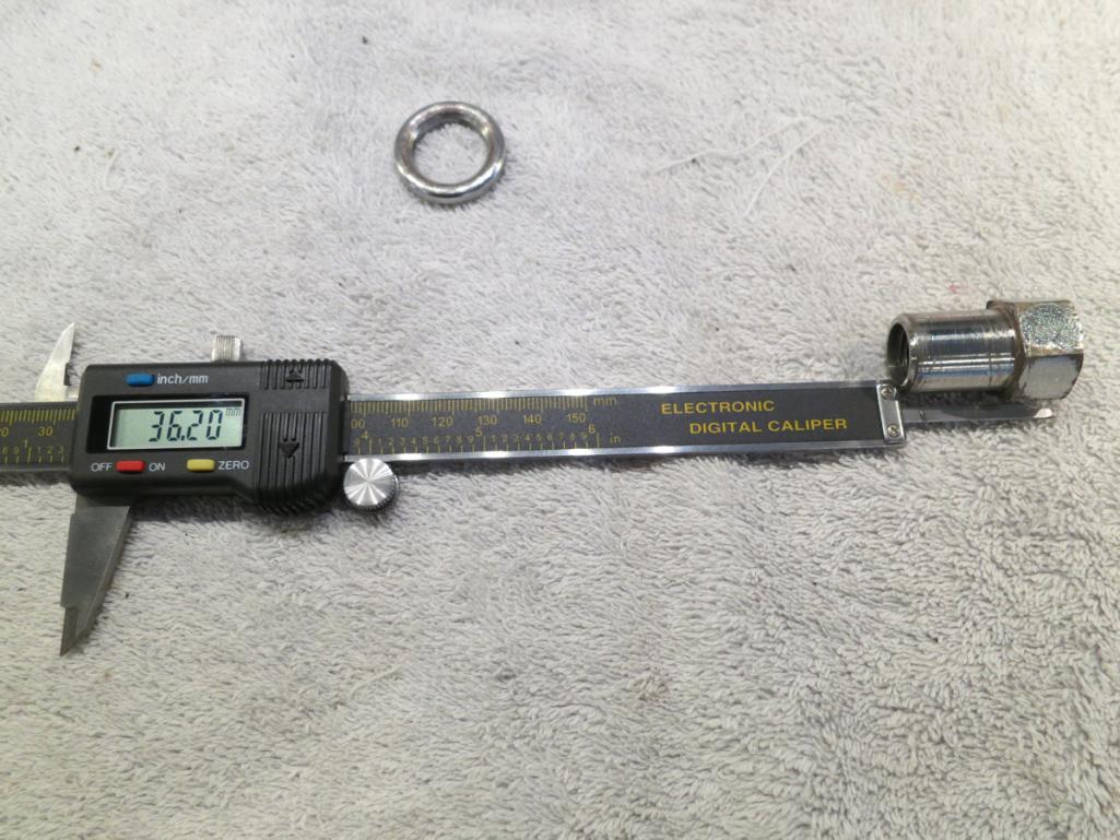

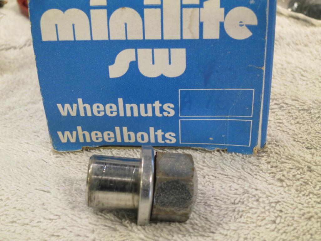

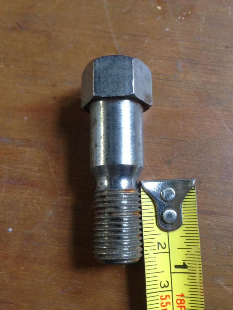

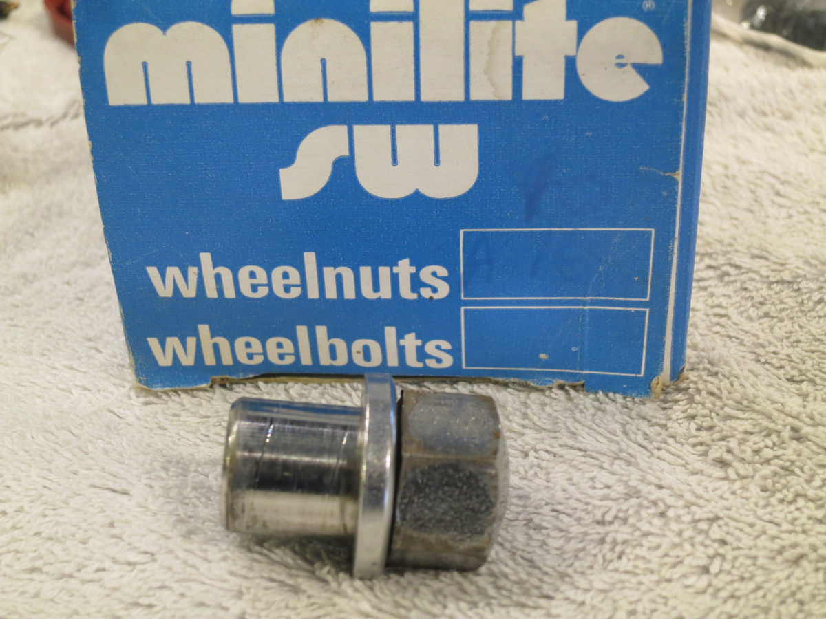

I hope these help.

QUOTE(mlmgm @ Jun 12 2019, 10:08 AM) *
I hope these help.

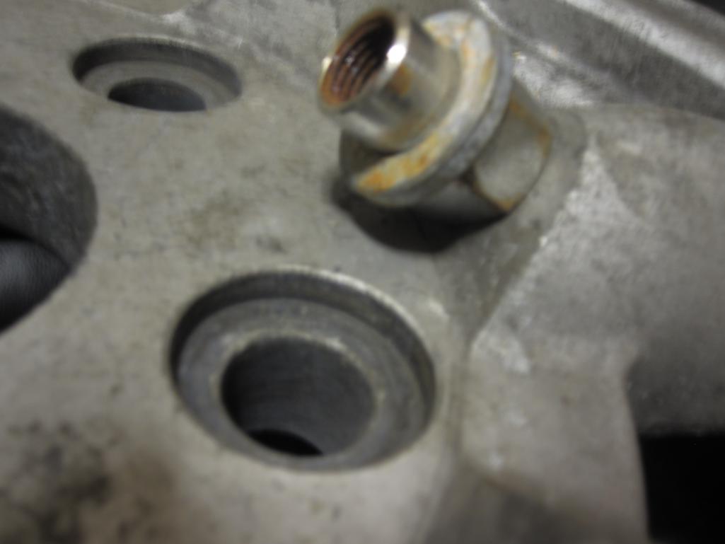

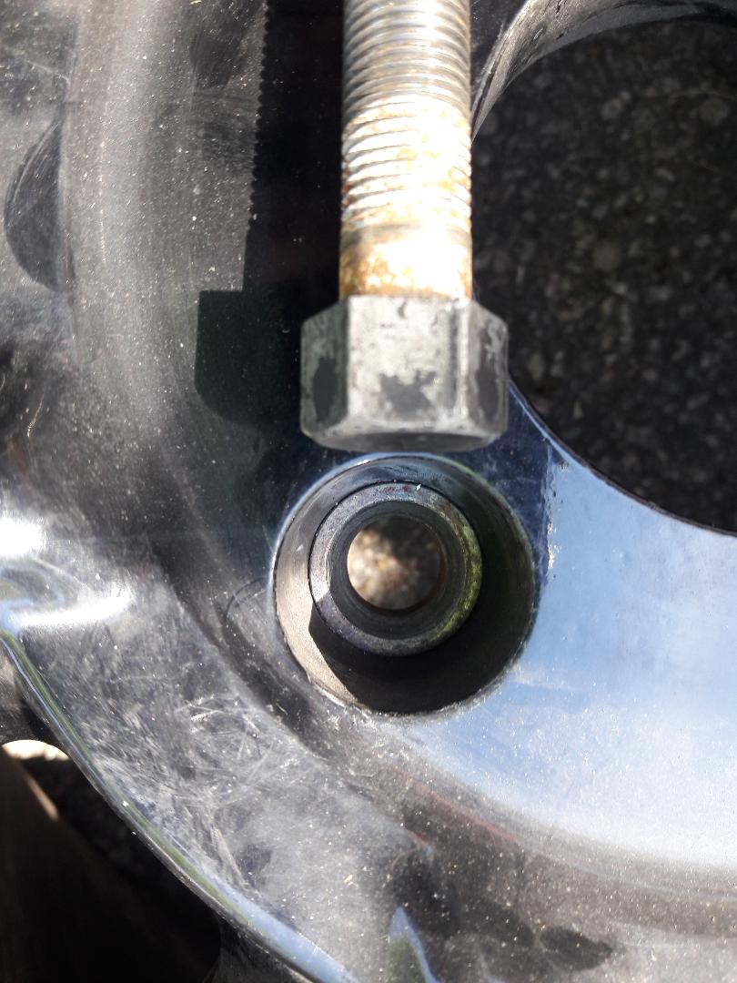

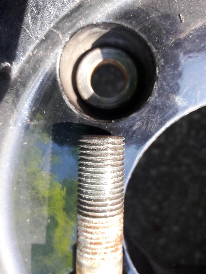

those pics will come in handy. I don't have stems to attach them to, but will get me half way there. I have one of these [attached] on the way in the mail. Looks like you have confirmed I am on the correct path. What I still don't know is if the inserts in my lug holes are stock to the minilite. They seem to possibly work with a conical washer on the nonminilite lugs I have....well 12 of the 14. the other 4 ball seats need to go i'm 99% certain. Attached Image Attached Image

this is what I have now, which is not working from 60-80 mph. 80-100 is fine though (IMG:style_emoticons/default/driving.gif) Attached ImageAttached Image
rgalla9146
post Jun 12 2019, 12:15 PM
Posts: 5,035
Joined: 23-November 05
From: Paramus NJ
Member No.: 5,176
The nuts shown by abeck914 are like those I'm using.
His washers are different from mine.
I believe the washer should be flat on both sides not cupped as shown.
My wheels are not hubcentric. They depend on the 'sleeve' of the nut to center the
wheel. The flat washer provides direct straight pressure on the flat of the wheel
to fasten to the hub.
As for the insert I have no idea how that fastener system works or what the correct
nut or bolt would look like.

I bought two new sets back in the late '70's for auto-x, no inserts in the lug holes

those must be some of the newer manufactured minis

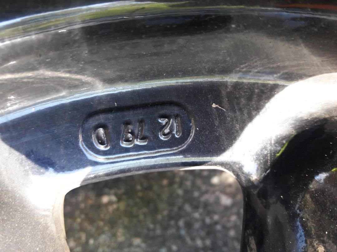

is there a date stamp ?

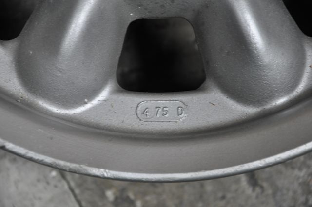

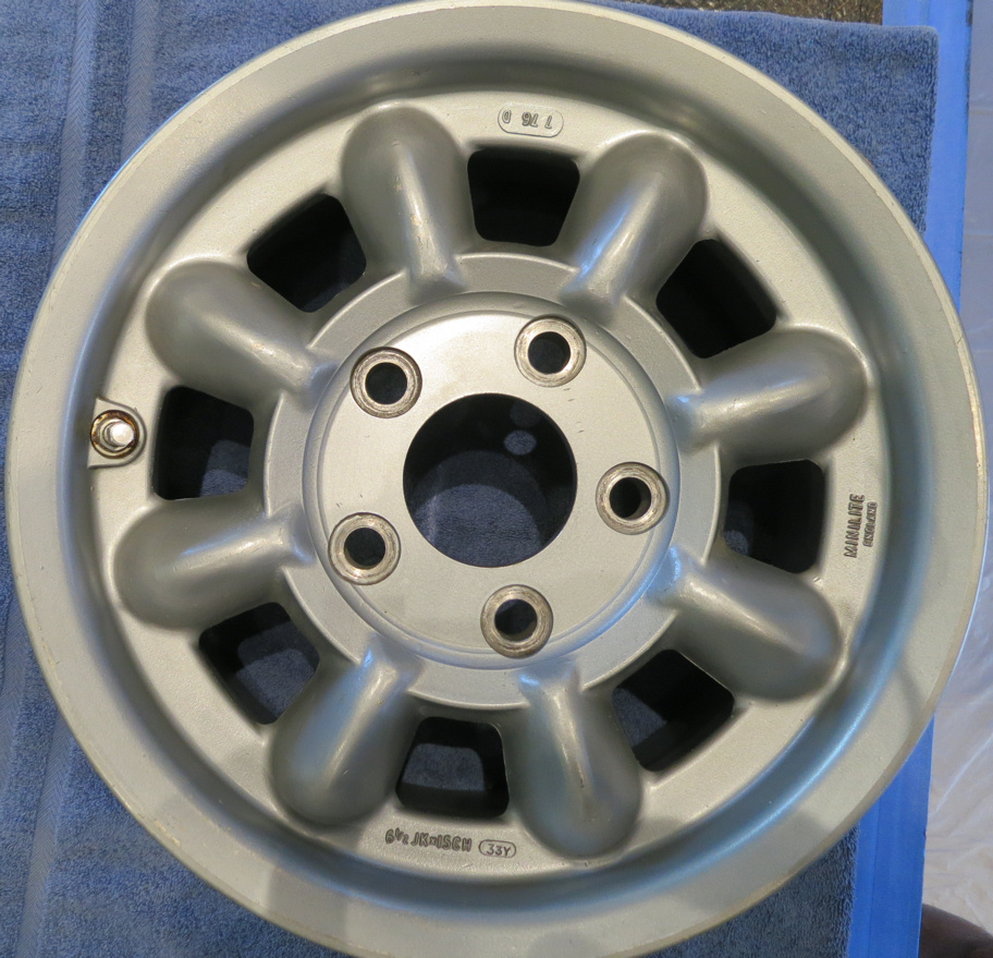

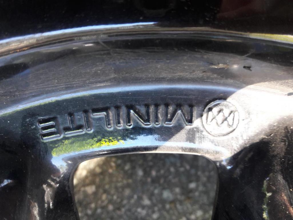

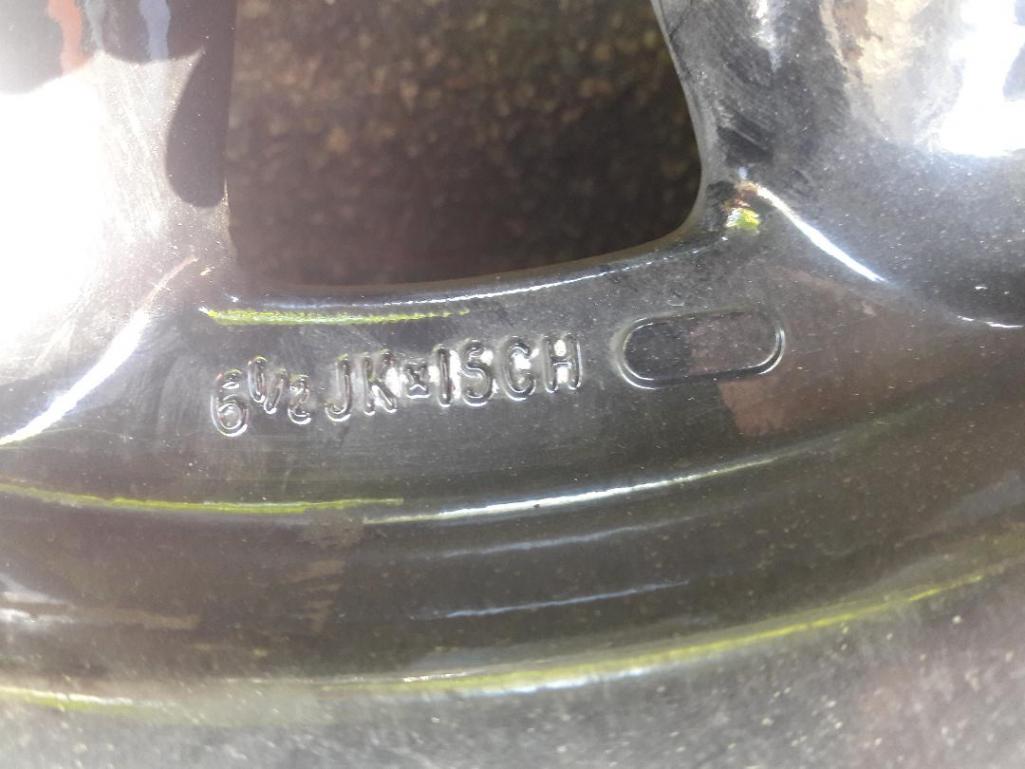

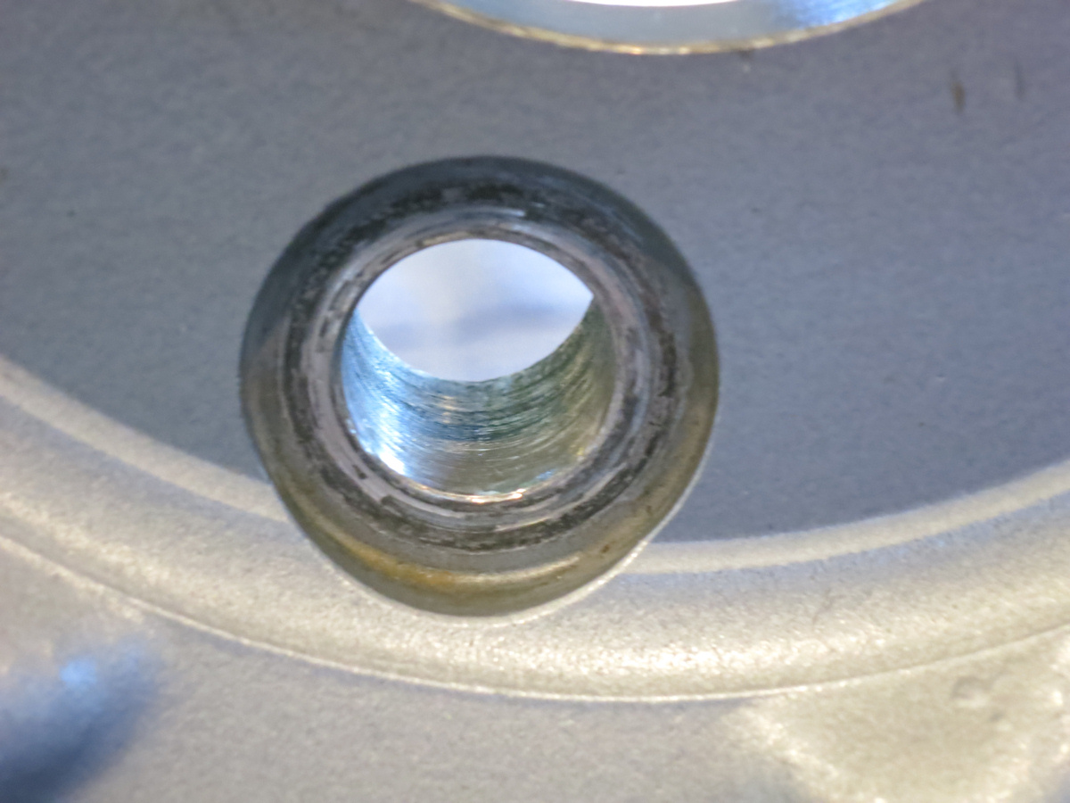

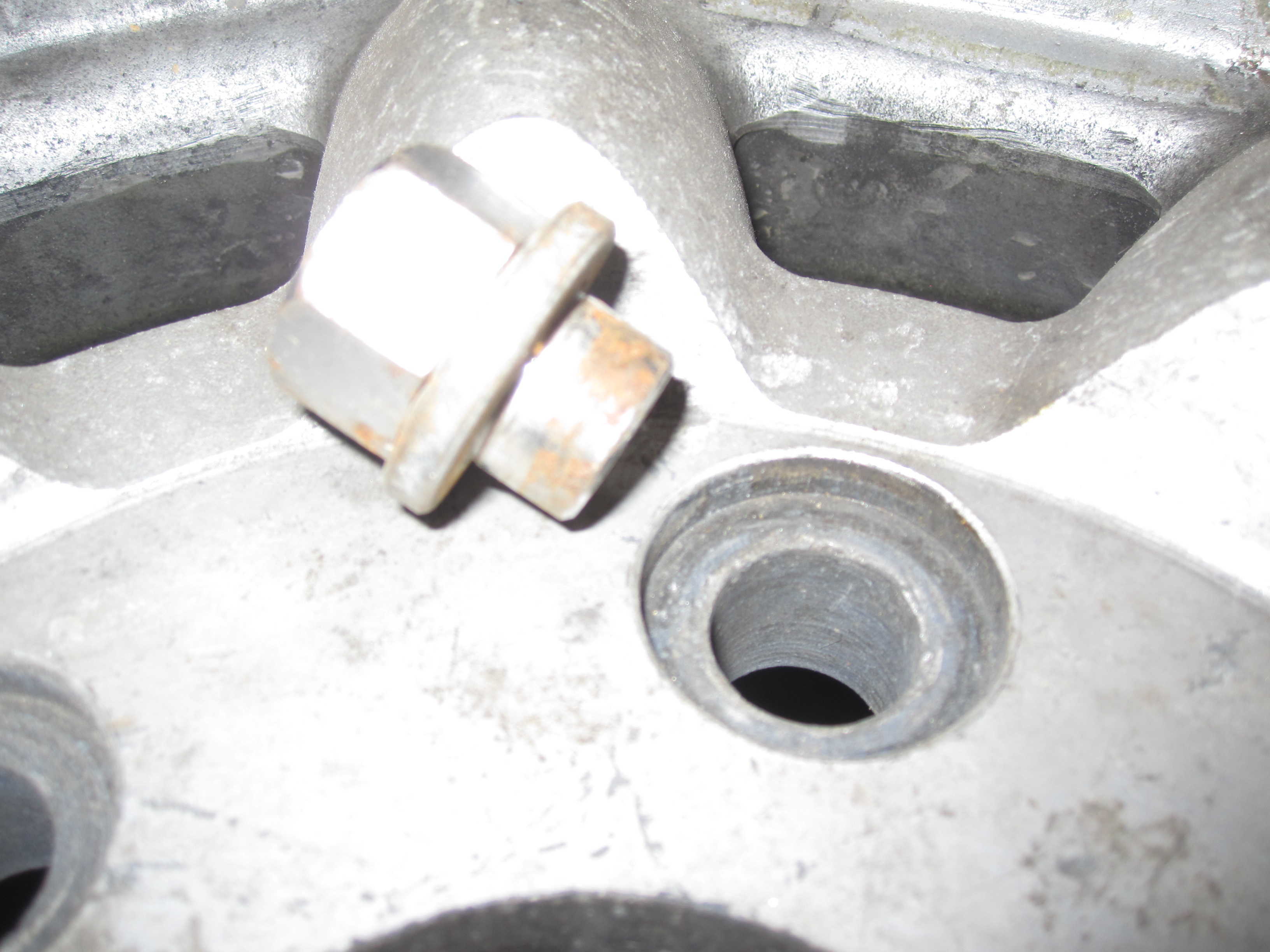

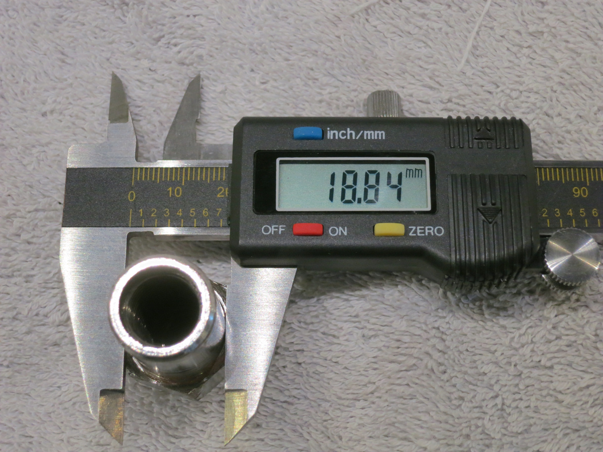

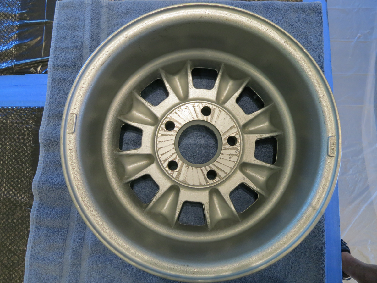

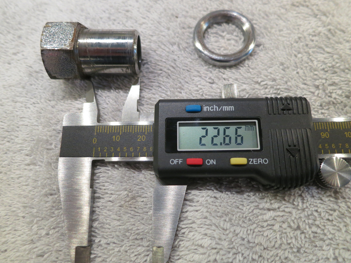

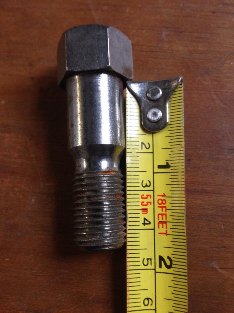

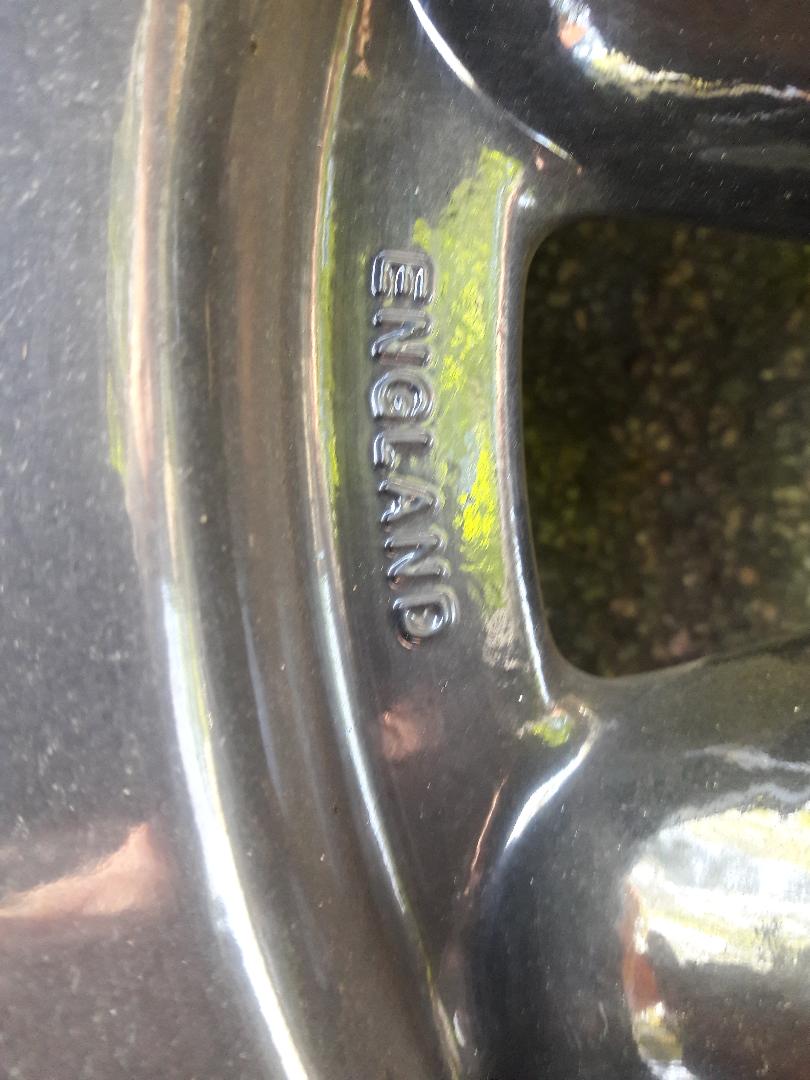

just adding some more pics and info to this thread.
pics of details of my minilites.
more I research i'm leaning towards concluding that I have some sort of this:
https://www.team-bhp.com/forum/tyre-alloy-w...us-reality.htmlAttached Image Attached ImageAttached ImageAttached Image

well someones been doing something to em..bummer, first holes look like tapered seat inserts, the one hole looks flat and not concentric to the insert..is that correct ??
fyi, wobble bolts only work for hub centric wheels..
- deciphering just what is what this exercise has been all about (IMG:style_emoticons/default/av-943.gif)
I think what we see in the pic is one hole with a tapered insert, as exists in all holes. Then the pic with the bolt, has the conical washer removed [as some do, and other bolts are fixed conical shape under bolt head] from the bolt and sitting in one of the tapered inserts.
I think I will know the next step when the original style bolt arrives. but i'm nervous to remove inserts because I don't know how much the original diameter of the bolt holes have been monkeyed with.
thanks for the heads up on the wobblies - seeing how this is my first endeavor with both those, and lug centric wheels. compound issue for me figuring this out.
