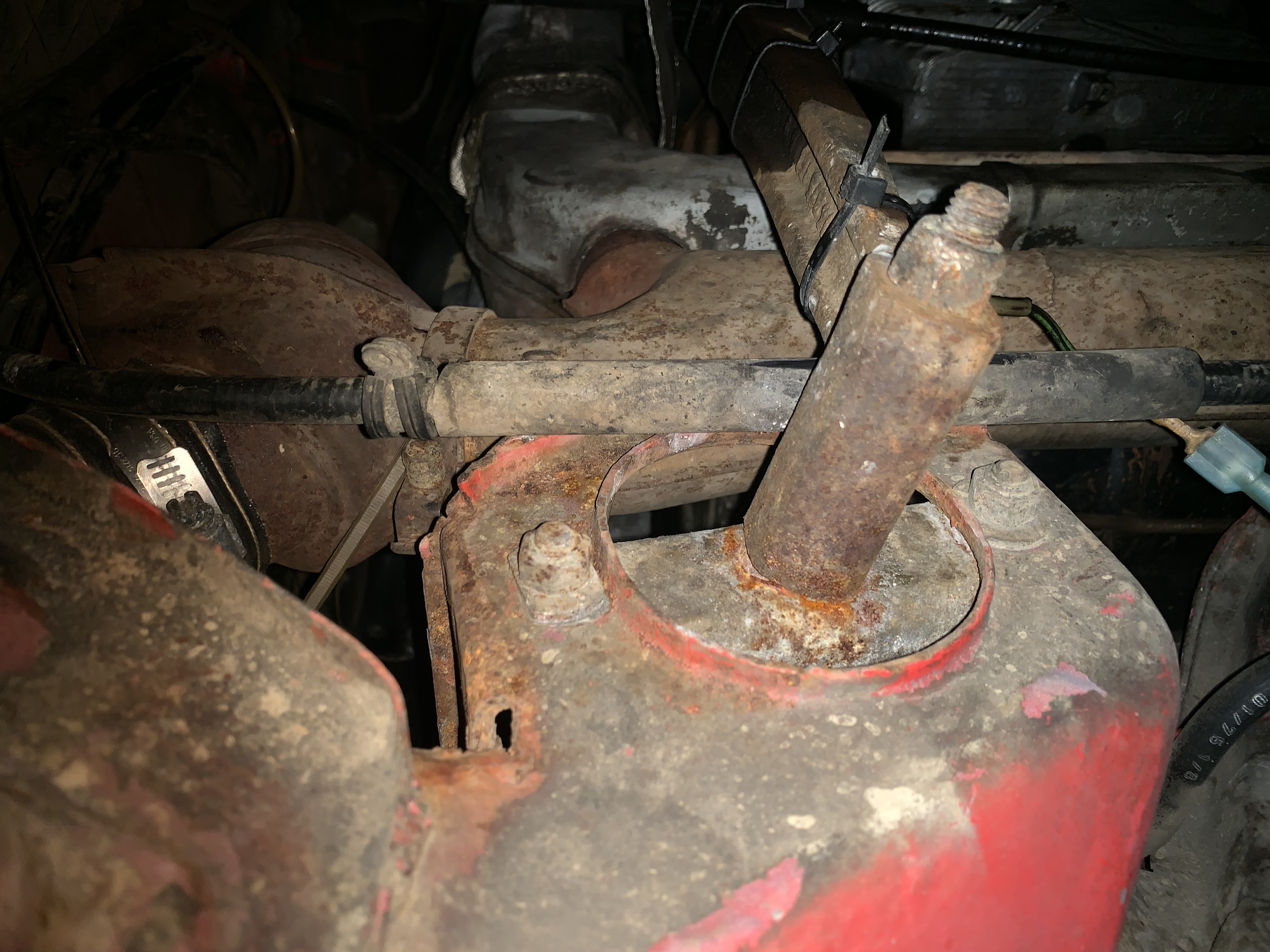

Noticed the engine bracket is bent. Not to worry, the engine will probably be dropped to replace and remove the oil cooler. Good times.... (IMG:style_emoticons/default/hissyfit.gif)
RolinkHaus Is this a big issue? Oct 7 2019, 05:08 PM
URY914 Not a biggie. Mine was bent one time. Oct 7 2019, 06:04 PM
RolinkHaus Forgot the pic
Oct 7 2019, 06:14 PM
Mikey914 Bolt not bracket, and yes replace it. Oct 7 2019, 06:29 PM

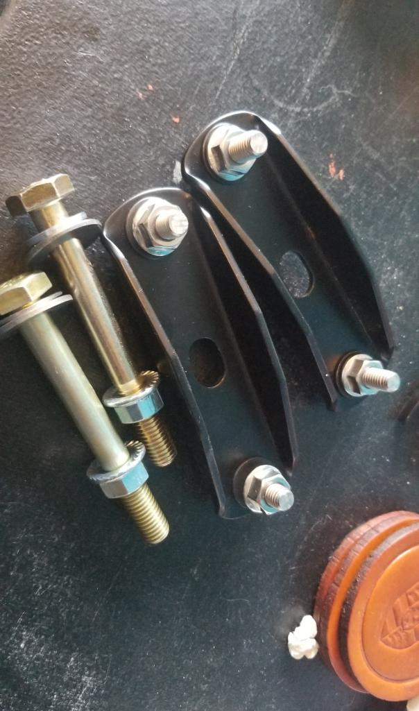

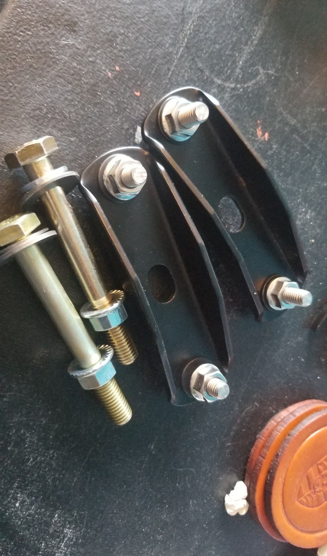

914Sixer Get one of Bruce Stone's HD brackets and not w... Oct 7 2019, 06:49 PM
Olympic 914
Get one of Bruce Stone's HD brackets and not ... Oct 8 2019, 09:19 AM
bdstone914
Get one of Bruce Stone's HD brackets and not... Oct 8 2019, 02:16 PM
RolinkHaus 914Sixer,
Where can I get them? Oct 7 2019, 07:28 PM
Mikey914 The "mount" is not bent. just the bolt. ... Oct 7 2019, 10:48 PM

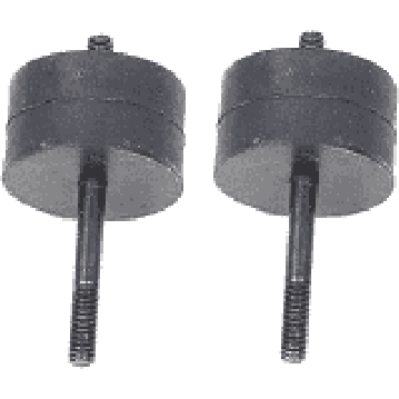

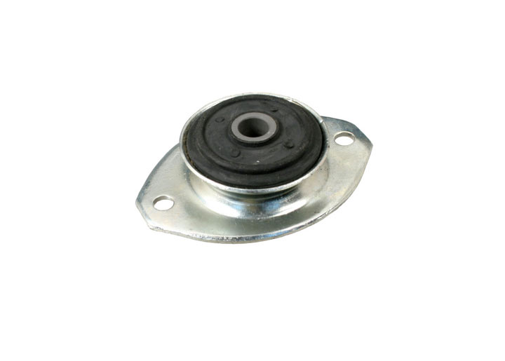

sixnotfour engine mounts probably separated too.. Oct 8 2019, 02:30 AM
RolinkHaus Are these mounts interchangeable with my set up?
Oct 8 2019, 04:16 AM
Maltese Falcon
... Oct 8 2019, 05:12 AM
RolinkHaus Good point. I think I’m just going replace the ... Oct 8 2019, 10:14 AM
bdstone914
Noticed the engine bracket is bent. Not to worry... Oct 8 2019, 02:20 PM
dr914@autoatlanta.com the bolt is upside down Oct 8 2019, 03:02 PM

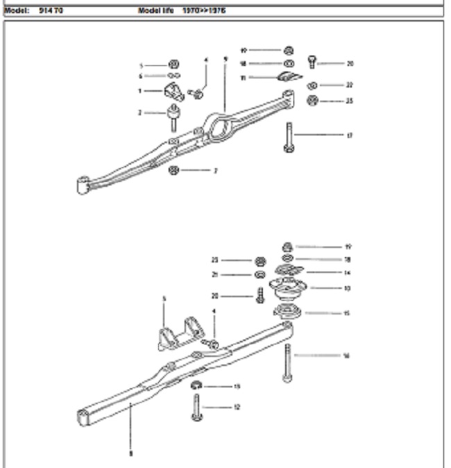

davep Bruce & George are correct, the head of the bo... Oct 8 2019, 03:25 PM
Literati914
Are these mounts interchangeable with my set up?... Oct 9 2019, 11:24 AM
sixnotfour After 50 yrs ,,it really matters which transmissio... Oct 9 2019, 12:37 PM![]() ![]() |
