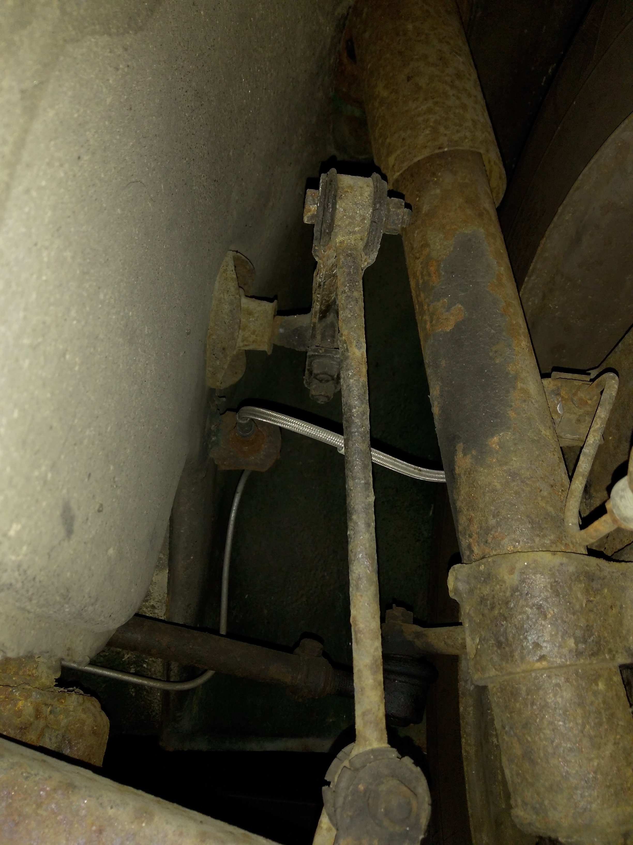

mtndawg
post Nov 5 2019, 06:11 PM
Posts: 433
Joined: 26-January 09
From: Granite Bay, Ca
Member No.: 9,985
Pics needed

QUOTE(mtndawg @ Nov 5 2019, 06:11 PM) *
Pics needed
If you were asking me, here you go. I can pull the tire and get better ones this weekend if needed. I know I didn't add it and I've had the car since 1977. There was nothing done to the car that I could tell when I bought it except the muffler had been replaced with the dual muffler Monza style. (and the rear valence discarded....) Attached Image Attached Image
ClayPerrine
post Nov 8 2019, 07:18 AM
Posts: 16,568
Joined: 11-September 03
From: Hurst, TX.
Member No.: 1,143
QUOTE(fixer34 @ Nov 7 2019, 07:28 PM) *
Pics needed
Probably installed by a previous owner, like our six. I disconnected it because the hole on the left side is torn out. It will be restored to no sway bar when the body work is done.
