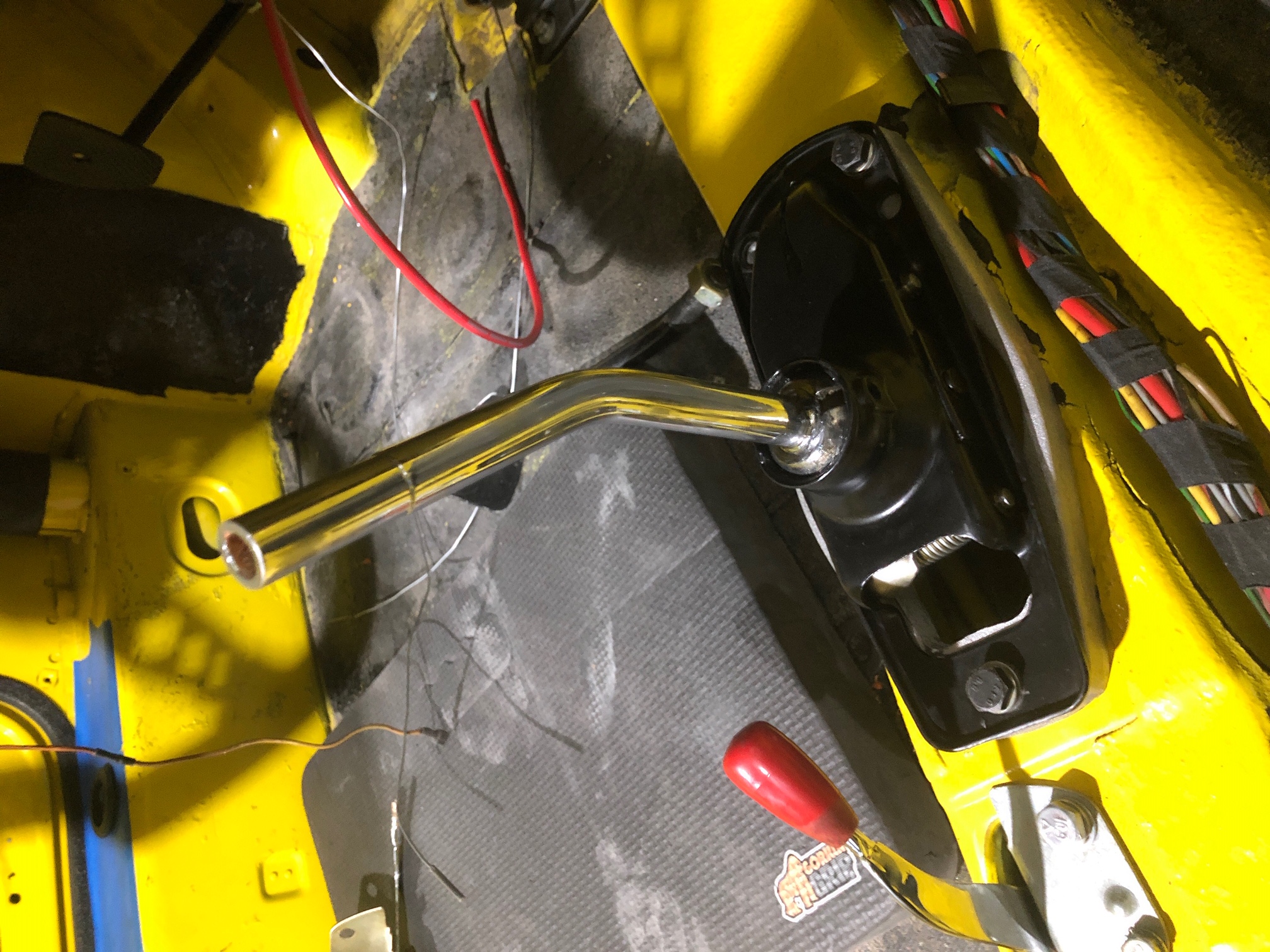

Look at my 914 6 stereo install. Eric said I can see the big red wire in the loom.
Also my quick shift
Good luck,
