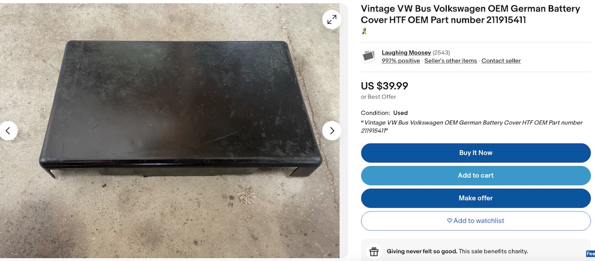

1 211 915 411 c This cover came with my 74 1.8. I don't know if it is original or from something else

I have one of these, it snaps on. simple. AFAIK it came from George

Thats the factory HO recall campaign battery cover. Snaps on, no rubber band needed like the early version.

@Artfrombama
@JeffBowlsby would know.
here is also one from a very original 1.8 sold recently on BAT.
lying around in trunk of car in the photos.
same as yours and has the recall sticker on it as well.
my reading of the part number you quote is
211 in it means its a type 2 part i believe. originally was meant for a bus (kombi).
the 411 numbers at end are used right through 70s and 80s for various battery covers in various model VWs.
im guessing the original battery cover part listed in PET (the smaller one) was superceded with the bus one and the bus one probably got developed a little later than during 914 production run.
its a real deal thats for sure.

here you go @Artfrombama and @JeffBowlsby
Porsche/Audi were handing out VW bus battery covers in that later recall.
looks like this one is either a C same as they handed out for 914s or its a G variant.
a bit later. photo not quite legible.
