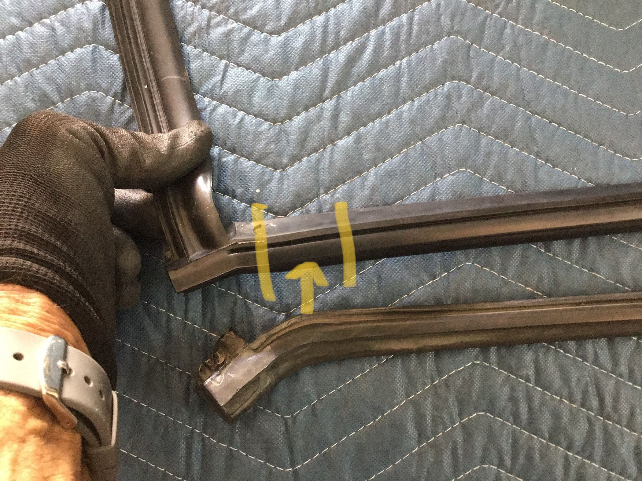

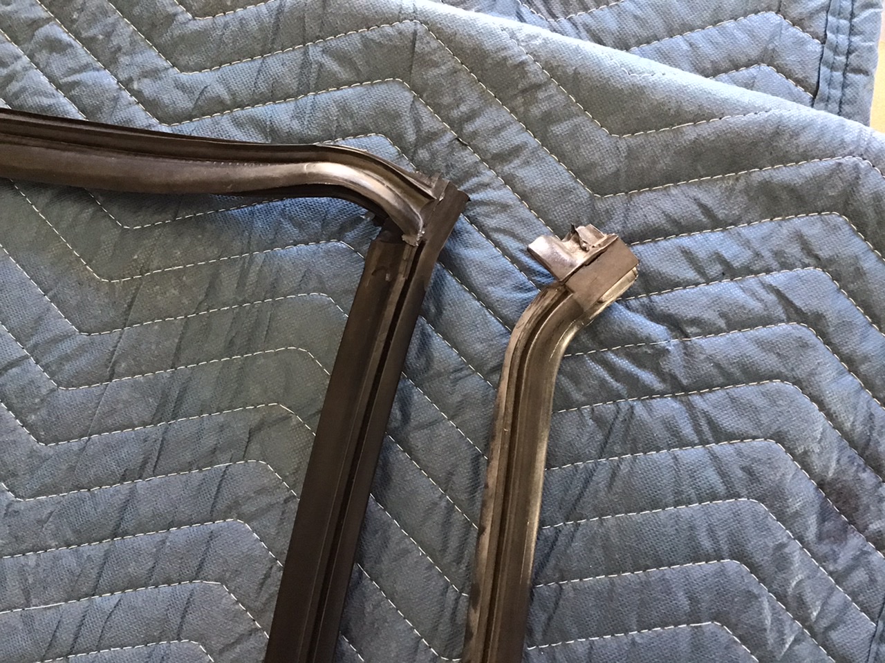

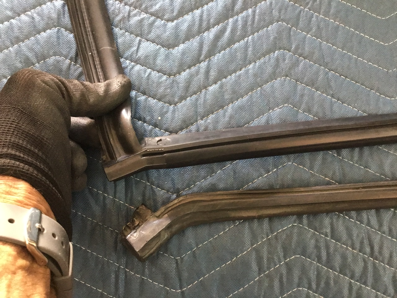

I would take installing the air box 5 times, over putting this seal in. I cannot get it to conform at the top where it makes the bend. (IMG:style_emoticons/default/headbang.gif)
I have tried heating the rubber in this area to get it to conform to the bend without any luck. The 914 rubber piece is reinforced in the exact location that it needs to make the bend. Not sure what to do at this point. (IMG:style_emoticons/default/hissyfit.gif)
You can see where the original piece is bent.

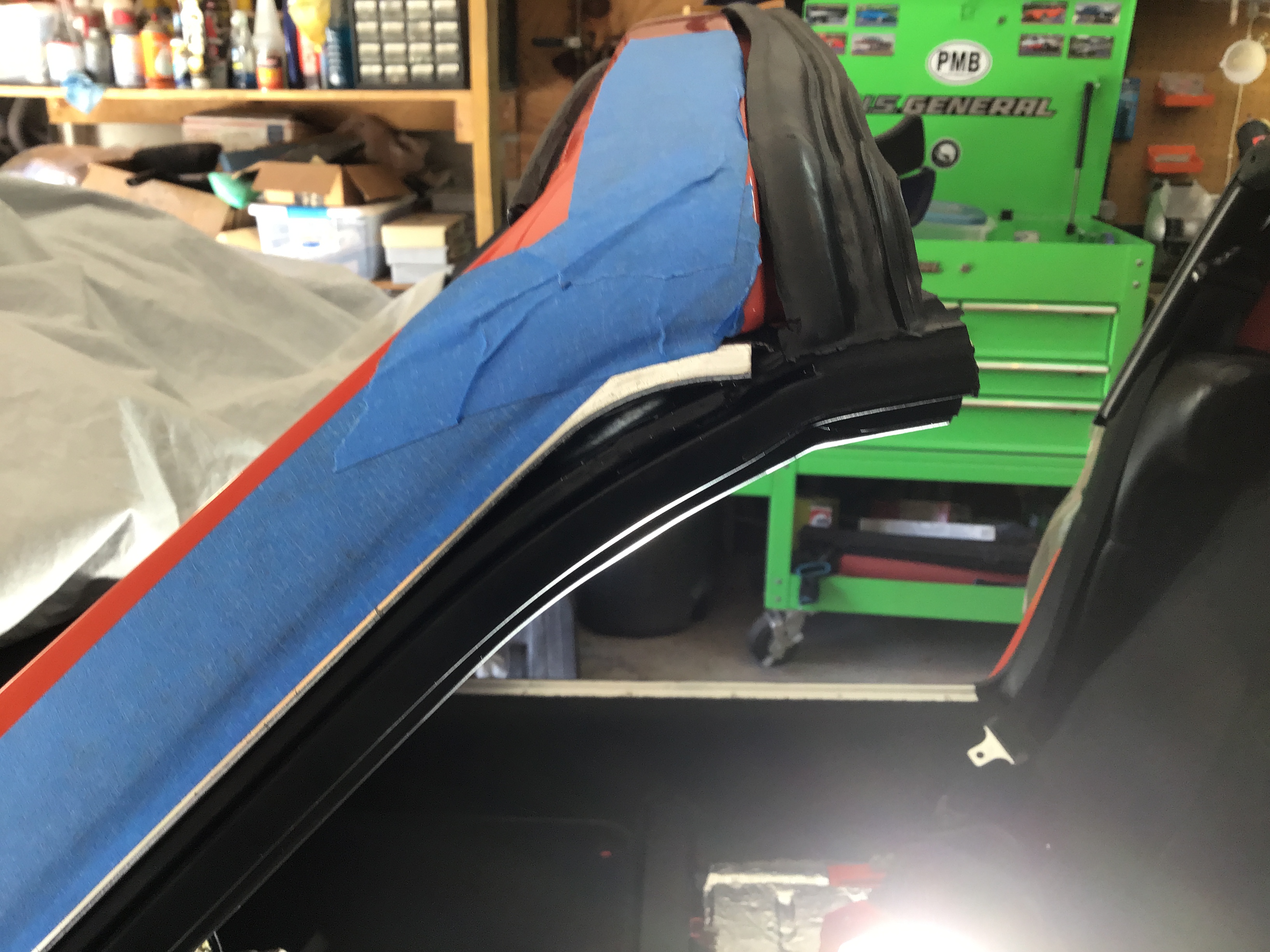

mgphoto   I did this about a year ago, work from the top dow...   Apr 3 2021, 11:39 AM
Morph914   I did this about a year ago, work from the top do...   Apr 3 2021, 12:30 PM

Mikey914   The rubber can only be molded when it's in it...   Apr 4 2021, 04:24 AM
Morph914   The rubber can only be molded when it's in it...   Apr 4 2021, 11:33 AM

zfisher6164   See if this helps, the seal went on easier then I ...   Apr 4 2021, 11:53 AM
Mikey914   This is not an easy seal to replace. The key is to...   Apr 4 2021, 04:04 PM

Literati914   .. In the picture, I have marked where the hard ...   Apr 4 2021, 07:48 PM

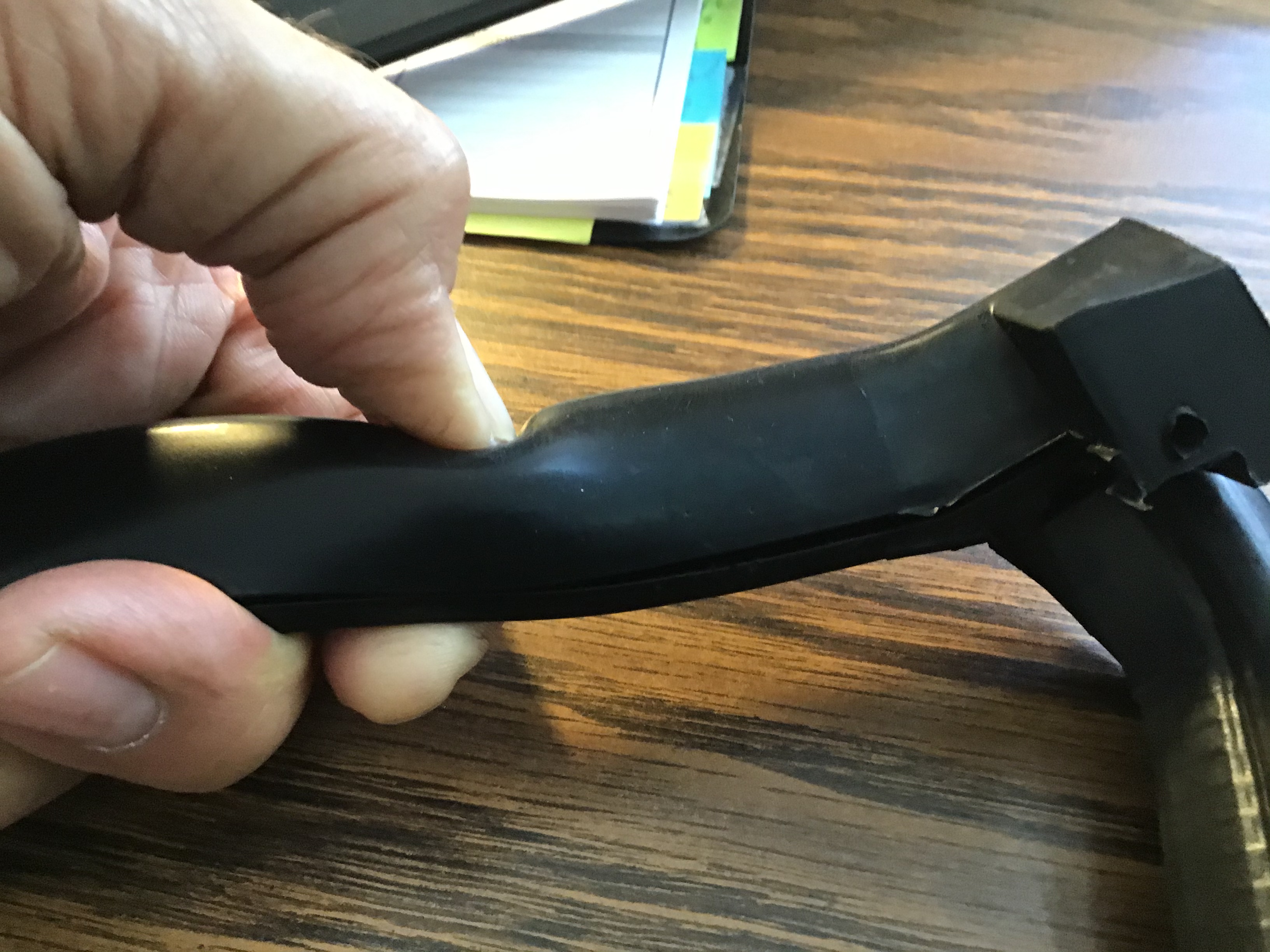

Mikey914   The internal joining block should be about 2-1/2...   Apr 7 2021, 10:19 AM
Morph914   The internal joining block should be about 2-1/2...   Apr 7 2021, 07:43 PM
76-914   The internal joining block should be about 2-1/2...   Apr 7 2021, 08:07 PM
Mikey914   More detail on closure This is a new seal out of t...   Apr 7 2021, 10:34 AM
