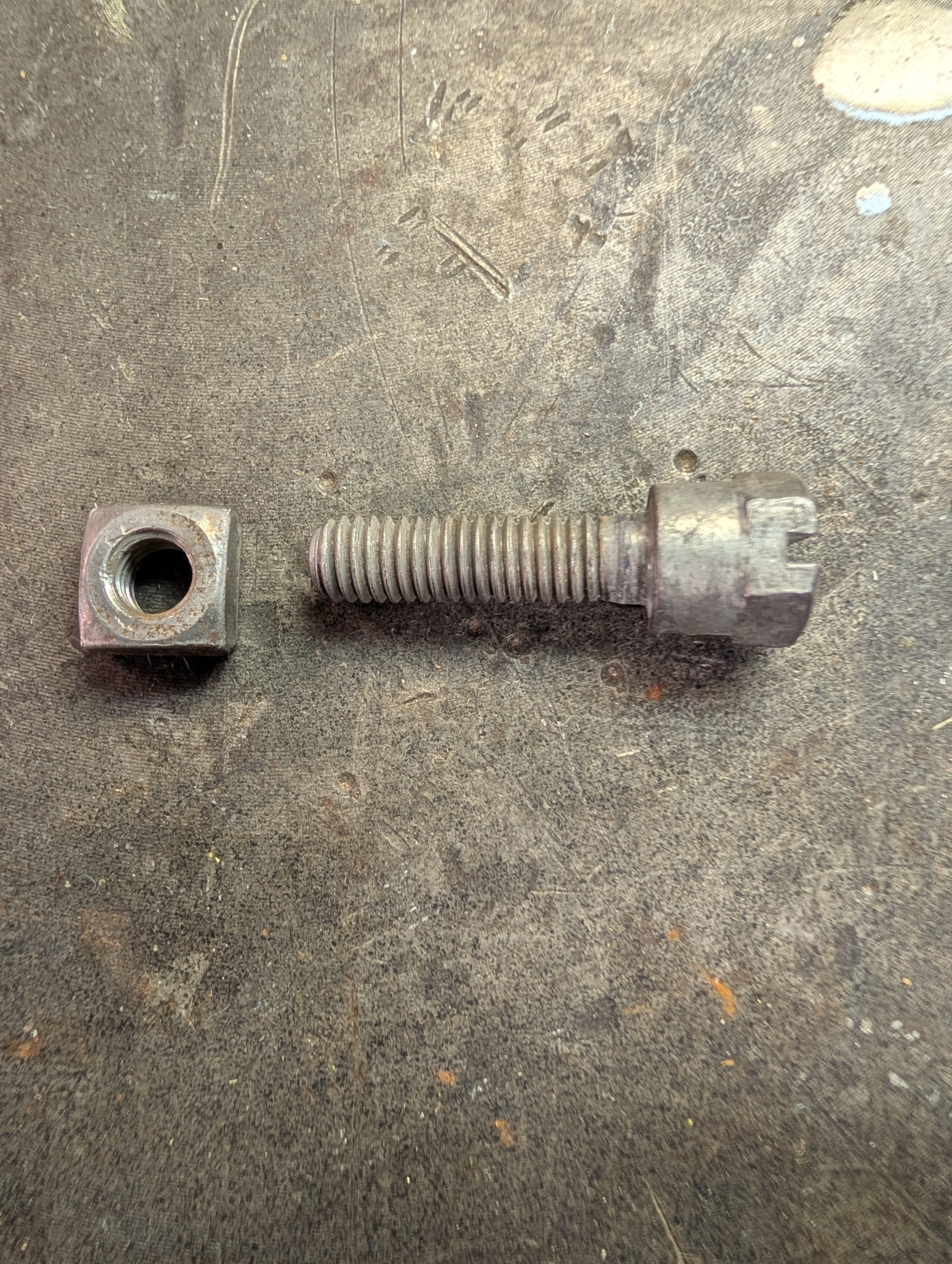

Is this the correct bolt to secure the flapper box to the heat exchanger on a 914-6? Part number 901-211-631-00. Appears to be NLA. Paired with square nut.
It is what I removed from a pair of used flapper boxes I bought. I tried installing it on a new Dansk flapper / heat exchanger and it appears too short. Even if I try various clamps to compress the flange and close the distance.

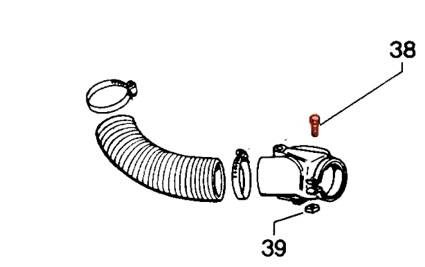

Dennis, I tried looking it up in the PET and other resources and it doesn't give a length. It sould be an M6 bolt although that is an assuption based on the fact that it shows the nut on it is M-6. Sorry its not much help, but you can at least check if its M6. if the one you have doesn't meet that spec, then you'll know its not right.

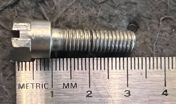

I agree. The bolt on my flappers is 32mm
If the Dansk parts do everything else as they should a longer bolt will do the trick.

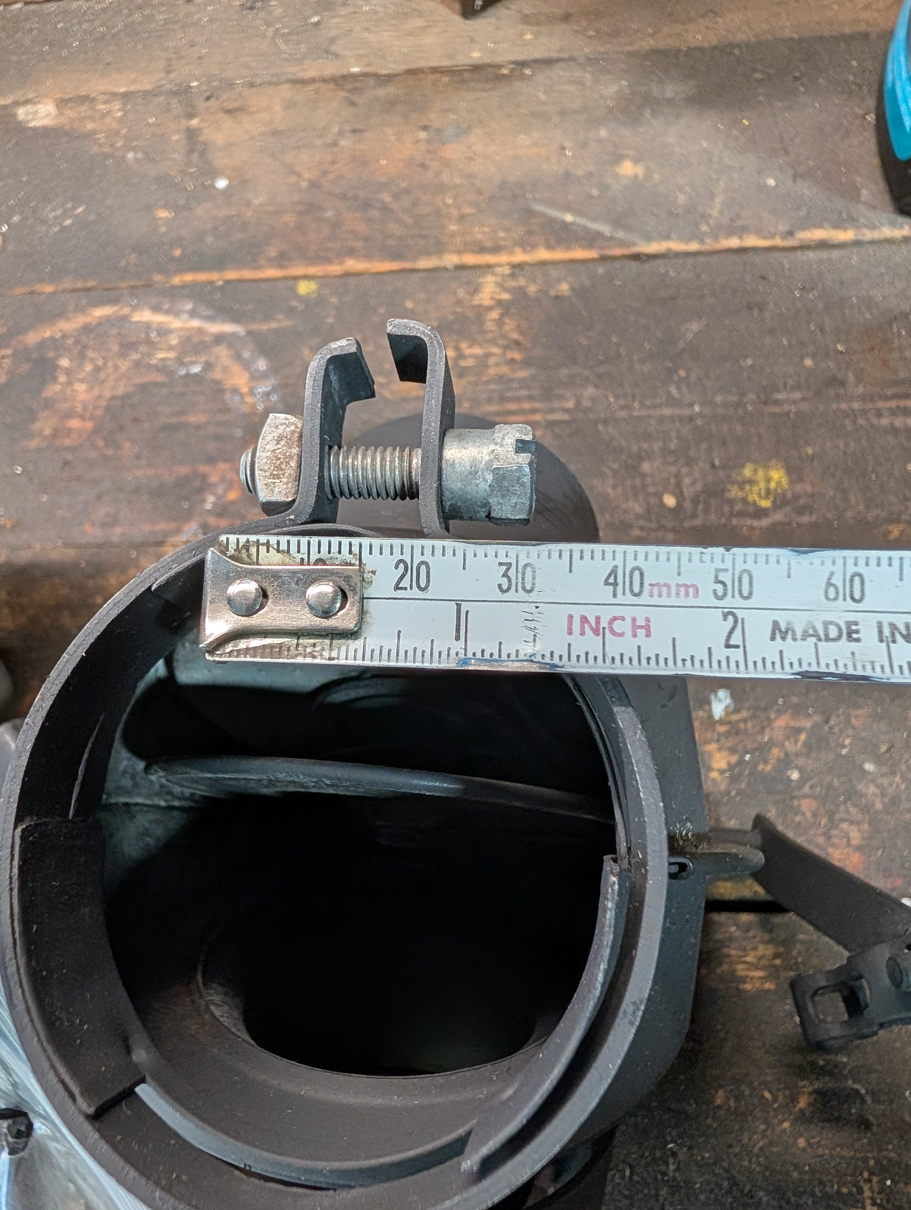

Dennis...here is a picture I took today of my OEM original six flapper boxes

@johnhora thanks for the photos and dimensions.

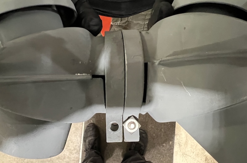

Maybe it's the end of the Dansk heat exchanger that is causing the problem. When I put the old and new flappers side-by-side, I don't see any notable difference in the diameters when relaxed.
Original on the right. New Dansk 914-4 with hole cut and painted gray on the left.

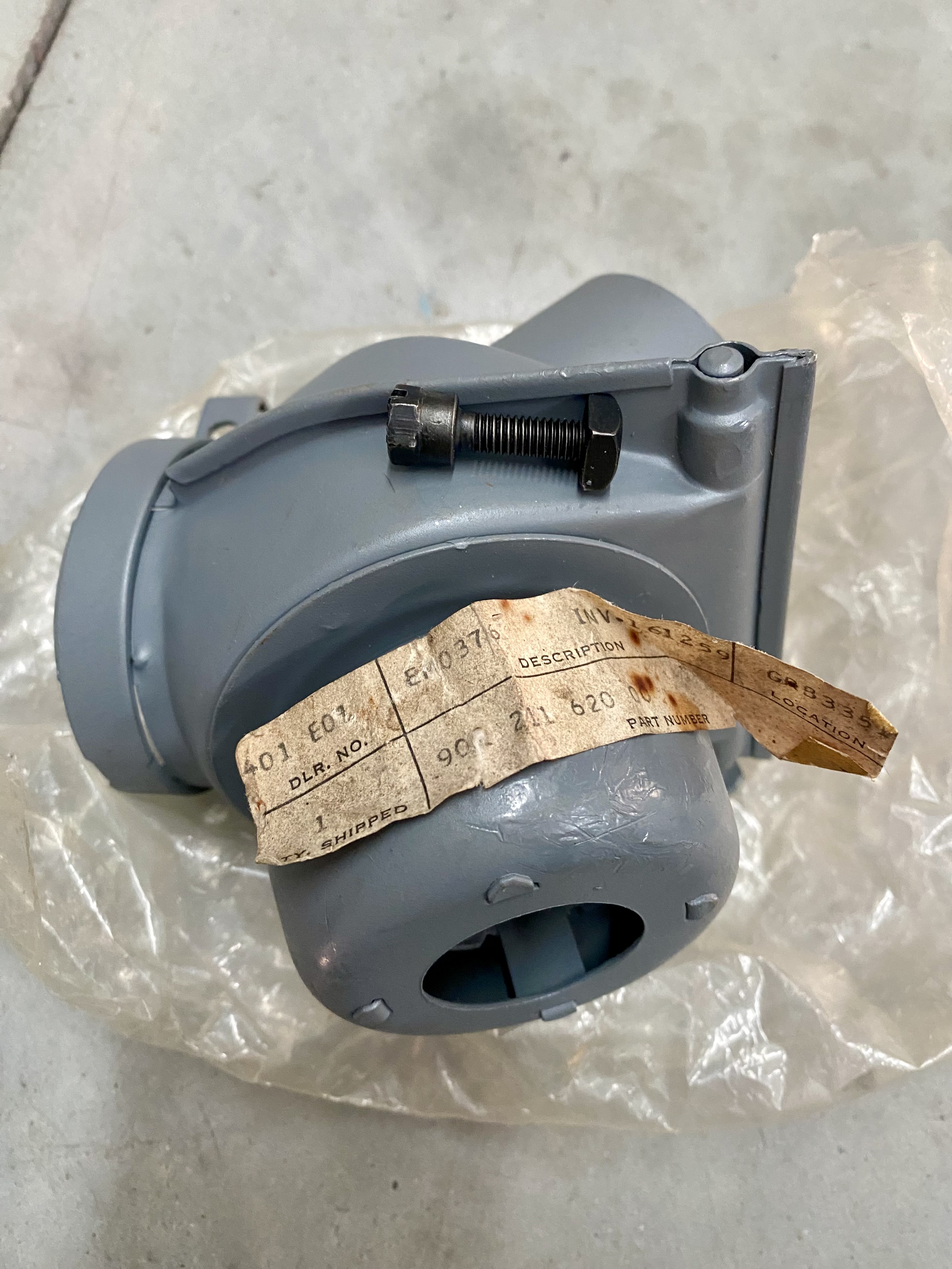

Here is an NOS valve and retainer bolt/nut. Interestingly the replacements were black oxide type finish with the unique locking nut.
